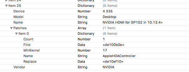

FredWst Posted March 28, 2018 Share Posted March 28, 2018 (edited) Hello, HDMI fix for 10.13.4 Bx AppleALC has been updated for some nvidia hdau id. Thank's to vit9696. Compil with debug AppleALC.kext.zip with NVIDIA HDMI for GP102 in 10.13.4+ (fabiosun) AppleALC.kext.zip Edited March 28, 2018 by FredWst 5 Link to comment Share on other sites More sharing options...
Guest Posted March 28, 2018 Share Posted March 28, 2018 (edited) not working for me without your patch in config . plist 39 minutes ago, FredWst said: Hello, HDMI fix for 10.13.4 Bx AppleALC has been updated for some nvidia hdau id. Thank's to vit9696. Compil with debug AppleALC.kext.zip I have understood I have to insert my device id in applealc and then recompile it (thank you Fred) Edited March 28, 2018 by Guest add some infos Link to comment Share on other sites More sharing options...
FredWst Posted March 28, 2018 Share Posted March 28, 2018 33 minutes ago, fabiosun said: not working for me without your patch in config . plist I have understood I have to insert my device id in applealc and then recompile it (thank you Fred) Yes you need to add it 1 Link to comment Share on other sites More sharing options...

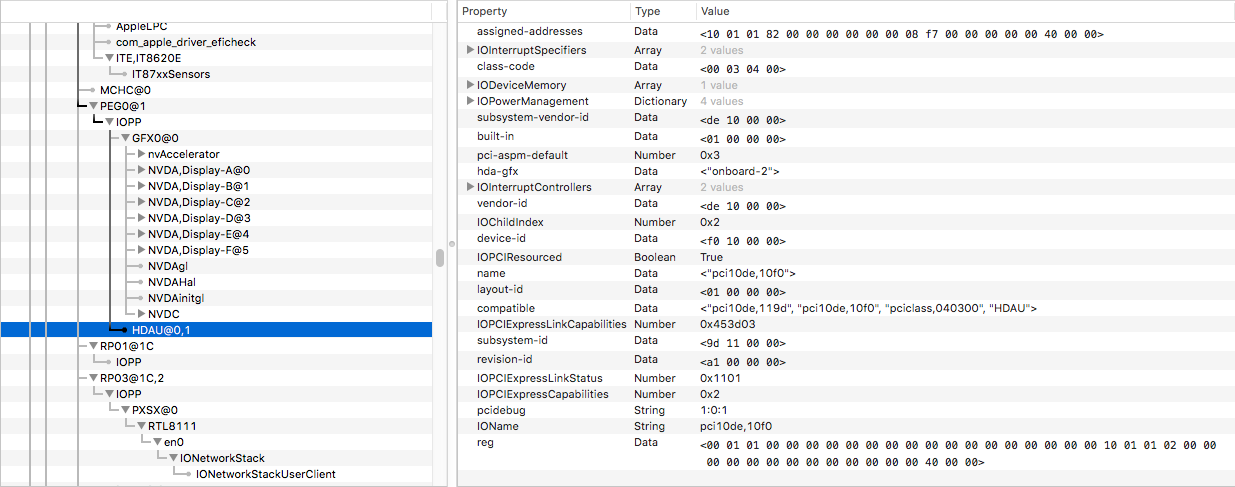

redflame Posted April 3, 2018 Share Posted April 3, 2018 7 hours ago, FredWst said: Can u give us, HDAU ID from ioregistryexplorer ? Fred For sure! Attached a screenshot of HDAU from ioregistryexplorer. Link to comment Share on other sites More sharing options...
