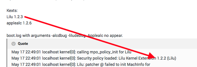

Cartier82 Posted May 17, 2018 Share Posted May 17, 2018 Hi, I am having troubles to get audio work through ALC883 (audio through HDMI works). My specs: GA-965P-S3 rev1 Audio Realtek ALC883 Audio device: 0x8086284B Sub device: 0x1458A002 Codec ID: 0x10EC0883 Revision: 0x0002 layout: severals 1, 3, 5, 7, 9 (clover injection), actual 7 Kexts: Lilu 1.2.3 applealc 1.2.6 boot.log with arguments -alcdbug -liludebug. Applealc no appear. Quote May 17 22:49:01 localhost kernel[0]: calling mpo_policy_init for Lilu May 17 22:49:01 localhost kernel[0]: Security policy loaded: Lilu Kernel Extension 1.2.2 (Lilu) May 17 22:49:01 localhost kernel[0]: Lilu: patcher @ failed to init MachInfo for com.apple.driver.AppleIntelKBLGraphicsFramebuffer May 17 22:49:01 localhost kernel[0]: Lilu: api @ failed to load com.apple.driver.AppleIntelKBLGraphicsFramebuffer kext file May 17 22:49:01 localhost kernel[0]: Lilu: patcher @ failed to init MachInfo for com.apple.kext.AMDRadeonX4100 May 17 22:49:01 localhost kernel[0]: Lilu: api @ failed to load com.apple.kext.AMDRadeonX4100 kext file May 17 22:49:01 localhost kernel[0]: Lilu: patcher @ failed to init MachInfo for com.apple.kext.AMDRadeonX4150 May 17 22:49:01 localhost kernel[0]: Lilu: api @ failed to load com.apple.kext.AMDRadeonX4150 kext file May 17 22:49:01 localhost kernel[0]: Lilu: patcher @ failed to init MachInfo for com.apple.kext.AMDRadeonX4200 May 17 22:49:01 localhost kernel[0]: Lilu: api @ failed to load com.apple.kext.AMDRadeonX4200 kext file May 17 22:49:01 localhost kernel[0]: Lilu: patcher @ failed to init MachInfo for com.apple.kext.AMDRadeonX4250 May 17 22:49:01 localhost kernel[0]: Lilu: api @ failed to load com.apple.kext.AMDRadeonX4250 kext file May 17 22:49:01 localhost kernel[0]: Lilu: patcher @ failed to init MachInfo for com.apple.kext.AMDRadeonX5000 May 17 22:49:01 localhost kernel[0]: Lilu: api @ failed to load com.apple.kext.AMDRadeonX5000 kext file May 17 22:49:01 localhost kernel[0]: Lilu: patcher @ failed to init MachInfo for com.apple.kext.AMDFramebuffer May 17 22:49:01 localhost kernel[0]: Lilu: api @ failed to load com.apple.kext.AMDFramebuffer kext file May 17 22:49:01 localhost kernel[0]: Lilu: patcher @ failed to init MachInfo for com.apple.kext.AMDLegacyFramebuffer May 17 22:49:01 localhost kernel[0]: Lilu: api @ failed to load com.apple.kext.AMDLegacyFramebuffer kext file May 17 22:49:01 localhost kernel[0]: Lilu: patcher @ failed to init MachInfo for com.apple.kext.AMDLegacySupport May 17 22:49:01 localhost kernel[0]: Lilu: api @ failed to load com.apple.kext.AMDLegacySupport kext file May 17 22:49:05 localhost kernel[0]: Lilu: patcher @ lookup patching applied only 0 patches out of 2 HDEF dsdt: Quote Device (HDEF) { Name (_ADR, 0x001B0000) Method (_DSM, 4, NotSerialized) { If (LEqual (Arg2, Zero)) { Return (Buffer (One) { 0x03 }) } Return (Package (0x10) { "AAPL,slot-name", "Built In", "name", "Audio Controller", "model", Buffer (0x27) { "Apple High Definition Audio Controller" }, "device_type", Buffer (0x11) { "Audio Controller" }, "layout-id", Buffer (0x04) { 0x01, 0x00, 0x00, 0x00 }, "MaximumBootBeepVolume", Buffer (One) { 0x01 }, "PinConfigurations", Buffer (Zero) {}, "hda-gfx", Buffer (0x0A) { "onboard-1" } }) } } Info.plist Could anybody help me to meek it works? Thanks in advance, regards. Link to comment https://www.insanelymac.com/forum/topic/311293-applealc-%E2%80%94-dynamic-applehda-patching/page/86/#findComment-2613976 Share on other sites More sharing options...
Andrey1970 Posted May 17, 2018 Share Posted May 17, 2018 1 1 Link to comment https://www.insanelymac.com/forum/topic/311293-applealc-%E2%80%94-dynamic-applehda-patching/page/86/#findComment-2613992 Share on other sites More sharing options...

Cartier82 Posted May 18, 2018 Share Posted May 18, 2018 15 hours ago, Andrey1970 said: Thanks a lot, it solve the problem. For any reason I though they were in last version. Regards, Link to comment https://www.insanelymac.com/forum/topic/311293-applealc-%E2%80%94-dynamic-applehda-patching/page/86/#findComment-2614055 Share on other sites More sharing options...

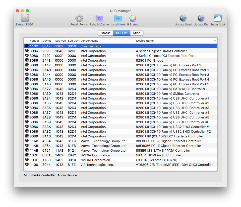

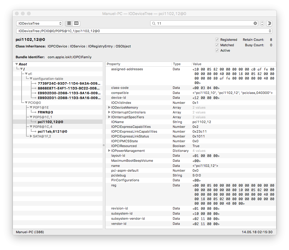

Typhoon_Master Posted May 21, 2018 Share Posted May 21, 2018 (edited) Is there a chance that a PCIe-Card with ACL898 can be run with this kext? What i tried so far... I) Normal installation I installed AppleALC + Lilu in Clover and injected every LayoutIDs that are shown in the wiki, but it did not work out. II) Modifying Plist Then I tried to change the plist of the kext to match my card, but also without success. <key>IOPCIPrimaryMatch</key> <string>0x00121102</string> III) Editing SourceCode and compiling myself After seeing "unsupported hdef vendor" in the logs, thought i might change the sourcecode to disable the check for the intel-vendorID. This didn't work out either and the whole kext is too complex for me to understand since i am no experienced osx/c++ dev. However at least i was successful in compiling the kext. May 21 09:21:28 localhost kernel[0]: AppleALC: audio @ (DBG) corrects analog audio for hdef at pci1102,12 with 1102:0012 May 21 09:21:28 localhost kernel[0]: AppleALC: audio @ (DBG) unsupported hdef vendor May 21 09:21:28 localhost kernel[0]: AppleALC: alc @ (DBG) failed to find a suitable codec, we have nothing to do May 21 09:21:28 localhost kernel[0]: AppleALC: alc @ (DBG) missing ControllerModInfo for 0 controller May 21 09:21:28 localhost kernel[0]: AppleALC: alc @ (DBG) missing ControllerModInfo for 1 controller Does anyone have an idea what i could do to make this work? Again the realtek-chip ACL898 should work with AppleALC, but i think it does not because of either is not declared as HDEF device for the system and/or because the kext does not check the pcie bus for devices. Card is a Creative Sound Blaster Audigy FX. Log and Codec-Dump is attached. Regards Typhoon codec_dump.txt appleALC_log.txt Edited May 21, 2018 by Typhoon_Master Link to comment https://www.insanelymac.com/forum/topic/311293-applealc-%E2%80%94-dynamic-applehda-patching/page/86/#findComment-2614435 Share on other sites More sharing options...
crusher Posted May 21, 2018 Share Posted May 21, 2018 (edited) use Lilu.kext Edited May 21, 2018 by crusher. Link to comment https://www.insanelymac.com/forum/topic/311293-applealc-%E2%80%94-dynamic-applehda-patching/page/86/#findComment-2614437 Share on other sites More sharing options...
Typhoon_Master Posted May 21, 2018 Share Posted May 21, 2018 (edited) 39 minutes ago, crusher. said: use Lilu.kext Of course i used AppleALC + Lilu together. Sorry for not mentioning, i thought this is obvious. I edited it in the original post. Edited May 21, 2018 by Typhoon_Master Link to comment https://www.insanelymac.com/forum/topic/311293-applealc-%E2%80%94-dynamic-applehda-patching/page/86/#findComment-2614440 Share on other sites More sharing options...

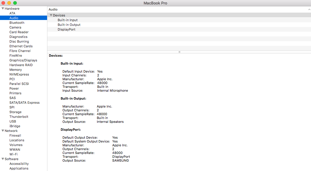

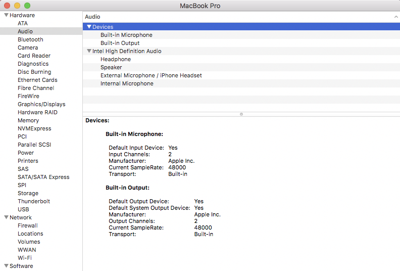

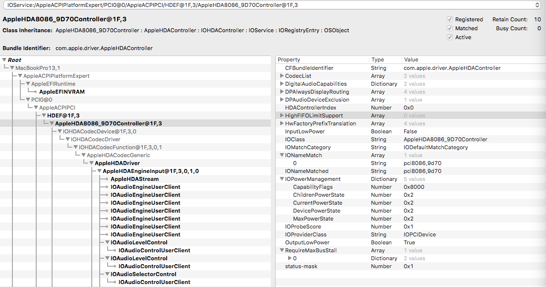

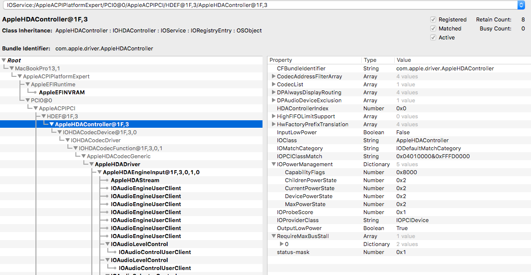

Reinekis Posted May 29, 2018 Share Posted May 29, 2018 (edited) With new generation AppleALC-1.2.6 (that only works with Lilu.kext) and High Sierra I don't have Intel High Definition Audio any more though there is a sound as expected. I attach screenshots of 10.12.6 with older AppleALC.kext (also attached) and the ones of 10.13.4 with AppleALC.kext-1.2.6 Is this normal? And what potentially could be the cause? AppleALC-working.kext.zip Edited May 29, 2018 by Reinekis Link to comment https://www.insanelymac.com/forum/topic/311293-applealc-%E2%80%94-dynamic-applehda-patching/page/86/#findComment-2615645 Share on other sites More sharing options...
MacPeet Posted May 29, 2018 Share Posted May 29, 2018 Is normal. Intel High Definition Audio is no longer displayed in High Sierra, only the devices. All good. 1 Link to comment https://www.insanelymac.com/forum/topic/311293-applealc-%E2%80%94-dynamic-applehda-patching/page/86/#findComment-2615694 Share on other sites More sharing options...
