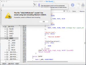

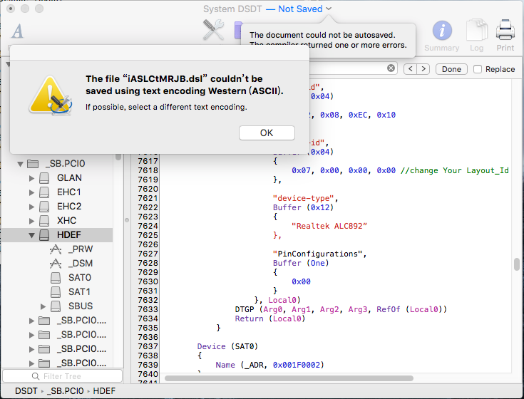

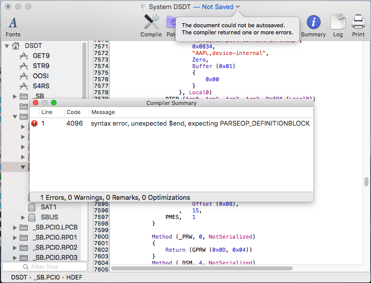

I tried to patch ALC892 by your patcher, and I followed steps in your documents to edit DSDT.
However, when I clicked "compile" ,there was a dialog as follows.
Then showed an error,code of which is '4096',so I can't edit successful.
Any solutions? Thanks!! :DD
(And sorry for my poor English....I've tried my best...)

Okay, here's my DSDT file ,and so is the screen-shot of the error dialog.
Original one:attachicon.gifDSDT_original.txt
The bug one :attachicon.gifDSDT_bug.txt
and here's the screen-shot:
Thanks :D :D
change this:
"device-type",
                    Buffer (0x12)
                        "Realtek ALC892¡¨
for this:
"device-type",
                    Buffer (0x12)
                        "Realtek ALC892"

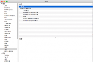

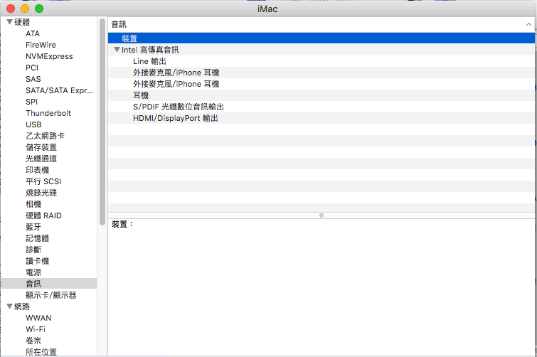

Hi,thanks for your help,but I have another wried problem…I've tried for over than 2 hours…Orz
I boot OSX with latest version of Clover by UEFI with GPT partition.
Though I've compiled passed,there's still nothing device found on OSX.

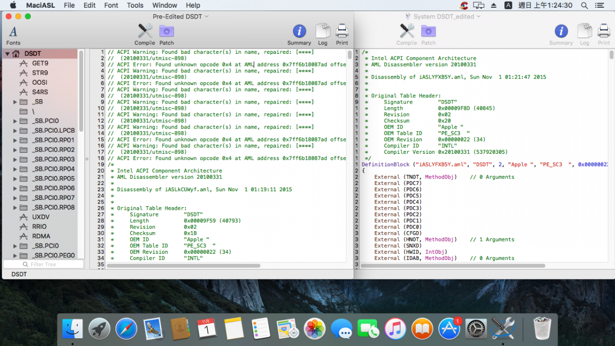

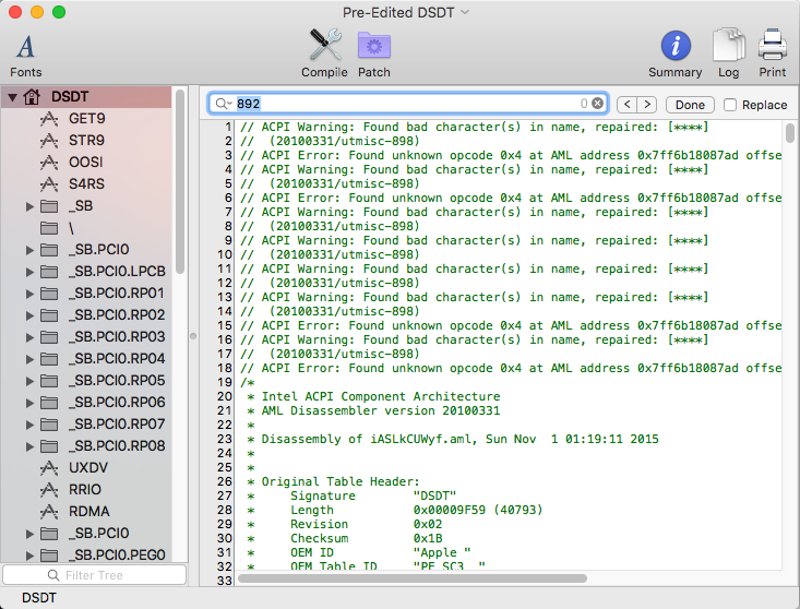

Thus, I open MaciASL ,and I find out the wried problem…please take a look at the following picture.
The left one is automatically opened by MaciASL,which is stand for the DSDT file that OS boot with;
The right one is the file under EFI parition,and the route of the file is EFI\Clover\ACPI\patched\DSDT.aml
I tried to search "892" of the left one,and nothing can be found……
Have you ever encounter this?
How to deal with it?Thanks!
I've compiled the left one,and here's the log of errors.Error log.txt
And here's the wried DSDT file grabbed by MaciASL.Wried_DSDT.txt
