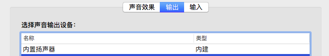

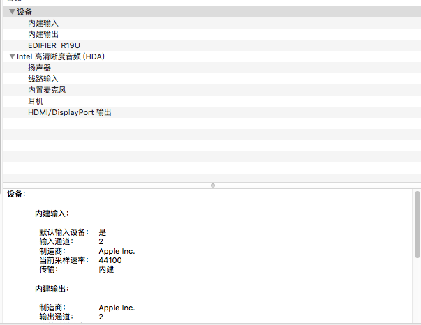

denghongcai Posted October 11, 2015 Share Posted October 11, 2015 Laptop Acer 4750, audio codec alc269vb i use vusun123's patched applehda to get internal speaker, internal mic and extern mic work perfectly. I can't get headphone work, though it detected headphone, no sound unfortunately... HDMI audio is also not work. I follow Mirone's guide to manually patch AppleHDA from a original state, but still failed. Anyone can help me? AppleHDA.kext.zip codec_dump.txt configdata+ioreg+dsdt.zip Link to comment https://www.insanelymac.com/forum/topic/306562-applehda-for-el-capitan-discussion/page/10/#findComment-2176489 Share on other sites More sharing options...

vusun123 Posted October 12, 2015 Share Posted October 12, 2015 Laptop Acer 4750, audio codec alc269vb i use vusun123's patched applehda to get internal speaker, internal mic and extern mic work perfectly. I can't get headphone work, though it detected headphone, no sound unfortunately... HDMI audio is also not work. I follow Mirone's guide to manually patch AppleHDA from a original state, but still failed. Anyone can help me? Did you patch your DSDT properly yet ? You must have patched your HPET, IRQ and RTC in order for it to work properly Link to comment https://www.insanelymac.com/forum/topic/306562-applehda-for-el-capitan-discussion/page/10/#findComment-2176680 Share on other sites More sharing options...
denghongcai Posted October 12, 2015 Share Posted October 12, 2015 I upload my dsdt.aml as attachment... I patched https://github.com/RehabMan/Laptop-DSDT-Patch HPET, IRQ and RTC all done. Strange thing is headphone can be detected by OSX, but no sound output...only internal speaker work. Link to comment https://www.insanelymac.com/forum/topic/306562-applehda-for-el-capitan-discussion/page/10/#findComment-2176681 Share on other sites More sharing options...

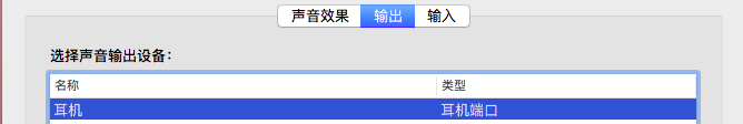

vusun123 Posted October 12, 2015 Share Posted October 12, 2015 I upload my dsdt.aml as attachment... I patched https://github.com/RehabMan/Laptop-DSDT-Patch HPET, IRQ and RTC all done. Strange thing is headphone can be detected by OSX, but no sound output...only internal speaker work. Did it switch to Headphone when you plugged in ? If so and also no sound, then the headphone node and path map must have been wrong Link to comment https://www.insanelymac.com/forum/topic/306562-applehda-for-el-capitan-discussion/page/10/#findComment-2176682 Share on other sites More sharing options...
denghongcai Posted October 12, 2015 Share Posted October 12, 2015 it switch to Headphone. I have changed the pathmap but not work. My #229 reply attachment contain the codec_dump and more information. Link to comment https://www.insanelymac.com/forum/topic/306562-applehda-for-el-capitan-discussion/page/10/#findComment-2176708 Share on other sites More sharing options...
vusun123 Posted October 12, 2015 Share Posted October 12, 2015 it switch to Headphone. I have changed the pathmap but not work. My #229 reply attachment contain the codec_dump and more information. Your verbs data: 01471c10 01471d00 01471e13 01471f90 01470c02 01871c30 01871d90 01871e81 01871f00 01b71c20 01b71d00 01b71ea0 01b71f90 02171c40 02171d10 02171e21 02171f00 Your headphone's pathmap: 33 > 12 > 2 Link to comment https://www.insanelymac.com/forum/topic/306562-applehda-for-el-capitan-discussion/page/10/#findComment-2176716 Share on other sites More sharing options...
denghongcai Posted October 12, 2015 Share Posted October 12, 2015 Unfortunately I'm using the pathmap 33 > 12 > 2 ... And the attachment also contain the AppleHDA.kext I am using.... I tried your verbs data, not work it's weird.... Link to comment https://www.insanelymac.com/forum/topic/306562-applehda-for-el-capitan-discussion/page/10/#findComment-2176756 Share on other sites More sharing options...
vusun123 Posted October 12, 2015 Share Posted October 12, 2015 Unfortunately I'm using the pathmap 33 > 12 > 2 ... And the attachment also contain the AppleHDA.kext I am using.... I tried your verbs data, not work it's weird.... Do you have Windows or Linux ? Check if your headphone port is usable Link to comment https://www.insanelymac.com/forum/topic/306562-applehda-for-el-capitan-discussion/page/10/#findComment-2176814 Share on other sites More sharing options...
denghongcai Posted October 12, 2015 Share Posted October 12, 2015 ehhhh, of course... Under Ubuntu 14.04 and Windows 10, headphone port is working perfectly... Link to comment https://www.insanelymac.com/forum/topic/306562-applehda-for-el-capitan-discussion/page/10/#findComment-2176826 Share on other sites More sharing options...
