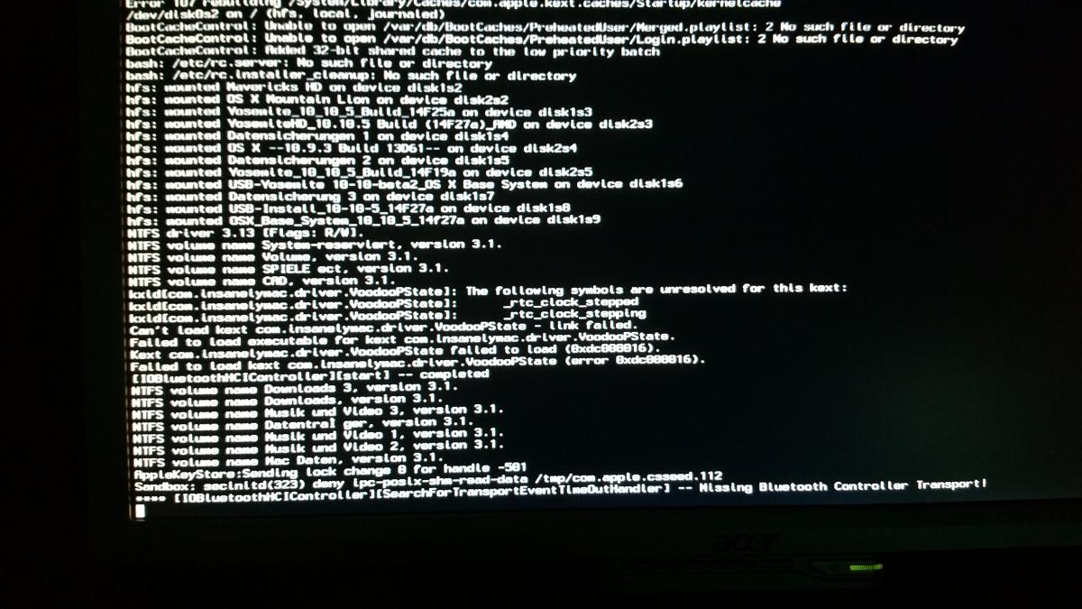

Hi folks, we need urgently a solution to the problem with Stuck on [iOBluetoothHCIController [searchForTransportEventTimeOuthandler] - Missing Bluetooth Controller transport! with Nvidia Graphics card.
otherwise it looks very bleak to make a clean install of 10.10.5 last build !! At the present time I have doubts that El Capitan will start on AMD hackintosh, unless we resolve the issue.
What I've tried so far:
  • BIOS Settings: Virtualization: [Enabled] changed to [Disabled], which did nothing
  • DSDT patched GFX0 to IGFX, that did nothing.
  • Boot -s
mount -uw /
cd /System/Library/Extensions
mkdir intel_back
mv AppleIntelHD* AppleIntelF* intel_back/
touch ../ExtensionsReboot -v
  • deleted the Nvidia Graphics drivers from /S/L/Extensions/ , that did nothing.
  • booted with nv_disable=1, which did nothing.
if anyone has any ideas to work around the problem, then report here.

I have just installed 10.10.5 on my PC - clean USB Flash installation with your kernel and replaced files from archive "package 10.10.5.zip".
I had been able to boot from USB only with kernel flags "-f -x nv_disable=1" (with other flags, of course, like kext-dev-mode=1, npci=0x2000, etc.).
Without that flags my videocard doesn't work and kernels (several for 10.10.4 and your last with 10.10.5) stuck on "[iOBluetoothHCIController [searchForTransportEventTimeOuthandler]" - Missing Bluetooth Controller transport".
I tried several days to combine parameters for video, delete AppleIntelF/H* kexts, other problematic kexts - but without success.
In safe mode with nv_disable=1 kernel have booted and I have finished 10.10.5 installation.
But even in safe mode after stage "[iOBluetoothHCIController [searchForTransportEventTimeOuthandler]" there is a pause about 5-7 minutes, after that kernel continues to boot in safe video mode.
At first start after installation during configuring OS I have had "No HPETs found" kernel panic three times and have added NullCPUPowerManagement.kext to S/L/E.
After that OS booted and I have installed NVidia Web drivers for 10.10.5. Now I am trying to combine parameters to boot OS with that drivers (with no luck for moment).

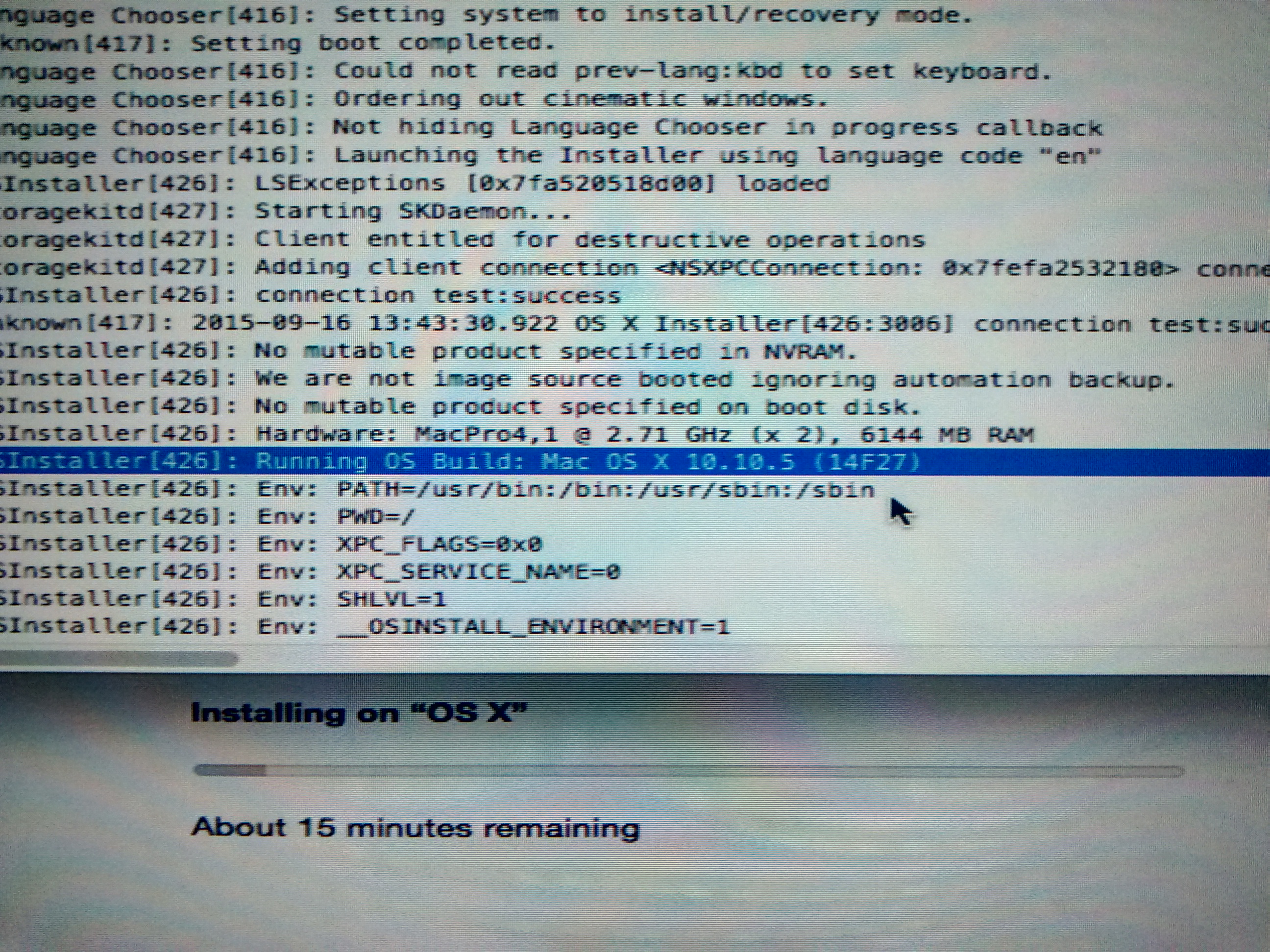

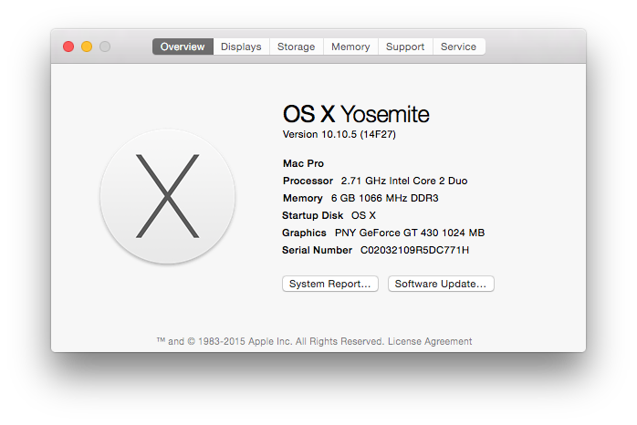

Currently installing vanilla 10.10.5 from USB using Spakk's kernel and package
Edit:
Now installed. Only changes made were files in Spakk's package and his 10.10.3 kernel and of course kexts needed for system to boot in E/E ( Didn't replace pthread.kext ;) )
