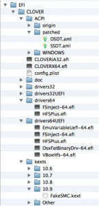

Sounds like you need to add FakeSMC.kext to /System/Library/Extensions/
you can either do that or your have your config.plist to inject kext = true or auto if you have fakeSMC installed in 10.9 folder in Kext folder.

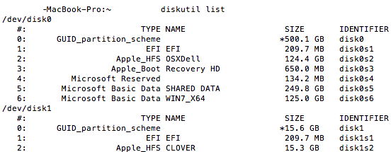

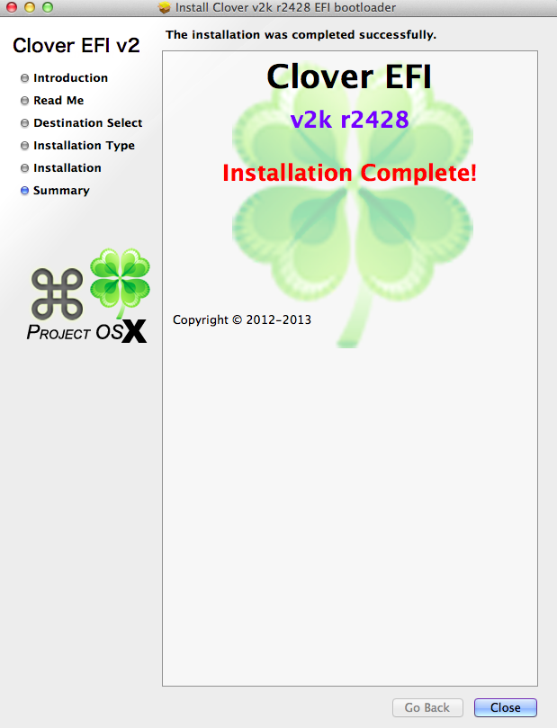

@mac09hack

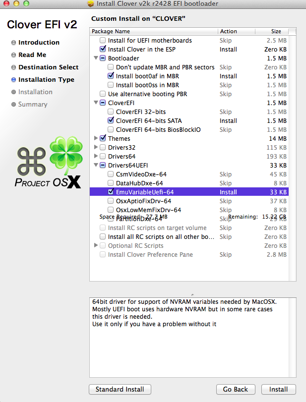

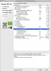

Make sure the EFI partition is unmounted and then run Clover_v2k_rxxxx.pkg targeting the HFS+ partition on the USB ie the partition "CLOVER" if following BatcOuntrY's guide.  Can you post the full output from Clover_Install_Log.txt?  If you try to run the installer while the EFI partition is mounted, you will get a failure message :wallbash: !!!

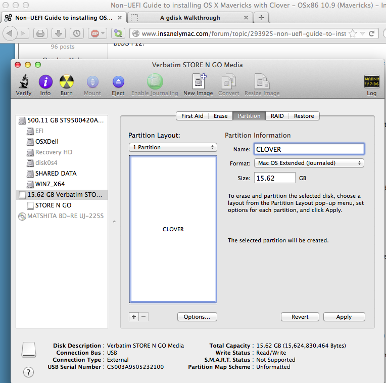

Step 1 Format the USB drive using GUID partition scheme.  NB Even though we are selecting to create 1 partition "CLOVER" only, in reality 2 are made (an EFI partition is automatically created when we choose GUID).
Step 2 in his guide is optional (no need to format the newly created EFI partition on the USB drive) - so no need to actually use terminal for the install.

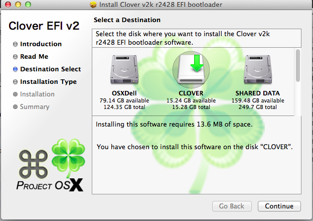

Step 3 Install Clover to the USB drive
Output from Clover_Install_Log.txt
Clover EFI installer log - Sat Jan 11 11:36:17 EST 2014
Installer version: v2k r2428 EFI bootloader
/dev/disk0
   #:                       TYPE NAME                    SIZE       IDENTIFIER
   0:      GUID_partition_scheme                        *500.1 GB   disk0
   1:                        EFI EFI                     209.7 MB   disk0s1
   2:                  Apple_HFS OSXDell                 124.4 GB   disk0s2
   3:                 Apple_Boot Recovery HD             650.0 MB   disk0s3
   4:         Microsoft Reserved                         134.2 MB   disk0s4
   5:       Microsoft Basic Data SHARED DATA             249.8 GB   disk0s5
   6:       Microsoft Basic Data WIN7_X64                125.0 GB   disk0s6
/dev/disk1
   0:      GUID_partition_scheme                        *15.6 GB    disk1
   1:                        EFI EFI                     209.7 MB   disk1s1
   2:                  Apple_HFS CLOVER                  15.3 GB    disk1s2
Backing up EFI files
Installing BootSectors/BootLoader
No Active Partition
Stage 0 - Writting boot0af to /dev/disk1
/usr/local/bin/fdisk440 -u -f /Volumes/CLOVER/usr/standalone/i386/boot0af -y /dev/disk1
Stage 1 - Writting boot1f32 to /dev/rdisk1s1
File system is Fat32.
dd if=/dev/rdisk1s1 count=1 bs=512 of=/tmp/origbs
cp /Volumes/CLOVER/usr/standalone/i386/boot1f32 /tmp/newbs
dd if=/tmp/origbs of=/tmp/newbs skip=3 seek=3 bs=1 count=87 conv=notrunc
dd if=/tmp/newbs of=/dev/rdisk1s1
Stage 2 - Written boot6 (x64) to /Volumes/ESP/boot
=========== Clover EFI Installation Finish ===========
If you're still having problems, maybe try using a different USB stick.

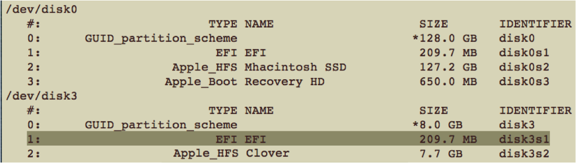

The install fails, with the log showing the output of diskutil list:
(truncated for formatting)
/dev/disk1
   0:      GUID_partition_scheme                        *8.0 GB     disk1
   1:                  Apple_HFS EFI                     209.7 MB   disk1s1
   2:                  Apple_HFS mav                     7.7 GB     disk1s2
Can't find volume with the name /Volumes/mav
