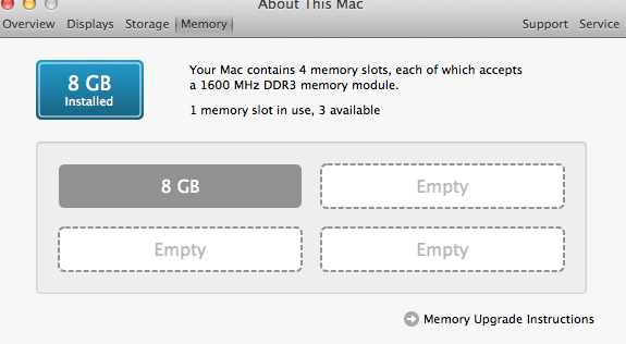

My Specs:
CPU: Xeon E3 1230v2
Ram: Corsair 8G
Main: GA-B75M-D3H
Graphics: Asus EAH 5450 SILENT/DI/1GD3
Installation steps:
  • Follow the steps here to set up bios. (Notice update 2 at the end of the post, I had many kernel panics and had to boot with safe mode (-x flag) when I’d just purchased this board and started to install Mountain Lion. Setting VT-d to disabled is the solution to it. By the way, remember set first boot to a normal boot. Do not boot with UEFI. UEFI booting works just fine on Mountain Lion but cause a lot of troubles on Mavericks. If you do UEFI booting, the system will not load the HDA kext (for sound) and AMDRadeonX3000 kext (for graphics).
  • Follow the guides here to make a boot usb (I kind of prefer making the usb myself to using apps)
  • Install the OS.
  • After the system is install I boot with the usb. I install Chameleon bootloader here (install Chimery or Clover if you prefer. In my opinion none is better. It’s simply because I’ve used Chameleon from my first time, I really don’t want to change).
  • For sound I tested the kext here and it works just fine
  • For Ethernet, thanks to Maniac10 I install the kext here and it just works fine. I don't see much of a difference in term of speed cause I have a pretty slow internet connection here (4M ADSL) but it works for me.
  • For the Graphics I follow the guide here to fix two kexts (AMD5000Controller.kext and AMDRadeonX3000.kext).
  • Restart the system and everything works like a charm.
These are two graphics kexts that I fixed and am using.
Note: After a long time the system may crash. You can fix this by update bios to f12 version. My mainboard had f14 version but I encounter many crashes all which happen when I am in the middle of work after some experiments. I downgrade to f12 and everything just works perfectly.
Some after words:
  • The machine is running very smoothly. Mavericks is much faster than Mountain Lion.
  • Safari 7 surfs web a lot faster than Firefox or Chrome, and the design is a plus, elegence and effective.
  • I use dual monitors so new features related to multi displays like menu bar and dock following in every screen is great.
  • iBooks and Maps are great. I really enjoy iBooks, looked for a good book management apps for 2 years, ever since I first used a hackintosh. I ended up with Ehon, but apparently iBooks is far a lot better. You can also buy books, which is great.
  • iCloud is working great.

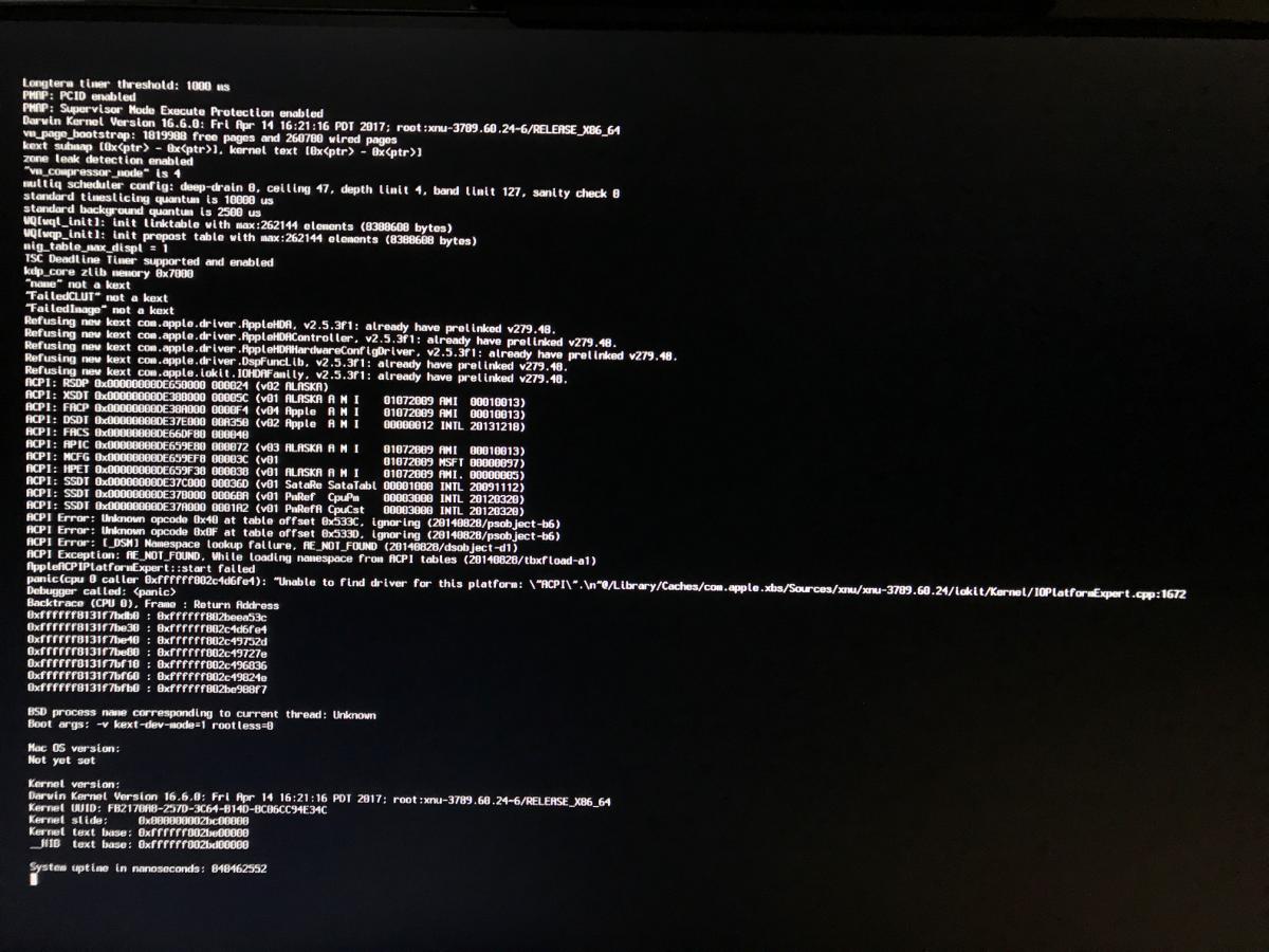

Successfully Installed Mavericks on this board with clover boot loader in uefi mode. Installed only three kext faksmc.kext, other two for audio and lan. Everything works except sleep which works when I click on sleep first time but after waking up it no longer sleep again.
Is their anyone having this issue?

Hello, I have this same board. I have everything working on Mavericks 10.9.1, but sound. It works, but I get a crackling noise and the volume goes down. I can "fix" it, by going to MIDI Setup and switching the format from 96000 to 48000khz. Weird.
I installed ALC887/888b Kext.
Anyone can point me in the right direction?

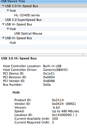

All GA-B75M-D3H Owners/Users,
Has anybody here had any luck getting USB 3.0 to work properly? I can get my USB 3.0 ports ( 2 X Integrated ont he mother board, and 4 X PCIe Card) recognize in the system report as USB 3.0 Superspeed Bus, but when I connect external drives to them they don't actually read or write at speeds above USB 2.0?
Any body here using this board and OS X 10.9+ able to get their USB 3.0 ports to achieve better than USB 2.0 speeds?
And please how did you do it?

Thanks fusion71au,
Now I have 1600MHZ memory and USB 3.0.
Feel like a real Mac.
This is my config.plist
Hi Navjot,
can you give me your dsdt file, I'm trying to install Yosemite with this board and I have some mistake so I need a dsdt file that work with a Nvidia graphics
Thanks,
Barnum

Hi,
I'm also running Sierra 10.12.5 on this board with the following config...
  • GA-B75M-D3H Bios F15 (tried with F11 as well and got the same result, didn't try F12)
  • i5-3570K
  • 8GB 1600Mhz RAM
  • Corsair SSD
  • Nvidia GTX650
  • Using iMac13,2
  • Clover 4091
I only don't have sleep. I've dealt with HDMI Audio using HDMIAudio.kext injected via Clover, along with LAN and FakeSMC kexts. When I choose Sleep from the apple menu, display sleeps, but the computer stays all awake. It comes back all working when I press a key, so essentially it doesn't sleep at all.
I also used PikerAlpha's ssdtPRgen.sh script to generate an SSDT.aml, but I guess it wasn't really necessary with this board as it did change nothing. Speedstep is working with or without the SSDT.
To fix it, I tried applying Pjalm's patch for the motherboard, but whether I apply a graphics patch (4000) after MB or not, I get error when trying to boot with the DSDT installed. It just panics at the beginning of boot and the last line before KP is about "AppleACPIPlatformExpert::start failed." and "Unable to find driver for this platform"...
Any ideas?
