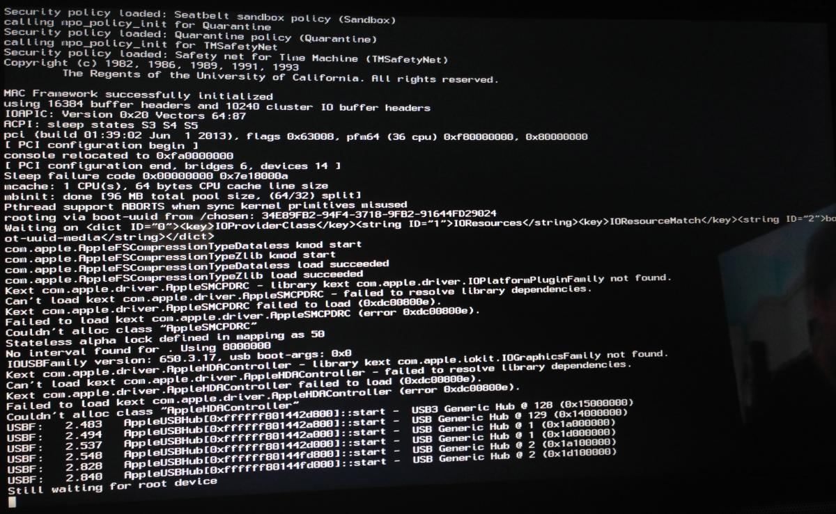

RocketSledder77 Posted June 30, 2013 Share Posted June 30, 2013 No luck, I keep getting the "Still waiting for Root Device" message. Is there any way to do this when you only have USB 3.0 ports. Will a USB 2.0 hub plugged into my USB 3.0 port work? Link to comment https://www.insanelymac.com/forum/topic/289883-hp-laptop-dv6-6xxx-dv7-6xxx-os-x-109-mavericks-and-1010-yosemite/#findComment-1929035 Share on other sites More sharing options...
Dec_Bra1n Posted June 30, 2013 Author Share Posted June 30, 2013 No luck, I keep getting the "Still waiting for Root Device" message. Is there any way to do this when you only have USB 3.0 ports. Will a USB 2.0 hub plugged into my USB 3.0 port work? Post your Extra Folder and delete files From your USB/System/Library/Extensions & most important For installation use USB 2 port instead of USB 3 Port NVDAGF100Hal.kext. NVDAGK100Hal.kext NVDANV50Hal.kext NVDAResman.kext NVDAStartup.kext NVSMU.kext Link to comment https://www.insanelymac.com/forum/topic/289883-hp-laptop-dv6-6xxx-dv7-6xxx-os-x-109-mavericks-and-1010-yosemite/#findComment-1929075 Share on other sites More sharing options...
RocketSledder77 Posted June 30, 2013 Share Posted June 30, 2013 I followed the directions and still getting the "Waiting for root device" message. Is there a way to do this with USB 3.0 only or will it work if I use a USB 2.0 hub with my USB 3.0 port? Link to comment https://www.insanelymac.com/forum/topic/289883-hp-laptop-dv6-6xxx-dv7-6xxx-os-x-109-mavericks-and-1010-yosemite/#findComment-1929076 Share on other sites More sharing options...

Dec_Bra1n Posted October 25, 2013 Author Share Posted October 25, 2013 I followed the directions and still getting the "Waiting for root device" message. Is there a way to do this with USB 3.0 only or will it work if I use a USB 2.0 hub with my USB 3.0 port? Dude there is one another method of installer USB/DVD creating called as Pandora see at downloads u can make DVD from Pandora and try use genericUSBXHCI latest version and AHCI patch it worked for me Hp Envy 6 1070el It works on HP DV6/DV7 too but after installing not before Link to comment https://www.insanelymac.com/forum/topic/289883-hp-laptop-dv6-6xxx-dv7-6xxx-os-x-109-mavericks-and-1010-yosemite/#findComment-1958060 Share on other sites More sharing options...
