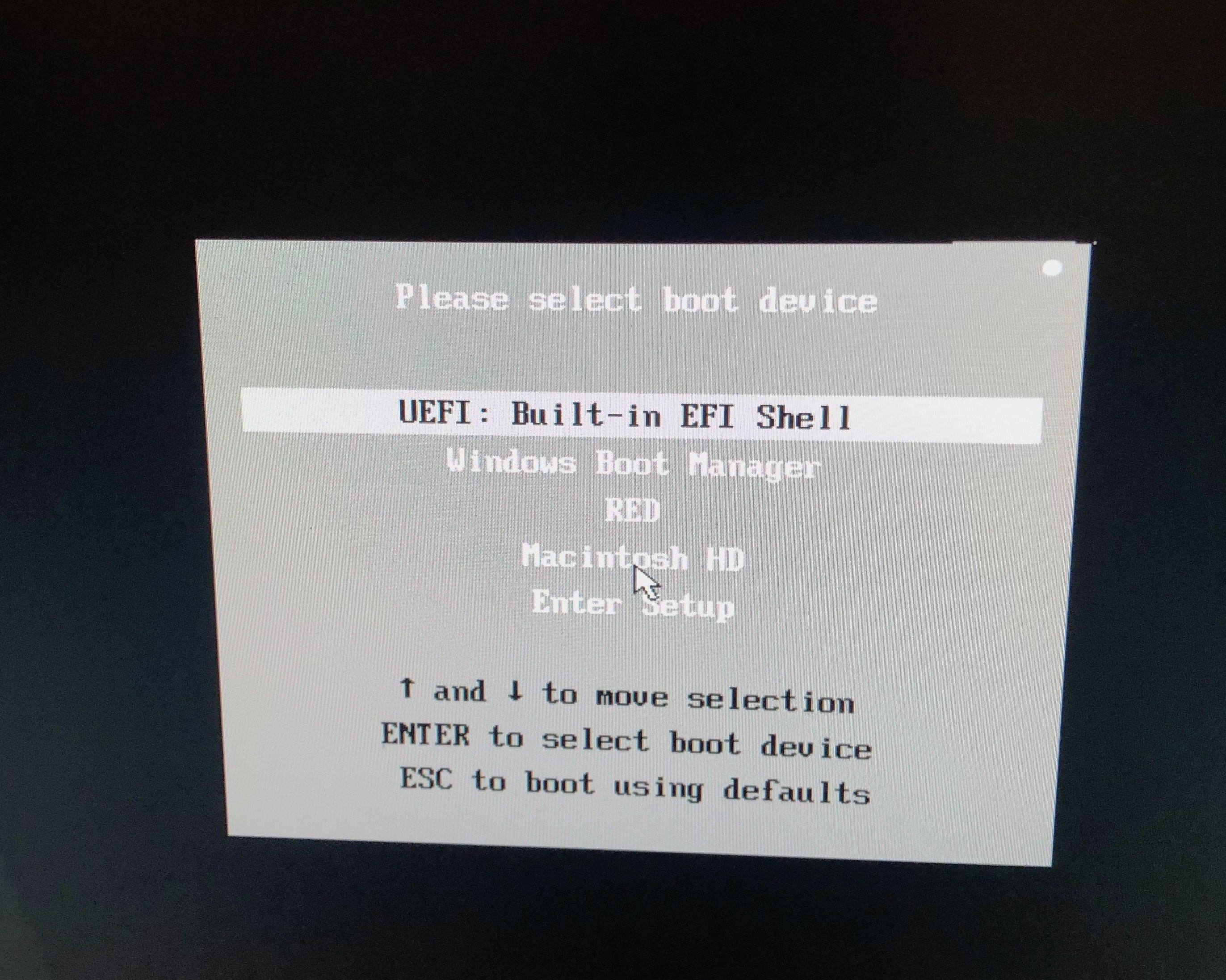

Here is what i get with F12:
RED is the 10.12.6 clone- and the same name as the original volume that has always booted just fine (but now also wont boot).

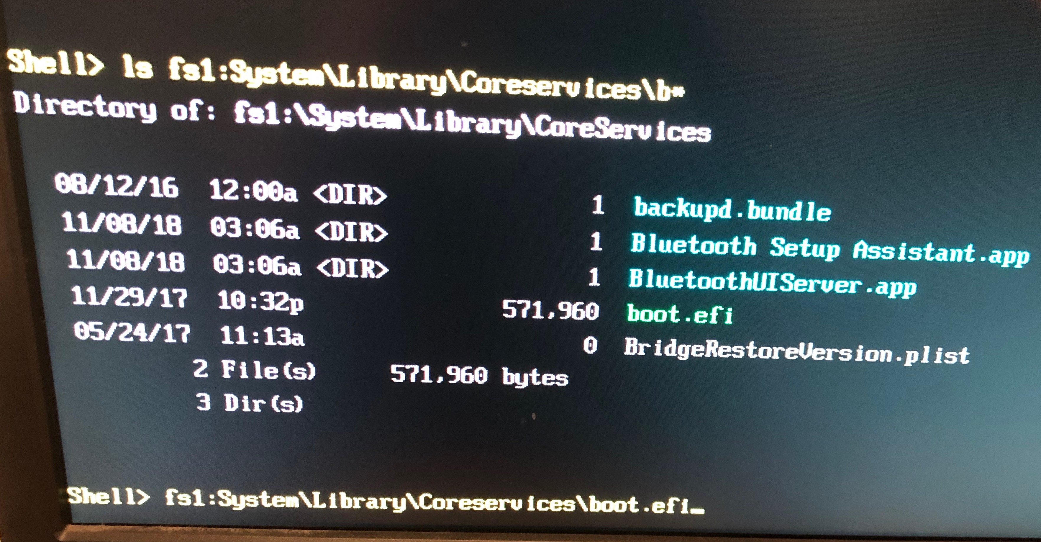

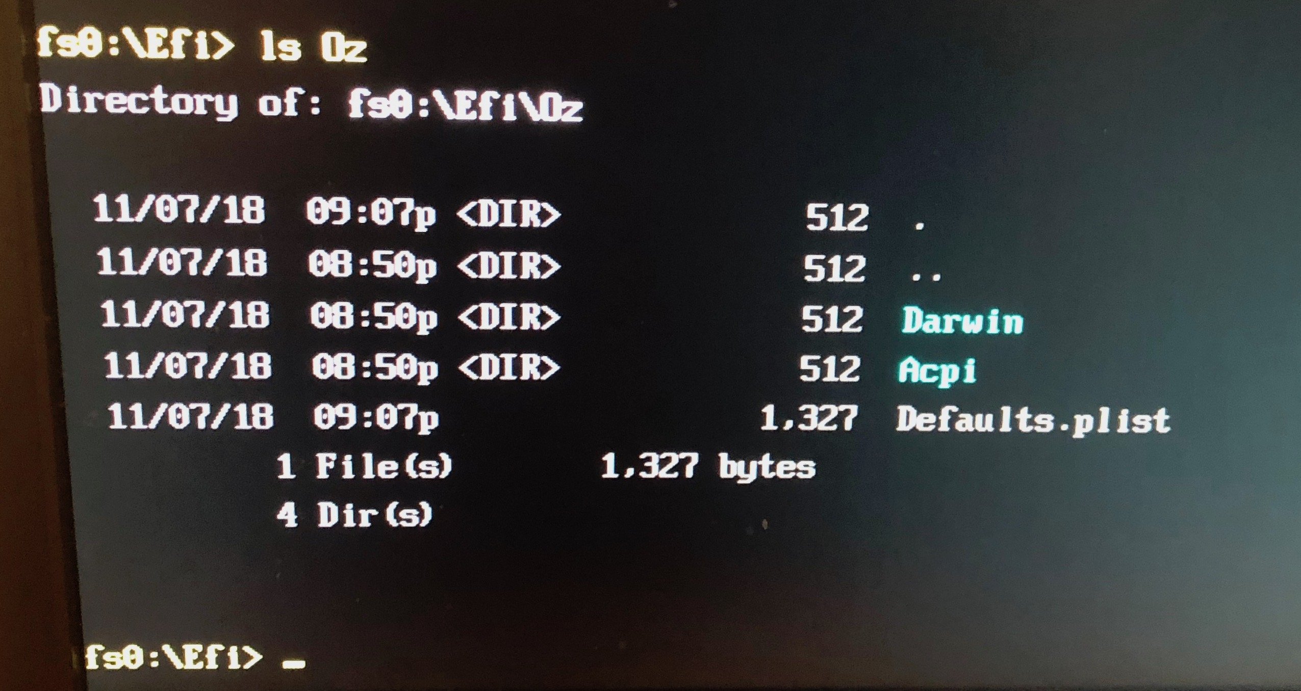

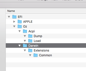

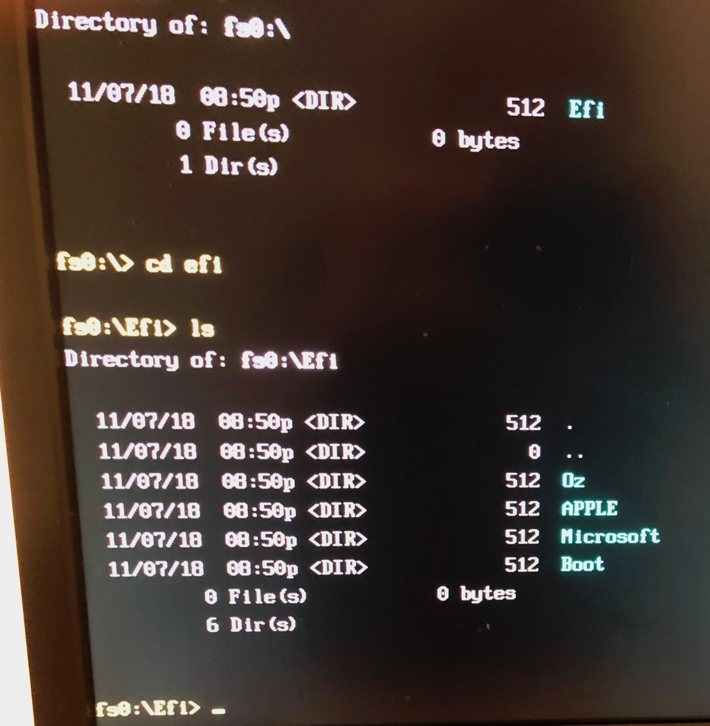

And here is what i see when entering the shell:
I can get into the EFI and OZ folders just fine, and see my defaults.plist in place- though i don't know why i would need one just to boot into 10.12.6 now (I have yet to start the OS updates).
IMG_4474.thumb.JPG.cbf91afba9a1b6032e6c4c72761e49ae.JPGIMG_4475.thumb.JPG.c1fa74fa6a84a9cb3d59320519771865.JPG
Finally, if i try loading boot.efi manually from the shell i also get the same result.
Instant "NO!" as though it does not even try to load.

Totally, if Defaults.plist is rejected, the SMBIOS info is not updated and it will take the value in BIOS which is a MacPro3,1 ... on which you cannot install Your desired OS, hence the no-no sign

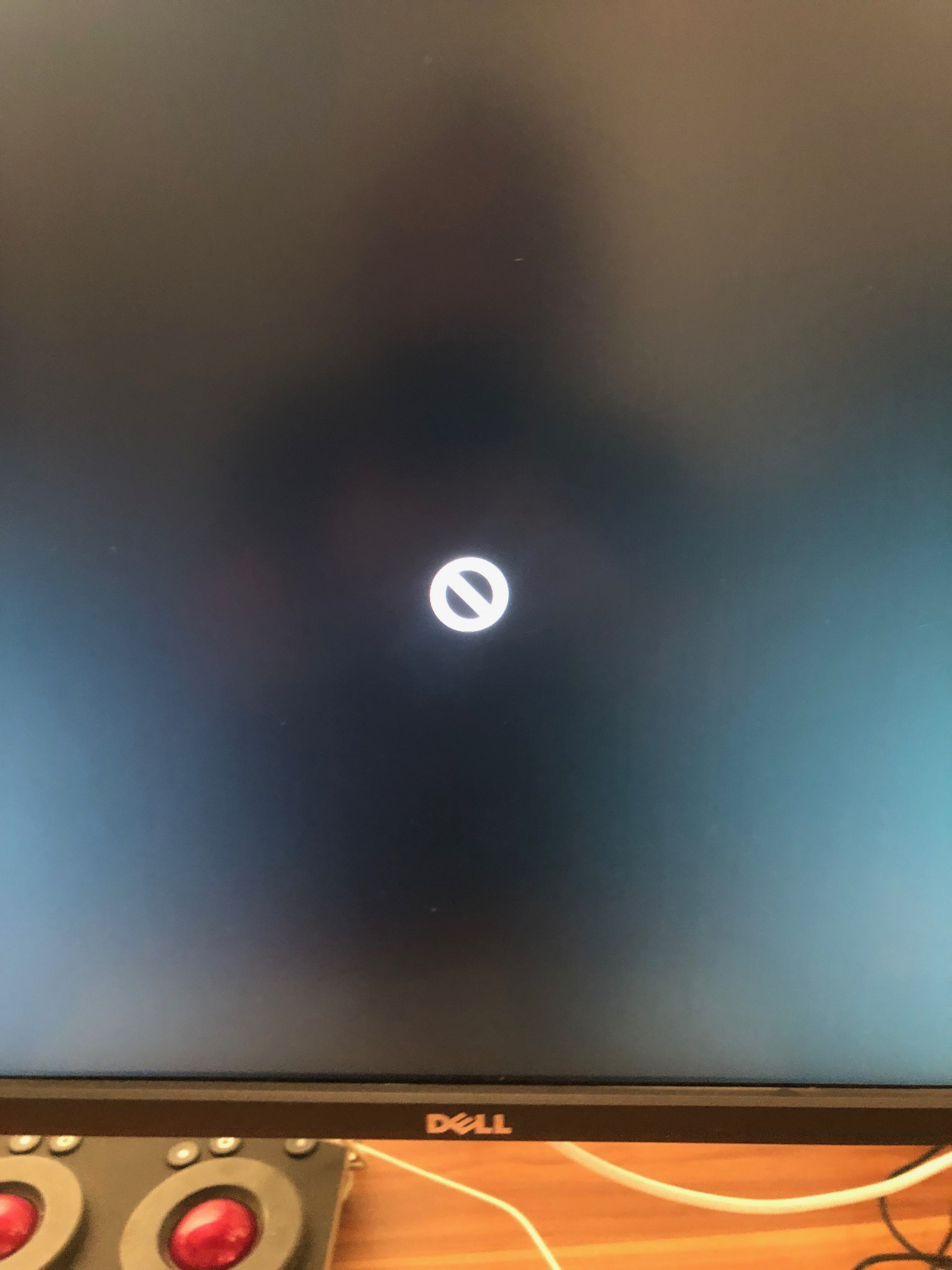

I have an issue that might be connected to this.
My Quo worked fine with Mojave and the first update. Now yesterday I tried to install the 10.14.1 Update and it rendered my Computer useless.
I even deleted everything from HD and tried a clean fresh install, similar to what has been discussed here several times.
Only one HD is connected to make sure I only have the one EFI Partition in System.
The new Ozmosis-generated default.plist sits in the Oz directory.
Reflashed xmax bios.
cleared NVRAM.
when I try to run installer from USB key I get the nice Nono-image shown.
Obviously something changed with that update huh?
attached is the oz generated plist.
any idea?

The Prohibition sign is a sure sign that your Defaults.plist is rejected.

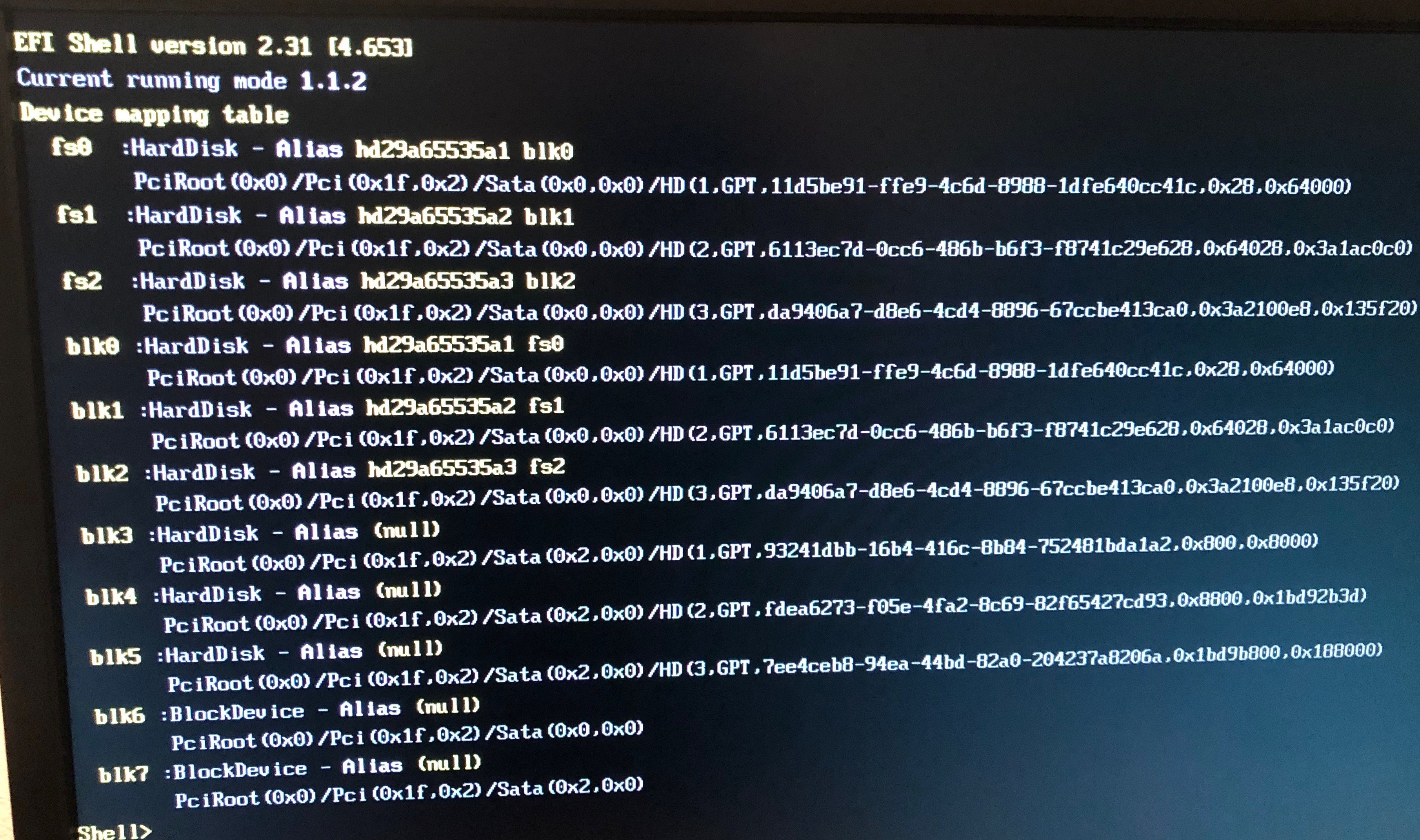

Hi there!
I have tried UEFI shell
The systems appears to be in fs1
and the EFI on fs3
but again all folders are empty.
Where I cant look now?
where the defaults.plist file mus be located?
Thank you al lot (again!)
