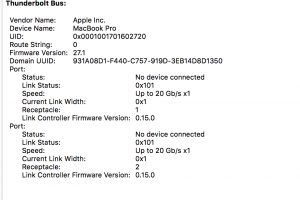

Anyone got Thunderbolt working on the Quo?
In System Information, mine says: "Thunderbolt: No Hardware Found."
My MacPro2008 say "Thunderbolt: No Drivers are Loaded" which is fair enough considering it's 2008.
I'm using Z77MXQUOAOS.H2O.167X-MASS.SIERRA.MacMini.ROM with 10.11.5 and upgraded to 10.2.4 no probs.
Can someone please provided their TB firmware settings and anything else that's needed to enable TB, as I'd really like to use TCP/IP over TB with this mobo.
ta.

Hi,
ta.

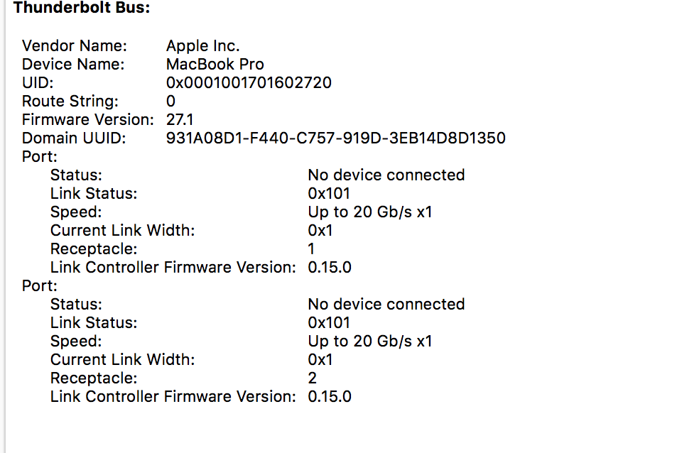

Thunderbolt is working over here. Working ever since I built the machine a couple years ago. Here are my Thunderbolt settings...
