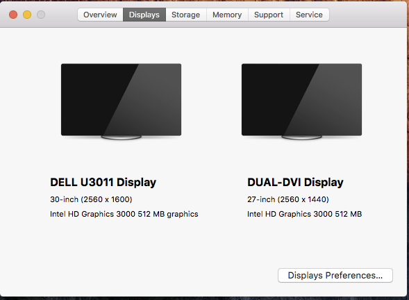

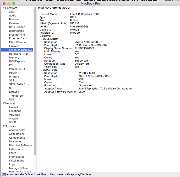

@tluck - I think I am getting closer to narrowing this down. It's not the app store install or 12/19 fixes that break the second DP port. That was just coincidental timing. Here is the sequence:
  • UEFI Boot from USB for install - both monitors working on each DP port on the docking station for the complete install process
  • UEFI Boot from USB for post install then select Macintosh HD - both monitors working on each DP port on the docking station
  • Install Clover 3320, copy \Boot and \Clover from the \420 directory, remove USB installer and reboot
  • UEFI Boot from Macintosh HD - only one monitor working on one DP port on the docking station
So something environmental changes from the USB boot to the Macintosh HD boot. So how to replicate the USB setting to the hard drive so that the second DP port works?
@149113 - hmm. weird. so now after all that if you boot from usb you will get 2 monitors?
on step 3 install clover - i presume you are using UEFI install in ESP and then the same config.plist that is on the USB to the HD?
i cant figure out how the boot method USB vs HD would effect the display. when you have 2 external monitors is lid open?
the config.plist from my zip contains an edit on the buffers - did you remove that? is the USB config.plist exactly the same as the config.plist on the HD?
@tluck - If I boot from the USB into the installer... both monitors work. Boot from USB and select Macintosh HD... only one monitor works. So I am guessing we are back to kext differences?
My Clover install was to the ESP using the exact settings you had in the screen shot. Laptop is always closed and in the docking station.
My config.plist is the same with the buffers section intact:

I'm gonna continue to mess around with it to see if I can figure it out. It is working well on the one monitor and had I not seen it working on two I would not have assumed it possible. Attached my clover bootlog file. Don't know it that's helpful.
bootlog.log.txt
@149113
well now that makes some sense to me - the OS installer uses a generic graphics driver. where as the final OS will use the SandyBridge HD 3000 driver.
so if you remove the config.plist kext patch ( no need VGA)  (use vi and change the AppleIntel to D:AppleIntel) you can test what ports are live on your dock by default. DP on the side of the box and DP on the dock should be working OOTB.  then it may be a matter of getting the 2nd DP on the dock wired in.
in case you haven't a tool already, to modify the this kext patch in the plist file ( data is encoded from text), you can search download PlistEdit Pro. of course their are others but this is pretty easy to manage.
@tluck - doing nothing more than removing the AppleIntelSNBGraphicsFB setting in the config.plist file, the second monitor now works and looks good. I used Clover Configurator and simply deleted that entry, saved the file and rebooted. Here is the new boot.log file for Clover. I guess it's fixed now.
bootlog.log.txt
@tluck Updated to your last config files. Everything works like a charm. Thnx!
