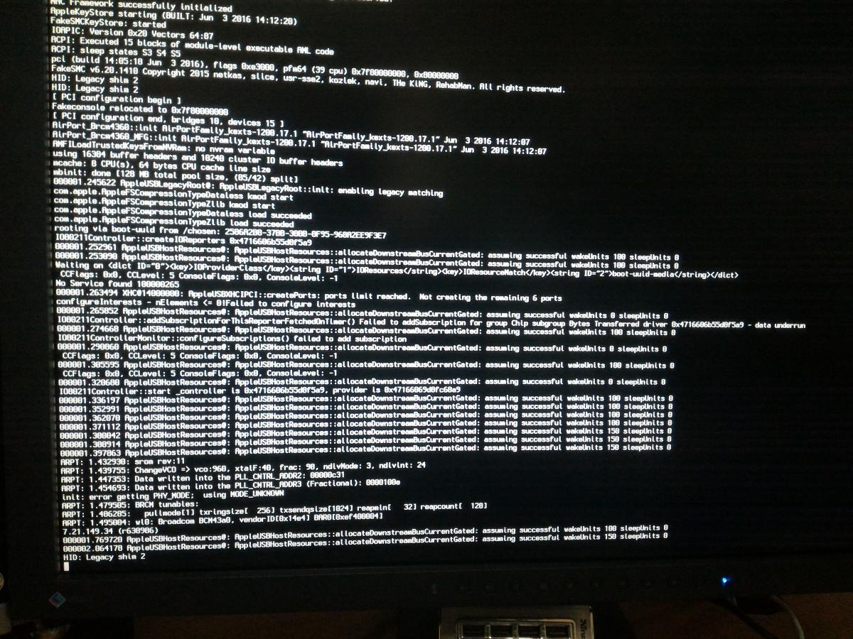

Hello Slice,
I have EX58-UD5 and use "PBR" and Clover EFi 64bits BiosBlockIO, because i don't have UEFI...
My experiences with the latest Clover boot updates :
Clover r 3551 is ok for me for OSX 10.11.5,  but Clover versions > 3551 don'work !
Clover r3661 is ok for me for OSX 10.12, but Clover versions > 3561 don'work !
Why is this ?
Do you believe I could have better results with "PBRsata" option and do I have to change to Clover EFi 64bits SATA in the same time?
Thank you for your advice

CloverEFi (boot6, boot7) lives own life other then CloverGUI (CloverX64.efi). "PBRsata" is a part of CloverX64.efi.
HID = Human Interface Device (?)
Shim = old API
Are you using some old kexts like ApplePS2Controller (or some trackpad kexts)? Not sure but try to boot with no those kexts if any, and unplug everything (also the mouse/keyboard).... just to make a test..
Otherwise if means "_HID" ... ACPI problem with your DSDT.. and need a GURU
