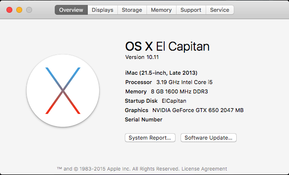

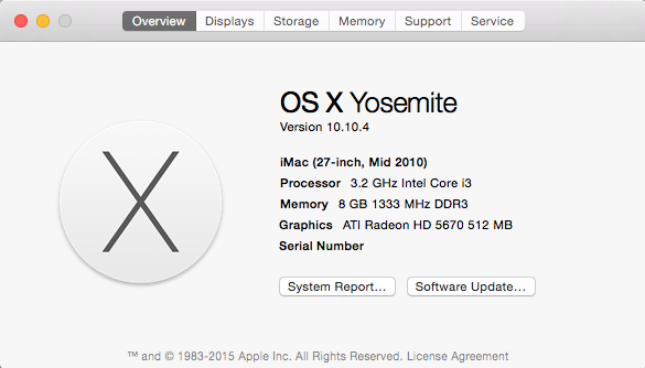

Hey guys.
I know this is a cosmetic thing, but it looks like it might be an issue with Clover.
There is a rounding issue when it comes to the detected amount of VRAM and the CPU speed. They are both less by exactly 1 (MB for the VRAM, GHz for the CPU), compared to what they should be. If you forcefully inject the amount of VRAM in device-properties for example, it will show you 2048 MB for the video card. And I suppose there is a way to force the CPU to show 3.2 GHz instead of 3.19, as well. But that's not the point. The point is for the automatic detection to work on its own. And it doesn't seem to be the case here. Please, correct me if I'm wrong.
Below you can see a comparison between what I got on my computer, running Clover, and what it is on a real Mac (in this case it's an iMac 27" mid 2010, running Yosemite).

Hey guys.
Also, any idea how to get rid of this "ghost" volume in Clover UI? I made a mistake and launched the installer for OS X El Capitan from another partition, instead of running it from Applications. And although the installer app is neither in Applications, nor on the initial partition (since I removed it from both places), I have no idea where is this still coming from.

Hey guys.
I remember I had this issue before and there was something under the El Capitan partition. But if it's there, I couldn't find it. Any idea? It's not a big issue. But it's annoying when you don't know what's causing it.

The 2047MB thing is caused the NVIDIA drivers IIRC. You can see in bdmesg how Clover detects your hardware (post it here if you want to help solve the issue). Also, look for .IABootFiles (and some file, don't remember exactly ATM) in the root of your drive and delete them if they're present.
Uninstalling the Nvidia drivers seems to have fixed the Graphics issue (VRAM is now 2048). Still, weird that this happens with Nvidia drivers installed but not applied.

This is your issue:
6:928  0:000  Finally: Bus=99768kHz CPU=3193MHz
For whatever reason, your base clock (BCLK) is 99.768 MHz. Multiply this by your main CPU multiplier (which, in this case, is 32x), and you get 3.193576 GHz, which is rounded to 3.19 GHz. Try setting the base clock in your BIOS to 100.05, as suggested by Piker-Alpha. This should give the correct 3.20 GHz frequency.

Right. It is indeed set to 99.78-79MHz in EUFI Bios. But I couldn't find a way to change that. Is there? Can I do that on a non-k cpu? And why is the frequency still 3.2 GHz in Windows? :))
Also, I do remember not having this issue with older versions of Clover in early stages of Yosemite (don't remember which version I was running back then). Really old one, for sure.
So yes, a rounding issue. But it doesn't happen with Windows, and it didn't happen with older (really old) versions of Clover.

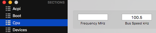

Hi Pike
If you're talking about this setting here
then yes, there is.

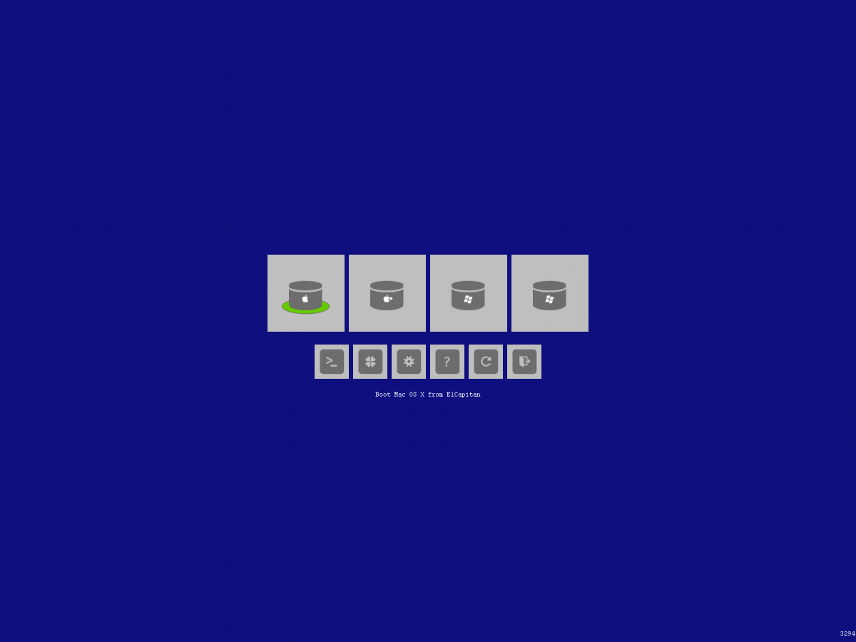

BUT, setting that to 100.5 (KHz) results in the following misbehaviors:
1. unbootable system (system hangs on first stage boot)
2. Clover UI and first stage booting displayed at higher than normal resolution (1600x1200 when it should be 1440x900)
3. THIS beautiful blue screen reminding me of the early ages of Windows XP.
You can input 3200 as your CPU frequency in MHz, and that will force it to display 3.2 GHz instead of 3.19.
But, as I said, I'm more interested to understand why doesn't it do that, on its own, rather than me tweaking/forcing it to display a certain value.

Yep, something like this fixes Clover mis-reporting...
    <key>CPU</key>
    <dict>
        <key>BusSpeedkHz</key>
        <integer>100000</integer>
    </dict>
The biggest problem here is user dependency on "Clover Configuator". Nice tool but not a Clover dev supported tool. Suggest you research problems here:  http://clover-wiki.zetam.org/Home, http://www.insanelymac.com/forum/topic/304530-clover-change-explanations/, and http://www.insanelymac.com/forum/topic/284656-clover-general-discussion/page-434

Ok, please, ignore my previous post. I set the bus speed in MHz, instead of KHz. My bad.
Yeah, setting it to 100,000 KHz or setting the CPU frequency to 3200 MHz will show 3.2 GHz in About This Mac.
But...why do we have to do this manually? I don't remember messing with this stuff before. I might be wrong though.
Update: apparently setting that to 100,000 KHz affects performance. In YouTube, for example, the audio starts stuttering after about a few minutes of playback (with Safari and Flash player installed).

How do I set that value? Can it be set on non-k cpus?
If it's not a Clover issue, then where is the issue? If you say CPU, then why, with the same CPU and motherboard, I get correct/appropriate readings in Windows (haven't tried Ubuntu yet) and (althogh I can't remember the exact version number) with that older version of Clover? Was it a bug then? Is it a bug now? This is what I'm trying to understand.
And yes, as I said, changing the bus speed in config leads to some issues im.YouTube. If you only set the frequency (3200 in my case), the issue is gone and the displayed value is also 3.2 GHz.

There are settings in Clover config.plist
	<key>CPU</key>
	<dict>
		<key>#BusSpeedkHz</key>
		<integer>133330</integer>
		<key>#FrequencyMHz</key>
		<integer>3140</integer>
BusSpeedkHz will set Bus Speed and tell to kernel FSBFrequency.
	if (DTLookupEntry(0, "/efi/platform", &entry) != kSuccess) {
		kprintf("EFI_FSB_frequency: didn't find /efi/platform\n");
		return 0;
	if (DTGetProperty(entry,FSB_Frequency_prop,&value,&size) != kSuccess) {
		kprintf("EFI_FSB_frequency: property %s not found\n",
			FSB_Frequency_prop);
		return 0;
Clover calculated value for me 99790. DO NOT ROUND IT!!! It is correct value. It is more correct value then 100000!
It is checked and proved. Clover calculate the value with good precision, much more precise then you think.
Changing the value will affect Clock, Sound and other system behavior.
FrequencyMHz is a value to be written into DMI and affect only on AboutMac with System Profiler to show CPU Speed. It is safe to write here all you want.
PS. CloverConfigurator tends to write something here. This is bad!
Open the final config.plist with TextEditor and erase the lines with BusSpeedkHz to be not having this value.
Or place # at the key as in my example.
