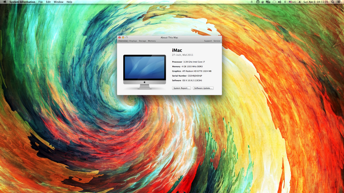

i just saw that : http://www.osx86.net...ntain_lion.html
according to the testimonies, it works well!
I also have a HD6770 I flashed into HD5770, but I didn't have time to try it!
I will do it in a few minutes!
Tell me if it works for you!
Good luck !
EDIT: i can confirm it, with the last Chameleon-2.1svn-r2054.pkg, it work well on 10.8.2 Build 12C43 !!! :thumbsup_anim:
No more need to flashing HD 6770 into HD 5770 to have QE/CI !!!
So just add your ID (0x68BA1002) into ATI5000Controller.kext, ATI6000Controller.kext and AMDRadeonAccelerator.kext

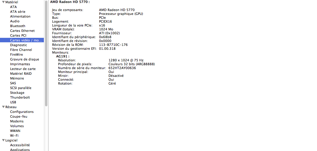

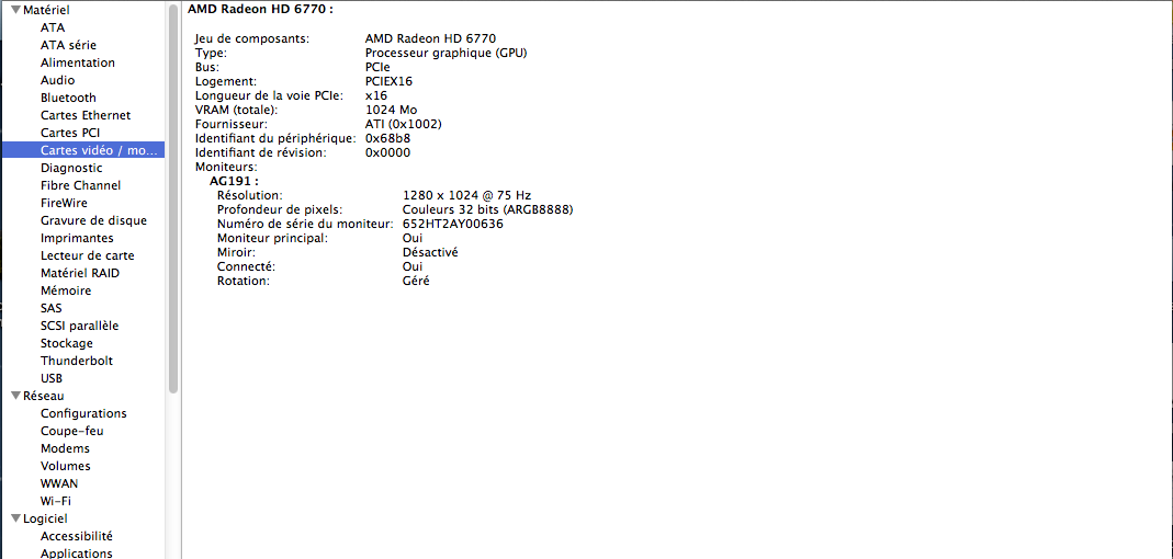

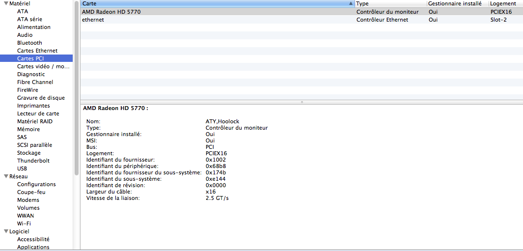

pfff, finally I did it :weight_lift:

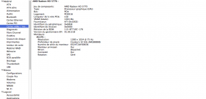

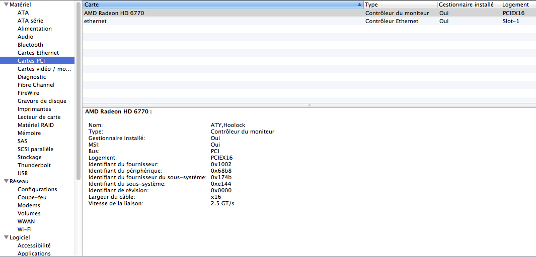

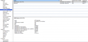

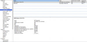

Attached File  Capture d’écran 2013-03-22 11.42.38.png   83.33KB   74 downloads Attached File  Capture d’écran 2013-03-22 11.42.54.png   83.93KB   85 downloads
HD 6770 with HD 5770 ID :P In this example, I think changing HD 6770 to HD 5770 is only cosmetic :)
Attached File  Capture d’écran 2013-03-22 13.33.56.png   83.03KB   72 downloads Attached File  Capture d’écran 2013-03-22 13.34.08.png   85.9KB   50 downloads
I don't think so
GraphicsEnabler injects the info of your graphics card but for this one, it isn't enough
the DSDT method doesn't works, this is the only way to get this card work (as hd6770) under ML
at the same time, it's not so hard to put your ID into the Info.plist, it takes 2 minutes -_-
