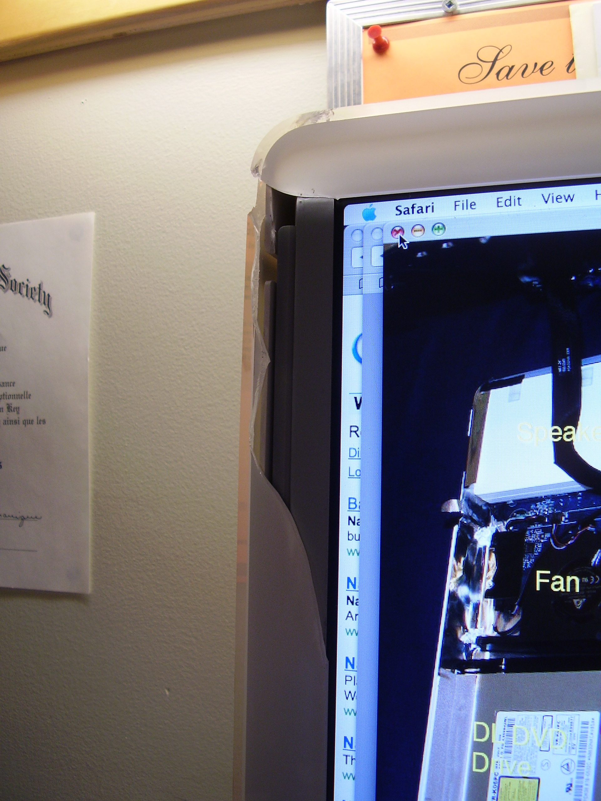

I'm hoping someone can help me out. Im afraid that during some holiday travels my 24" imac took a bit of a hit while in the custody of baggage handlers. ...too big for carry-on, and I needed to take it with me, so into the check luggage it went. anyways, the upper left edge got a bit bashed and though is was in a suitably-sized iLugger, the case cracked and one piece broke of as shown in the pic.
Much to my relief, it seemed that everything was working just fine despite this damage. But now that I have returned home from the holidays, I find that I no longer seem to be able to share my internet through my airport card. My laptop detects the signal until I try to connect to it, a which point it says the signal is gone...
I'm wondering where within the 24" iMac the wireless antenna is located? If it's along the edge(s) of the case, it may have been damaged after all.
Thanks to anyone with info or ideas.
Question number one. Get the upgrade from Apple. It's cheap and worth it.
Question number two. The module is about the size of an iPode nano screen and is located on the bottom right hand side of the iMac. Very easy to get to. Also the plastic is very easy to change as well.

Hey folks, great topic.
wow, that sucks. i would take action against the airline, those are expensive as hell. as 4 the wireless antenna, i think it is in da middle
