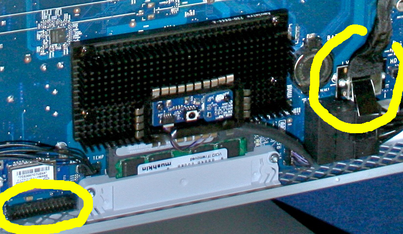

lev Posted October 6, 2006 Share Posted October 6, 2006 So I guess one is for power and one for the video input. Were you able to identify the shape of the video input connector??? lev Link to comment Share on other sites More sharing options...
Don Luca Posted October 6, 2006 Share Posted October 6, 2006 Oh my... this is really interesting!!! Calson, if you manage to discover what kind of video input the 24" has, we can hook a TV-Box and trnasform our Mac in a Multimedia Center! And it would be great! Link to comment Share on other sites More sharing options...
Caslon Posted October 6, 2006 Author Share Posted October 6, 2006 The connector is very much like an IDE hard drive connector, just not as big. That's funny Don Lucha. I have no idea why anyone would mess with the display. You can already hook it up via the Mini DVI connector. Besides, I would use a Mac Mini for my media center, not an iMac. Link to comment Share on other sites More sharing options...

lev Posted October 9, 2006 Share Posted October 9, 2006 Sorry to be a pain in the a$$ ;-) but are there any news on the display-connector-front? Do you recall the shape or have some fotos you did not post so far? thanks, lev Link to comment Share on other sites More sharing options...

Caslon Posted October 19, 2006 Author Share Posted October 19, 2006 !!!!!!!!!!!!!!!!!!!!!!!!!! Update !!!!!!!!!!!!!!!!!!!!!!!! Well, the 7900 card I tried was really a 6800. It did not work. I just tried a 7800 and it's a type III card and physically will not work with the iMac 24. My only conclusion is that it Mac cards or nothing. I'm done trying. That makes 4 different cards that don't work. Link to comment Share on other sites More sharing options...
lev Posted October 19, 2006 Share Posted October 19, 2006 That's really a pity. I would have liked a 7900 in an iMac. But thanks a lot for trying. Honestly. I don't know if I would have had the courage to open my iMac. By the way, did you get another glimps at the internal display-connector? Cheers, Lev Link to comment Share on other sites More sharing options...
Caslon Posted October 20, 2006 Author Share Posted October 20, 2006 Here is a pic of the two connectors for the LCD panel. Link to comment Share on other sites More sharing options...
aberracus Posted October 20, 2006 Share Posted October 20, 2006 Caslon How come that you have so many macs and you open them and mess with them.. you do testing for living? Link to comment Share on other sites More sharing options...
lev Posted October 20, 2006 Share Posted October 20, 2006 Thanks a lot Caslon!!! I was waiting for such a picture. Now, does anyone recognize the type of connector? I suppose one is for power and one for the video-in signal... Come on. We are close to keeping that beautiful display once the iMac itself has to retire... :-) Anyone have any knowledge on TFT-Displays? Link to comment Share on other sites More sharing options...
hersato Posted October 20, 2006 Share Posted October 20, 2006 Thanks Caslon, for nice pictures, but where is the power supply ?. Link to comment Share on other sites More sharing options...
