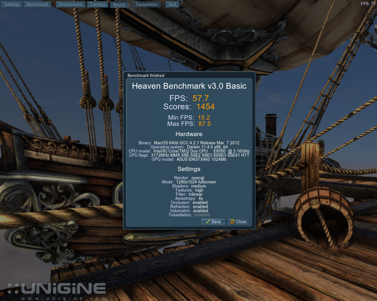

I'm getting around 4300 here at 1280x1024 - GTX 460, 10.7.3 with the new nvidia drivers, MacPro3,1 identifier - which means no AGPM.kext loaded.

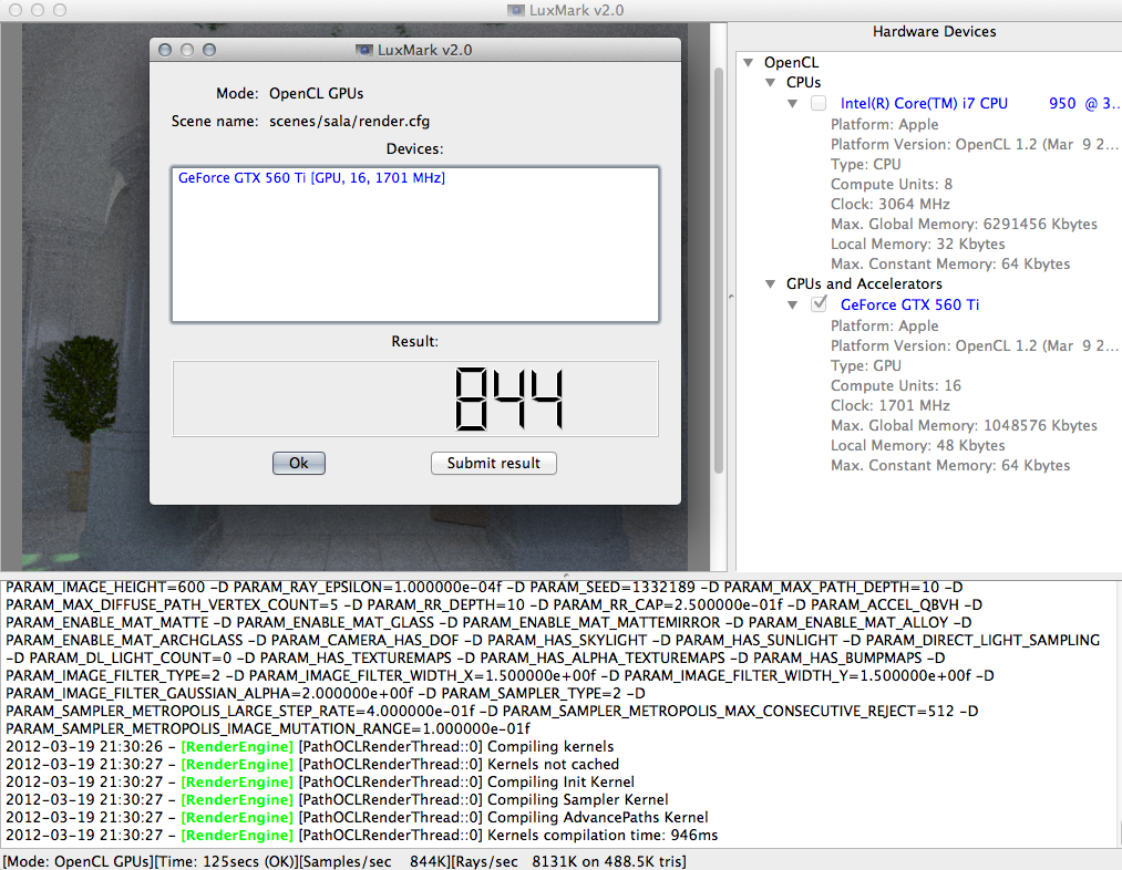

so, i was going to test dp2 on my hackintosh with the gtx 560 ti and it even reached the installer ui (didn't manage that with dp1), but the installation process immediately crashes, b/c it fails to compile lots of coreimage opencl kernels (bad design decision to fail to install because of that, apple).
not sure yet how i'll manage to fix that, since there is no geforcegldriver.bundle to patch ... maybe scrape it together from the installer packages?
also, according to the latest xcode 4.4 preview, 10.8 should have opencl 1.2 support now.
edit:
copied/extracted GeForceGLDriver.bundle from Packages/Essentials.pkg, patched it and installation went fine. dp2 is running well so far, too.
and there is indeed partial opencl 1.2 support:

gl driver has been updated to version 295.30.00a05.
and luxmark is working again
Attached File  Screen Shot 2012-03-19 at 9.38.52 PM.png   404.39KB   52 downloads

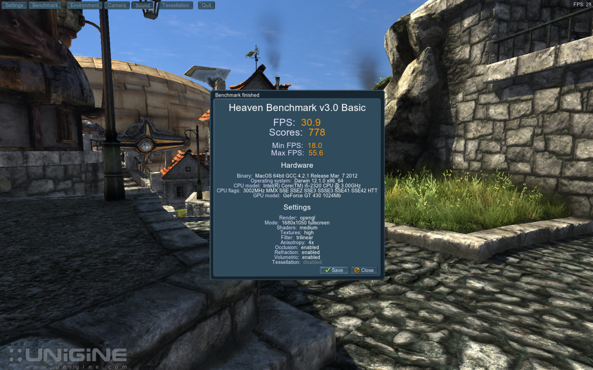

So this is my FPS on Unigine, idk if thats like ok for my graphics or not, gonna check on windows tomorrow.
Hi Colask8,
Which videoboard do you have: a GT 430 or the one in your signature ?
Because your Unigine result shows a GT 430 (in hi-res 1650x1050) with a 30.9 fps result and mine doesn't even go above 15 fps in both Mountain Lion and even in Windows !!!
