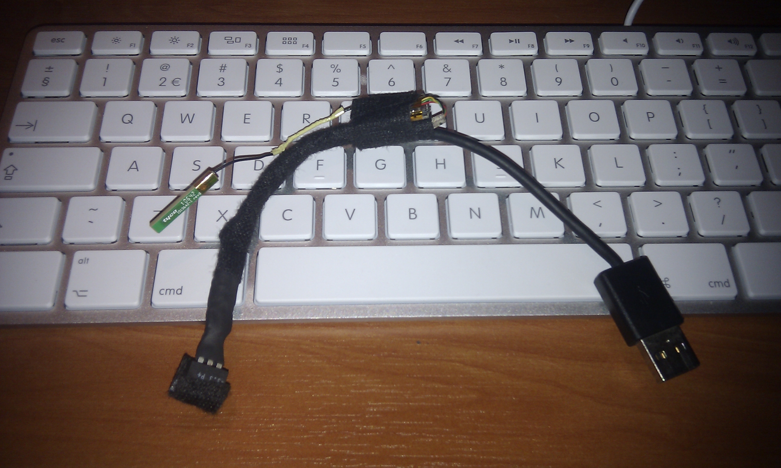

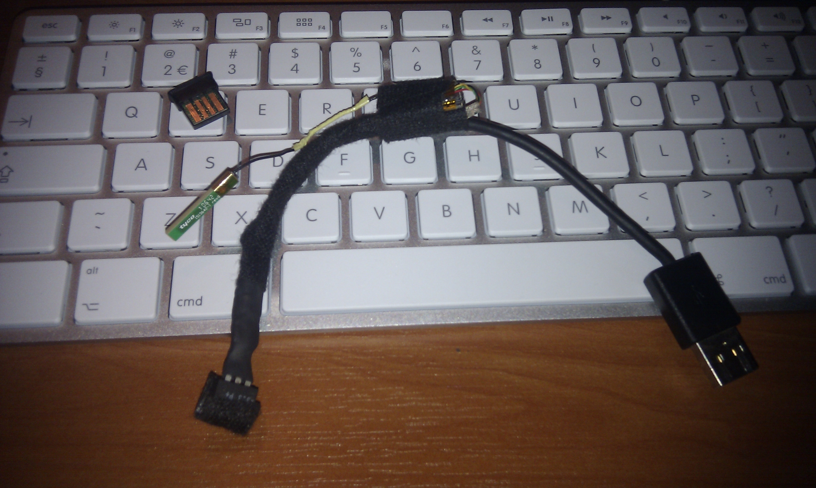

here you have module from Macbook Pro A1260
my 2in1 iDevice :-D - description in polish, but there are many pictures so everything should be clear
2in1 - IrDA & Bluetooth
