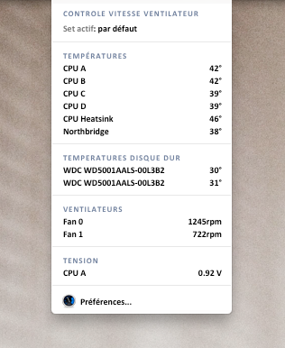

The Real Deal Posted October 15, 2010 Share Posted October 15, 2010 Finally! monitoring without kp and E/E... this looks rock solid, works flawlessly thus far. Big thanks from France mate. GPU temp and it will fully deserved to be pinned on top! Oct 15 16:23:38 localhost kernel[0]: FakeSMC: Opensource SMC device emulator by netkas (C) 2009 Oct 15 16:23:38 localhost kernel[0]: FakeSMC: Modified for plugins support by mozodojo (C) 2010 Oct 15 16:23:38 localhost kernel[0]: FakeSMCDevice: 15 keys added Oct 15 16:23:38 localhost kernel[0]: FakeSMC: Adding key TC0D with handler, type sp78, size 2 Oct 15 16:23:38 localhost kernel[0]: FakeSMC: Adding key TC1D with handler, type sp78, size 2 Oct 15 16:23:38 localhost kernel[0]: FakeSMC: Adding key TC2D with handler, type sp78, size 2 Oct 15 16:23:38 localhost kernel[0]: FakeSMC: Adding key TC3D with handler, type sp78, size 2 Oct 15 16:23:38 localhost kernel[0]: IntelThermal: CPU family 0x6, model 0x1a, stepping 0x5, cores 4, threads 8 Oct 15 16:23:38 localhost kernel[0]: IntelThermal: CPU0 Tjmax 100 Oct 15 16:23:38 localhost kernel[0]: IntelThermal: CPU1 Tjmax 100 Oct 15 16:23:38 localhost kernel[0]: IntelThermal: CPU2 Tjmax 100 Oct 15 16:23:38 localhost kernel[0]: IntelThermal: CPU3 Tjmax 100 Oct 15 16:23:38 localhost kernel[0]: AppleIntelCPUPowerManagement: initialization complete Oct 15 16:23:38 localhost kernel[0]: FireWire runtime power conservation disabled. (2) Oct 15 16:23:38 localhost kernel[0]: FireWire (OHCI) TI ID 8024 PCI now active, GUID 00caf7380000241d; max speed s400. Oct 15 16:23:38 localhost kernel[0]: IT87x: found ITE IT8720F Oct 15 16:23:38 localhost kernel[0]: FakeSMC: Adding key TN0P with handler, type sp78, size 2 Oct 15 16:23:38 localhost kernel[0]: FakeSMC: Adding key Th0H with handler, type sp78, size 2 Oct 15 16:23:38 localhost kernel[0]: FakeSMC: Adding key VC0C with handler, type fp2e, size 2 Oct 15 16:23:38 localhost kernel[0]: FakeSMC: Adding key F0Ac with handler, type fpe2, size 2 Oct 15 16:23:38 localhost kernel[0]: FakeSMC: Adding key F1Ac with handler, type fpe2, size 2 Link to comment Share on other sites More sharing options...

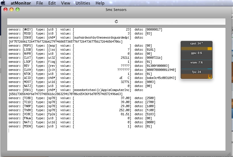

mitch_de Posted October 16, 2010 Share Posted October 16, 2010 Great working here (C2D CPU). I used ITE + IntelTherm. Question: Were comes the CPU Voltage (internal) - from IntelTerm, ITE or main FakeSMC ? I ask because i would use only one of them (which shows CPU Voltage). I know thats there an second Voltage (Voltage, external of the VRM, Mainboard) i belive its from ITE but i am unsure. HINT: The freeware ATMonitor is really great! IT has also an build in function (Tools) for showing all found SMC keys. Also, unique has an build in FPS measurement which can be used beside games which cant show FPS (+ VRAM measurement ) I will ask the dev to add the CPU Voltage SMC to next build of that tool - thats the only (usefull) SMC which cant be shown by ATMonitor. I dont like/use iStatPro/ iStatMenues because much more mem/cpu load footprint. http://www.macupdate.com/info.php/id/30533/atmonitor Link to comment Share on other sites More sharing options...
The Real Deal Posted October 16, 2010 Share Posted October 16, 2010 The CPU voltage does not look 100% accurate. Actually it showns 0,92v, but with mark-i and under W7: CPU-Z, Everest, etc,... all shown the same voltage: 0,944v Link to comment Share on other sites More sharing options...

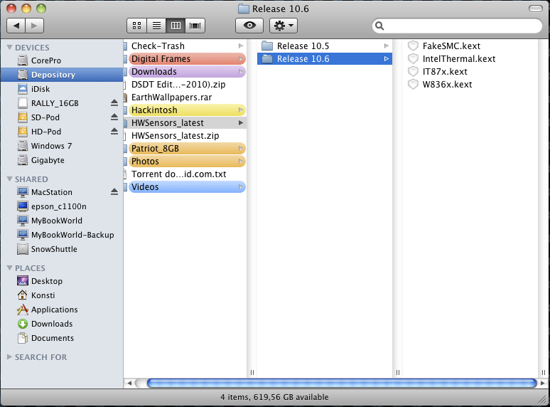

MacKonsti Posted October 16, 2010 Share Posted October 16, 2010 I've got it from the package HWSensors_latest.zip in Mozodojo package downloaded today from his git website. Mate, unless I am blind, the latest compiled binaries from http://github.com/downloads/Mozodojo/FakeS...est.zip/qr_code do not contain the Nvidia plugin.... Anyway, any thoughts on the SuperIO error about updating the key? Link to comment Share on other sites More sharing options...
stefano.85 Posted October 16, 2010 Share Posted October 16, 2010 Mate, unless I am blind, the latest compiled binaries fromhttp://github.com/downloads/Mozodojo/FakeS...est.zip/qr_code do not contain the Nvidia plugin.... Anyway, any thoughts on the SuperIO error about updating the key? downloaded 2 times.... also from your link.... in the subdir release 10.6 there are 4 kexts: fakesmc, Intelthermal, IT87x, NVClockX, W836x. I'm not on the effects of drugs or alcholol .... and you?? hihi Link to comment Share on other sites More sharing options...
MacKonsti Posted October 16, 2010 Share Posted October 16, 2010 downloaded 2 times.... also from your link.... in the subdir release 10.6 there are 4 kexts: fakesmc, Intelthermal, IT87x, NVClockX, W836x.I'm not on the effects of drugs or alcholol .... and you?? hihi Mate, that's 5 kexts--unless you are excluding FakeSMC. I wish I had some alcohol ! Is it possible that I am downloading a previous version or something? The date on the website is 16.10.2010, the size of the zip file is 185.927 bytes but it's not there! Check out the zip contents! I re-downloaded it just now for the third time! Link to comment Share on other sites More sharing options...
aleister Crowley Posted October 16, 2010 Share Posted October 16, 2010 ive the same 4 kexts here in the 16.10 Release Link to comment Share on other sites More sharing options...
oldnapalm Posted October 16, 2010 Share Posted October 16, 2010 Maybe your browser are using cached files instead of downloading again. I just downloaded and can confirm NVClockX.kext is there. Edit: it's not working though, no messages in log. Link to comment Share on other sites More sharing options...
