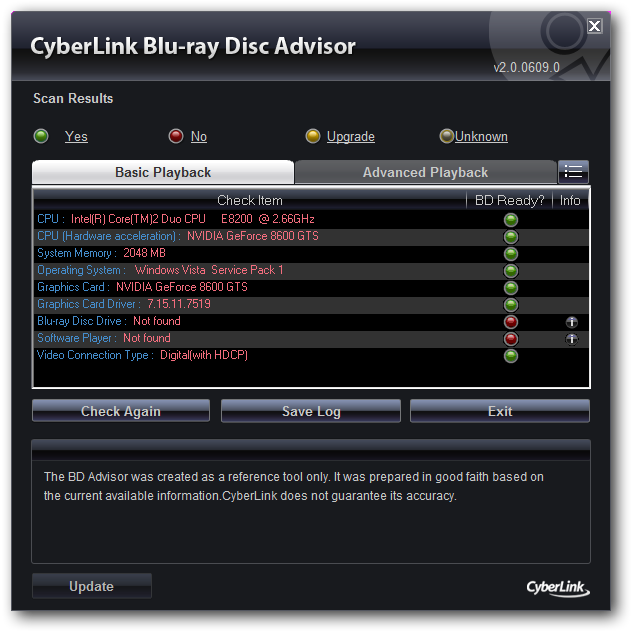

Could it be that mac crossflashing disables hdcp in pc cards?
Not sure how to test that, playing some blueray disc in pc requires hdcp I think...
EDIT: CyberLink Blu-Ray Disc Advisor in Windows reports if your display is HDCP compliant, not sure if its accurate or not but maybe those with flashed cards can check if your card reports as HDCP.
Last two points are red. Surprised me that I have Blu-Ray ready DVD :) . So, only in need of good software and possible change of display, cause Cyberlink claims that Blu Ray works even with VGA connection (it's a question of image quality). :)

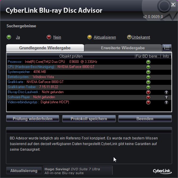

Thanks for the report, anyone with a dvi connection and a flashed card tried it?
You can play blu ray over vga without troubles but in the near future bd discs will restrict non-hdcp outputs to dvd-like resolution.
You might misread. I have flashed card and I use DVI connection :P
I tested it under Vista 64bit using a flashed (3D.rom) Asus 8800GT connected to a DELL 2408WFP Flat Screen (DVI-D cable) and it failed the test.
