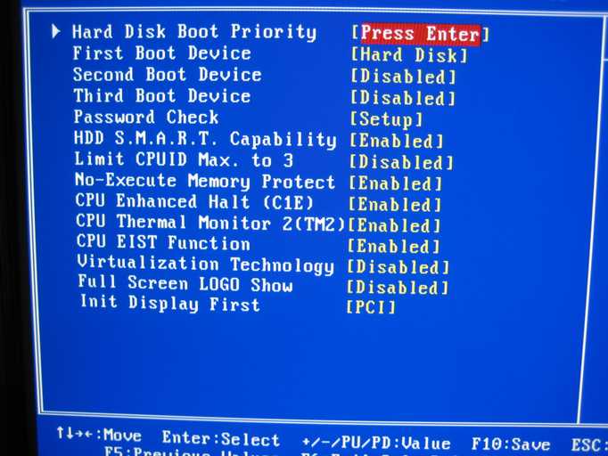

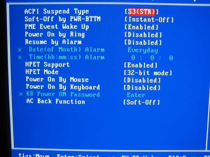

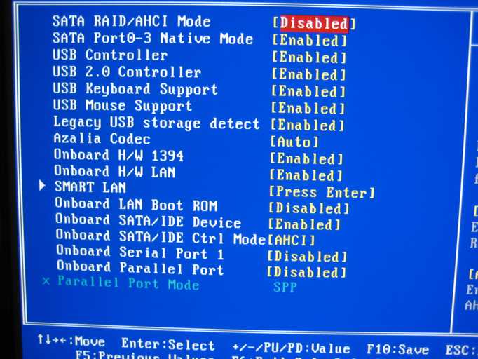

Coadey Posted March 26, 2008 Share Posted March 26, 2008 Guide: GA-EP35-DS4 10.5.2 Vanilla-est Install w/ MBR Updates for 10.5.5+ are at the bottom. The Gigabyte GA-EP35-DS4 varies from the GA-P35-DS4 in several ways, including firmware. I thought I'd post the most vanilla 10.5.2 install I was able to come up with. These guides were most helpful to get me started: http://forum.insanelymac.com/index.php?showtopic=7640http://forum.insanelymac.com/index.php?showtopic=86167http://forum.insanelymac.com/index.php?showtopic=83689http://forum.insanelymac.com/index.php?showtopic=77165 Here is the hardware I used (at a cost of around $1100): Processor: Intel E3110 45nm Xeon Dual-Core 3.0 Ghz (OC to 3.6 Ghz, stock HSF) Mainboard: Gigabyte GA-EP35-DS4 (OC FSB to 400 Mhz, stock 1.2 voltage) Memory: Mushkin 4GB (2 x 2GB) DDR2 800mhz Video: MSI Nvidia GeForce 8800GT OC 512MB Drives: Two Seagate 500GB 7200.11 hard drives, one LITE-ON SATA DVD Power: Antec 430W EarthWatts ATX12V Keyboard: Apple Aluminum Wired Keyboard MB110LL/A Mouse: Logitech RX1000 Case: Thermaltake VD2000BNS with additional Enermax UC-12EB fan Using this guide and hardware everything works with a vanilla kernel. You'll also be able to do "Software Updates" (as of 3/27/2008). ________________________________________________________________________ Prerequisites ________________________________________________________________________ Necessary Software You'll need to copy this software to a USB drive: OS X 10.5.2 Combo UpdaterLeopard Graphics Update 1.0The EP35DS4pack (Alternate Link) You'll also need two DVD's: Kalyway 10.5.1 Retail Leopard 10.5 Hardware Notes Press "Delete" during boot and setup the BIOS to match the attached screenshots. Remove the jumper from any Seagate hard drive to enable 3 GB/s SATA. The 6 ICH9 SATA ports can be used, but not the last 2 Gigabyte ones. Although it should work, I left AHCI "Disabled" for better compatibility with Windows/Linux. The "Hard drive boot priority" changes the order that OS's detect the drives. This system uses 102 watts idle, 179 watts peak. Benchmarks: Cinebench: 4167 (1 CPU), 7936 (2 CPU), 7952 (OpenGL) Geekbench: 4863 Xbench: 217 Openmark: 33292 (at 1920x1200) ________________________________________________________________________ Installation ________________________________________________________________________ This is broken down into three stages using 2 drives. The goal is to have one MBR OS X drive, and one MBR Linux + Windows drive. By using MBR for OS X, the Linux GRUB bootloader can automatically configure and boot both OS X and Windows volumes. Stage One - Installing and booting Kalyway on a GUID Partition Insert the Kalyway 10.5.1 DVD and boot from it. Press F8 when prompted, select "Kalyway". Use "Disk Utility" under the "Utilities" menu to partition both drives: Partition the first drive as "GUID" into 2 partitions; "Kalyway" and "LeopardGUID" Partition the second as "MBR" (use the "Options" button) into 1 partition named "LeopardMBR" Proceed with the install onto the "Kalyway" volume, then remove the DVD and reboot into OS X. Stage Two - Installing a mostly Vanilla 10.5.2 on a GUID Partition While booted from the Kalyway volume, insert your retail Leopard DVD. Now open Applications/Utilities/Terminal to execute this command: open /Volumes/Mac\ OS\ X\ Install\ DVD/System/Installation/Packages/OSInstall.mpkg This will start the Leopard installer without rebooting. Be sure to install onto "LeopardGUID". When finished, install OS X 10.5.2 Combo Updater and Leopard Graphics Update onto LeopardGUID, and do not reboot. Go back to the Terminal to "fix" your LeopardGUID install. First, backup/remove incompatible kext's: sudo su mkdir /Volumes/LeopardGUID/vanilla mv /Volumes/LeopardGUID/System/Library/Extensions/AppleACPIPlatform.kext /Volumes/LeopardGUID/vanilla/ mv /Volumes/LeopardGUID/System/Library/Extensions/AppleAHCIPort.kext /Volumes/LeopardGUID/vanilla/ mv /Volumes/LeopardGUID/System/Library/Extensions/AppleEFIRuntime.kext /Volumes/LeopardGUID/vanilla/ mv /Volumes/LeopardGUID/System/Library/Extensions/AppleHDA.kext /Volumes/LeopardGUID/vanilla/ mv /Volumes/LeopardGUID/System/Library/Extensions/AppleIntelCPUPowerManagement.kext /Volumes/LeopardGUID/vanilla/ mv /Volumes/LeopardGUID/System/Library/Extensions/AppleSMBIOS.kext /Volumes/LeopardGUID/vanilla/ mv /Volumes/LeopardGUID/System/Library/Extensions/IOAHCIFamily.kext /Volumes/LeopardGUID/vanilla/ mv /Volumes/LeopardGUID/System/Library/Extensions/IOATAFamily.kext /Volumes/LeopardGUID/vanilla/ mv /Volumes/LeopardGUID/System/Library/Extensions/IONetworkingFamily.kext /Volumes/LeopardGUID/vanilla/ mv /Volumes/LeopardGUID/System/Library/Extensions/JMicronATA.kext /Volumes/LeopardGUID/vanilla/ Now remove the "download quarantine" flags and install the EP35DS4pack kext extensions: find /Volumes/*/EP35DS4pack/kext -exec xattr -d com.apple.quarantine {} ";" cp -R /Volumes/*/EP35DS4pack/kext/* /Volumes/LeopardGUID/System/Library/Extensions/ diskutil repairpermissions /Volumes/LeopardGUID The included kext's are needed as explained below: AppleACPIPlatform: Fixes restart/shutdown (otherwise only sleep works)dsmos: Enables page decryption for some applicationsAppleSMBIOS: Properly detects hardware features (e.g. fixes System Profiler) by macdotnubNote: Some applications may not work with his SMBIOS. You can try this one: http://netkas.org/?p=58AppleAHCI: Prevents internal drives from appearing as external (not needed if AHCI is disabled)IOACHIFamily: Required for AHCI support (not needed if AHCI is disabled)IOATAFamily: Enables SATA ports 2-5, otherwise system may not boot past grey apple.AppleHDA: Patched for EP35-DS4 onboard sound (Realtek ALC889A)ALCinject: Detects EFI string for onboard sound (instead of using com.apple.Boot.plist)NVinject: Detects EFI string for NVIDIA graphics (instead of using com.apple.Boot.plist)IONetworkingFamily: Fixes Time Machine and "_CFGetHostUUIDString" errorsRealtekR1000: Fixes Apple Filesharing. (Realtek 8111B LAN) Do not reboot. Stage Three - Cloning the GUID partition to an MBR Open Applications/Utilities/Disk Utility Select one of the partitions Click the "Restore" tab Drag the LeopardGUID volume into Source, and LeopardMBR into Destination Click the "Restore" button After the clone is done, open Terminal, and get the disk identifier for LeopardMBR (e.g. /dev/disk1s1) df | grep LeopardMBR Now carefully install the EFI bootloader. Replace the #'s with your disk identifier number(s): sudo su diskutil umount /Volumes/LeopardMBR cd /Volumes/*/EP35DS4pack/efi8/ ./startupfiletool /dev/rdisk#s# ./boot_v8 dd if=./mbr/boot1h of=/dev/rdisk#s# bs=512 count=1 dd if=./mbr/boot0 of=/dev/disk# bs=400 count=1 Make the partition bootable: diskutil umount /Volumes/LeopardMBR fdisk -e /dev/disk# flag 1 quit You should now be able to reboot, press Delete to enter the BIOS, change the hard drive boot priority, and boot into LeopardMBR. You can safely do a "Software Update", including Security Update 2008-002 and Time Machine 1.0 (which includes kernel 9.2.2) Re-partition the old Kalyway/LeopardGUID drive into an MBR disk to insall Windows and/or Linux. I also added a third FAT32 partition, since all OS's can read/write that. If you install Linux, do it last, and it will automatically configure the GRUB Bootloader to see both Mac and Windows. 10.5.5 Update I don't recommend performing an in-place update on a running system, even if it's vanilla. I've had systems kernel panic during an update because kernel extensions are reloaded as they're installed if they're not removed fast enough. This leaves you with a non-booting system that you have to boot using a different drive anyway. First download the 10.5.5 Combo Updater (601 MB) and updated kext pack: http://www.apple.com/support/downloads/mac...omboupdate.htmlhttp://rapidshare.de/files/40528454/EP35DS...10.5.5.zip.html Mount the disk image and copy the .pkg updater to the root of your boot volume. Unzip the kext pack and put it there too, then follow these instructions (replace "BOOTVOLUME" with the name of the volume you're updating). 1. Reboot using the Kalyway insaller DVD. 2. When the install wizard appears click the right arrow. 3. Pull down the "Utilities" menu and choose "Terminal". 4. Run the update installer. Remember to choose the right disk to update. It may fail at the end during the "postinstall" cleanup, but that won't effect operation: /Volumes/*/usr/bin/open /Volumes/*/MacOSXUpdCombo10.5.5.pkg 5. Back in the Terminal, backup the kext's: mkdir /Volumes/BOOTVOLUME/10.5.5_Backup mv /Volumes/BOOTVOLUME/System/Library/Extensions/ALCinject.kext /Volumes/BOOTVOLUME/10.5.5_Backup/ mv /Volumes/BOOTVOLUME/System/Library/Extensions/AppleACPIPlatform.kext /Volumes/BOOTVOLUME/10.5.5_Backup/ mv /Volumes/BOOTVOLUME/System/Library/Extensions/AppleAHCIPort.kext /Volumes/BOOTVOLUME/10.5.5_Backup/ mv /Volumes/BOOTVOLUME/System/Library/Extensions/AppleEFIRuntime.kext /Volumes/BOOTVOLUME/10.5.5_Backup/ mv /Volumes/BOOTVOLUME/System/Library/Extensions/AppleHDA.kext /Volumes/BOOTVOLUME/10.5.5_Backup/ mv /Volumes/BOOTVOLUME/System/Library/Extensions/AppleIntelCPUPowerManagement.kext /Volumes/BOOTVOLUME/10.5.5_Backup/ mv /Volumes/BOOTVOLUME/System/Library/Extensions/AppleSMBIOS.kext /Volumes/BOOTVOLUME/10.5.5_Backup/ mv /Volumes/BOOTVOLUME/System/Library/Extensions/dsmos.kext /Volumes/BOOTVOLUME/10.5.5_Backup/ mv /Volumes/BOOTVOLUME/System/Library/Extensions/IOAHCIFamily.kext /Volumes/BOOTVOLUME/10.5.5_Backup/ mv /Volumes/BOOTVOLUME/System/Library/Extensions/IOATAFamily.kext /Volumes/BOOTVOLUME/10.5.5_Backup/ mv /Volumes/BOOTVOLUME/System/Library/Extensions/IONetworkingFamily.kext /Volumes/BOOTVOLUME/10.5.5_Backup/ mv /Volumes/BOOTVOLUME/System/Library/Extensions/JMicronATA.kext /Volumes/BOOTVOLUME/10.5.5_Backup/ mv /Volumes/BOOTVOLUME/System/Library/Extensions/NVinject.kext /Volumes/BOOTVOLUME/10.5.5_Backup/ mv /Volumes/BOOTVOLUME/System/Library/Extensions/RealtekR1000.kext /Volumes/BOOTVOLUME/10.5.5_Backup/ 6. Now install the new kext's from the kext pack. Only two major changes have been done; a switch from NVinject to NVkush (to fix Quartz Extreme and other issues in 10.5.5) and a switch to the mac.nub version of AppleSMBIOS patched by Duvel (otherwise the hardware serial number doesn't work, e.g. Second Life will crash). chown -R root:wheel /Volumes/BOOTVOLUME/EP35DS4pack_10.5.5/kext/* find /Volumes/BOOTVOLUME/EP35DS4pack_10.5.5/kext -exec xattr -d com.apple.quarantine {} ";" cp -pR /Volumes/BOOTVOLUME/EP35DS4pack_10.5.5/kext/* /Volumes/BOOTVOLUME/System/Library/Extensions/ rm -f /Volumes/BOOTVOLUME/System/Library/Extensions.mkext diskutil repairpermissions /Volumes/BOOTVOLUME 7. You should now be able to reboot normally. If you see a grey "no" symbol during boot, wait a while, and it should continue booting (then later warn you about a misinstalled kext). If it doesn't boot, re-follow the instructions. Hope this helps! ________________________________________________________________________ Remaining Issues ________________________________________________________________________ You can only wake from sleep by pressing the power button, despite any BIOS wake settings. Upon waking, any attached USB drives will warn that they weren't unmounted properly, but do reappear. When using DHCP, the IP information is lost after sleep due to the realtek driver. Use a static internal IP, or remove the RealtekR1000 kext if you don't need Apple Filesharing. No eSATA hot-swap due to AHCI being disabled. Must reboot to see a new external SATA drive. Link to comment https://www.insanelymac.com/forum/topic/95910-guide-ga-ep35-ds4-1052-vanilla-install-1055-update/ Share on other sites More sharing options...
