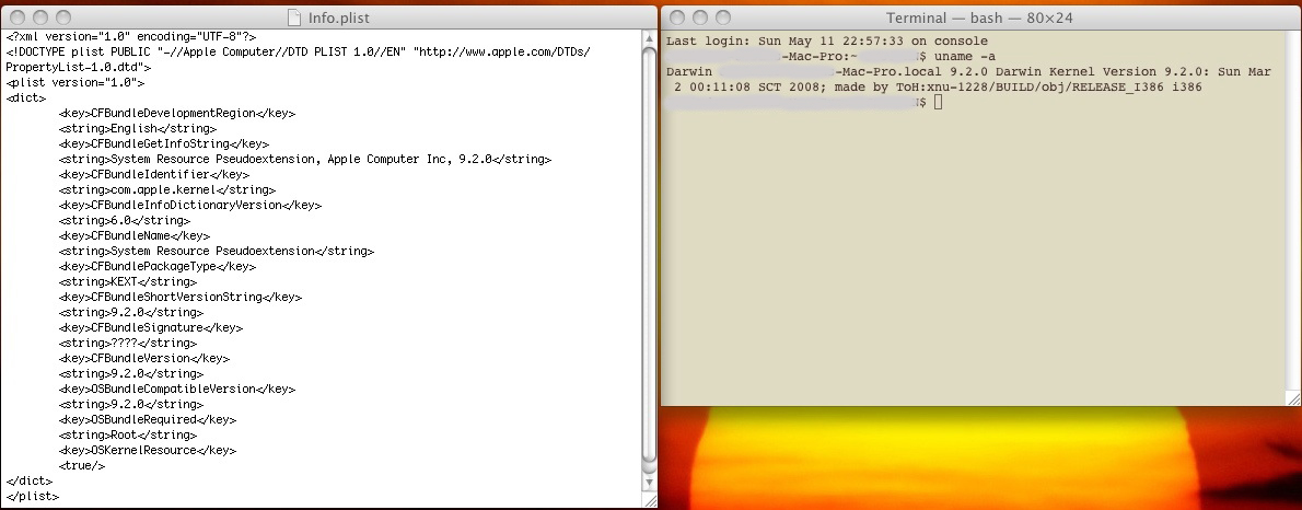

How to check kernel version:
The easiest way to check kernel is running terminal window (applications/utilities/terminal) and type:
uname -a
It will show a long line and at the end of the line it should say the version. Check the figure below.
How to check system.kext version:
Open a finder window, go to /S/L/E and find the file named "system.kext" right click on it, and click on Get Info. In the Get Info window, you will see the Version number. Alternatively, you can right click on the kext, click "show package contents", and open the "info.plist" file (in text editor, for example). It should show a line like this:
<key>CFBundleVersion</key>
<string>9.2.2</string>
Here is how it should look like:
Both should match in versions. If you have 9.2.2 kernel, then system.kext should also be 9.2.2. However, if your kernel and system.kext versions are not matching, that is then the root of the problem. So in order to fix these issues, use the installer provided below. Once you can confirm the details and you know you have non-matching versions, you can continue to Install Guide and follow the instructions

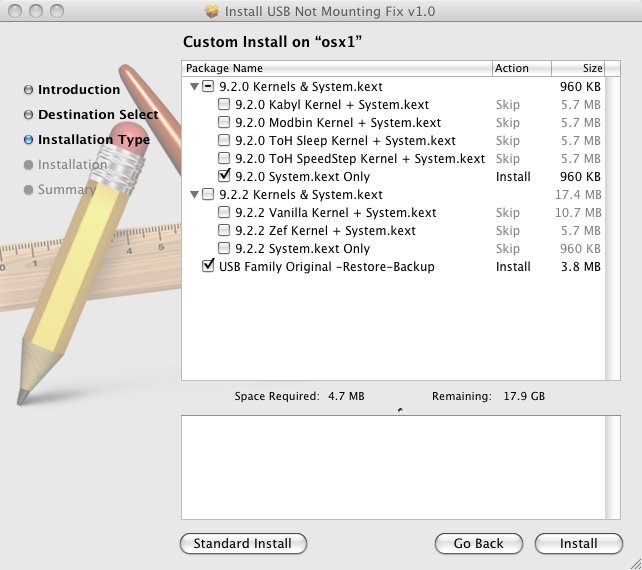

( C ) HOW-TO GUIDE FOR FIXING THE ISSUE "USING USB fix 1.3.MPKG" (aka USB Fix Installer)
1 ) Download the zip file
2 ) Extract the file on your desktop or where ever you like
3 ) Open the folder wherever you extracted the file
4 ) Double click/run the file "USB Fix 1.3.mpkg"
5 ) This has to be installed on the partition you are running OSX, so, no location change on this version

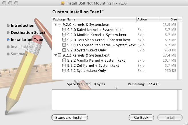

6 ) Click on "Customize", to be able make your own choices...
7 ) By Default: "9.2.0 System.kext only" and "USB Family Original Restore Backup" is selected.
Reasons for default selections:
  • I see that many people are using Kalyway 10.5.2 DVD, which by default has 9.2.0 sleep kernel, selected but installs 9.2.2 system.kext... To solve one of the two issues, you need to have correct system.kext. So this is why I made 9.2.0 system.kext only default
  • As default on the Kalyway 10.5.2 DVD, PCGENUSB2 is also selected. This is a full driver package that is needed only on handful of mobos/laptops which has problematic bios that doesnt release the USB 2.0 high speed bus information to OS as a result it causes High Speed ports to not work. However majority of the people do not have this issue... Therefore I made this by default selection for people who accidently installed pcgenusb2...
Although at this stage you can restart, I HIGHLY RECOMMEND Steps 8,9,10 that are optional but useful on some unique situations...
8 ) Open a finder window, and locate /S/L/Extensions.mkext file. Right Click on it, and select Move To Trash (enter password of course later)
9 ) Locate /S/L/E/C/com.apple.kext.info file and same right click and move to trash
10 ) Restart and at boot press F8 where it waits for 5 secs. Type: -v -f (this is gonna recreate driver caches and fast boot caches. the reason why we are doing 7,8 is sometimes these caches prevent new drivers from loading. Although Leopard has auto update function on these caches, sometimes better take precaution...)
WARNING: The installer is fairly safe but still use it at your own risk. Any problem, please report :)

Well, at first thanks for this.
I also had this problem at least twice before. Then I found out (don´t remember where) that this happens when system.kext do no match your kernel version. To check this you have to go to /System/Library/Extensions/ then find your system.kext in there. Ctrl+click it and select "show package contets", then open the file "info.plist" in the TextEdit app. In there you´re gonna see something like this:
<key>CFBundleShortVersionString</key>
<string>9.2.0</string>
<key>CFBundleSignature</key>
<string>????</string>
<key>OSBundleCompatibleVersion</key>
So, these numbers must be the same as your kernel version. In my case 9.2.0. If it´s different you have to replace this system.kext with one that matches your kernel, and that´s it. At least all the times I had this problem I solved it this way. Only if there´s more than a cause to this same issue...

If you're using a 9.2.2 kernel, make sure you are also using the 9.2.2 system.kext You can get it from the time-machine update using pacifist. Everything works perfectly.
