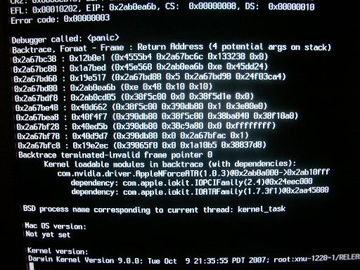

Guest SkipLicks Posted April 8, 2008 Share Posted April 8, 2008 Hi eddie, and thank you very much for your work! I have some problems with the AppleNForceATA driver, and I think someone reported it previously. When I boot on the DVD, I have a black screen with the debugger trace. If this can help you to improove this release, here are my devices id of my IDE/PATA controlers: PATA (0x00E510DE): PCI\VEN_10DE&DEV_00E5&SUBSYS_A5511297&REV_A2\3&13C0B0C5&0&40 SATA (0x00E310DE): PCI\VEN_10DE&DEV_00E3&SUBSYS_A5511297&REV_A2\3&13C0B0C5&0&50 I tried to change some file on the ISO using transmac but I had no success. If there is something that I can do to test a fix I am available to try it. Thanks Link to comment https://www.insanelymac.com/forum/topic/92989-leo4all-1052-universal-amdintelsse2sse3/page/41/#findComment-701580 Share on other sites More sharing options...

eddie11c Posted April 8, 2008 Author Share Posted April 8, 2008 Eddie, are you saying to remove the AppleACPIPlatform.kext? No what I am saying, if you have ACPIPlatform version 1.0.3 you should remove ACPIPS2Nub, its not needed. Hi eddie, and thank you very much for your work! I have some problems with the AppleNForceATA driver, and I think someone reported it previously. When I boot on the DVD, I have a black screen with the debugger trace. If this can help you to improove this release, here are my devices id of my IDE/PATA controlers: PATA (0x00E510DE): PCI\VEN_10DE&DEV_00E5&SUBSYS_A5511297&REV_A2\3&13C0B0C5&0&40 SATA (0x00E310DE): PCI\VEN_10DE&DEV_00E3&SUBSYS_A5511297&REV_A2\3&13C0B0C5&0&50 I tried to change some file on the ISO using transmac but I had no success. If there is something that I can do to test a fix I am available to try it. Thanks Is this a panic you get at the initial part of the boot? I could probably move these device ID's out of AppleNforce, but not sure how that would effect others. Nforce boards use the same Device ID's alot. I will take a look at this, if you can search around to see if any other motherboards use these same Device ID's. I will look also, but my time is pretty limited right now, and I still need more info from people running leopard for the output of the sysctl -n machdep.cpu.brand_string Please take a minute if you have Leopard installed and run this command from Terminal and post the output! Link to comment https://www.insanelymac.com/forum/topic/92989-leo4all-1052-universal-amdintelsse2sse3/page/41/#findComment-701675 Share on other sites More sharing options...

vijayagarwal Posted April 8, 2008 Share Posted April 8, 2008 Hi eddie, i posted the wrong device id in my previous post..now i am posting the device id for the controller.. PCI\VEN_10DE&DEV_0448&SUBSYS_30CF103C&REV_A1 PCI\VEN_10DE&DEV_0448&SUBSYS_30CF103C PCI\VEN_10DE&DEV_0448&CC_01018A PCI\VEN_10DE&DEV_0448&CC_0101 thanks.. Link to comment https://www.insanelymac.com/forum/topic/92989-leo4all-1052-universal-amdintelsse2sse3/page/41/#findComment-701740 Share on other sites More sharing options...
Guest SkipLicks Posted April 8, 2008 Share Posted April 8, 2008 Is this a panic you get at the initial part of the boot? I could probably move these device ID's out of AppleNforce, but not sure how that would effect others. Nforce boards use the same Device ID's alot. I will take a look at this, if you can search around to see if any other motherboards use these same Device ID's. I will look also, but my time is pretty limited right now, and I still need more info from people running leopard for the output of the sysctl -n machdep.cpu.brand_string Please take a minute if you have Leopard installed and run this command from Terminal and post the output! Yes it is a panic in the initial part of the boot, few seconds after. A picture of the screen display is attached. I try to search if other motherboards use this same ID's, but I think that it is all Nforce3 250GB chipset, espcially AMD Athlon 64 motherboards. I found this ones: Epox: EP-8KDA3+ Epox: EP-8KDA3+ PRO Epox: EP-8KDA3J MSI: K8N Neo Platinum (MS-7030) MSI: K8N Neo-FSR (MS-7030) ASUS: K8N-E Deluxe BIOSTAR: K8NHA Grand BIOSTAR: K8NHA-M Grand Albatron: K8X250GB Pro DFI: LANPARTY UT nF3 250Gb Jetway: N250DAG Abit: NF8 Abit: NF8-V Soltek: SL-B9A-FGR Soltek: SL-K8AN2-GR Soltek: SL-K8AN2E-GR I have no Leopard running yet, so I boot on Tiger, and write the commande line "sysctl -n machdep.cpu.brand_string" It gives me the following result : "AMD Athlon 64 Processor 3000+" Link to comment https://www.insanelymac.com/forum/topic/92989-leo4all-1052-universal-amdintelsse2sse3/page/41/#findComment-701783 Share on other sites More sharing options...
