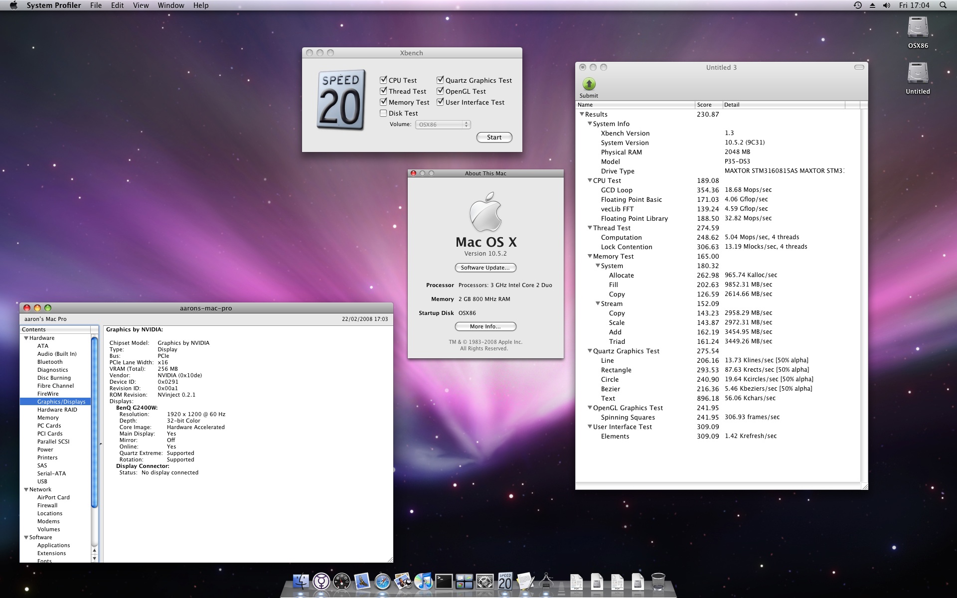

MrHicks Posted February 22, 2008 Share Posted February 22, 2008 Just built my hackintosh with: GA-P35-DS3 v2.1 e2160 2gb ddr2 800 7900gt efi_mbr ahci enabled 10.5.2 installed I'm getting a nice 230 xbench score with the disk check disabled. Strangely, shutdown works perfectly for me, but restarting does not, I just get a blank screen with all the fans still running? Link to comment https://www.insanelymac.com/forum/topic/83689-how-to-install-on-gigabyteasuscompatible-boards/page/21/#findComment-638071 Share on other sites More sharing options...

MrHicks Posted February 22, 2008 Share Posted February 22, 2008 @mr hicks, can i please see the results to ur video benchmarks in xbench? (open gl, quartz, user interface) sorry it's a bit large. Any ideas on why shutdown works fine and restart doesn't? The roles were reversed before I updated to 10.5.2. Link to comment https://www.insanelymac.com/forum/topic/83689-how-to-install-on-gigabyteasuscompatible-boards/page/21/#findComment-638163 Share on other sites More sharing options...
