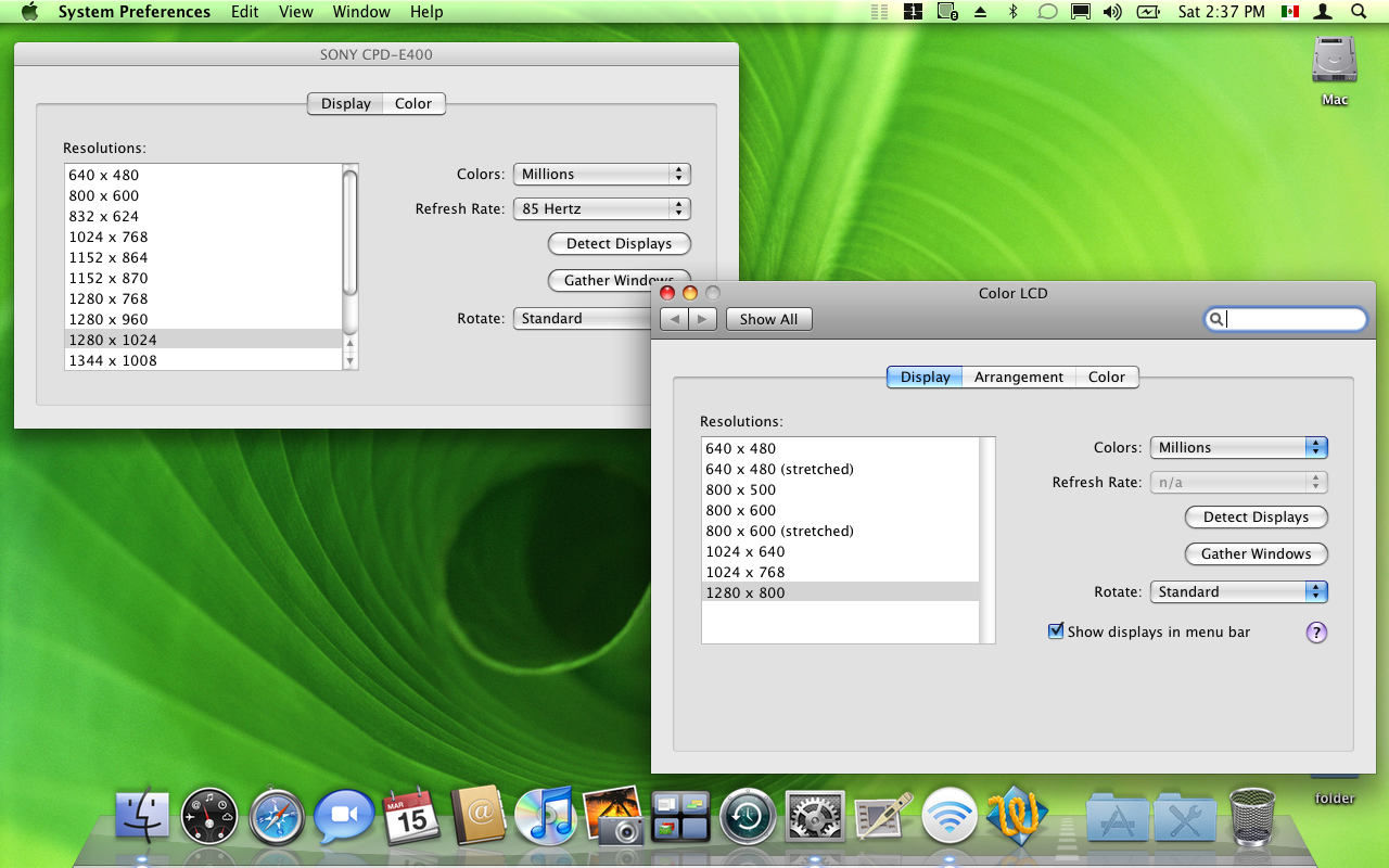

More good news DUAL Monitor on 8400 possible, I tested 2 NVCAP values:
from desktop 8400gs
property list editor mode:
<04000000 00000100 02000000 00000000 00000000>
text editor mode:
BAAAAAAAAgANAAAAAAAABwAAAAA=
EDIT:
This allow you to have the Internal LCD, and DVI via HDMI conector or VGA
<04000000 00000100 06000000 00000000 00000000>
text editor mode:
BAAAAAAAAQAGAAAAAAAAAAAAAAA=
from other user card, Dual display with VGA, LCD primary:
<04000000 00000200 0D000000 00000007 00000000>
text editor mode:
BAAAAAAAAwAMAAAAAAAABwAAAAA=
Those values can be in NVinject, NvinjectGo Natit and also it can be converted in a gfx string and added to the com.apple.Boot.plist
