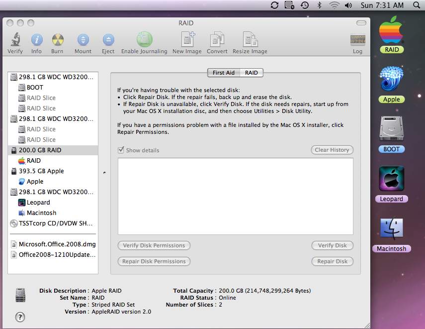

karaakeha1 Posted December 15, 2007 Share Posted December 15, 2007 Leopard retail instillation simplified guide( See Below After RAID Guide) April 7: Installed Chameleon 2.0 RC1 works Great. Thanks to Chameleon Developers. Finally able to dual boot with Windows 7 or windows Vista on separate Hard Drive. (Download Chameleon Link Below ) those who has widescreen monitor can fix the stretched Apple boot logo ( thanks again to Chameleon 2.0) by just changing the resolution in theme.plist of default theme in extra folder. Checkout Chameleon 2.0 RCI in action pics below Mouse Lag fix: this lag is quite obvious in 10.5.6 after installing latest Quicktime and iTunes. I just deleted the AppleUpstreamUserClient.kext . than delete Extensions.mkext before restart . Mouse lag Gone Dec 22 Update AppleAHCIPort.Kext Build 31 (ver 1.5.2) Adds ID for ICH7 to ICH10 IOAHCIFamily.kext Build 294 (ver 1.5.0) shows SATA drive as internal JMicronATA.kext latest Vanilla just added Jmicron ids Above three kexts are vanilla just Device ids are added See attachment below for new kexts pack For Sleep to work make sure in Energy Saver -Restart Automatically after a Power Failure is checked Credit goes to Jan Bird Sep 18, 2008 Sleep Issue. I was investigating Why Leopard Fails Sleep when idle. Found that Paragon NTFS was the cause I deactivated and Voila ! Leopard is able to go sleep on its own. Same Issue with MacFuse. This Issue affects even MacBook Or MacBook Pr 11 July, For Restart fix -Open AppleACPIPlatform Binary in hex Editor & replace E8 A0 FF FF FF with B0 FE E6 64 F4 ( thanks to CharlesB ) attached below latest AppleACPIPlatform.kext For Advance user only RAID Install Two Methods Chameleon EFI & EFI v8 listed below I prefer Chameleon EFI as you can directly boot from Software RAID Chameleon EFI RAID Guide You need two or more Drives I used three Drives for Stripe RAID by Disk reading Xbench score alone jumped to over 190 Use diskutility to make raid volume of your desire Important : 1. Make sure first install the Leopard Retail to the Destination RAID Drive.You can install Retail Leopard From Disk or Carbon Copy Clone from Existing Retail Leopard install. 2. Apply post patch as usual RAID Drive 3 than Edit com.apple.boot.plist (Drag drop on the desktop edit than replace)in the RAID volume add to Kernal Flags boot-uuid=RAID Identifier For RAID Identifier:using "Disk Utility.app", right click on your root volume, then Information it will look like following pic 4.Make sure you Install Chameleon EFI after Step 3(after addding UUID to com.apple.boot.plist) other wise Raid won't boot. -Extract all the files to user root folder from Cameleon Files folder. Open terminal type here in example I used three Disks Disk0 , Disk1 , Disk2(Mac OS X creates a small helper partition at the end of each RAID member disk Called Boot OSX) , fdisk -f boot0 -u -y /dev/rdisk0 fdisk -f boot0 -u -y /dev/rdisk1 fdisk -f boot0 -u -y /dev/rdisk2 dd if=boot1h of=/dev/rdisk0s3 dd if=boot1h of=/dev/rdisk1s3 dd if=boot1h of=/dev/rdisk2s3 diskutil mount disk0s3 cp boot /Volumes/Boot\ OSX diskutil unmount disk0s3 diskutil mount disk1s3 cp boot /Volumes/Boot\ OSX diskutil unmount disk1s3 diskutil mount disk2s3 cp boot /Volumes/Boot\ OSX diskutil unmount disk2s3 You are Done Boot to Raid Good Luck look at mine Three Disk Striped Raid Pic Tip to Automatically select RAID during boot than open the Disk Utility to check RAID Identifier(Select RAID and click info) Copy that than you need to edit com.apple.boot..plist on the BOOT partition not the RAID add <key>Kernel Flags</key> <string>boot-uuid=Paste Raid Identifier here</string> this make sure you automatically boot from RAID Volume Included in install Package new AppleSMBIOS which is functionally best so far with following advantages DVD player , adobe CS3 , LogmeIn ,Carbon Copy Cloner( make your you have installed EFI to the cloning drive after Cloning )works With included kexts, Hard Drive shows as internal and if in Bios is AHCI mode they are even Hot swappable eSATA Sleep, Restarts works fine with vanilla kernel 9.6.0 In the forum down Eclau post also shows step by step how to make custom EFI String for Video card ,Time machine fix,Sound Here is updated Simple Guide Leopard Retail Install with Chameleon EFI For any Retail Leopard install First requirement is working Leopard Partition Destination Drive with Disk utility Select GUID partition how to install EFI To install Chameleon EFI its very simple because now it has installer . just run and select the right drive Install Leopard Mount the Leopard retail DVD or its Image. I prefer image as instillation is very fast 5-6 mins In terminal Copy Paste cd /Volumes/Mac\ OS\ X\ Install\ DVD/System/Installation/Packages open osinstall.mpkg Install on right Destination Drive Than install 10.5.6 Combo update on the right drive Now to remove incompatible kext or install requird one Put kext file in the user folder(users/currentuser(yourusername)/ Open post patch change (destination=Name of Drive where retail leopard is installed) Open terminal and drag drop post patch this included Sound file is for GA P35 DS4 or similar Gigabyte motherboard & GFX EFI string for nvidia 7600 GT Card Make sure in Post patch sh file you replace with drive name(Leopard) with yours Drive name Boot with new Drive and enjoy Good luck with your built For EFI String for VIDEO , Network, Audio use Latest EFI Studio ,Select Devices and Click Wrtie to com.apple.boot.plist will add Automatically for you. Now you can even install EFI on destination Drive by this PowerOff_bug_fix.zip Chameleon.dmg.zip Chameleon_Files_.zip _Latest_EFIStudio.zip HDAEnabler.kext.zip Latest_889a_AppleHDA.kext.zip Latest_11_JUN_AppleACPIPlatform.kext.zip Latest_Kext_package.zip updated_kexts_for_10.5.5.zip Kexts___Post_patch_10.5.5.zip OpenHaltRestart.kext.zip 10.5.6_kexts_pack.zip Chameleon_2.0_r431.pkg.zip 1 Link to comment https://www.insanelymac.com/forum/topic/76404-%EF%A3%BF-leopard-retail-dvd-perfect-guide-1056-chameleon-20-rc1-april-72009/ Share on other sites More sharing options...
