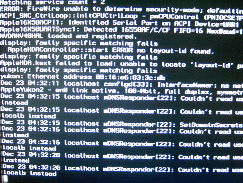

Ok, I have tried several things and I am stuck. Here is where I am so far:
1) I have iAtkos running smoothly (GUID/EFI v8) on my laptop. I have an DMG file of the Retail Leopard DVD on the iAtkos desktop.
2) Formated and external drive with GUID and installed EFI v8 and entered the "dd if" commands to make it bootable. These same commands worked fine for my iAtkos install.
3) Using the terminal I navigated to the Packages directory of the Leopard retail DMG and ran OSInstall.mpkg.
4) Selected my external HD and hit install, no problems there.
5) When that finished I removed AppleEFIRuntime.kext and added Netkas' AppleSMBios.kext and dsmos.kext.
6) Did the permissions for those files and then did a disk permissions. Reboot.
Here are my problems:
1)Initialy got a repeating over and over HPET thing (Package 0 didn't get an HPET). I renamed the AppleIntelCPUPowerManagement.kext. That seemed to stop that.
2) I now get a series of lines (about 5 or 6) that all begin with:
localhost mDNSResponder [22] couldn't read user-specified.....
I did a complete reinstall except the second time I added IONetworkingFamily.kext and AppleAzaliaAudio.kext from the iAtkos DVD. I also added Natit.kext.
1) got the repeating HPET line, and again removed AppleIntelCPUPowerManagement.kext
2) Still get the mDNSResponder [22] lines.
On both installs it just hangs there. Also on my iAtkos install the HPET deal isn't an issue and I have AppleIntelCPUPowerManagement.kext installed. Any ideas?

Ok, I have tried several things and I am stuck. Here is where I am so far:1) I have iAtkos running smoothly (GUID/EFI v8) on my laptop. I have an DMG file of the Retail Leopard DVD on the iAtkos desktop.2) Formated and external drive with GUID and installed EFI v8 and entered the "dd if" commands to make it bootable. These same commands worked fine for my iAtkos install.3) Using the terminal I navigated to the Packages directory of the Leopard retail DMG and ran OSInstall.mpkg. 4) Selected my external HD and hit install, no problems there.5) When that finished I removed AppleEFIRuntime.kext and added Netkas' AppleSMBios.kext and dsmos.kext.6) Did the permissions for those files and then did a disk permissions. Reboot.Here are my problems:1)Initialy got a repeating over and over HPET thing (Package 0 didn't get an HPET). I renamed the AppleIntelCPUPowerManagement.kext. That seemed to stop that.2) I now get a series of lines (about 5 or 6) that all begin with: localhost mDNSResponder [22] couldn't read user-specified.....I did a complete reinstall except the second time I added IONetworkingFamily.kext and AppleAzaliaAudio.kext from the iAtkos DVD. I also added Natit.kext.1) got the repeating HPET line, and again removed AppleIntelCPUPowerManagement.kext2) Still get the mDNSResponder [22] lines.On both installs it just hangs there. Also on my iAtkos install the HPET deal isn't an issue and I have AppleIntelCPUPowerManagement.kext installed. Any ideas?GeezePs...I really don't have to fool with this method, except that I think it is a really cool concept in regards to using the retail DVD. Plus iAtkos release removed all ability to run PPC code programs.
From with the iATKOS when retail leopard Hard drive is connected check
ls -lr /Volumes/Leo/System/Library/Extensions/ ( here leo=Name of Hard-drive) if all the permissions are corrected .I was getting the same errors, once permissions were corrected I Booted without Error though first booted to safe modeF8 and then -x -v once I booted to safe mode from there with disk utility I repaired the permissions and reboot and error disappeared
Need to delete this AppleEFIRuntime.kext if installed from Retail DVD, if iATKOS than not required From with the iATKOS when retail leopard Hard drive is connected check
Thanks...that got me a bit farther. dsmos.kext didn't have the right permissions set. I corrected that and from the iAtkos install DVD did a repair permissions as well.
Now I get to the blue screen but no login window and no mouse pointer.
Thanks for your help. Can't wait to get this figured out.
Try deleting AppleIntelCPUPowerManagement.kext
