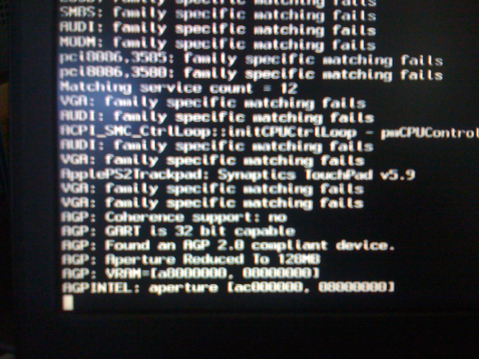

iHugoF Posted August 17, 2008 Share Posted August 17, 2008 Hi there, I've a ATI Mobility Radeon 9700 (by info on the PC sticker), but it's reported as the 9600 (64 MB) on PC boot. I can't manage to have it work with CI/QE, even after trying almost every info I've found here. Please help! Here are the files as requested. Archive.zip Hope this helps... Thank you! Link to comment https://www.insanelymac.com/forum/topic/71308-new-agpgart/page/30/#findComment-859359 Share on other sites More sharing options...
Slice Posted August 17, 2008 Author Share Posted August 17, 2008 Hi there, I've a ATI Mobility Radeon 9700 (by info on the PC sticker), but it's reported as the 9600 (64 MB) on PC boot. I can't manage to have it work with CI/QE, even after trying almost every info I've found here. Please help! Here are the files as requested. Hope this helps... Thank you! As I see you have AGP Bridge devID=3581 that is supported by AGPGart. But I don't see you install it. Your VGA devID=4e50 also is supported by existing drivers. Don't know what is your problem. May be your problem is called "mobility" as for me? Link to comment https://www.insanelymac.com/forum/topic/71308-new-agpgart/page/30/#findComment-859537 Share on other sites More sharing options...

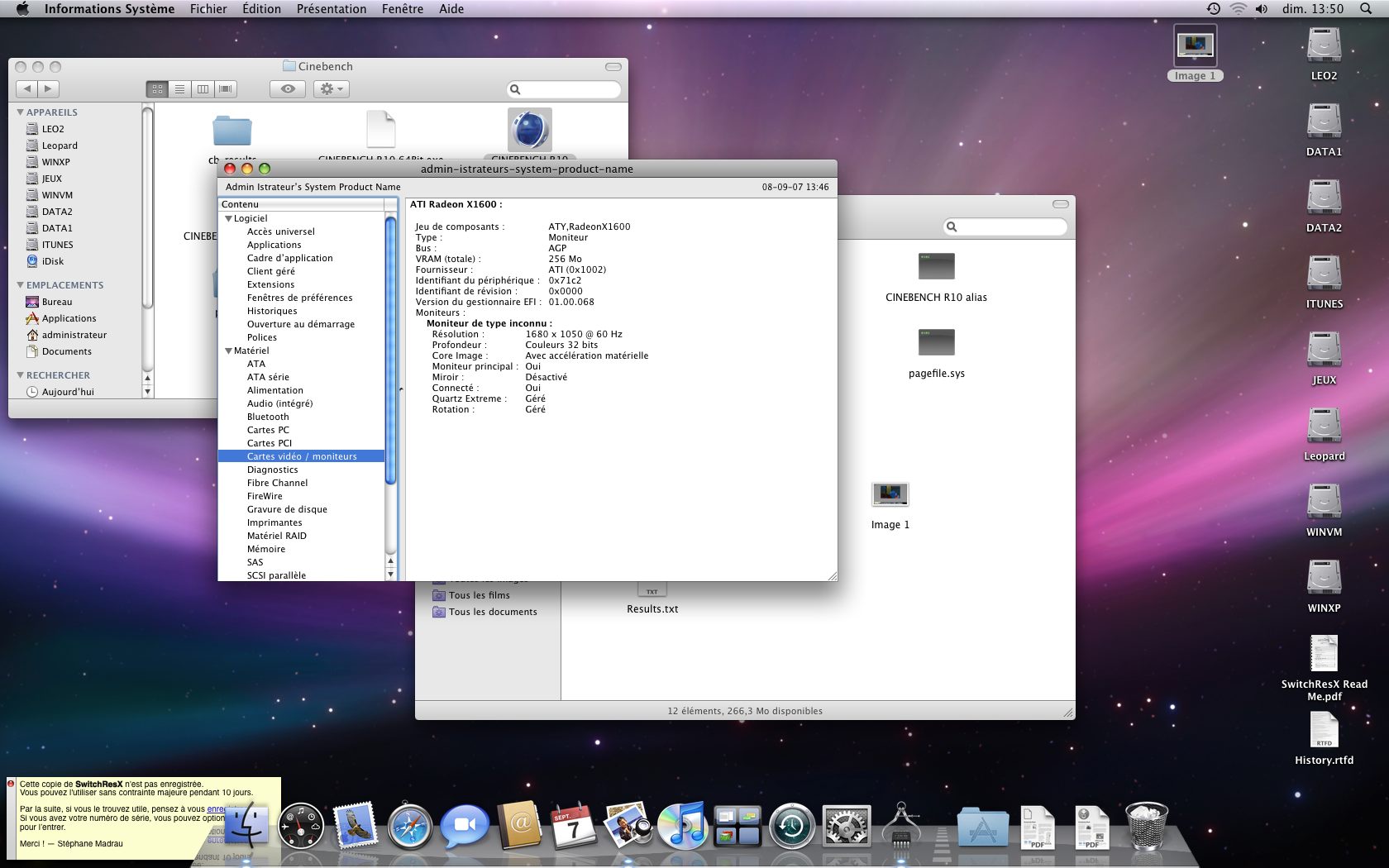

gaston Posted August 21, 2008 Share Posted August 21, 2008 Well i come back with my original graphic card, (the one in my signature) Sapphire ATI Radeon X1600 AGP 256Mb (ID 71c2), was reading and find out that Dan Druff have the same card and same mic prossesor as well. Slice/Dan Druff any advance in this case? Can i try something to help? Thanks to u all! Link to comment https://www.insanelymac.com/forum/topic/71308-new-agpgart/page/30/#findComment-863962 Share on other sites More sharing options...
Slice Posted August 21, 2008 Author Share Posted August 21, 2008 Well i come back with my original graphic card, (the one in my signature) Sapphire ATI Radeon X1600 AGP 256Mb (ID 71c2), was reading and find out that Dan Druff have the same card and same mic prossesor as well. Slice/Dan Druff any advance in this case? Can i try something to help? Thanks to u all! Read topic, see FAQ and reports from Dan Druff and JaS. My advice - set aperture to 64Mb as JaS did. Link to comment https://www.insanelymac.com/forum/topic/71308-new-agpgart/page/30/#findComment-864371 Share on other sites More sharing options...
iHugoF Posted August 22, 2008 Share Posted August 22, 2008 As I see you have AGP Bridge devID=3581 that is supported by AGPGart. But I don't see you install it.Your VGA devID=4e50 also is supported by existing drivers. Don't know what is your problem. May be your problem is called "mobility" as for me? So how should I proceed? Do I have to had the IDs to the Info.plist file of AGPGart? My AGPGart only has under "IONameMatch" "pciclass,060400" and "pci10de,e2". By the way, it's a laptop... I think that the "Mobility" is there just because of that. Thank you for your help! Link to comment https://www.insanelymac.com/forum/topic/71308-new-agpgart/page/30/#findComment-864579 Share on other sites More sharing options...
Slice Posted August 22, 2008 Author Share Posted August 22, 2008 So how should I proceed? Do I have to had the IDs to the Info.plist file of AGPGart? My AGPGart only has under "IONameMatch" "pciclass,060400" and "pci10de,e2". By the way, it's a laptop... I think that the "Mobility" is there just because of that. Thank you for your help! "pci10de,e2" - it is not your chipset, erase it. You don't need to change anything in AGPGart. Your problem is in ATI drivers. I have no good reports with "Mobility". I am waiting for other developers to resolve the problem. Link to comment https://www.insanelymac.com/forum/topic/71308-new-agpgart/page/30/#findComment-864773 Share on other sites More sharing options...

iHugoF Posted August 22, 2008 Share Posted August 22, 2008 "pci10de,e2" - it is not your chipset, erase it.You don't need to change anything in AGPGart. Your problem is in ATI drivers. I have no good reports with "Mobility". I am waiting for other developers to resolve the problem. The AGP driver is loading, but CI is Software and no QE. I did so many stuff already that I lost track of it, but using the IOPCIFamily.kext and AGPGart.kext (267 & 270), when booting it stops where the attached image shows. I don't know if this helps or not. Thank you! Link to comment https://www.insanelymac.com/forum/topic/71308-new-agpgart/page/30/#findComment-865131 Share on other sites More sharing options...

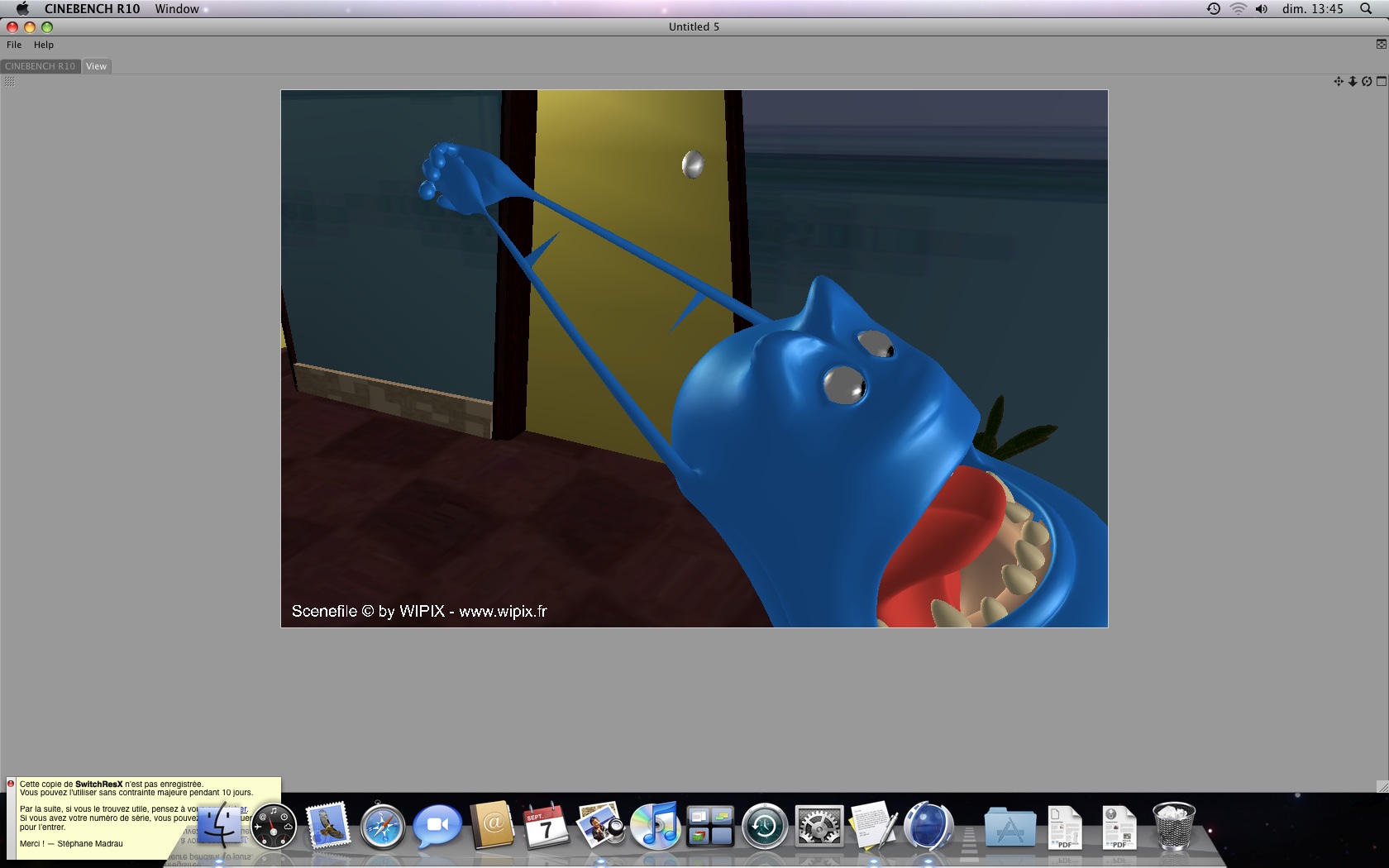

Dan Druff Posted September 8, 2008 Share Posted September 8, 2008 Back from the dead!!! Hi, I had a very busy summer and couldn't get near my PC for long. Also, I've got another MB/CPU, more powerful (with C2D support and everything), but it's still AGP! Now, I'm still under 10.5.2 as before and everything still works the way it had, but I'm installing anoher partition under 10.5.4 and I'm in testing now. After numerous unsucessful attempts, I managed to get my X1600 pro AGP running fine under 10.5.4 using this method: http://forum.insanelymac.com/index.php?sho...33&hl=x1650. This method uses old AGPGart by Joblo, so why not update to 2.7.1! That's what I did and guess what, all is working nearly fine, it may needs some tweaking but all in all it's nearly perfect. I'm sending logs and images for you to see. Setup #15 Leo 10.5.4 with vanilla kernel AGPGart 2.7.1 -> AGP_HOST: 0xf0000000 IOGraphicsFamily -> Vanilla 10.5.4 IONDRVsupport -> 1.5.2 from Modbin Video install atindrv -> 10.5.28.21 from Modbin Video install Graph kext -> 10.5.28.21 from Modbin Video install with 71C2 key added ATIinject.kext -> from Modbin Video install with 71C2 key added Boots fine, some image tearing (see included image). I suppose that the OpenGL performance is attribuable to my new CPU. I suppose, also, that the prodigious leap made on GioFX (from 440 to 512) is also attribuable to my new system, my memory bus is now very fast compared to my old system. Tearing: Some image tearing Shading (OpenGL Standard): 3449 (CPU performance) GioFX: 512 Logs.zip Link to comment https://www.insanelymac.com/forum/topic/71308-new-agpgart/page/30/#findComment-883120 Share on other sites More sharing options...
Dan Druff Posted September 8, 2008 Share Posted September 8, 2008 As it is very confusing to keep trace of everything (mod, compatibility, chipset supported, etc.) I created a Wiki page here to keep everything in order. The layout is simple and can be change to suit our needs. Now everybody can help to centralize information for everyone and make this project easier to maintain/follow. http://wiki.osx86project.org/wiki/index.php/AGPGart Link to comment https://www.insanelymac.com/forum/topic/71308-new-agpgart/page/30/#findComment-883145 Share on other sites More sharing options...
