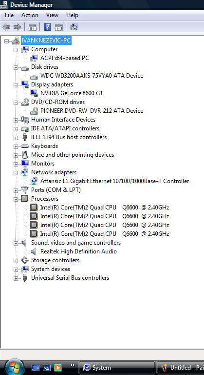

Aljester Posted February 16, 2008 Share Posted February 16, 2008 I have this configuration. Can I install os x on my new blank hard disk sata? With this configuration? I forget to say I have a motherboard Asus P5K and 4 gb ram. Link to comment https://www.insanelymac.com/forum/topic/69132-asus-p5k-e-and-leopard-now-with-iatkos-first-post-updated/page/7/#findComment-626962 Share on other sites More sharing options...
