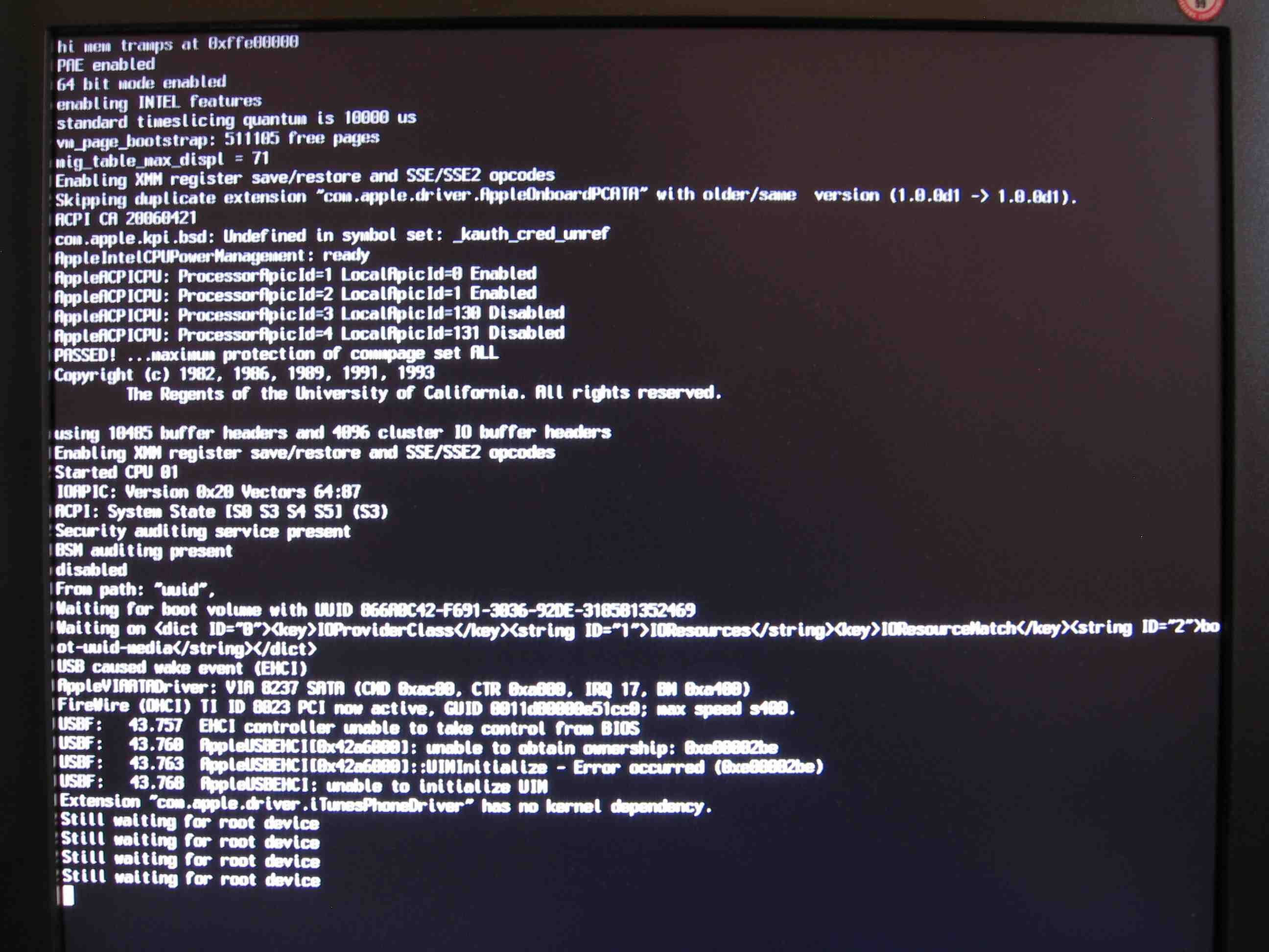

trexplorer Posted March 17, 2007 Share Posted March 17, 2007 Tried the Loki installer in addition to manual ugrade and consistently get this result (see pic). Tried a number of kext replacements from my 10.4.8. 8.8.1 install without success ... Anyone know what's going on ... ? E6300 on asus P5B deluxe SATA (Intel ICH8) and IDE controllers (JMicron) Asus GForce 7600 GS vidieo with Natit Link to comment https://www.insanelymac.com/forum/topic/45260-1049-updater-results-loki1049/page/3/#findComment-326016 Share on other sites More sharing options...
enb14 Posted March 17, 2007 Share Posted March 17, 2007 yeah, BSDroot hang, try with old PCIFamily and PCCard kexts Fixed with the newer kernel Link to comment https://www.insanelymac.com/forum/topic/45260-1049-updater-results-loki1049/page/3/#findComment-326038 Share on other sites More sharing options...
