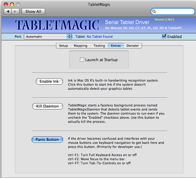

hey I follow all that, but frankly I don't see anywhere on the 2.0b11 where it says anything about don't query fields, in any of the 5 tabs across the preference pane. Thus I don't see any opportunity to edit those fields.
on my computer, the extras tab looks like this, I can even see in the manual theres supposed to be a don't query option, but I don't appear to have one. I installed the earlier ß8 version too. The tracking is my last big hurdle here.
Anyway, is it one of the other panels, and not labelled, or maybe it was removed for this version.

umm... i believe this problem is caused by when you installed tabletmagic, you were using the AppleSMBIOS.kext from netkas, to make your computer pretend it's a mac pro. I would try uninstalling tabletmagic, putting back the vanilla AppleSMBIOS.kext, install tabletmagic, and see if the "Don't Query" is there under the extras tab. If it's there, I think you can go ahead and put the netkas AppleSMBIOS.kext back and use the modified daemon that i posted previously. Hopefully that solves your problem.
thanks for the reply, this figuring this stuff out can be frustrating. I uninstalled tablet magic, got the vanilla AppleSMBIOS.kext from my macbook, and swapped it out in the Extensions [repaired perms, deleted extension pref etc -restart] then I reinstalled the tabletmagic, but its still the same as the previous printwindow - so just to see what I was looking for, I installed the ß11 version onto my real CoreDuo Macbook, and the same result, no Don't Query area. I then, just to check, installed the ß8 version, and got the same result, so no go, unless I am doing something wrong in my flow of install re-install -

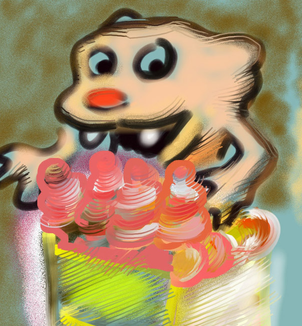

who loves cake!
drawn with that ole xp tablet edition drive stuck back in [no pressure sensitivity there]

"Don't Query" guy. Do you get the "No Tablet Found" problem? When Scott wrote the TabletPC support he coded it to detect the machine model name. Nowadays, these names are different, and so we have a problem. Anyone wanna look for the modelname code and tweak it? I don't. x.x
I find the driver now that I have imported the modified daemon[sp], I get the tablet working fine, I edited my resources plist for the WACF004, which is the one I have according to my device manager, and even get pressure sensitivity. What I don't get is the "don't query" area of the preference pane where you can [switch that on or off] and enter the tracking adjustments, its not even showing up on the panel[see picture above]. I saw the dialogue where Scott mentioned that theres machine name issues in there. I don't know what the next step would be to move forward with this.

Sorry for the long wait! Try the new version of TabletMagic posted here:
http://thinkyhead.com/pub/TabletMagic2b12.dmg (711K)
This release uses a more robust technique to recognize non-Apple hardware configurations and should be compatible with all your favorite custom kernels. When your TabletPC system is recognized you will find an extra set of controls in the "Extras" pane:
  • Don't Query Digitizer: Assume a digitizer exists on the selected serial port.
  • Range: Fix tracking problems by changing these values. If the pen tracks too little, decrease these values. If it tracks too far, increase them.
If you have the Port popup set to "Automatic" then only the first serial port will be scanned, so try selecting the actual serial port if Automatic fails.
