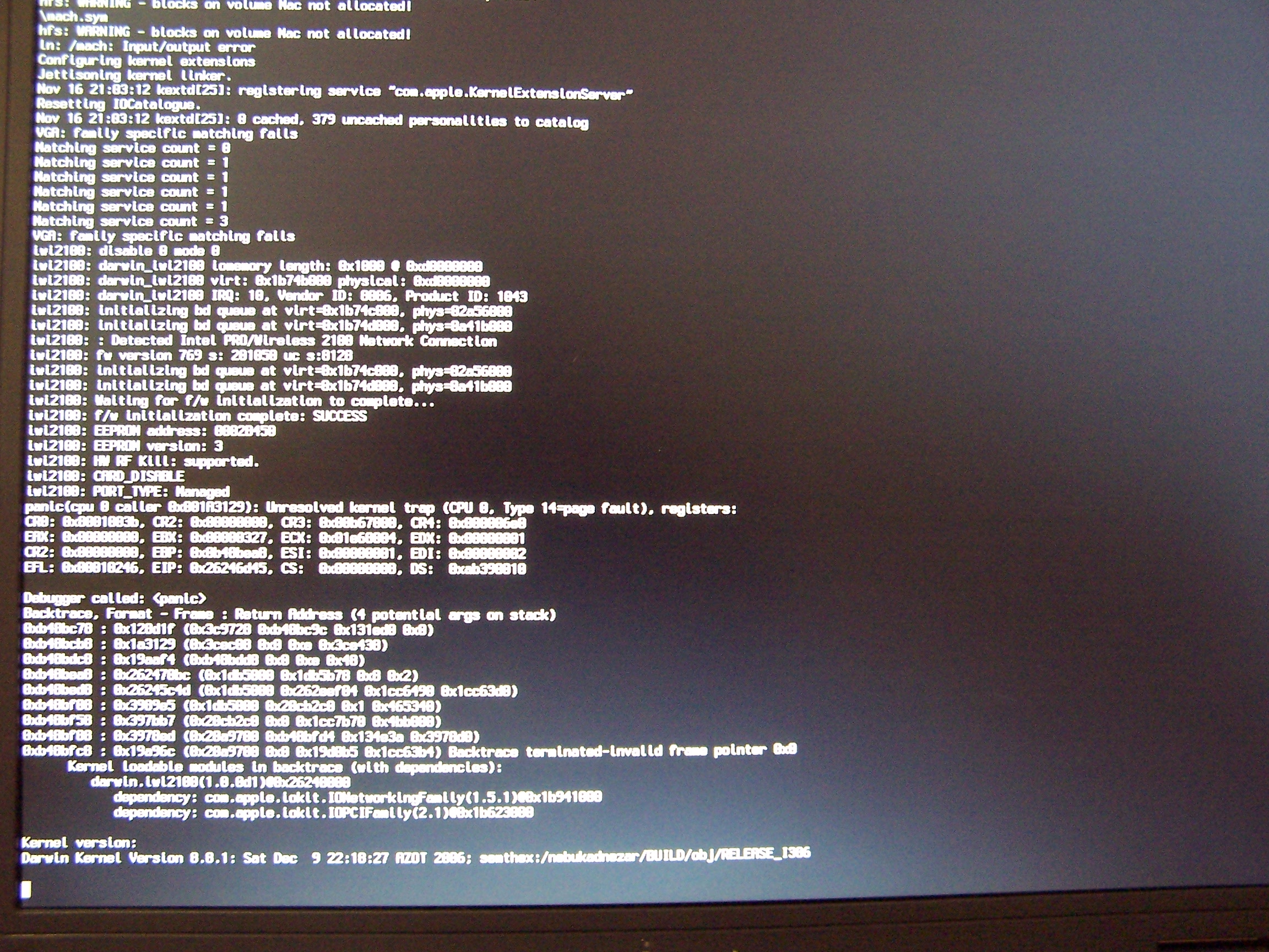

post the kp picture so i can check it
also try to boot with card powered on/off - might help
last release as a hack for power setting this can be the kp reason - but this might make the driver work

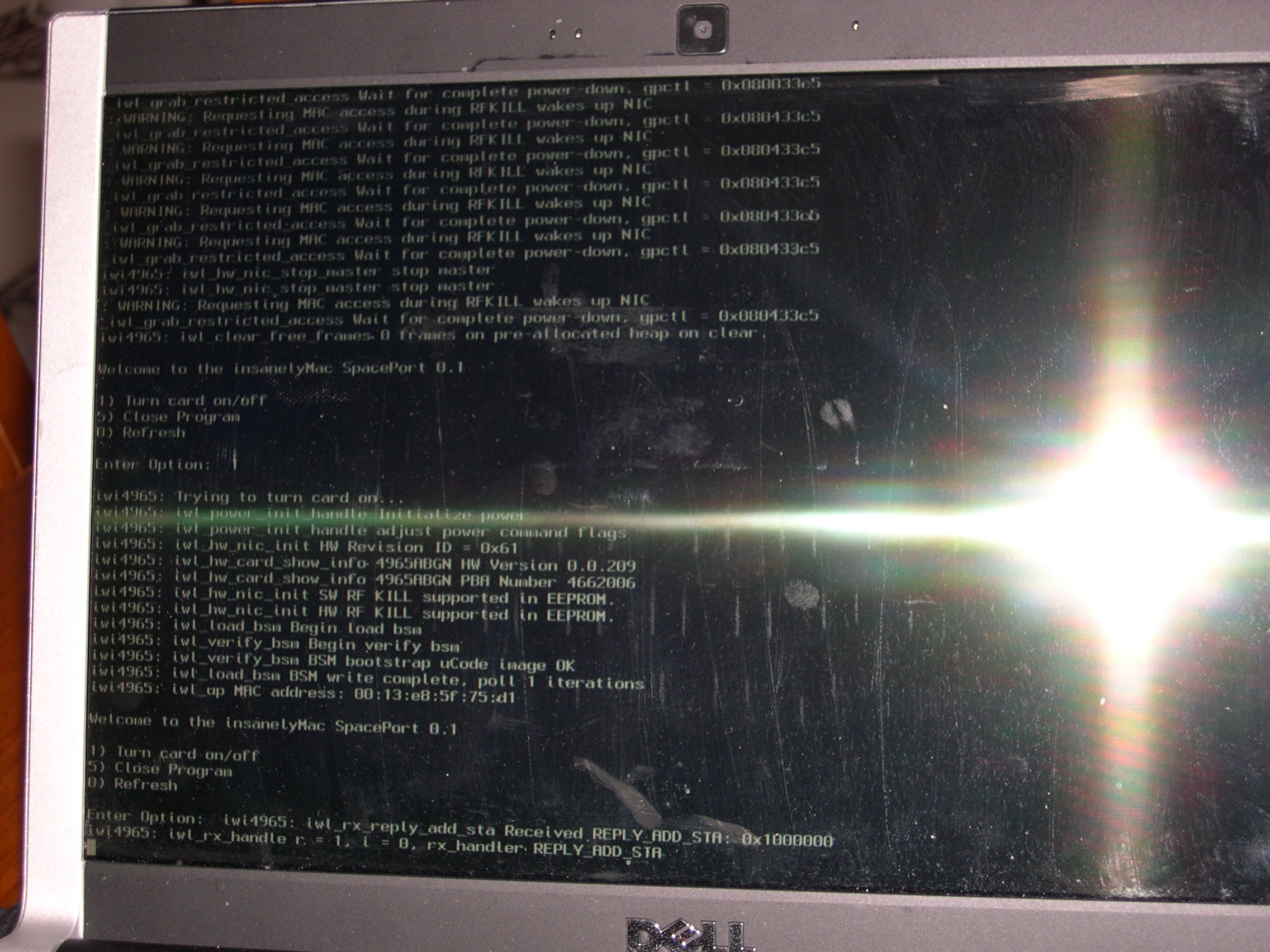

the computer freezes at the blue screen of os x boot up after exit from single user mode with networkSelector leaving the card on
If the card is off then os x boots up without freezing.
still get the previous unhandle: iwl_rx_handle UNHANDLED - #0x3a UNKNOWN reclaim? 0
also when turning the card off get the following
# Warning : requesting Mac access during RFKILL wakes up NIC _iwi_grab ... gpct1 = 0x080433c5
I will try again to getlogs for this, but for some reason the generate logs were empty.

my final test/post on this driver version (I swear!)
standard logs attached.
Don't think they are much different.
HOWEVER, one time I did not get the unhandle error.
Unfortunately in my excitement i typed exit into the networkSelector and it got stuck in a never ending loop.
After numerous attempts to repeat the process and get the same result I had no luck :)
I am also posting a picture of the success though (at least before I f*cked it up!)
so close ...

i'm expecting another kp picture - maybe not :P
