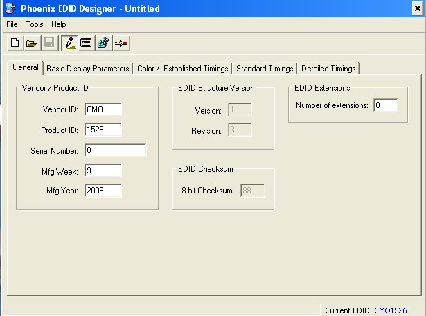

Lord Uffa Posted February 12, 2007 Share Posted February 12, 2007 Sheriffbounce: I post here since today I was not able to post in reply; I even tried to contact you PVT, but it seems I have problem with tis forum sw, dnt know why... Here is my edid - got it with phoenix - does it look like yours? manufacturer Monitor/LPL1289 hardware ID LPL1289 EDID BYTES: 0x 00 01 02 03 04 05 06 07 08 09 0A 0B 0C 0D 0E 0F ------------------------------------------------ 00 | 00 FF FF FF FF FF FF 00 32 0C 89 12 00 00 00 00 10 | 00 0F 01 03 80 25 17 78 0A 23 00 98 58 51 8C 29 20 | 26 50 54 00 00 00 01 01 01 01 01 01 01 01 01 01 30 | 01 01 01 01 01 01 A8 2F 90 E0 60 1A 10 40 20 40 40 | 13 00 6F E6 10 00 00 18 00 00 00 00 00 00 00 00 50 | 00 00 00 00 00 00 00 00 00 00 00 00 00 FE 00 4C 60 | 47 50 68 69 6C 69 70 73 4C 43 44 0A 00 00 00 FE 70 | 00 4C 50 31 37 31 57 45 32 2D 54 4C 30 33 00 70 all is working ok, except for audio, ATIinject, lan and wlan :-) but AFAIK it seems we'll have to wait and see for this - or do like you and buy a working card for wlan & lan Thank you in advance, Nick Link to comment https://www.insanelymac.com/forum/topic/36812-ati-mobility-x1600-x1700-and-others/page/9/#findComment-300940 Share on other sites More sharing options...

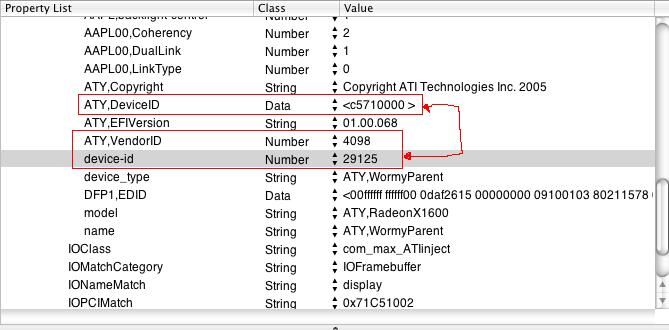

Lord Uffa Posted February 13, 2007 Share Posted February 13, 2007 (edited) SOLUTION!!! well, a sort of... This time I got it!!! Same results as Sheriffbounce (1680X1050 and reschange), but I've had to modify a couple of things: I must premit I started from the kext Sheriffbounce posted some time ago in this thread. First, IOPCImatch in Info.plist, and consequently Info2.plist, was wrong; was 0x00001002&0x0000ffff and should be 0x71C51002; In second place as I was getting nothing with the Info.plist with one monitor, I tried to put two identical edid in DFP1,EDID and LVDS,EDID - the keys of Info2.plist. and Tah dah!!! 1680x1050 and res change.... very good .... Many thanks to Sheriffbounce for he pointed me to the right direction. here is the kext I use: remember to modify accordingly with your configuration (EDID is good for hp9420, change it for your conf) cheers, Nick Nick's System: HP Compaq NX9420 Intel Core 2 Duo 1.83GHz working 1 core cold start and 2 cores after reboot from windows ... Mysterious core 1GB Ram 100GB SATA HDD working Ati Mobility x1600 Dev ID 71C5 working Laptop monitor vendor ID LPL1289 working Internal WLan: Intel 3945abg (not working) (YET) Embedded lan: bcm (not working) Bluetooth OK working OSX 10.4.8 JAS DVD ATIinject.kext.zip Edited February 13, 2007 by Lord Uffa Link to comment https://www.insanelymac.com/forum/topic/36812-ati-mobility-x1600-x1700-and-others/page/9/#findComment-301673 Share on other sites More sharing options...

Lord Uffa Posted February 19, 2007 Share Posted February 19, 2007 Hi, Try the way I described in my last post; I.e. Use plist editor to make changes; check : ---------:<-------- <key>IOPCIMatch</key> <string>0x71C51002</string> ---------:<-------- is written this way (no "&" in the middle) and put your edid in both places of the old Info2.plist (in my attached files is already named Info.plist) this way: ---------:<-------- <key>DFP1,EDID</key> <data> AP///////wAyDIkSAAAAAAAPAQOAJRd4CiMAmFhRjCkm UFQAAAABAQEBAQEBAQEBAQEBAQEBqC+Q4GAaEEAgQBMA b+YQAAAYAAAAAAAAAAAAAAAAAAAAAAAAAAAA/gBMR1Bo aWxpcHNMQ0QKAAAA/gBMUDE3MVdFMi1UTDAzAHA= </data> <key>LVDS,EDID</key> <data> AP///////wAyDIkSAAAAAAAPAQOAJRd4CiMAmFhRjCkm UFQAAAABAQEBAQEBAQEBAQEBAQEBqC+Q4GAaEEAgQBMA b+YQAAAYAAAAAAAAAAAAAAAAAAAAAAAAAAAA/gBMR1Bo aWxpcHNMQ0QKAAAA/gBMUDE3MVdFMi1UTDAzAHA= </data> <key>device-id</key> ---------:<-------- after that, rm -rf /System/Library/Extensions.mkext rm -rf /System/Library/Extensions.kextcache be careful not to rm the whole Extensions dir (yes, I did this once, too many yawns at 3.00 am LOL). keep us informed, cheers, Nick Nick's System: HP Compaq NX9420 Intel Core 2 Duo 1.83GHz 1GB Ram 100GB SATA HDD Ati Mobility x1600 Dev ID 71C5 Laptop monitor vendor ID LPL1289 Internal WLan: Intel 3945abg NOT working (yet) Embedded ethernet Broadcom netxtreme M ven 14e3 dev id 16fd NOW WORKS!!! Bluetooth OK OSX 10.4.8 JAS DVD Link to comment https://www.insanelymac.com/forum/topic/36812-ati-mobility-x1600-x1700-and-others/page/9/#findComment-306530 Share on other sites More sharing options...

ninetto Posted February 19, 2007 Share Posted February 19, 2007 dear monsiuer LORD UFFA, yes, congrats on the success! now I think I am also very close: your tip to check the string after <key>IOPCIMatch</key> looks IMPORTANT... mine did in fact have the deadly "&" mess in there like this: <string>0x00001002&0x0000ffff</string> BUT can you tell me what the data in this string is refering to? Did you change it manually? thanks for any advice in advance... regards, ninetto p.s. my laptop is a Mitac barbone (goes by the name Nexoc in Deutschland) Link to comment https://www.insanelymac.com/forum/topic/36812-ati-mobility-x1600-x1700-and-others/page/9/#findComment-306860 Share on other sites More sharing options...
DiaboliK Posted February 19, 2007 Share Posted February 19, 2007 (edited) dear monsiuer LORD UFFA, yes, congrats on the success! now I think I am also very close: your tip to check the string after <key>IOPCIMatch</key> looks IMPORTANT... mine did in fact have the deadly "&" mess in there like this: <string>0x00001002&0x0000ffff</string> BUT can you tell me what the data in this string is refering to? Did you change it manually? thanks for any advice in advance... regards, ninetto p.s. my laptop is a Mitac barbone (goes by the name Nexoc in Deutschland) yes that would be the string to edit: change it to: <string>0xXXXX1002</string> where XXXX being one of the 13 device id's for the X1600, set it to yours it would be one of the following: 0x7140, 0x7181, 0x71a1, 0x71c0 0x71c2, 0x71c5, 0x71cd, 0x71e0 0x71e2, 0x71e6, 0x71ed, 0x1a1 0x7160 you can find out in windows device manager. help that helps a few out. -DiaboliK Edited February 19, 2007 by DiaboliK Link to comment https://www.insanelymac.com/forum/topic/36812-ati-mobility-x1600-x1700-and-others/page/9/#findComment-306879 Share on other sites More sharing options...
Lord Uffa Posted February 20, 2007 Share Posted February 20, 2007 (edited) Yes, follow Diabolik instructions and insert it by hand using plist editor: http://it.wikipedia.org/wiki/Property_List_Editor remember to change your edid, though. cheers, Nick Edited February 20, 2007 by Lord Uffa Link to comment https://www.insanelymac.com/forum/topic/36812-ati-mobility-x1600-x1700-and-others/page/9/#findComment-307287 Share on other sites More sharing options...

ninetto Posted February 21, 2007 Share Posted February 21, 2007 YIKES, this thread is gettin' long and tiresome... BUT please one last query... Of course I have added my EDID to Nick's KEXT and I have changed my device ID as Nick/Diabolik mentioned in the STRING after IOPCImatch... But for SOME CRAZY and I'm sure LOGICAL reason, my HackinLaptop' still keeps the old ID "0x71c5" instead of my corrected ID "0x71c2". MY QUESTION: Is there some other line where the device ID for the screen has to go? Other plist? regards, ninetto Link to comment https://www.insanelymac.com/forum/topic/36812-ati-mobility-x1600-x1700-and-others/page/9/#findComment-308035 Share on other sites More sharing options...
ninetto Posted February 22, 2007 Share Posted February 22, 2007 OK, even though I have not had success yet (UPADTE : yes-yes-yes with DUAL DISPLAY and PURE DVI, see signature) with my ATI x1600 mobility(256MB +256) in a Mitac Barebone/15.4 Screen/Core 2 duo 7200 Laptop I'll list a summary of "things-to-do" for others, to recap this long thread. If there is something I got wrong or someone wants to add, please do. 1. Get your EDID of your internal screen with Phoenix-Tool. Format it with TextEdit into blocks of 8 characters. Now is also the time to plug in your secondary display and get its EDID too, if you want to try to add that in the playlist also. 2. Get the device ID of your card, via e.g. Device Manager. It will be a six digit looking something like "0x71e2" 3. There are different flavors of ATIkexts out there, lots of them in fact. There seems to be conflicting reports if it is enough to just use ATIINJECT + ATIDRV (see http://forum.insanelymac.com/index.php?showtopic=36462) or THE MAXX3200 original post, but there are lots of success stories using all three files, including IONDRVSupport.kext from the older JAS 10.4.5 DVD like SHIERRFBOUNCE (post#25). SHIERFBOUNCE was kind enough to post many modified kexts. Pick one close to your machine. Somewhere I read that you should remove a lot of the original ATIrage/radeon.kexts, plus Natit/Callisto first... but I am starting with a clean install so I ignored this advice. ANBODY know the bottom-line on THIS??? 4. Editing the plist in ATIINJECT with Playlist editior (get it at:here). This is where things get a bit murky. There are two plists. It seems like info.plist is the IMPORTANT one & info2.plist has an effect on secondary displays. I edit the kext before placing them in the extensions folder. The EDID is crucial: original instruction was that LVDS,EDID was for internal display and DFP1 for external, but at least one person had success when placing his EDID in BOTH lines. Be really careful inserting the EDID not adding spaces or deleting the "<>" ... that screwed me up at least once. 5. Editing the plist (contd.) Check the IOPCIMatch Key to be sure your Device ID (step 2) is correctly displayed. It should be "0xXXXX1002" where the large XXXX is your device ID. Delete any "&..." garbage in this key. 6. Save info.plist. Some people have deleted one or the other plists, using only one. I don't know what effect or logic is behind this. I have only one plist in my version. 7. Insert ATIINJECT and ATIDRV kexts. (option: also IONDRVSupport.kext?) into SYSTEM/LIBRARY/EXTENSIONS 8. as usual, open terminal type: sudo -s enter ur password cd /system/library/extensions chown -R root:wheel atiinject.kext chmod -R 755 atiinject.kext 9: NEW: for the fast and super easy was to add new kexts without all the terminal typing check out KEXT HELPER http://forum.insanelymac.com/index.php?sho...;hl=kext+helper Then you can ignore all the parts in STEP 8! Highly recommended, especially for noobs... GOOD LUCK to ALL! regards, n.m. Link to comment https://www.insanelymac.com/forum/topic/36812-ati-mobility-x1600-x1700-and-others/page/9/#findComment-308765 Share on other sites More sharing options...
