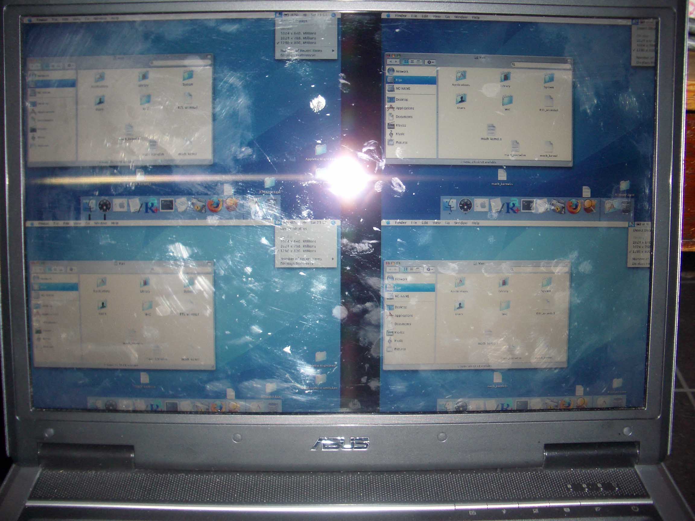

mac sussed Posted January 7, 2007 Share Posted January 7, 2007 Thanks walterav. My x1600 mobility is still not functioning properly. Every other boot it shows alternate black and white stripes. When it does boot to a desktop, the screen is split into four like in the attached photo, but it does show 1280x800 now. I have reverted to Semthex kernel from Mifki, both from Jas 10.4.8 DVD. I am using 10.4.5 ATINDRV.kext and IONDRV.kext from the Apple download. ATIinject.kext came from this #1 post. I put the EDID's in using Apple Property List Editor sourced from the Useful files in the Genius Bar. Link to comment https://www.insanelymac.com/forum/topic/36812-ati-mobility-x1600-x1700-and-others/#findComment-269857 Share on other sites More sharing options...

mac sussed Posted January 10, 2007 Share Posted January 10, 2007 (edited) The ASUS F3JA has QE/CI without any modification on 10.4.8 but it has slight mouse tearing issues and non-native resolution (1024x768). These are the reasons why I want to get I want to get ATIinject working with my laptop. I think it is a problem with the EDID data as to why my screen shows four mini desktops with ATIinject. I get the feeling that the display is trying to output 2560x1600, hence the four 1280x800 desktops. If I understood EDID data and was confident, I would try to edit the string to output correctly. Here is my data:- 00FFFFFF FFFFFF00 0DAF2615 00000000 09100103 80211578 0AC6A99A 574E8526 1E505200 00000101 01010101 01010101 01010101 0101BC1B 00A05020 17303020 36004BCF 10000018 000000FE 004E3135 3449322D 4C30320A 20200000 00FE0043 4D4F0A20 20202020 2020A020 000000FE 004E3135 3449322D 4C30320A 20200088 Edited January 11, 2007 by mac sussed Link to comment https://www.insanelymac.com/forum/topic/36812-ati-mobility-x1600-x1700-and-others/#findComment-272858 Share on other sites More sharing options...

mac sussed Posted January 11, 2007 Share Posted January 11, 2007 The only difference between our EDID data is the 111th byte, which is A0 in yours and 20 in mine. This could be as simple as a reference to the panel manufacture date. Link to comment https://www.insanelymac.com/forum/topic/36812-ati-mobility-x1600-x1700-and-others/#findComment-273694 Share on other sites More sharing options...
sheriffbounce Posted January 11, 2007 Share Posted January 11, 2007 (edited) okay fellas got it working!!! used JAS 10.4.8 + ATINDRV.kext + IONDRVSupport.kext from the older JAS 10.4.5 DVD entered my EDID in info.plist and info2.plist repaired permissions etc and.... got QE/CI res changed and all the stuff fully working nice to have 1600*1050 on the internal display finally cheers sheriff Edited January 12, 2007 by sheriffbounce Link to comment https://www.insanelymac.com/forum/topic/36812-ati-mobility-x1600-x1700-and-others/#findComment-273739 Share on other sites More sharing options...
