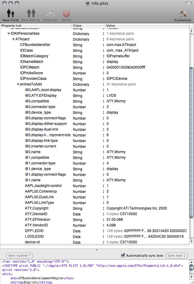

I write a guide on X1700 topic included some basic information . In short , you need phoenix editor for windows to get EDID . About how to group it to use in plist read my guide .
Okay, I managed to get EDID info from windows.. (had to install it on different HDD)..
My second laptop is Acer Aspire 5110 (5112WLMi) with X1600 graphics.
If someone could paste this in a right place, would be awesome.

Okay now I have made my FireGL V5200 work perfectly under Leopard.
This is how I do:
1. Edit the ATIRadonX1000.kext 's info.plist, add the model number x71C41002 into the PCIMatch list
2. Edit the EDID info in the ATIinject.kext download form this thread, then put it in the exenstion folder.
this is my Thinkpad T60p's EDID (1400x1050):
00FFFFFF FFFFFF00 30AE2240 00000000 000F0103 801D1578 EA2D0597 57518A27 23505421 08008180 01010101 01010101 01010101 0101302A 7820511A 10403070 13001ED6 10000019 25237820 511A1040 30701300 1ED61000 00190000 000F0090 43329043 280F0100 4CA35034 000000FE 004C544E 31343150 342D4C30 320A0019
3. change the permission and owner.
4. reboot, all now perfect.

insert into LVDS,EDID and DFP1,EDID

Augh I'm getting so frustrated but I think I'm really close. I used the files from this thread:http://forum.insanelymac.com/index.php?showtopic=77685
With the files on my Leopard Desktop, I edited the atiinject.kext plist using plist editor and added my EDID to the LVDS for the CMO1523 Hardware ID which is:
 <00FF FFFF FFFF FF00 0DAF 2315 0000 0000 0000 0103 8021 1478 0A77 F1A0 5A4B 9624 184F 5400 0000 0101 0101 0101 0101 0101 0101 0101 0101 7C2E 90A0 601A 1E40 3020 3600 4BCF 1000 0018 0000 00FE 004E 3135 345A 312D 4C30 320A 2020 0000 00FE 0043 4D4F 0A20 2020 2020 2020 2020 0000 00FE 004E 3135 345A 312D 4C30 320A 2020 00F8>
Not touching anything else I save the file, move the atiinject.kext and atindrv.kext to /system/library/extensions.
From there I go to Terminal:
sudo -s
chmod -R 755 ATIinject.kext ATINDRV.kext
chown -R root:wheel ATIinject.kext ATINDRV.kext

try using my post: http://forum.insanelymac.com/index.php?sho...=0&p=571627
i have ATI X1600 mobility in LG and i got it to work, this thread have all the attachments needed and very detailed explanations.
please note that even after i succeeded sometimes it boots into a black screen or black and white stripes and then black screens, the only thing i can do for that is reboot and again until it boots correctly, that said there is a voodoo remedy: when booting press one or more key (any key will do) on the keyboard during gray apple screen.
if it doesn't help use verbose and/or fix permission load mode (at startup press F8 in the prompt write: -v -f and press enter) this will load somewhat slower causing the ATI driver to be ready and the inject to work properly.
hope you will get there, tell me if i can help more.
