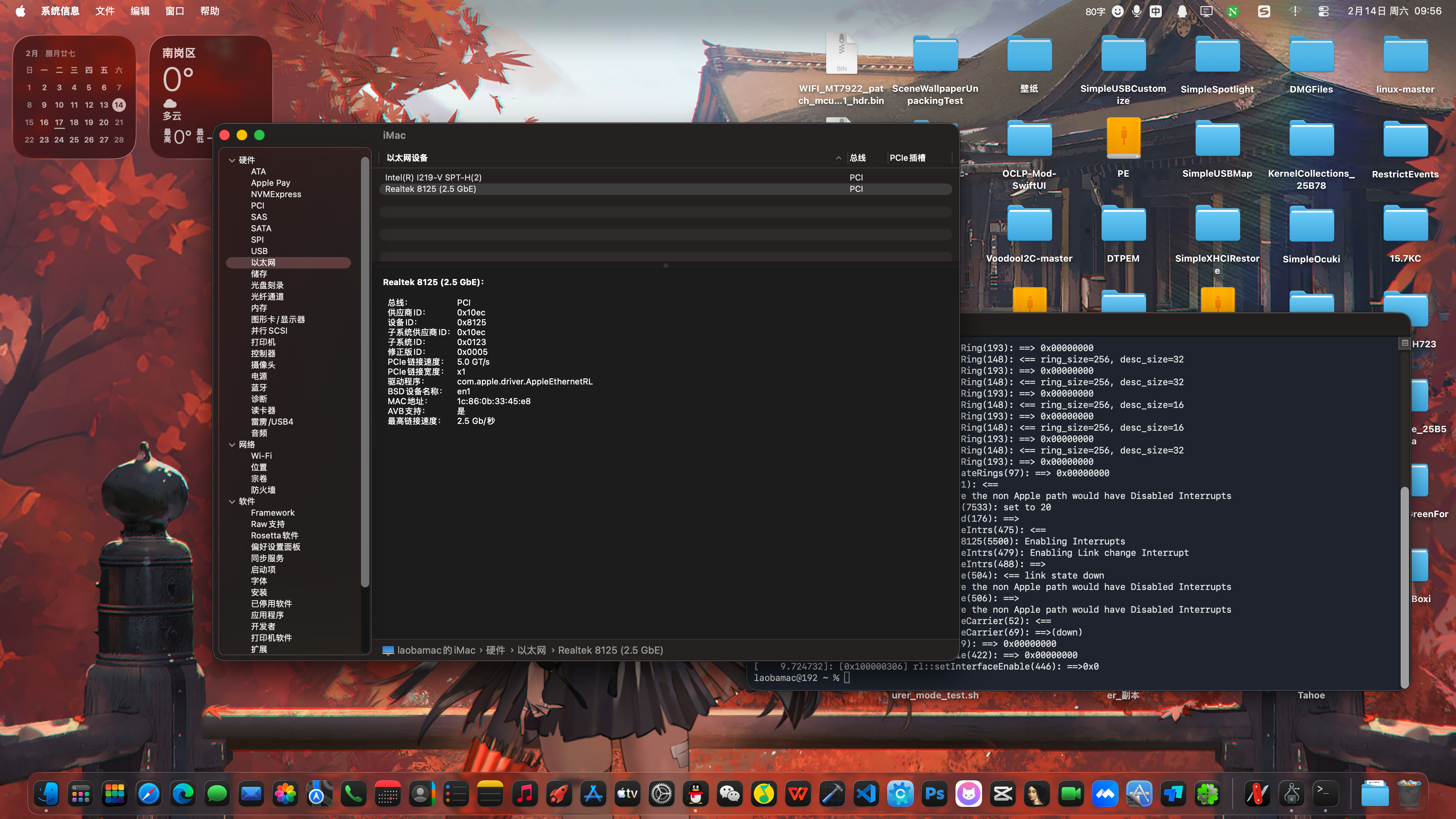

After update to 26.3,
I simply applied some patches to AppleEthernetRL, which allowed me to register my network card interface, but unfortunately, I couldn't access the internet.
Apple seems to have made some customization to the network card firmware, such as some PHY addresses being changed.
Perhaps someone will conduct more detailed decompilation research on it in the future, but that would be a waste of time.

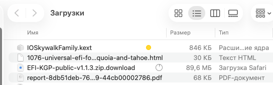

Thanks, I will take your version of IOSkywalkFamily.kext but... the download is not finishing. May be because of VPN which I am forced to use.
Download works here without issues, just checked on that: 87.79 MB downloaded successfully. 👍

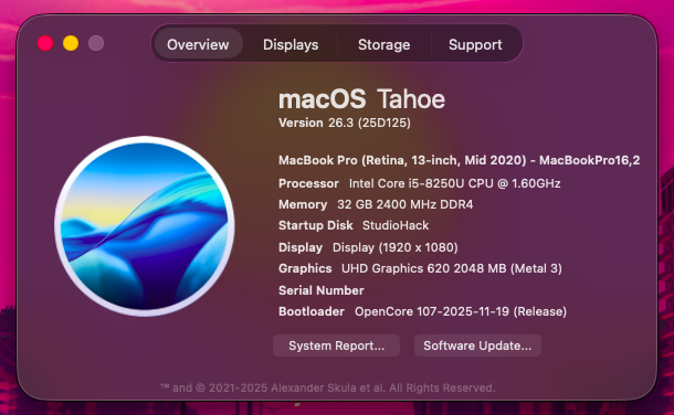

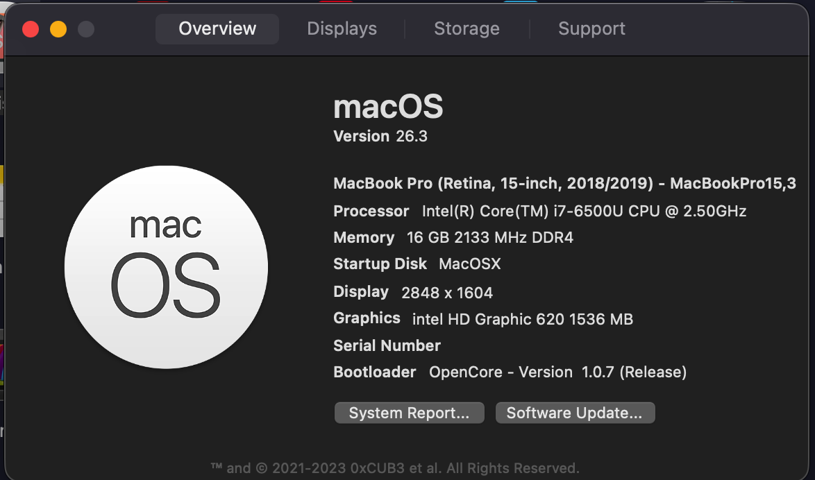

Haven't posted here in a while. I was postponing the upgrade from Sequoia but today I decided to prep and do it on an old laptop collecting dust around. Everything is working as expected. @laobamac_yyds's patch has been applied for full Wifi and audio capabilities. My system kernel panicked at first but I was able to find and fix the issue quickly, it was misconfiguration with the AMFI kext/boot args.
HP EliteBook 840 G6 | i5-8250U | 32GB DDR4 | WD Black SN770 1TB NVME | BCM94360NG

On 2/23/2026 at 4:20 AM, Slice said:
But not for me
And stop forever.

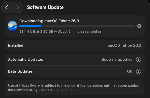

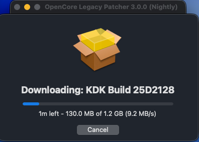

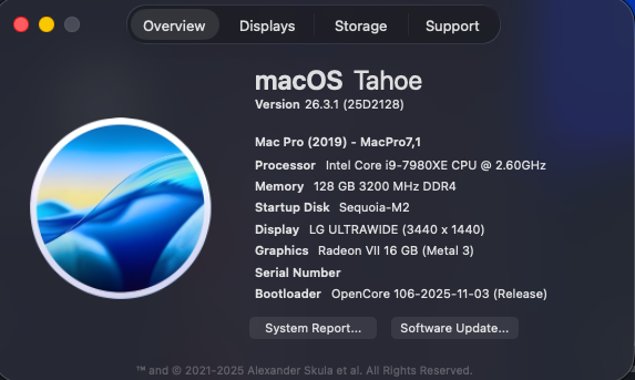

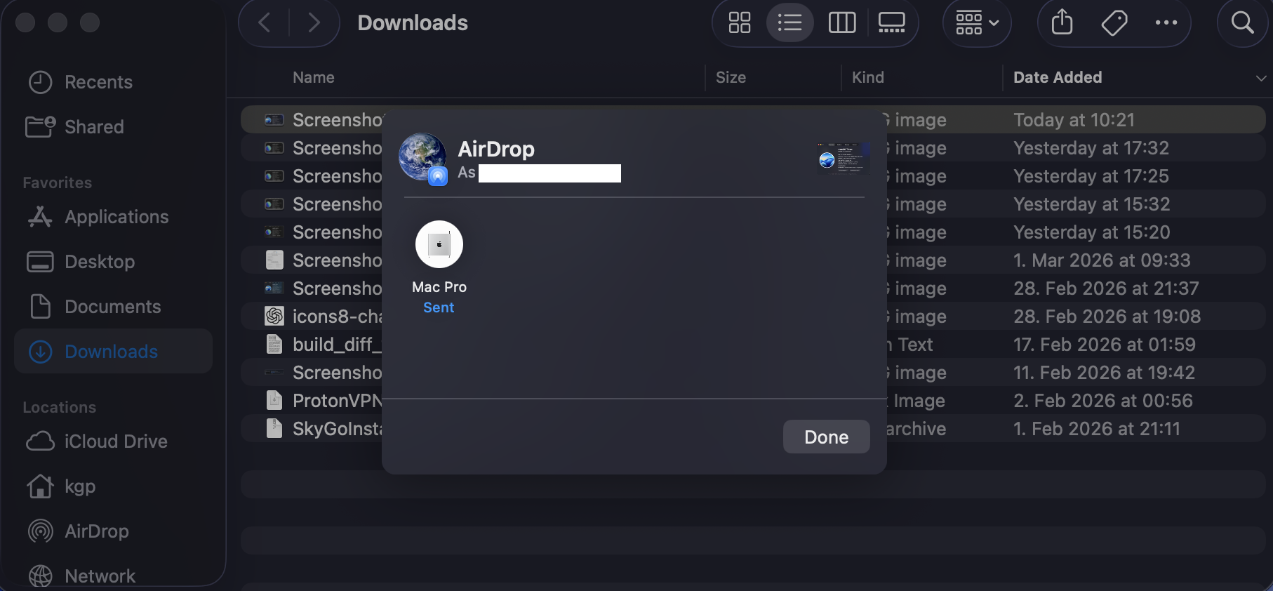

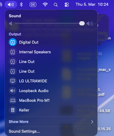

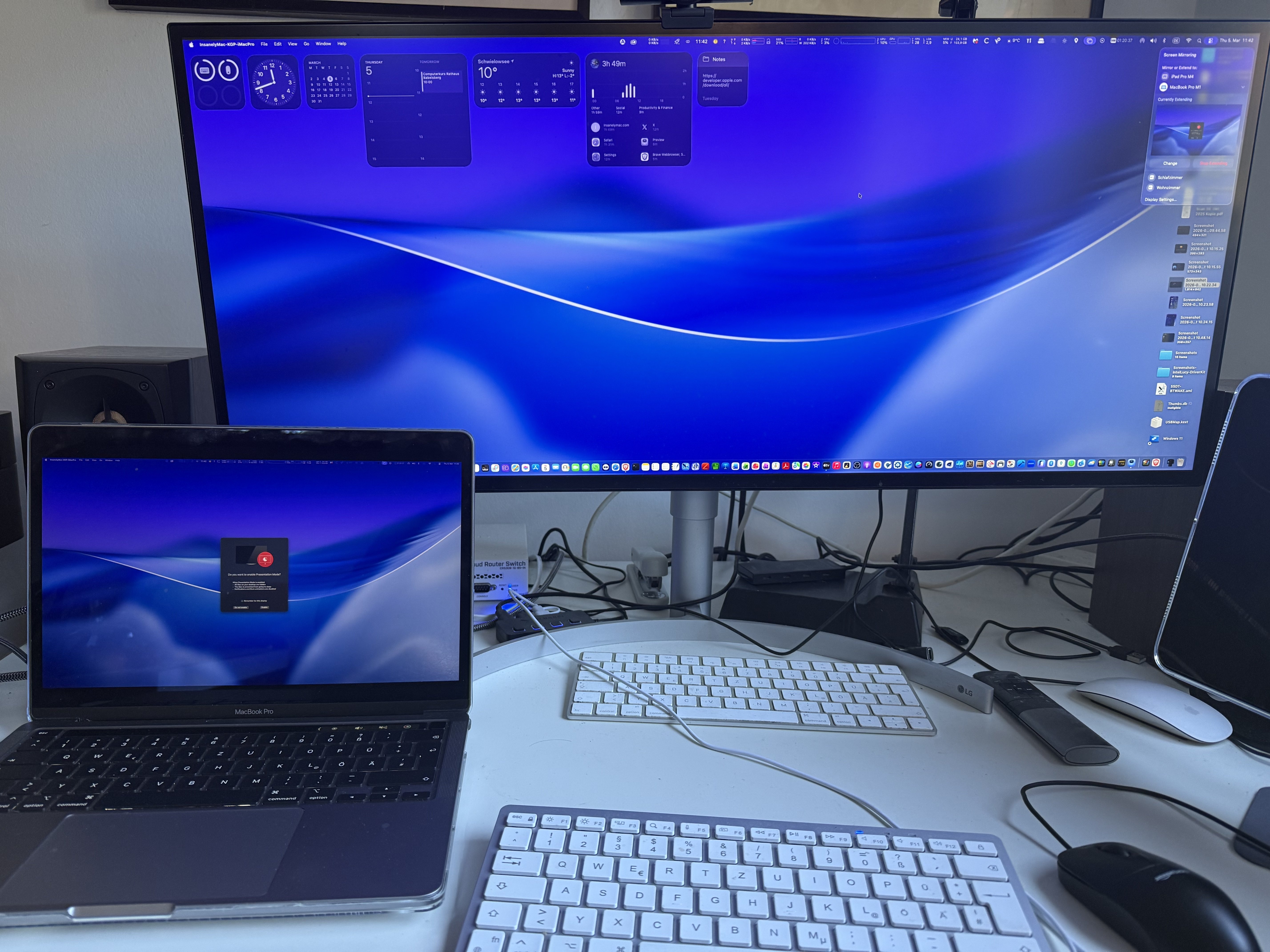

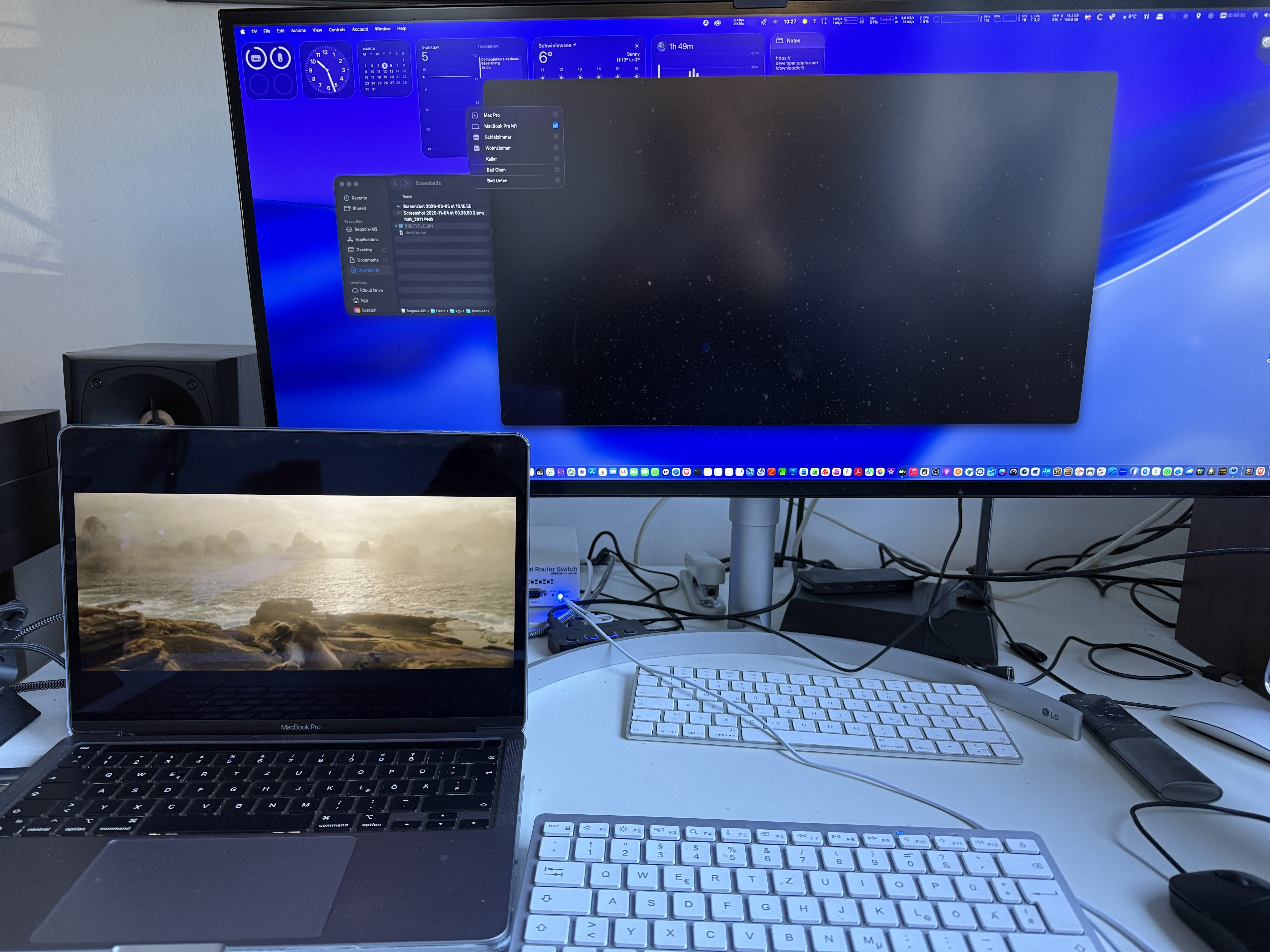

Painless OTA update to macOS Tahoe 26.3.1 (25D2128) with Whatevergreen 1.7.1d7.

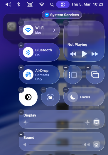

Audio and Wi-Fi with Airdrop, Airplay and Screen Mirroring successfully tested with OCLP 3.0.0 Nightly available on my Github repository in line with my BCM943602CDP.
System booted with the Broadcom-EFI of my EFI-Folder Distribution with AMFIPass.kext 1.4.1 enabled and using boot-arg "amfi=0x80". Everything by exactly following my OCLP guidelines
I'm a little confused. The OCLP 3.0.0 Nightly github says not to use AMFIPass.kext, but you're using both AMFIPass.kext and the "amfi=0x80" option at the same time. What does "using both at the same time" mean? If I use both, will I still be able to use Broadcom WiFi and audio? No kernel panics?
  • Like 3
I was definitely using AMFIPass.kext 1.4.1 (enabled) with boot-arg "amfi=0x80" over the recent months on my system (totally forgot about this tiny detail) and therefore corrected all respective guidelines yesterday. The description on Github just remains without unchanged yet. When just using boot-arg "amfi=0x80" without AMFIPass.kext enabled, AWDL refuses to work on my system. Apart from this difference, the system also boots with AMFIPass.kext disabled, but only Wi-Fi and AppleHDA are working (no AWDL). Try at first place,  if AWDL is working on your system with  boot-arg "amfi=0x80" and  AMFIPass.kext disabled. I can just talk about my system und EFI-Folder configuration. You might likely want to do the tests on a test drive and not on a productive system. In any case, always have a second EFI on a separate bootable disk with "amfi=0x80" and AMFIPass.kext disabled.
