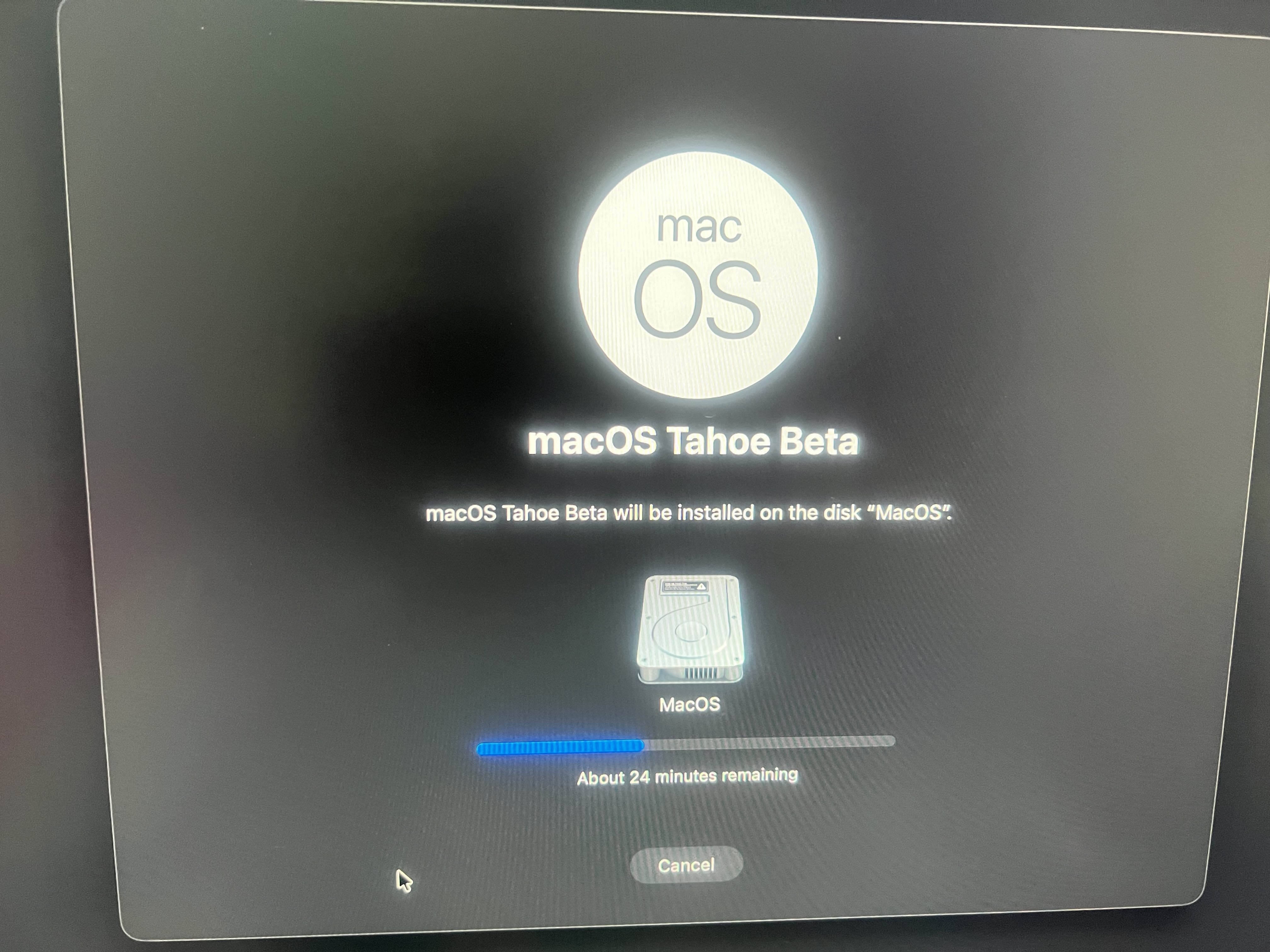

.For me, this Tahoe is a strange entity.
I still can't make an installer USB configured with the RX580 as primary Graphics.
It has to be the Integrated CPU UDH 630 Graphics without the WEG.kext enabled.
I will try again with the next released Beta.
I have configured a USB EFI Installer and used RX580 as the primary Graphics.
Additionally I have initiated an Upgrade for Tahoe from the Desktop and  separately also via a FULL Install from the OC boot menu
by erasing the drive clean and installing a fresh copy of Tahoe. ie. setup as Headless mode in config.plist
Firstly in bios I set these parameters.
PEG set as primary.
Mirror Display ON
4g Graphics OFF
The minimal kext I use are Lilu, NVMeFix, REALTEKTL8111 (Ethernet for my System), RestrictEvents, USBPort, VirtualSMC, WatereverGreen.
The rest of the settings in EFI would be configured for your particular  motherboard/video card combo.
Oh bye the way this is for my Intel System ASUS PRIME Z370-P
Hope this helps.

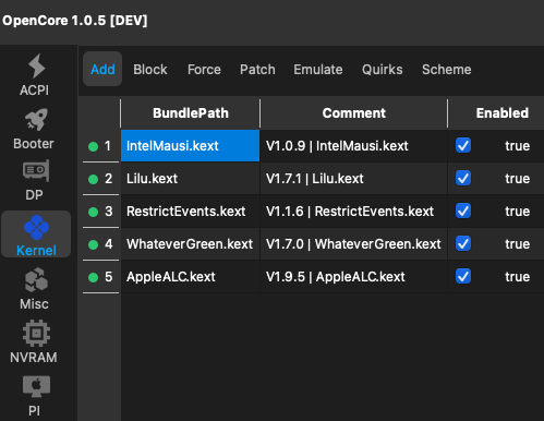

@eSaF
The pic you posted in this comment is practically the same as what I have; everything is the same except for MaxKernel, where 24.20.00 and 24.99.99 have the same functionality.
Since I have an RX 6600 XT and MacPro 7.1 SMBIOS,I don't have the issue you're referring to with the USB installer. In my case, the same BIOS settings, hardware and EFI work for both the USB installer and Tahoe already installed.

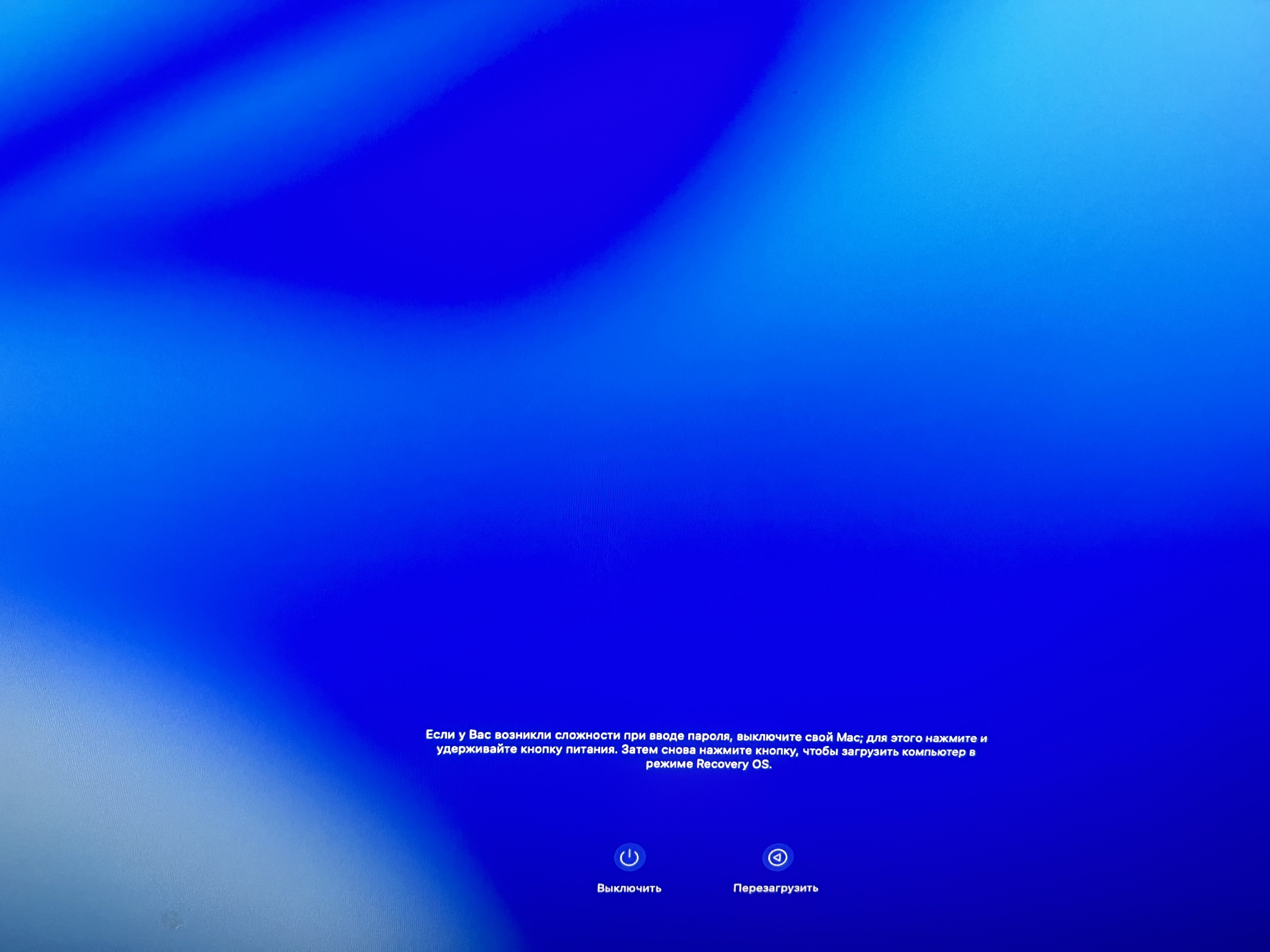

Just now, Anto65 said:
From your picture you posted
" If you have trouble entering your password, turn off your Mac by pressing and holding the power button.
Then press the button again to boot the computer into Recovery OS mode.
Shutdown
Restart "  🤷‍♂️
Yes, thank you very much! I figured it out😂

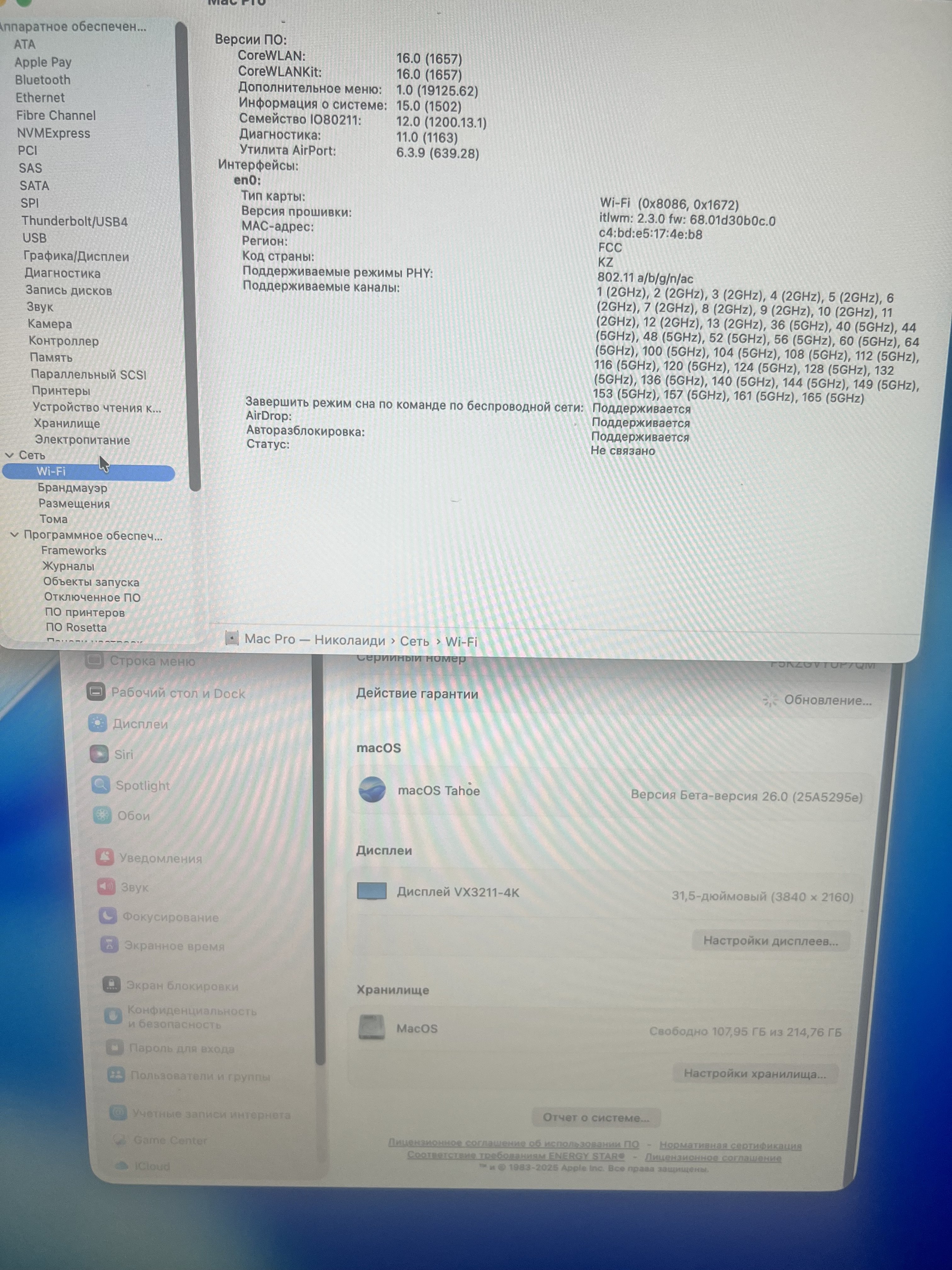

To sum up, the USB ports are working, sleep is working, and there is sound via DP on the monitor. FileVault disabled it via recovery mode. As expected, WI-FI does not work)).  Thank you all so much for your help! You are the best!
