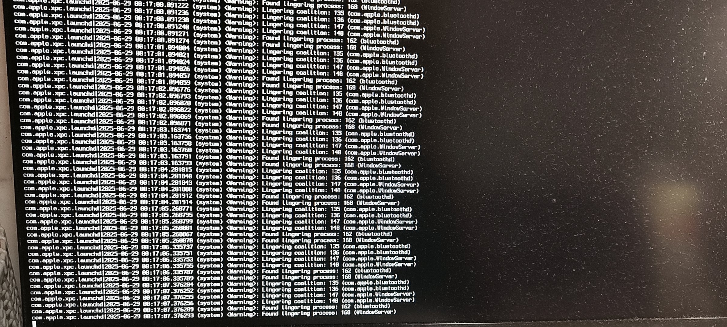

Irish_Man Posted June 29, 2025 Share Posted June 29, 2025 2 hours ago, laobamac_yyds said: I compiled a metallib and use Metal.framework(13.2.1-24),but timeout for WindowsServer🥶 It boot well in the whole process,but cause timeout and reboot at when about to enter the user interface of the system.....😖 Do you have any ideas? Attached is the list of metallib and patches I compiled. https://drive.google.com/file/d/1D28Q5VuWs5CqL3UTdnCZmvoX3jX9cSNB/view?usp=share_link and the patch_dict https://drive.google.com/file/d/1J0cgQ82vvYAUkEzwFR2fE1vp9n61Yw_M/view?usp=share_link ps:trying to fix Kepler on Tahoe Spoiler It's funny, I've seen these errors during shutdown/sleep where Bluetoothd and WindowServer are failing to terminate cleanly. In my case the fix was USB mapping and Device Properties input for GPU. Link to comment https://www.insanelymac.com/forum/topic/361162-pre-release-macos-tahoe/page/72/#findComment-2835403 Share on other sites More sharing options...

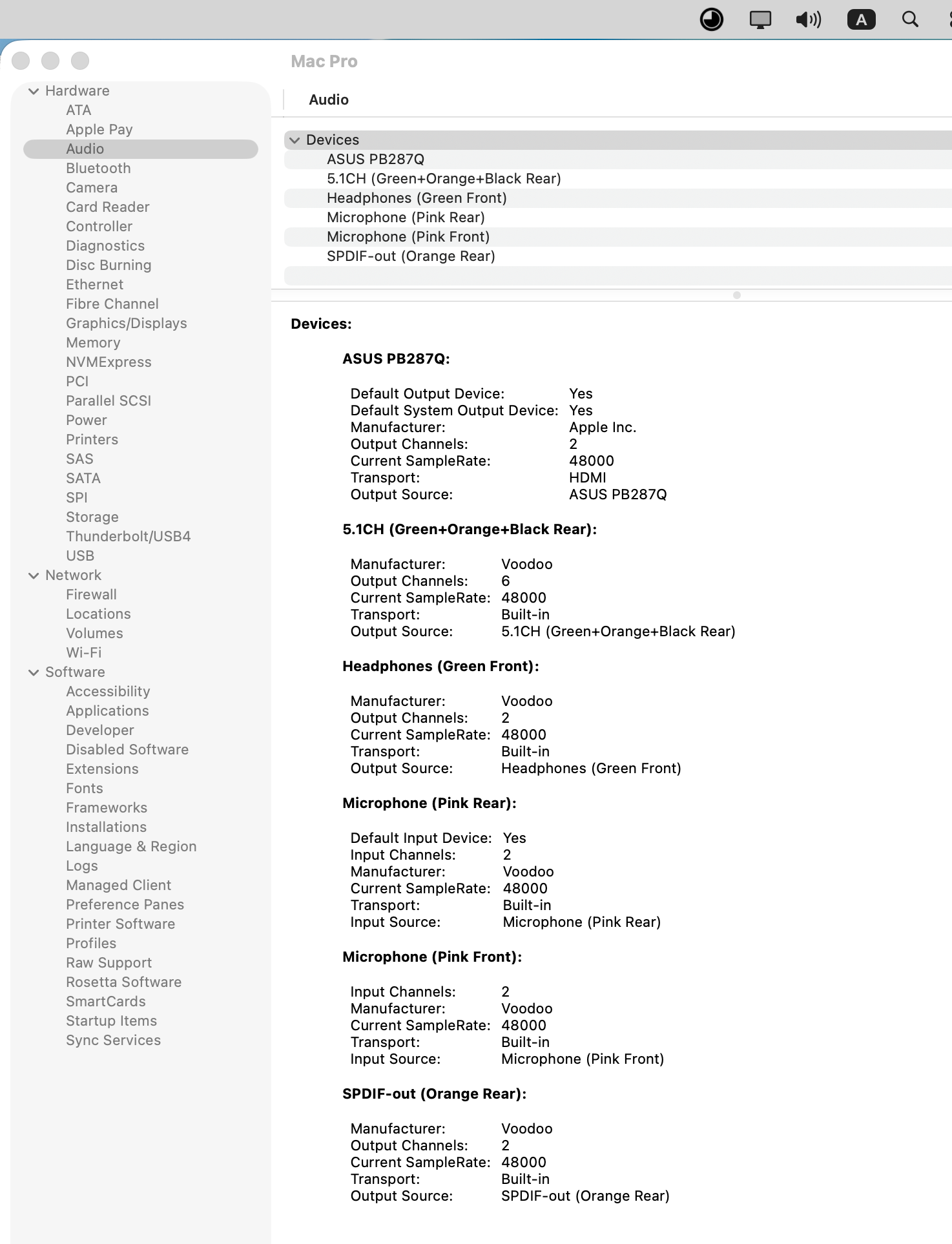

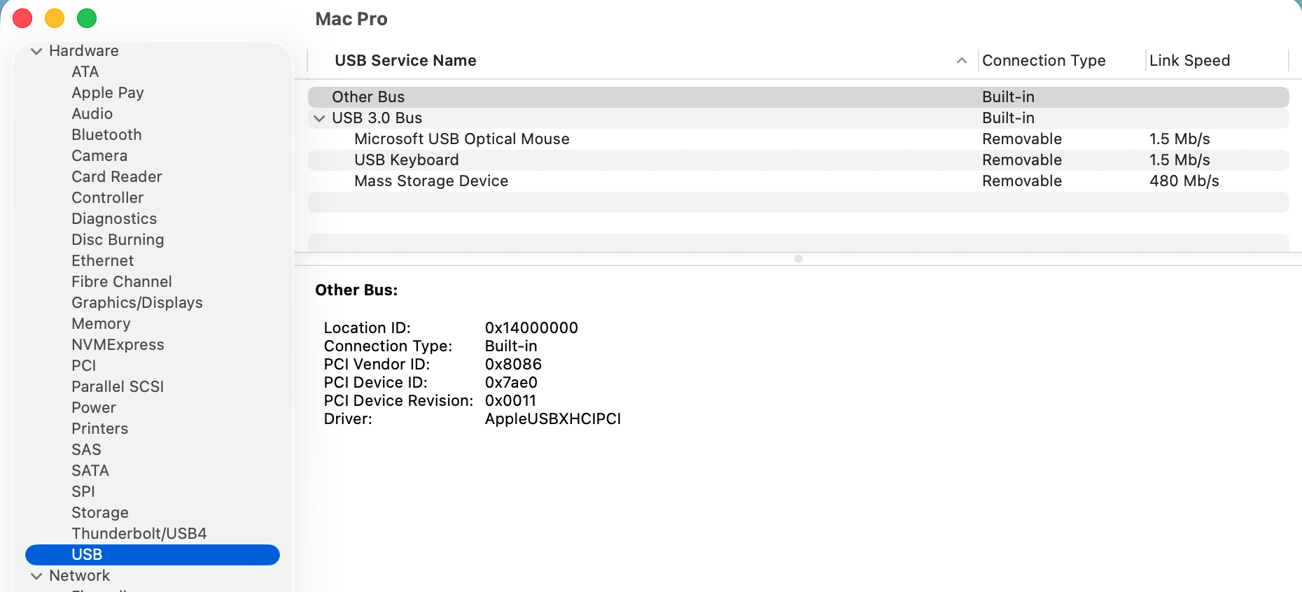

macky1 Posted June 29, 2025 Share Posted June 29, 2025 (edited) 1 hour ago, ANTIKO said: To sum up, the USB ports are working, sleep is working, and there is sound via DP on the monitor. FileVault disabled it via recovery mode. As expected, WI-FI does not work)). Thank you all so much for your help! You are the best! Reveal hidden contents If you want sound via external speakers we are using VoodooHDA which works surprisingly well. Thanks to @Chris1111 https://github.com/chris1111/VoodooHDA-Tahoe Edited June 29, 2025 by macky1 1 2 Link to comment https://www.insanelymac.com/forum/topic/361162-pre-release-macos-tahoe/page/72/#findComment-2835405 Share on other sites More sharing options...

laobamac_yyds Posted June 29, 2025 Share Posted June 29, 2025 11 minutes ago, STLVNUB said: Well After A Lot Of Stuffing Around And Trial And Error, I Join The Elite And Have One Clover EFI Folder Booting Sequoia AND Tahoe Now To Fix Up Sound And Intel Wifi, Then I'll Be A Happy LITTLE Chappie Any Pointers On Fixing Sound And Wifi Welcome For most sound cards, it is recommended to choose OCLP Mod and AppleALC to use the AppleHDA driver for better performance. Why choose VoodooHDA when SIP is lost in response?😅 3 hours ago, surenmunoo said: The below is what ChatGPT says if its any help. This issue typically means: WindowsServer fails to start (often due to broken GPU acceleration). You're dropped into launchd’s restart loop because the graphical interface cannot initialize. 🧠 Key Observations from the Screenshot: Messages like: makefile CopyEdit (Warning): Lingering coalition: 166 (com.apple.WindowServer) strongly indicate WindowServer crash or stall, confirming your suspicion. 🎯 Causes Specific to Kepler on Sequoia: Kepler is officially unsupported in macOS Sequoia (macOS 15). Apple removed support for non-Metal 3.x and older shaders. Even with a patched metallib, you may also need binary patches to: Skip Metal device checks. Allow older GPU families. Prevent system daemons from crashing on unsupported features. Your metallib may not be compatible with the full Metal API expectations in Sequoia. If shaders or Metal functions are missing or incorrect, WindowServer may crash or hang during rendering setup. Missing GPUDevicePolicy patches — these are common when AppleGraphicsControl.kext prevents acceleration. On older macOS versions we use agdpmod=pikera or similar boot-args. You may need similar tricks (but patched for Sequoia). ✅ Suggestions: 1. Check GPU Acceleration Logs Use -v debug=0x100 keepsyms=1 (you probably already are) and look earlier in the boot log: Do you see messages like: makefile CopyEdit IOAccelerator: Metal device not supported or lua CopyEdit GFX firmware load failed or makefile CopyEdit IOService: matching failed for AppleMGPUPowerControl These will confirm failure to load GPU acceleration. 2. Try Headless Boot to Disable WindowServer Try booting with: bash CopyEdit nv_disable=1 -v debug=0x100 keepsyms=1 This disables Kepler acceleration to test if system boots without starting WindowServer. If it boots: you have a working system minus graphics acceleration. That confirms it's purely GPU related. 3. Add/Check These Kernel Patches: IOAcceleratorFamily2 patch to allow unsupported GPUs. Patch AppleMGPUPowerControl or AGDC to skip model checks. Consider applying OCLP-like patch sets manually if using a Hackintosh. 4. Try Lilu + WhateverGreen (latest betas): Even if they're not designed for Kepler on macOS 15, they: Inject missing framebuffer properties. Bypass some AppleGPU policies. Work better with patched metal libraries. Also use boot-args: diff CopyEdit -wegbeta -lilubetaall gfxrst=1 agdpmod=pikera 5. Use a Patched/Stub WindowServer (for debugging) In some cases, you can replace /System/Library/CoreServices/WindowServer with a stub (like sleep 60) just to confirm booting — not usable for real work but helps confirm it's the cause. 🔗 Resources: If you can share: Your metallib Any OpenCore patches/kexts you're applying IORegistry dump (from another machine) … I can help analyze what’s missing. 😭Well, GPT didn't provide any useful advice 1 1 Link to comment https://www.insanelymac.com/forum/topic/361162-pre-release-macos-tahoe/page/72/#findComment-2835416 Share on other sites More sharing options...
macky1 Posted June 29, 2025 Share Posted June 29, 2025 7 minutes ago, laobamac_yyds said: For most sound cards, it is recommended to choose OCLP Mod and AppleALC to use the AppleHDA driver for better performance. Why choose VoodooHDA when SIP is lost in response?😅 😭Well, GPT didn't provide any useful advice Speaking for me I am using VoodooHDA as a stop gap until OCLP is released with AppleALC and hopefully Wifi patched. Your forked version is excellent but I have been using OCLP for a long time and my config.plist is set up for it. Just my 2 1/2 cents worth. 1 2 Link to comment https://www.insanelymac.com/forum/topic/361162-pre-release-macos-tahoe/page/72/#findComment-2835417 Share on other sites More sharing options...

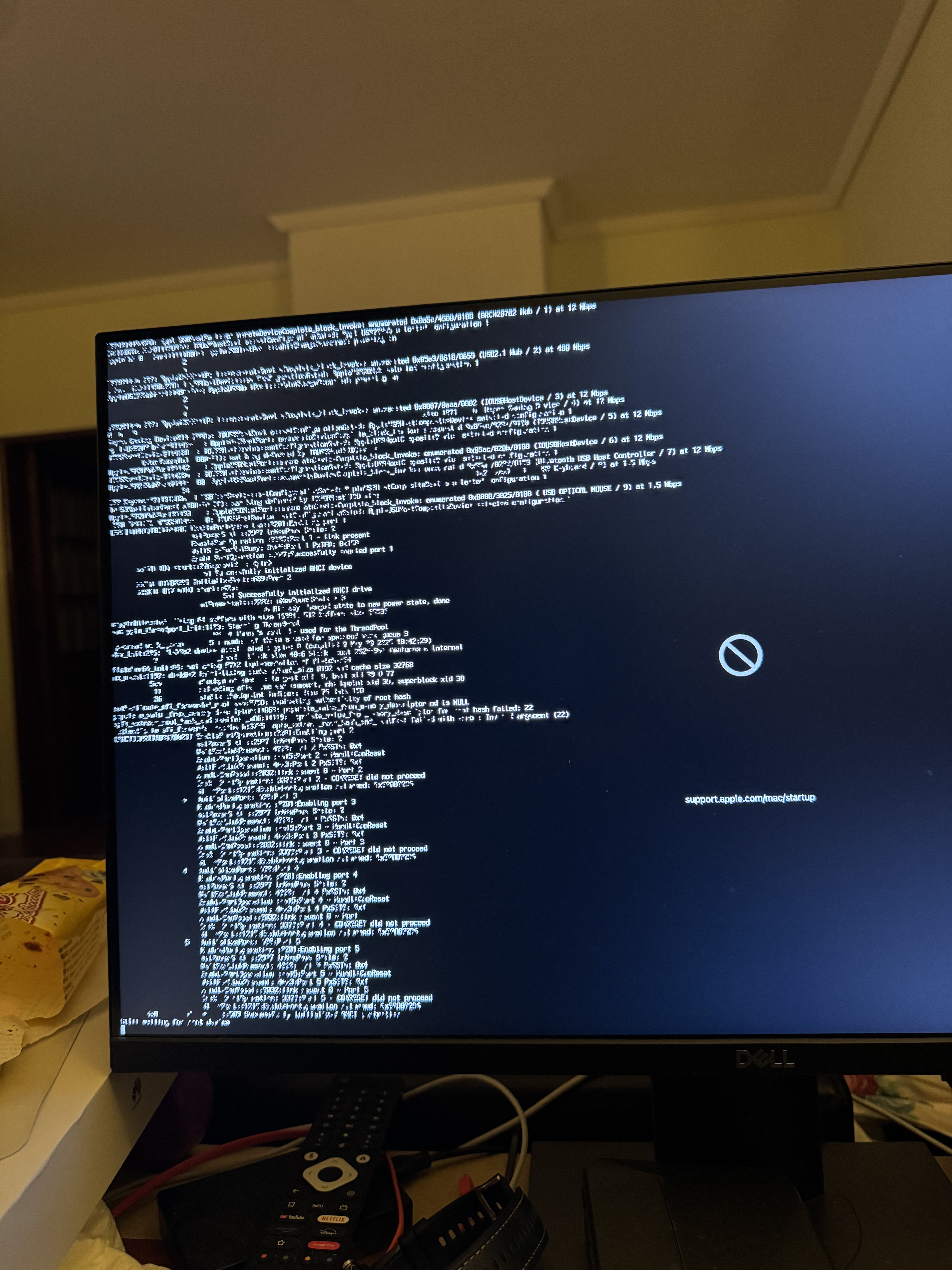

MorenoAv Posted June 29, 2025 Share Posted June 29, 2025 3 hours ago, hiphopboy said: Did you update the new OC ? Yes it's OC 1.05. 1 1 Link to comment https://www.insanelymac.com/forum/topic/361162-pre-release-macos-tahoe/page/72/#findComment-2835421 Share on other sites More sharing options...

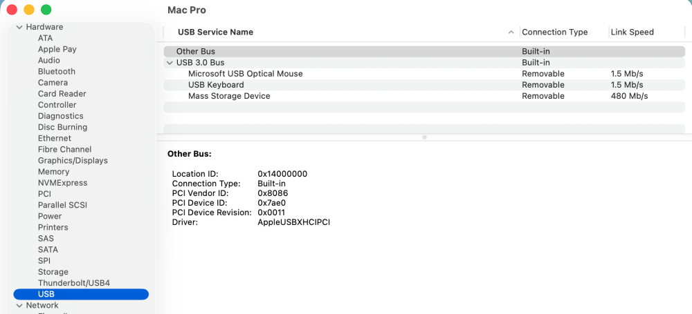

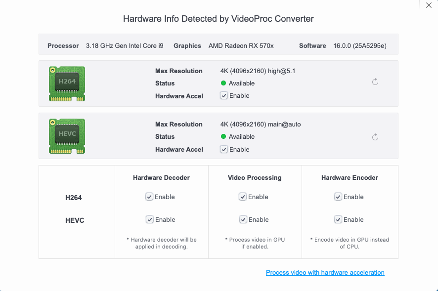

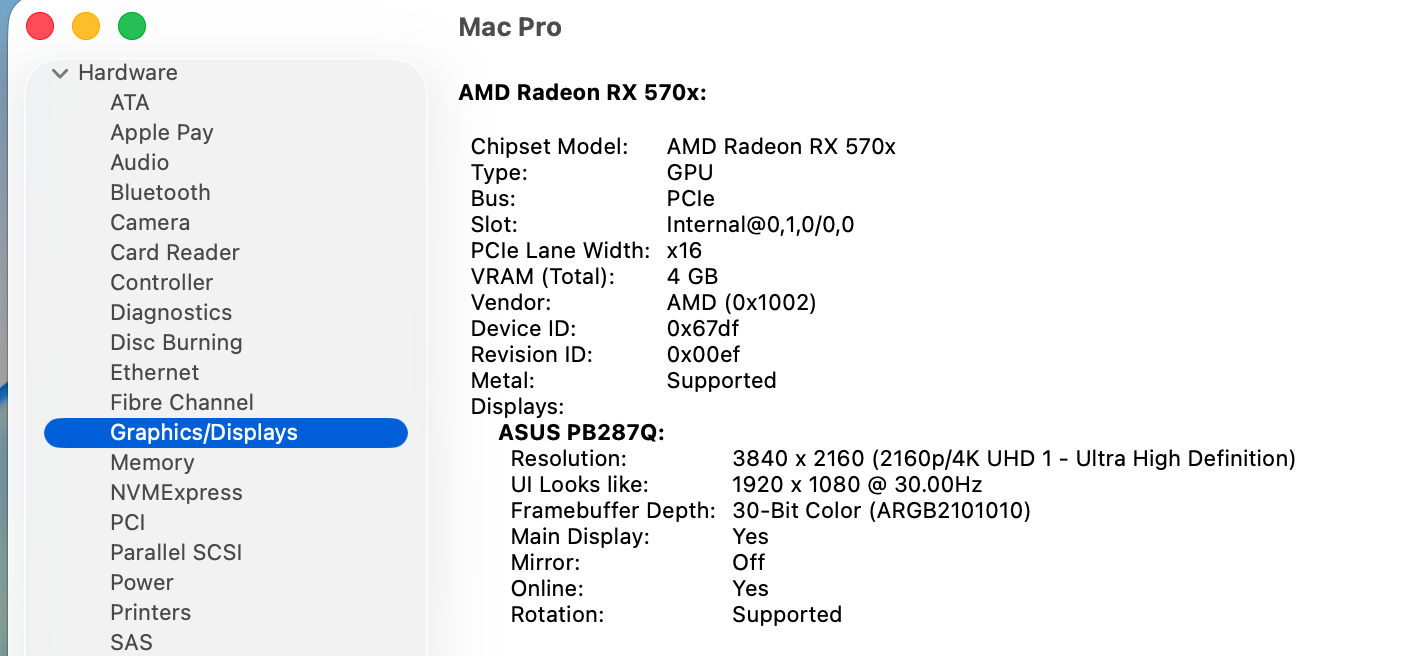

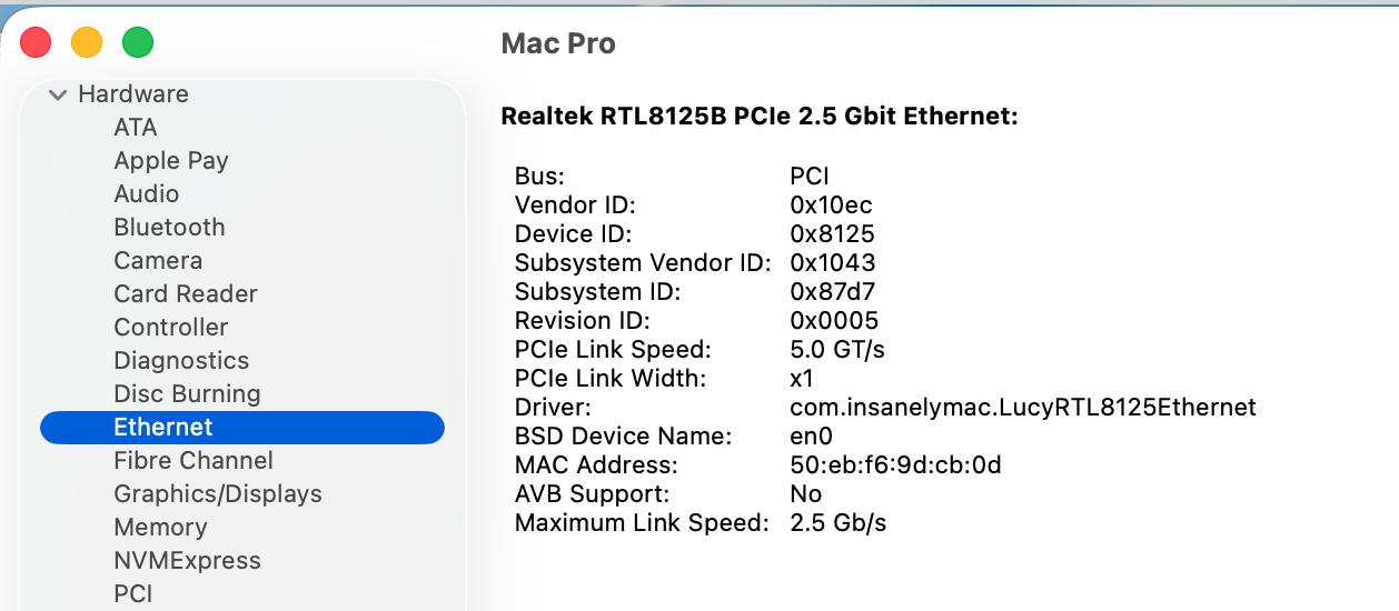

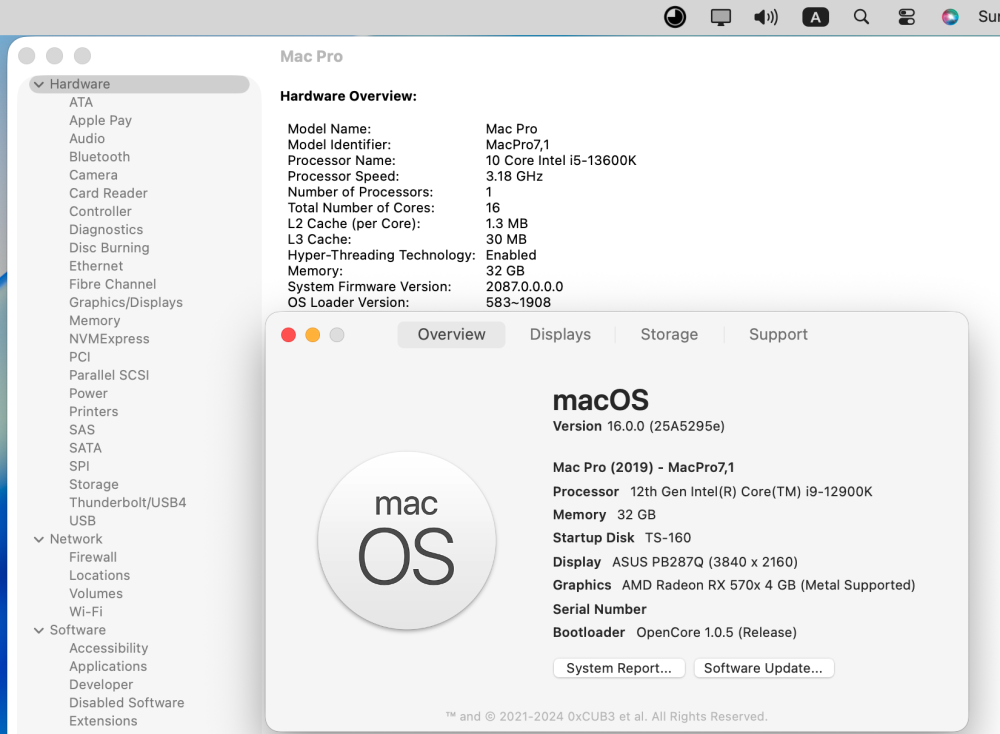

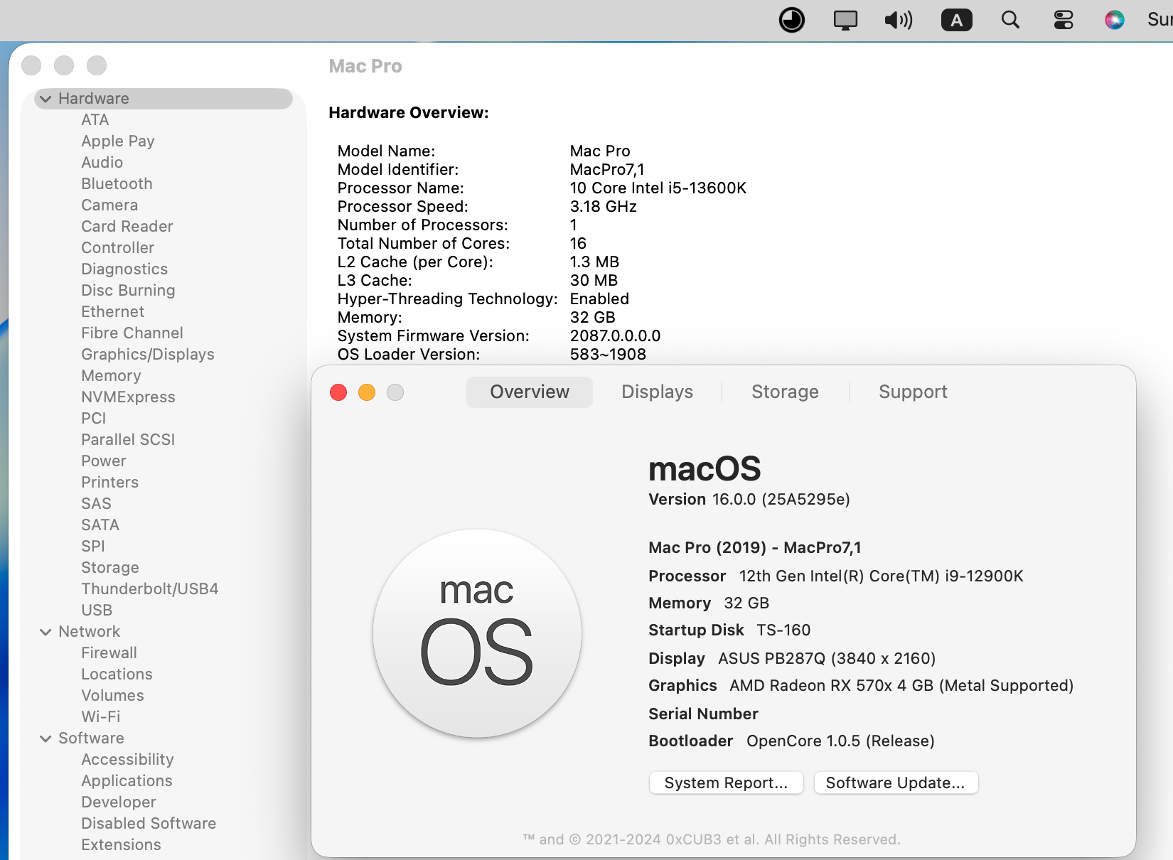

jsl Posted June 29, 2025 Share Posted June 29, 2025 (edited) After struggling for about 4 weeks at last my ASUS PRIME Z690-P D4 Hackintosh can boot Tahoe beta 2 with RX570 now ! No such issues of Finder, Firefox, LucyRTL8125Ethernet or Audio output. The only problem waiting for fix is unable to wake-up from S3 sleep. [Edit] It seems FL1100 USB 3.0 adapter may interfere its power management of MB. After removal of it and modified my config-new.plist it can wake-up from S3 sleep now ! config.plist config-new.plist Edited July 1, 2025 by jsl 7 Link to comment https://www.insanelymac.com/forum/topic/361162-pre-release-macos-tahoe/page/72/#findComment-2835423 Share on other sites More sharing options...

MorenoAv Posted June 29, 2025 Share Posted June 29, 2025 Good morning to all, Tried your EFI @Anto65 that I'll appreciate, and it don't work, stops at "kextlog: Loading Pageable Kc from file /system7library/kernelcollections/basesystemkernelextension.kc. tried to the EFI from @jsl, and it stops in the same line. grrrrrrrr 1 1 1 Link to comment https://www.insanelymac.com/forum/topic/361162-pre-release-macos-tahoe/page/72/#findComment-2835426 Share on other sites More sharing options...

MorenoAv Posted June 29, 2025 Share Posted June 29, 2025 @eSaF Following your suggestion changed from RX 570 to iGPU graphics in the bIos and disabled WhateverGreen, and it stops " In Memory Stackshot Succeed ** Bytes traced 65903 (uncompressed 164432) 1 1 Link to comment https://www.insanelymac.com/forum/topic/361162-pre-release-macos-tahoe/page/72/#findComment-2835429 Share on other sites More sharing options...

MorenoAv Posted June 29, 2025 Share Posted June 29, 2025 (edited) I only have active ALC, IntelMausi, Lilu, restrictedevents, usb map, and whatever green disabled in config.plis. I think I can't boot if I disable one more @Anto65 tried booting with your EFI and although I made the changes in the bios, it stops in the same place KC's Edited June 29, 2025 by MorenoAv 1 1 Link to comment https://www.insanelymac.com/forum/topic/361162-pre-release-macos-tahoe/page/72/#findComment-2835432 Share on other sites More sharing options...
laobamac_yyds Posted June 29, 2025 Share Posted June 29, 2025 (edited) I use RX 570 Installed directly without any problems. Just disable WhateverGreen it can then be started and installed macOS Tahoe. If the startup process is in the PCI or AppleKeyStore stop at, try adding-amd_no_dgpu_accel add to startup parameters. WhateverGreen will only cause a startup failure during installation, when you start "Macintosh HD" (your installation target name, after the installation process is complete), you need to enable it for your RX570 to work properly. Ps: you said that your EFI stopped and crashed at EB, which was not caused by GPU at all cause, you should check something else, like the OC version, kext Version... Edited June 29, 2025 by laobamac_yyds 5 Link to comment https://www.insanelymac.com/forum/topic/361162-pre-release-macos-tahoe/page/72/#findComment-2835433 Share on other sites More sharing options...
Anto65 Posted June 29, 2025 Share Posted June 29, 2025 (edited) @MorenoAv would try only with integrated and WEG enabled... try again with my EFI (if you want) Edited June 29, 2025 by Anto65 2 Link to comment https://www.insanelymac.com/forum/topic/361162-pre-release-macos-tahoe/page/72/#findComment-2835434 Share on other sites More sharing options...

MorenoAv Posted June 29, 2025 Share Posted June 29, 2025 One more try with your EFI @Anto65, and it hangs in the same place the already famous for the wrong reasons, KC's 1 1 Link to comment https://www.insanelymac.com/forum/topic/361162-pre-release-macos-tahoe/page/72/#findComment-2835437 Share on other sites More sharing options...
