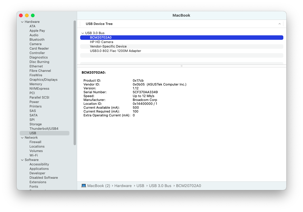

4 hours ago, arsradu said:
Hey guys!
Has anyone managed to get BCM bluetooth working with Sequoia? I've got a BT-500 dongle (from ASUS) and, even with the same BlueToolFixup in place, starting with beta 4 or 5, BT doesn't work anymore. You try to enable it, and it just goes back to disabled.
I've tried some of the advises over here (including using -lilubetaall boot arg), but no success.
The hardware is recognised in Hackintool, so I don't think that's a USB issue (recognised as BCM4350C2....not sure how accurate that is though)...but...it just doesn't get enabled.
Any ideas?

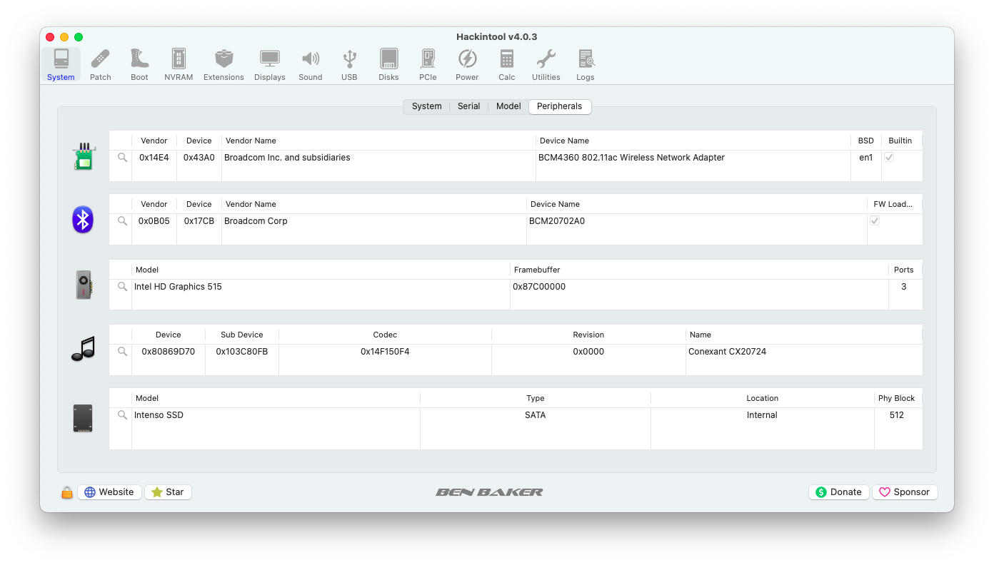

hi I have an Asus bt 400 and working fine with latest beta what wifi card do you have???
I don't have a WiFi card. Just that BT-500 adapter. I also had the BT-400 before, but for some reason, microphone for connected headphones wouldn't work with that one. So I bought BT-500, and amazingly enough, that worked...for a while. But now, it doesn't work at all.
I can't even enable BT on my computer (after turning it on in System Settings, it just goes back to disabled).

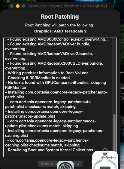

Hi, Sequoia beta 8 regress by OCLP root patch, "No kext found with GPUCompanionBundles, skipping RSRMonitor" cannot detect AMDRdeonx3000.kext in DMG pak, all other files installing.
Build wxPython #1662: Commit fccde72 other new build say unsupported os.
I think that's because the required fix "Add TeraScale Fixup" has not been implemented into the source code yet: https://github.com/dortania/OpenCore-Legacy-Patcher/pulls

Thanks to help from @CloverLeaf, I figured out why my Intel Bluetooth wasn't working in Sequoia Beta.  I was testing non-zxystd Bluetooth kext builds that others had built.  It turns out that if I use the "official" zxystd Sequoia Bluetooth kext builds and Shanee's Bluetoolfixup.kext (without -lilubetaall) or Acidanthera's BluetoolFixup.kext (with -lilubetaall as @acquarius13 said), Intel Bluetooth is working for me with Intel 9560.
See details here.  Intel Bluetooth is now working for me with Sequoia Beta 8 and Intel 9560.
Hi, in beta 6 detected but have issue see this post:https://www.insanelymac.com/forum/topic/359530-pre-release-macos-sequoia/?do=findComment&comment=2824490
this new error is in beta 8, amdradeonx3000 exist in package.

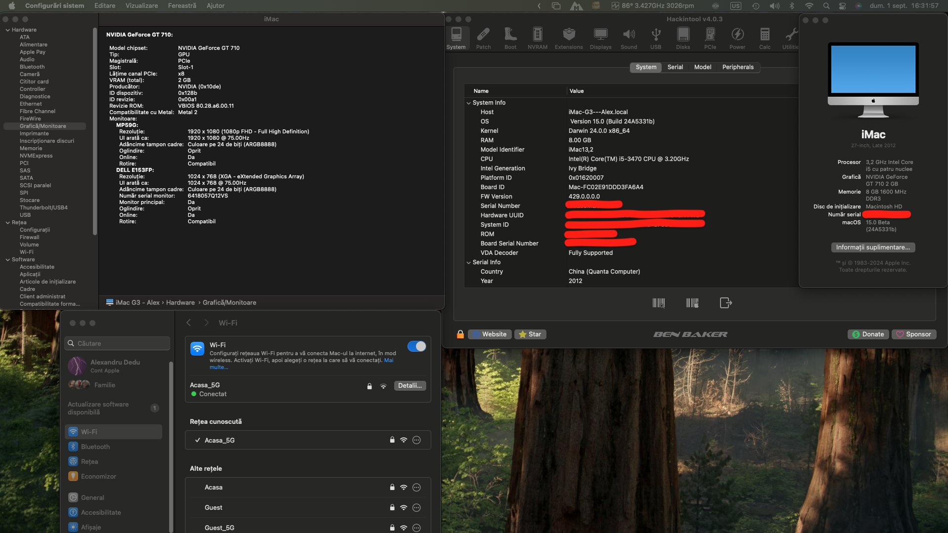

2 hours ago, Stefanalmare said:
Latest Sequoia beta. Nvidia GT 710, Ivy Bridge IGPU and wifi patched:
  Hide contents
Hi may I ask how you patched? OCLP or what? Thanks
@bluenote56 and @AlfredoM It would be a good idea to post your NVidia graphics card / chipset with your questions.  @Stefanalmare's GT 710 was natively supported by macOS through Big Sur (without the need for "web drivers").   Not all Nvidia are equal.  For example, I still can't patch my Nvidia Tesla graphics with OCLP.  Chances are, if your Nvidia graphics was last officially supported in High Sierra, it still won't work in Sequoia with OCLP (not yet).
