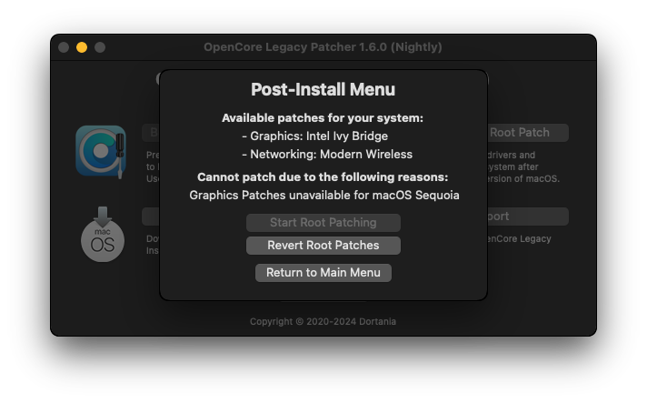

cankiulascmnfye Posted September 1, 2024 Share Posted September 1, 2024 Regarding Ivy Bridge: iGPU patching does not work – even if you build it from source (Sequoia Development branch) 2 1 1 Link to comment https://www.insanelymac.com/forum/topic/359530-pre-release-macos-sequoia/page/67/#findComment-2824628 Share on other sites More sharing options...
cankiulascmnfye Posted September 1, 2024 Share Posted September 1, 2024 2 hours ago, Stefanalmare said: It is OCLP compiled from source/development, bypassing the 2 restrictions. Which Restrictions are you referring to exactly? Building from sequoia source didnt allow patching Intel HD 4000 Link to comment https://www.insanelymac.com/forum/topic/359530-pre-release-macos-sequoia/page/67/#findComment-2824630 Share on other sites More sharing options...
Stefanalmare Posted September 1, 2024 Share Posted September 1, 2024 17 minutes ago, cankiulascmnfye said: Which Restrictions are you referring to exactly? Building from sequoia source didnt allow patching Intel HD 4000 1. Bypass "3802 patchability check": in sys_patch/detections/detect.py line 724 commented out the return False. 2. Re-compile the privileged-helper-tool with make debug (Terminal), removes Dortania signing. Like I said, all is here: https://forums.macrumors.com/threads/macos-15-sequoia-on-unsupported-macs-thread.2428654/ 2 Link to comment https://www.insanelymac.com/forum/topic/359530-pre-release-macos-sequoia/page/67/#findComment-2824631 Share on other sites More sharing options...

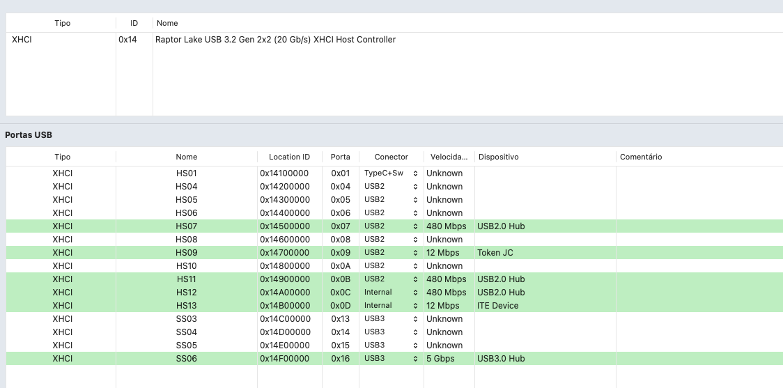

Max.1974 Posted September 1, 2024 Share Posted September 1, 2024 (edited) On 8/31/2024 at 9:59 PM, Andrw0380 said: Obrigado pela informação. Acabei de tentar com aquele boot-args e, infelizmente, nenhuma mudança. É estranho o fato de que todos os 3 kexts estão carregados e eu não mudei meu mapa SMBIOS ou USB Port quando fiz a atualização, então é estranho que de repente não esteja funcionando, especialmente depois de fazer algumas redefinições da NVRAM. Eu tenho Wi-Fi funcionando, pois apenas a BT não está funcionando na placa AX210 no meu laptop Dell Inspiron 7567. Anexei minha pasta OC com meu config.plist. Eu removi a seção genérica exclusiva do SMBIOS para o meu sistema e tive que remover o 'itwlm.kext' e o 'IntelBluetoothFirmware.kext', pois o tamanho do arquivo compactado era muito grande para aqui, mas esses kexts estão no meu OC na pasta Kexts que está sendo usada. OC.zip 4,79 MB·10 downloads Hi @Andrw0380 All good? I looked at your config.plist and noticed that there are 2 keys missing and modified two others if you want to test. Here your config.plist config.plist.zip Modifications: ExtendBTFeatureFlags Bolean true Spoiler XhciPortLimit Bolean true Spoiler I add 2 keys that important in Nvram NVRAM > 7C436110-AB2A-4BBB-A880-FE41995C9F82 bluetoothExternalDongleFailed data <00> bluetoothInternalControllerInfo data <00000000 00000000 00000000 0000> Spoiler Hope you can fix that Need fix your internal ports to 255 in USB mapping. If you want try this version of IntelBluetooth v2.4.0 https://github.com/OpenIntelWireless/IntelBluetoothFirmware/releases/tag/v2.4.0 Check here too: https://github.com/perez987/Intel-AX210-wifi6-on-macOS-Sonoma#installing-wifi-module Edited September 2, 2024 by Max.1974 3 Link to comment https://www.insanelymac.com/forum/topic/359530-pre-release-macos-sequoia/page/67/#findComment-2824636 Share on other sites More sharing options...

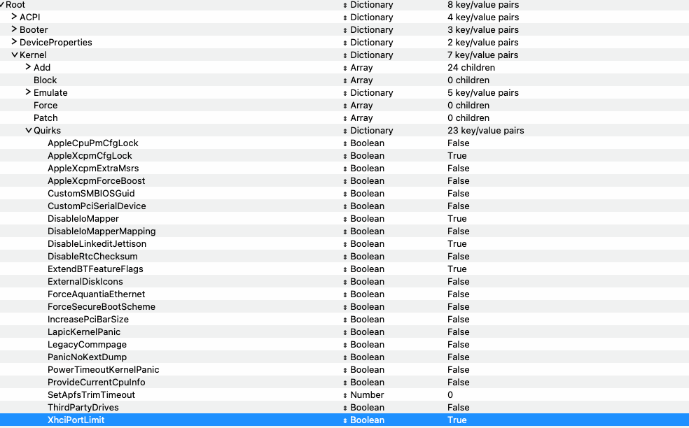

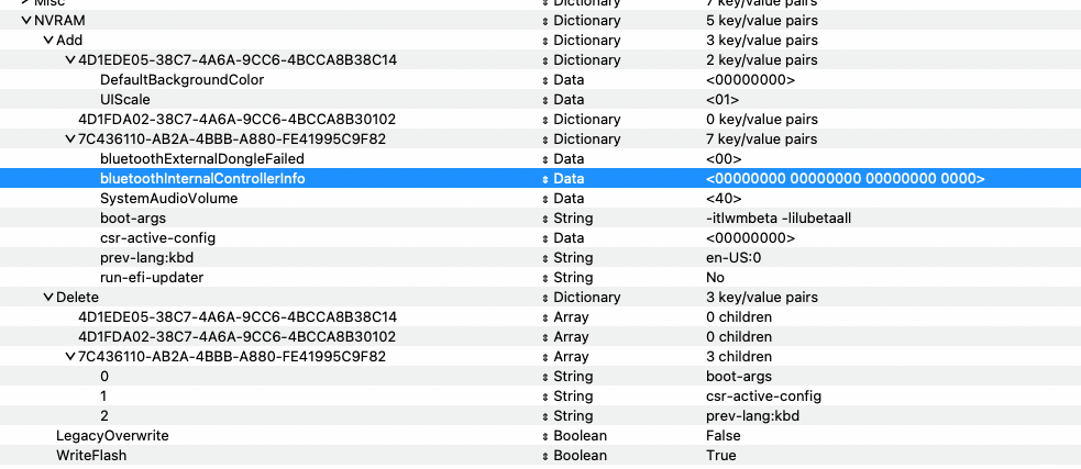

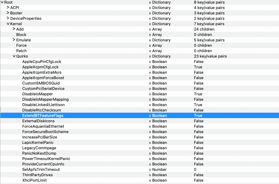

Andrw0380 Posted September 2, 2024 Share Posted September 2, 2024 4 hours ago, Max.1974 said: Hi @Andrw0380 All good? I looked at your config.plist and noticed that there are 2 keys missing and modified two others if you want to test. Here your config.plist config.plist.zip 5.94 kB · 5 downloads Modifications: ExtendBTFeatureFlags Bolean true Reveal hidden contents XhciPortLimit Bolean true Reveal hidden contents I add 2 keys that important in Nvram NVRAM > 7C436110-AB2A-4BBB-A880-FE41995C9F82 bluetoothExternalDongleFailed data <00> bluetoothInternalControllerInfo data <00000000 00000000 00000000 0000> Reveal hidden contents Hope you can fix that Need fix your internal ports to 255 in USB mapping. If you want try this version of IntelBluetooth v2.4.0 https://github.com/OpenIntelWireless/IntelBluetoothFirmware/releases/tag/v2.4.0 Check here too: https://github.com/perez987/Intel-AX210-wifi6-on-macOS-Sonoma#installing-wifi-module Thanks so much man as I now have working BT! I've added those config.plist changes with the IntelBluetoothFirmware build that was on the official Github page that @deeveedee provided above your comment and everything now works! I did take a look at the USBPort map and on my Dell Inspiron 7567, the BT adapter and the Camera is connected to port 0x04 and 0x0C which I did have mapped to internal (255) port. I just wanted to make sure per your comment if that is correct and what port map changes were you referencing? Also if I have the USBPorts.kext active, do I still need the XhciPortLimit key set to true? Just wanting to know for future reference so I know I'm running the config properly. 2 Link to comment https://www.insanelymac.com/forum/topic/359530-pre-release-macos-sequoia/page/67/#findComment-2824641 Share on other sites More sharing options...
Max.1974 Posted September 2, 2024 Share Posted September 2, 2024 (edited) 26 minutes ago, Andrw0380 said: Muito obrigado, cara, como agora tenho BT trabalhando! Eu adicionei essas alterações do config.plist com a compilação IntelBluetoothFirmware que estava na página oficial do Github que @deeeveedee forneceu acima do seu comentário e tudo agora funciona! Eu dei uma olhada no mapa USBPort e no meu Dell Inspiron 7567, o adaptador BT e a câmera estão conectados às portas 0x04 e 0x0C que eu mapeei para a porta interna (255). Eu só queria ter certeza de que, de acordo com o seu comentário, se isso está correto e a quais mudanças no mapa do porto você estava se referindo? Além disso, se eu tiver o USBPorts.kext ativo, ainda preciso que a chave XhciPortLimit seja definida como verdadeira? Só quero saber para referência futura para que eu saiba que estou executando a configuração corretamente. You can try use XHCIPortlimit true first, and after this not work, try false (not recommended) but tell me what keys you add to fix? I prepare your config.plist to working. Yes im absolutely sure that 255 is internal ports. Usbports use SMBIOS, check inside the plist. Every time that you change SMBIOS, if you are using USBPorts.kext you need change SMBIOS too. Im using to fix old HDD compile RHUB ports, but laptop maybe not need that. Always use to internal ports like Bluetooth Broadcom, intel AX that not is CNvio, but you can use too. In my desktop I have been used both: Broadcom Bluetooth and isolated intel BT, using Intel Wireless or OCLP, you choose that as you want. Enjoy it! Edited September 2, 2024 by Max.1974 2 Link to comment https://www.insanelymac.com/forum/topic/359530-pre-release-macos-sequoia/page/67/#findComment-2824643 Share on other sites More sharing options...

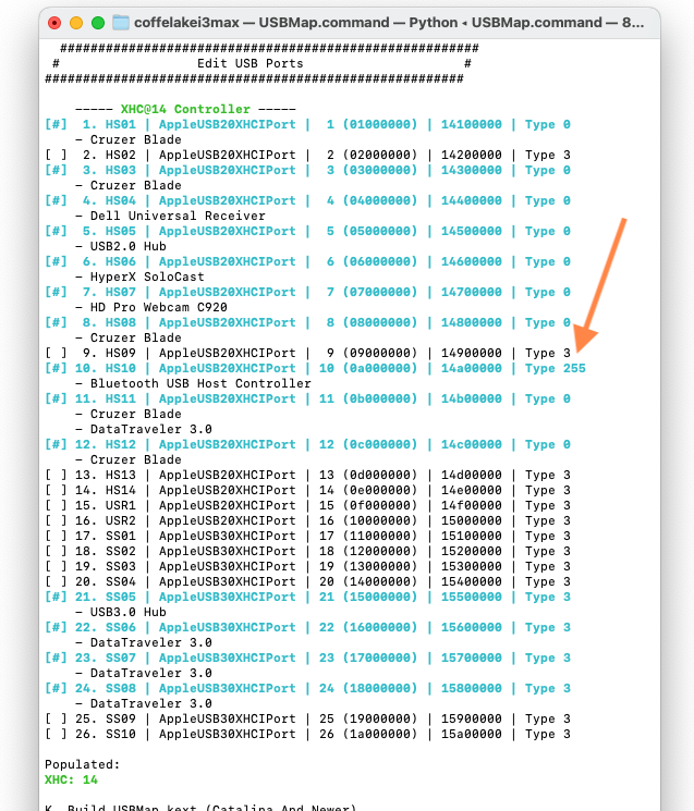

Andrw0380 Posted September 2, 2024 Share Posted September 2, 2024 (edited) 26 minutes ago, Max.1974 said: You can try use XHCIPortlimit true first, and after this not work, try false (not recommended) but tell me what keys you add to fix? I prepare your config.plist to working. Yes im absolutely sure that 255 is internal ports. Usbports use SMBIOS, check inside the plist. Every time that you change SMBIOS, if you are using USBPorts.kext you need change SMBIOS too. Im using to fix old HDD compile RHUB ports, but laptop maybe not need that. Always use to internal ports like Bluetooth Broadcom, intel AX that not is CNvio, but you can use too. In my desktop I have been used both: Broadcom Bluetooth and isolated intel BT, using Intel Wireless or OCLP, you choose that as you want. Enjoy it! Here is my updated config.plist with working Wi-Fi and BT. I've cleaned it up and removed the old entries of kexts I had set to disable when I first posted it. I believe the fix was using the proper BT kexts with adding the NVRAM BT entries as I didn't have that before in my config.plist. I've also posted my USBPorts.kext which has my laptop ports are broken down as follows: - External USB 3 ports for USB 2.0 devices use connectors 0x01-0x03, 0x07 (USB Card Reader) and USB 3.0 devices connect to 0x11-0x13 - Internal ports are 0x04 (Bluetooth Adapter) and 0x0C (Internal Camera) The Dell Inspiron 7567 only has a USB 3.0 Controller for it's ports so that's why I've set all the external ports to value 3 and internal ports to 255 as per best practices. Thanks again everyone for helping me get this to work! config.plist USBPorts.kext.zip Edited September 2, 2024 by Andrw0380 1 Link to comment https://www.insanelymac.com/forum/topic/359530-pre-release-macos-sequoia/page/67/#findComment-2824645 Share on other sites More sharing options...

cankiulascmnfye Posted September 2, 2024 Share Posted September 2, 2024 8 hours ago, Stefanalmare said: 1. Bypass "3802 patchability check": in sys_patch/detections/detect.py line 724 commented out the return False. 2. Re-compile the privileged-helper-tool with make debug (Terminal), removes Dortania signing. Like I said, all is here: https://forums.macrumors.com/threads/macos-15-sequoia-on-unsupported-macs-thread.2428654/ Okay, thanks. I have got to figure wherer this line went, because the detect.py file was removed/replaced in the latest commit: "patchsets: Implement new patch detection architecture" 1 Link to comment https://www.insanelymac.com/forum/topic/359530-pre-release-macos-sequoia/page/67/#findComment-2824647 Share on other sites More sharing options...
