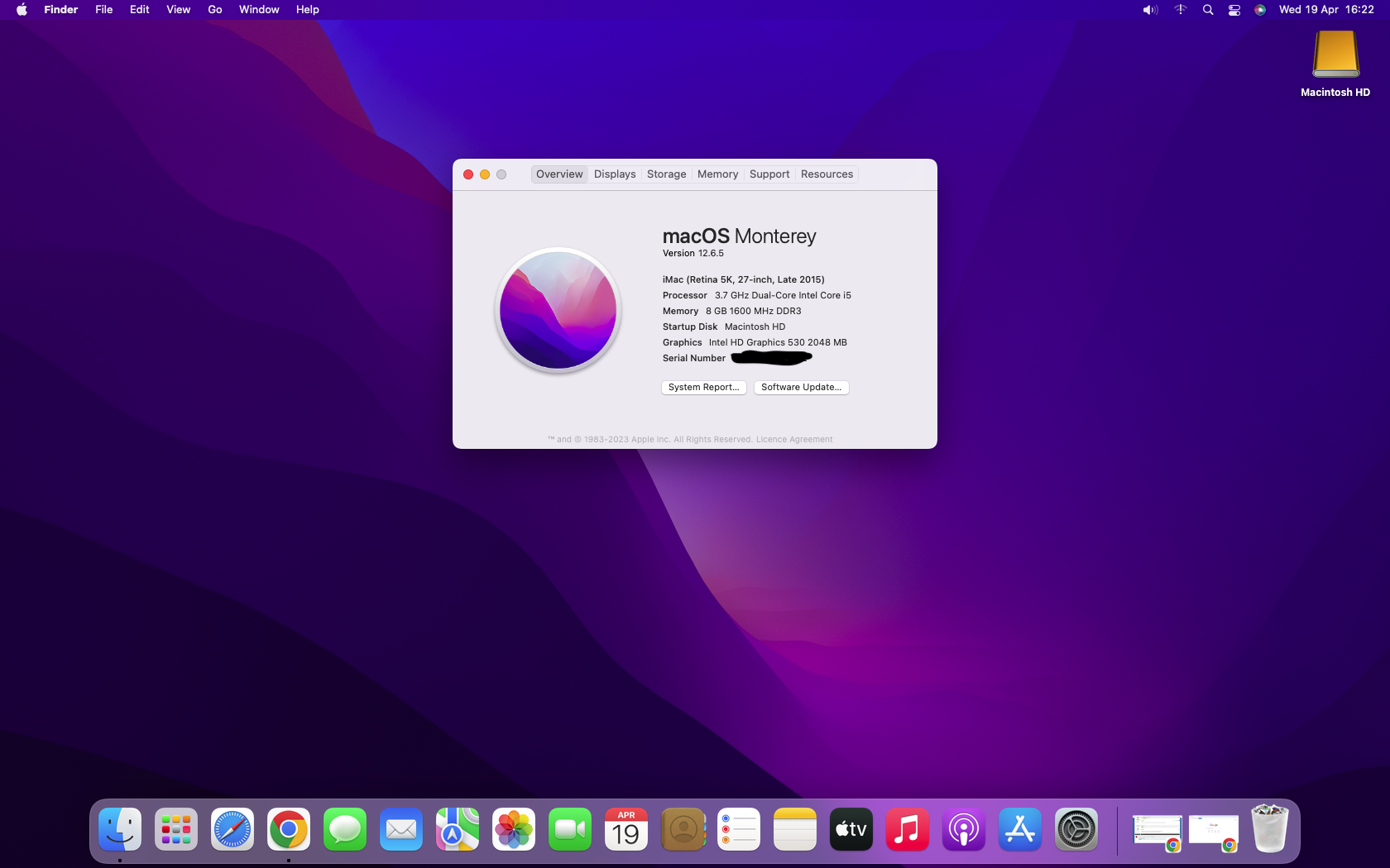

deeveedee Posted April 19, 2023 Share Posted April 19, 2023 @Alan Sojan In your original post, you claim to have an i3-6100, but your screen shot shows i5. With your new EFI (with spoofed device-id 0x191B), does About This Mac now indicate that you have an i3? Quote Link to comment https://www.insanelymac.com/forum/topic/356349-intel-hd-530-monterey/page/4/#findComment-2803851 Share on other sites More sharing options...
Alan Sojan Posted April 19, 2023 Author Share Posted April 19, 2023 36 minutes ago, deeveedee said: @Alan Sojan In your original post, you claim to have an i3-6100, but your screen shot shows i5. With your new EFI (with spoofed device-id 0x191B), does About This Mac now indicate that you have an i3? No. for some reason it still shows as an i5 even though I 100% have an Intel i3 1 Quote Link to comment https://www.insanelymac.com/forum/topic/356349-intel-hd-530-monterey/page/4/#findComment-2803852 Share on other sites More sharing options...
deeveedee Posted April 19, 2023 Share Posted April 19, 2023 Thanks for the reply. I can only suspect that there is something about the Skylake i3 that is different from the i5 and i7 (requiring the spoofed device-id). If someone understands the need for the spoofed device-id, hopefully they can post the explanation here. 1 Quote Link to comment https://www.insanelymac.com/forum/topic/356349-intel-hd-530-monterey/page/4/#findComment-2803853 Share on other sites More sharing options...

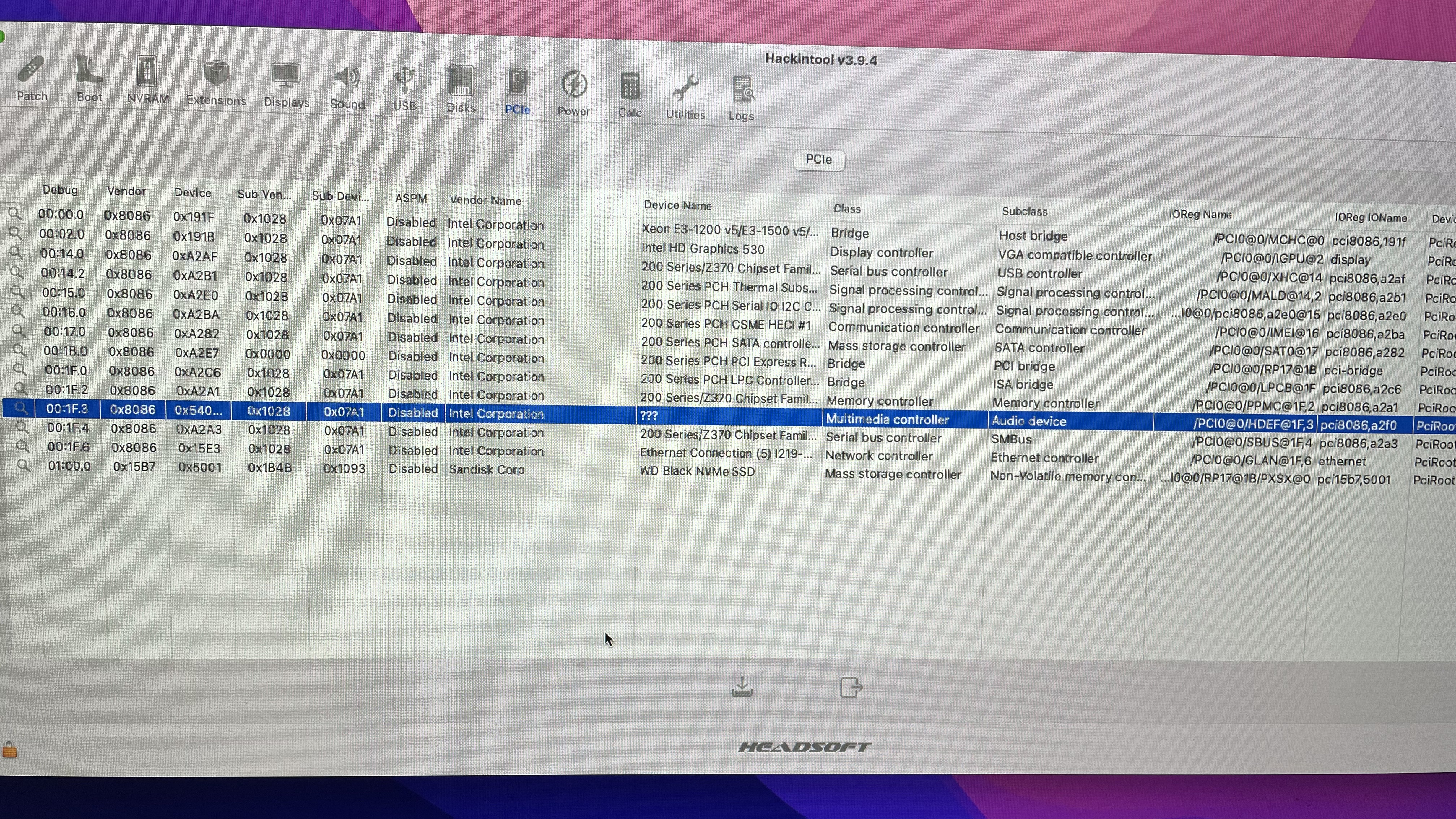

Peckamal Posted May 18, 2023 Share Posted May 18, 2023 Hello, I used the EFI uploaded by the thread founder, everything seems to work for me except for one thing and that is the sound, the system does not even detect the sound card, I have a dell optiplex 7050 i5 6500 Intel HD 530, do you have any advice on how to make the sound work? Thank you Quote Link to comment https://www.insanelymac.com/forum/topic/356349-intel-hd-530-monterey/page/4/#findComment-2804727 Share on other sites More sharing options...

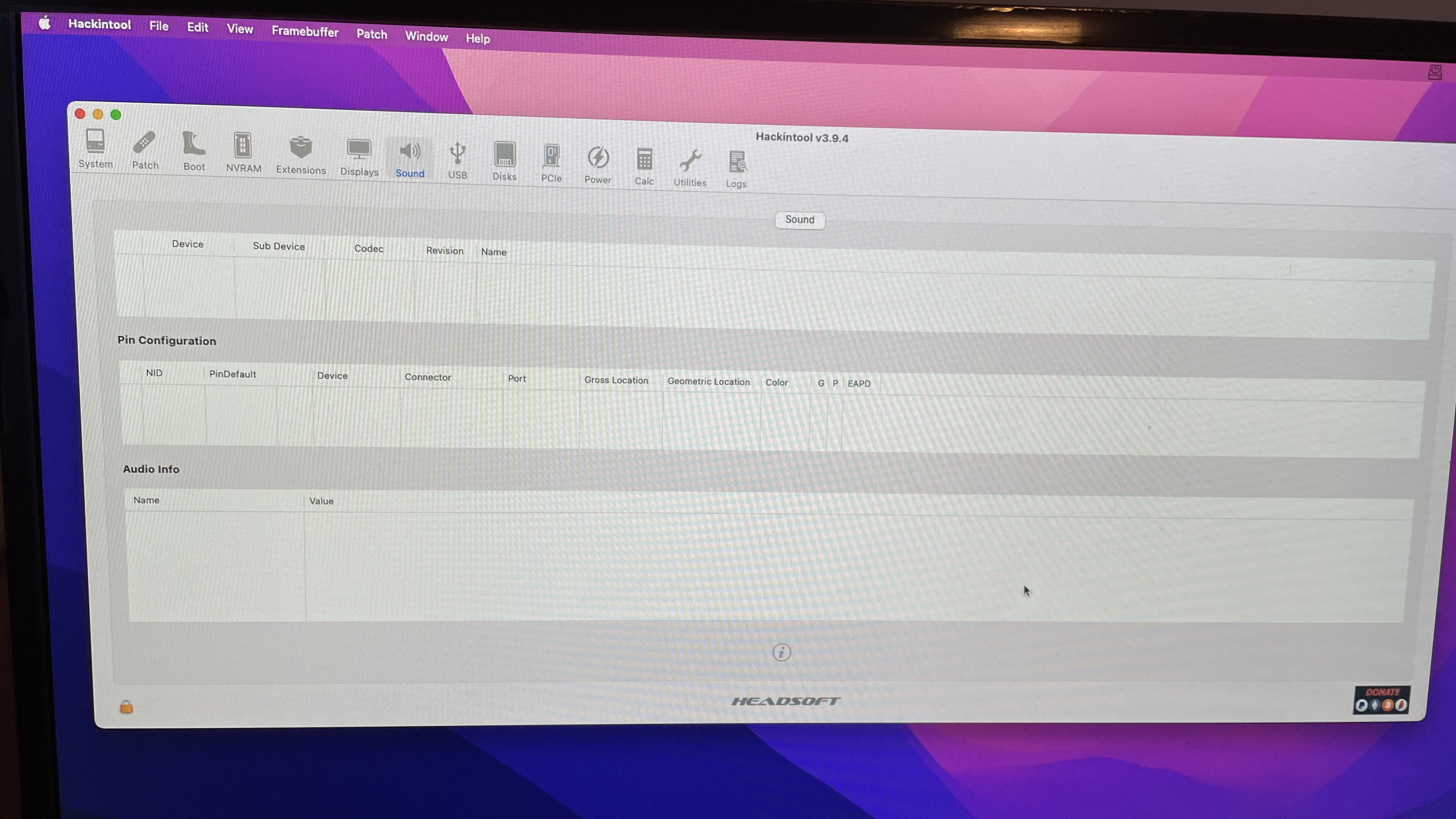

Peckamal Posted May 19, 2023 Share Posted May 19, 2023 This is the current situation of the sound card, maybe someone will figure out why it is not displayed, thank you very much 1 Quote Link to comment https://www.insanelymac.com/forum/topic/356349-intel-hd-530-monterey/page/4/#findComment-2804787 Share on other sites More sharing options...

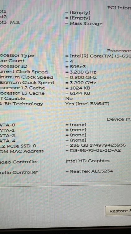

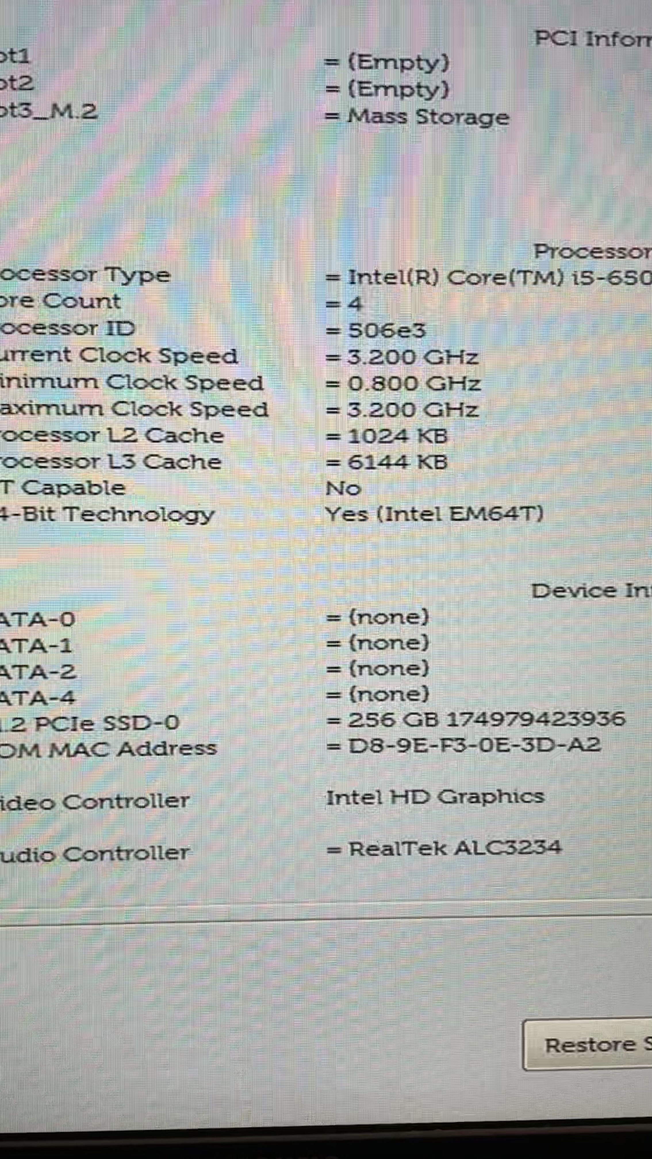

Slice Posted May 19, 2023 Share Posted May 19, 2023 I afraid ALC3234 has non-standard interface. Hackintool can't show you device until it will work. Moreover it can't show audio device when it works with VoodooHDA. Try to get more information in Windows with AIDA64 program. 3 Quote Link to comment https://www.insanelymac.com/forum/topic/356349-intel-hd-530-monterey/page/4/#findComment-2804788 Share on other sites More sharing options...

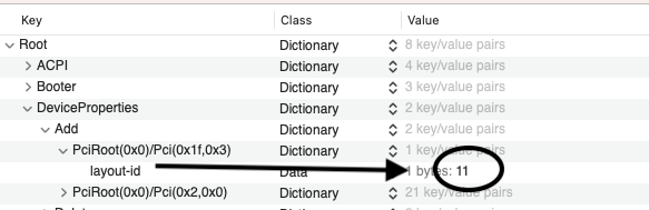

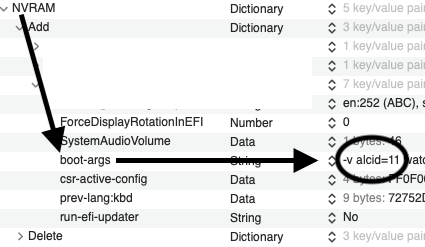

RickiThaDragon Posted May 19, 2023 Share Posted May 19, 2023 The reason it is not displayed is that you need to put in the config plist the following info. The device-id (from what i see on your screenshot i assume that to be 54010000 (it looks like your using a DELL PC btw. So just add that along with your layout-id and you can also add the aapl slot-name, and other things if you like but the device-id will get it to show up and the layout id i have used 0x0B, 0x00, 0x00, 0x00 for 300 Series and 0x0D,0x00, 0x00, 0x00 for 100 series. To find your available CODECS FOR THE ALC3234 you can check here and there should be a list of usable Layout IDs, you have to try them one at a time until one works. I normally start at the beginning and work my way up till one works. https://github.com/acidanthera/AppleALC/wiki/Supported-codecs You may also require to have the HPET configured correctly as well, hope this helps 1 Quote Link to comment https://www.insanelymac.com/forum/topic/356349-intel-hd-530-monterey/page/4/#findComment-2804793 Share on other sites More sharing options...
RickiThaDragon Posted May 19, 2023 Share Posted May 19, 2023 36 minutes ago, Peckamal said: I also had such a sound card with my old laptop, I think there will be more such dell PCs, I will have to wait, someone with experience will contact me, and I think it belongs to the alc255 group Try layout id "11" or 0x0b,0x00,0x00,0x00 1 Quote Link to comment https://www.insanelymac.com/forum/topic/356349-intel-hd-530-monterey/page/4/#findComment-2804795 Share on other sites More sharing options...
