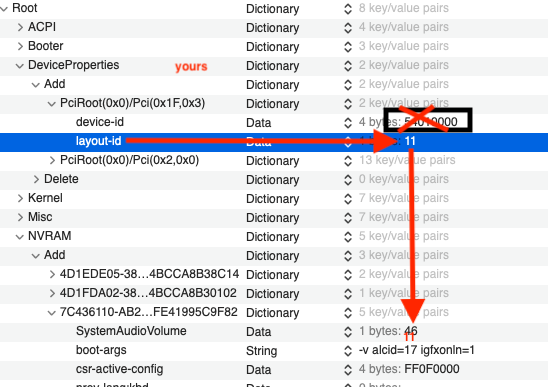

ichelash Posted May 19, 2023 Share Posted May 19, 2023 1 hour ago, Peckamal said: Yes it is there and I checked everything, I shared my EFI maybe someone will come up with it You have in Device Properties...layout_id=11 for audio, and in Boot-args you have alcid=17, choose one. 11 or 17. 2 Quote Link to comment https://www.insanelymac.com/forum/topic/356349-intel-hd-530-monterey/page/5/#findComment-2804816 Share on other sites More sharing options...

Peckamal Posted May 20, 2023 Share Posted May 20, 2023 5 hours ago, Rocky12 said: Hello, Thank you, when I used your EFI, the pc did not start, I don't know what to do, with my EFI, the pc starts but there is no sound, I really don't know how to proceed, Thank you for any help Quote Link to comment https://www.insanelymac.com/forum/topic/356349-intel-hd-530-monterey/page/5/#findComment-2804825 Share on other sites More sharing options...
Peckamal Posted May 20, 2023 Share Posted May 20, 2023 6 hours ago, Rocky12 said: Hello, Thank you, when I used your EFI, the pc did not start, I don't know what to do, with my EFI, the pc starts but there is no sound, I really don't know how to proceed, For example, I don't have the DSDT.aml in EFI and I don't even know what to edit it in, Thank you for your help, I appreciate it you for any help Quote Link to comment https://www.insanelymac.com/forum/topic/356349-intel-hd-530-monterey/page/5/#findComment-2804829 Share on other sites More sharing options...
ichelash Posted May 20, 2023 Share Posted May 20, 2023 2 hours ago, Peckamal said: Hello, Thank you, when I used your EFI, the pc did not start, I don't know what to do, with my EFI, the pc starts but there is no sound, I really don't know how to proceed, For example, I don't have the DSDT.aml in EFI and I don't even know what to edit it in, Thank you for your help, I appreciate it you for any help In simple term what @Rocky12 is saying..is open config.plist of your EFI using Opencore configurator "i know you got one"..then on your ACPI-->Patch--> list patches Then on the drop down of the list of patches choose Rename HDAS TO HDEF as show in the image below 👇 1 Quote Link to comment https://www.insanelymac.com/forum/topic/356349-intel-hd-530-monterey/page/5/#findComment-2804835 Share on other sites More sharing options...

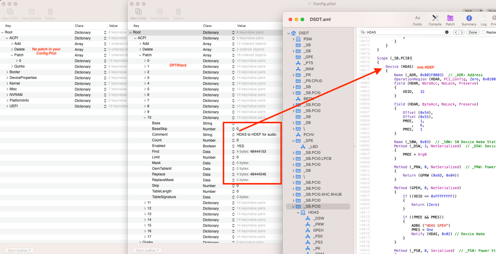

Peckamal Posted May 20, 2023 Share Posted May 20, 2023 5 hours ago, ichelash said: In simple term what @Rocky12 is saying..is open config.plist of your EFI using Opencore configurator "i know you got one"..then on your ACPI-->Patch--> list patches Then on the drop down of the list of patches choose Rename HDAS TO HDEF as show in the image below 👇 Hi, I followed the instructions but the audio is still nowhere 😞 Quote Link to comment https://www.insanelymac.com/forum/topic/356349-intel-hd-530-monterey/page/5/#findComment-2804862 Share on other sites More sharing options...

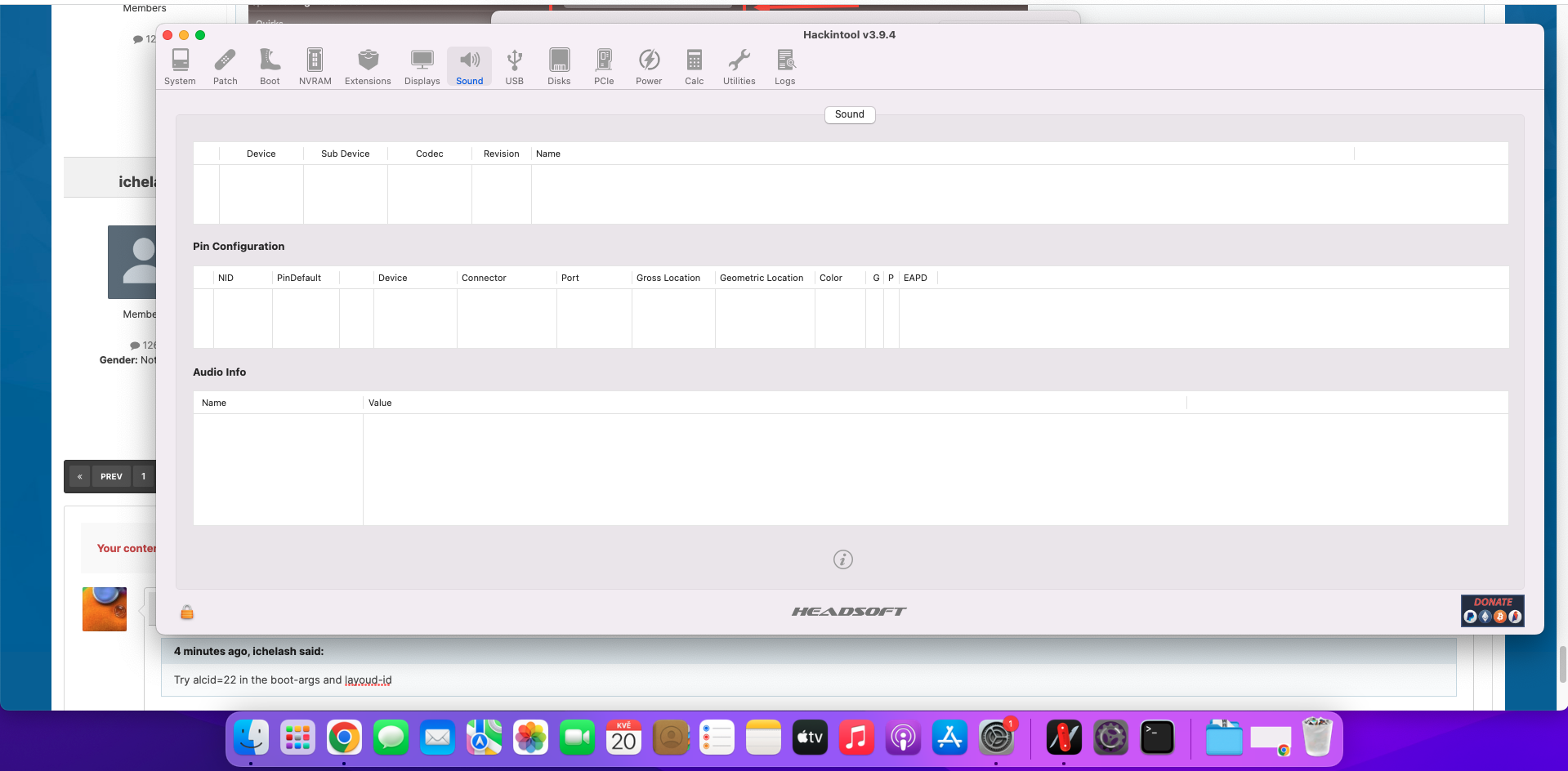

ichelash Posted May 20, 2023 Share Posted May 20, 2023 1 hour ago, Peckamal said: Hi, I followed the instructions but the audio is still nowhere 😞 Try alcid=22 in the boot-args and layoud-id Quote Link to comment https://www.insanelymac.com/forum/topic/356349-intel-hd-530-monterey/page/5/#findComment-2804863 Share on other sites More sharing options...
Peckamal Posted May 20, 2023 Share Posted May 20, 2023 4 minutes ago, ichelash said: Try alcid=22 in the boot-args and layoud-id No change still no sound and still not showing Quote Link to comment https://www.insanelymac.com/forum/topic/356349-intel-hd-530-monterey/page/5/#findComment-2804865 Share on other sites More sharing options...
Peckamal Posted May 20, 2023 Share Posted May 20, 2023 6 minutes ago, eSaF said: Do you have sound in Windows (if dual booting)? I don't have Windows but I tried Ubuntu and the sound works there Quote Link to comment https://www.insanelymac.com/forum/topic/356349-intel-hd-530-monterey/page/5/#findComment-2804870 Share on other sites More sharing options...
datafeedexpert Posted May 20, 2023 Share Posted May 20, 2023 On 5/18/2023 at 8:26 PM, Peckamal said: Hello, I used the EFI uploaded by the thread founder, everything seems to work for me except for one thing and that is the sound, the system does not even detect the sound card, I have a dell optiplex 7050 i5 6500 Intel HD 530, do you have any advice on how to make the sound work? Thank you You can Post your EFI Here 1 Quote Link to comment https://www.insanelymac.com/forum/topic/356349-intel-hd-530-monterey/page/5/#findComment-2804873 Share on other sites More sharing options...
Peckamal Posted May 20, 2023 Share Posted May 20, 2023 3 minutes ago, datafeedexpert said: You can Post your EFI Here Here you have it Efi.zip Quote Link to comment https://www.insanelymac.com/forum/topic/356349-intel-hd-530-monterey/page/5/#findComment-2804875 Share on other sites More sharing options...

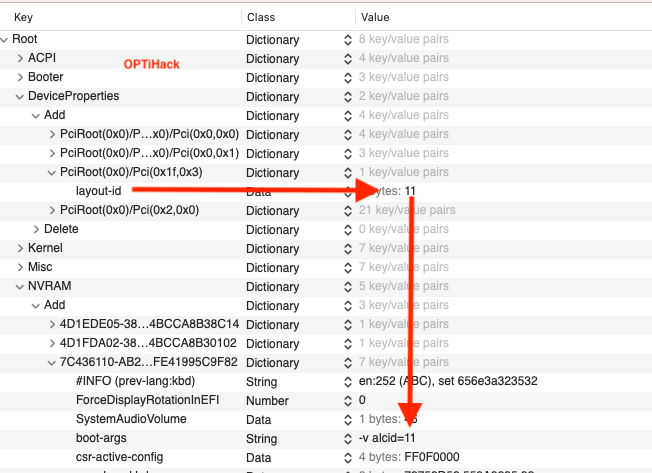

Peckamal Posted May 20, 2023 Share Posted May 20, 2023 14 minutes ago, eSaF said: I don't know if this will fix the problem you're having but worth a try. In your config.plist UEFI/Audio/AudioCodec, instead of '1' try '0' (see attached) and as long as your alcid value data is correct I am hoping this will fix the problem. Also have a look in Hackintool after you make the change to see if any semblance of Audio show up. Don't forget to clear Nvram on reboot. Good luck. Thanks for another tip but it doesn't work Quote Link to comment https://www.insanelymac.com/forum/topic/356349-intel-hd-530-monterey/page/5/#findComment-2804889 Share on other sites More sharing options...

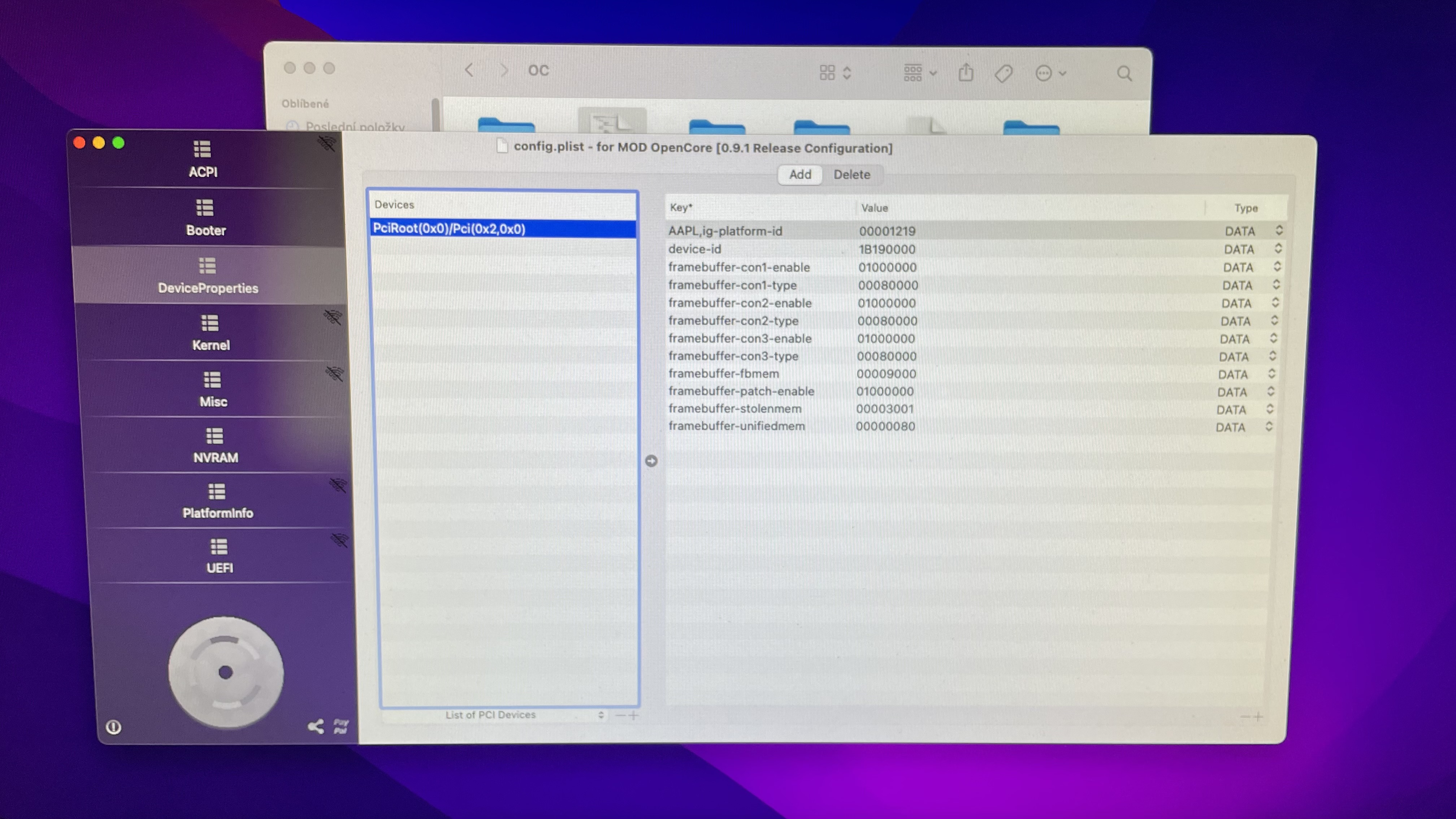

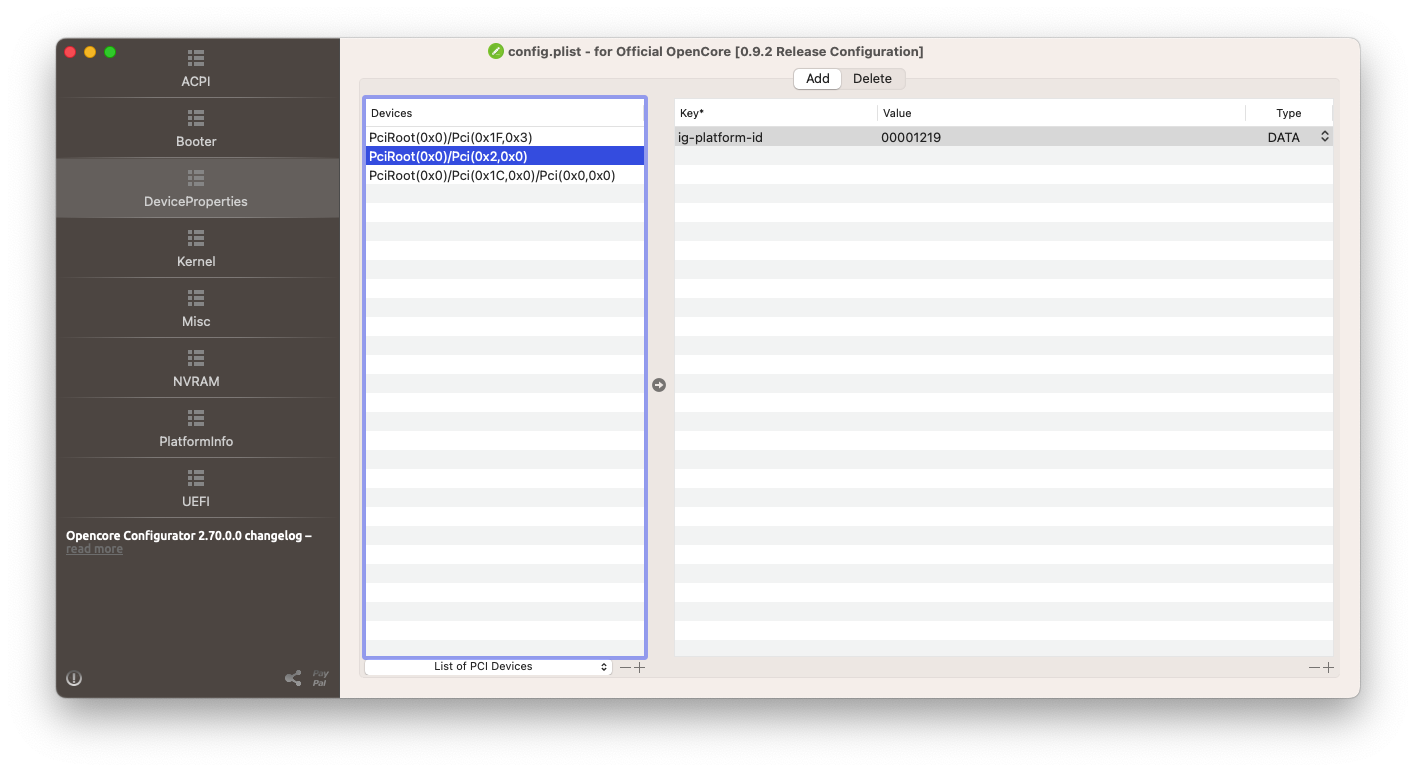

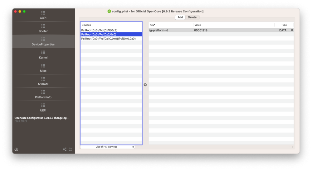

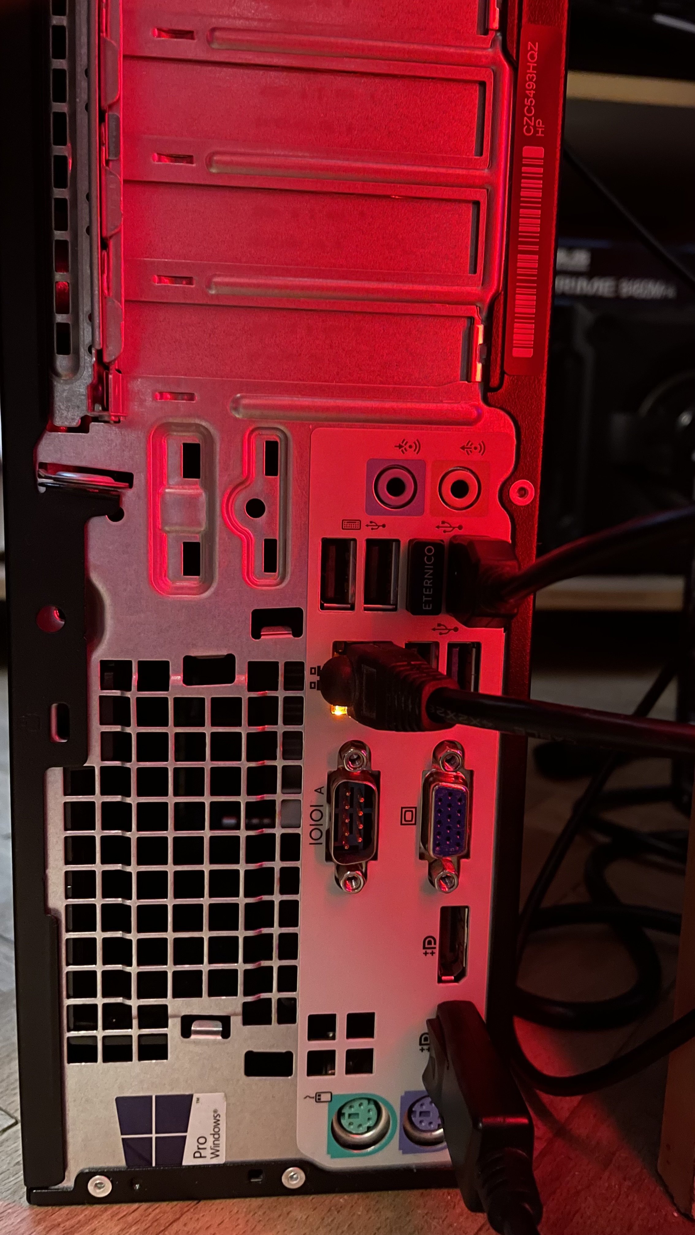

Peckamal Posted May 21, 2023 Share Posted May 21, 2023 Hello, I have another thing, and that is that today we installed Monterey on a friend's HP ProDesk 600 G2 SFF after several attempts, everything works and the sound works, but the problem is that it has 2xDP and 1x VGA output, but only 1 DP works. Don't you know what should be set or changed in the config so that the last outputs are also sent to the monitor? Thank you very much Quote Link to comment https://www.insanelymac.com/forum/topic/356349-intel-hd-530-monterey/page/5/#findComment-2804932 Share on other sites More sharing options...
deeveedee Posted May 21, 2023 Share Posted May 21, 2023 (edited) @Peckamal I'm not sure which SMBIOS macModel that you chose for your rig (e.g. macmini8,1), so these are just some observations that might help you: You have chosen AAPL,ig-platform-id 0x19120000. As indicated here, this framebuffer definition specifies the following port types (see full framebuffer definition below): con0: <01000000> dummy port (see port types here) - no physical port con1: <00040000> DisplayPort con2: <00040000> DisplayPort Your DeviceProperties patches change con1 and con2 port types to <00080000> which is HDMI. These probably work with DP as well, but may not work with VGA. Your DeviceProperties patch con3 which is not defined in your case. You can remove your con3 patches Without knowing the mapping of your physical connectors to your logical connectors (con0, con1, con2) and without knowing which physical connector works when connected to your monitor, I'm guessing that the non-working physical connector corresponds to con0 which your AAPL,ig-platform-id defines as "dummy." If that's the case, you will need to change the definition of con0-type in the same way that you changed the definition of con1 and con2 types. You may be able to add DeviceProperty framebuffer-con0-type = <00080000> (to be consistent with your other patches) which specify type HDMI even though you are using DP. Let's start with HDMI for the initial test and if that doesn't work, we'll revisit. Here's where it gets tricky, logical framebuffer definitions have indices and busids. Your chosen AAPL,ig-platform-id sets the index of con0 as FF (disabling the port). You will need to change the index of con0. Since con1 has index 1 and con2 has index 2, you can try setting con0 to index = 3 with the DeviceProperty framebuffer-con0-index = <03000000>. But in your AAPL,ig-platform-id, con0 has busId 0x00 which may also disable the physical port, so you may need to change con0 busId. busIds 0x05 and 0x04 are taken, so you can try setting con0 busId = 0x02 with the DeviceProperty framebuffer-con0-busid = <02000000> Each logical connector con0, con1, con2 has flags that affect connector behavior. Your chosen AAPL,ig-platform-id sets con0 flags <0x00000020> which will probably not produce a working connector. For consistency with the other flag definitions of con1 and con2, set the flags for con0 to 0x00000187 using DeviceProperty framebuffer-con0-flags = <87010000> Your chosen framebuffer specifies con0 pipe as 0. This may not work, so try setting framebuffer-con0-pipe = <0b000000> You may find that your displays don't all work simultaneosly and they may not wake up after sleep, so you may need additional device properties. For now, test this by adding the following boot-args: darkwake=2 igfxonln=1 igfxagdc=0 In summary, add the following DeviceProperties to your config.plist: framebuffer-con0-type = <00080000> framebuffer-con0-index = <03000000> framebuffer-con0-busid = <02000000> framebuffer-con0-flags = <87010000> framebuffer-con0-pipe = <0b000000> frambuffer-con0-enable = <01000000> and add the following boot-args to your config.plist darkwake=2 igfxonln=1 igfxagdc=0 I'm only relaying to you what I learned while patching my hack (which you know about here). Patiently read about my HackMini8,1 (starting with the fiirst post) to learn more. 0x19120000 Framebuffer definition ID: 19120000, STOLEN: 34 MB, FBMEM: 21 MB, VRAM: 1536 MB, Flags: 0x0000110F TOTAL STOLEN: 56 MB, TOTAL CURSOR: 1 MB (1572864 bytes), MAX STOLEN: 124 MB, MAX OVERALL: 125 MB (131608576 bytes) Model name: Intel HD Graphics SKL CRB Camellia: CamelliaDisabled (0), Freq: 1388 Hz, FreqMax: 1388 Hz Mobile: 1, PipeCount: 3, PortCount: 3, FBMemoryCount: 3 [255] busId: 0x00, pipe: 0, type: 0x00000001, flags: 0x00000020 - ConnectorDummy [1] busId: 0x05, pipe: 9, type: 0x00000400, flags: 0x00000187 - ConnectorDP [2] busId: 0x04, pipe: 10, type: 0x00000400, flags: 0x00000187 - ConnectorDP FF000000 01000000 20000000 01050900 00040000 87010000 02040A00 00040000 87010000 Edited May 21, 2023 by deeveedee 1 1 Quote Link to comment https://www.insanelymac.com/forum/topic/356349-intel-hd-530-monterey/page/5/#findComment-2804946 Share on other sites More sharing options...
Peckamal Posted May 22, 2023 Share Posted May 22, 2023 3 hours ago, deeveedee said: @Peckamal I'm not sure which SMBIOS macModel that you chose for your rig (e.g. macmini8,1), so these are just some observations that might help you: You have chosen AAPL,ig-platform-id 0x19120000. As indicated here, this framebuffer definition specifies the following port types (see full framebuffer definition below): con0: <01000000> dummy port (see port types here) - no physical port con1: <00040000> DisplayPort con2: <00040000> DisplayPort Your DeviceProperties patches change con1 and con2 port types to <00080000> which is HDMI. These probably work with DP as well, but may not work with VGA. Your DeviceProperties patch con3 which is not defined in your case. You can remove your con3 patches Without knowing the mapping of your physical connectors to your logical connectors (con0, con1, con2) and without knowing which physical connector works when connected to your monitor, I'm guessing that the non-working physical connector corresponds to con0 which your AAPL,ig-platform-id defines as "dummy." If that's the case, you will need to change the definition of con0-type in the same way that you changed the definition of con1 and con2 types. You may be able to add DeviceProperty framebuffer-con0-type = <00080000> (to be consistent with your other patches) which specify type HDMI even though you are using DP. Let's start with HDMI for the initial test and if that doesn't work, we'll revisit. Here's where it gets tricky, logical framebuffer definitions have indices and busids. Your chosen AAPL,ig-platform-id sets the index of con0 as FF (disabling the port). You will need to change the index of con0. Since con1 has index 1 and con2 has index 2, you can try setting con0 to index = 3 with the DeviceProperty framebuffer-con0-index = <03000000>. But in your AAPL,ig-platform-id, con0 has busId 0x00 which may also disable the physical port, so you may need to change con0 busId. busIds 0x05 and 0x04 are taken, so you can try setting con0 busId = 0x02 with the DeviceProperty framebuffer-con0-busid = <02000000> Each logical connector con0, con1, con2 has flags that affect connector behavior. Your chosen AAPL,ig-platform-id sets con0 flags <0x00000020> which will probably not produce a working connector. For consistency with the other flag definitions of con1 and con2, set the flags for con0 to 0x00000187 using DeviceProperty framebuffer-con0-flags = <87010000> Your chosen framebuffer specifies con0 pipe as 0. This may not work, so try setting framebuffer-con0-pipe = <0b000000> You may find that your displays don't all work simultaneosly and they may not wake up after sleep, so you may need additional device properties. For now, test this by adding the following boot-args: darkwake=2 igfxonln=1 igfxagdc=0 In summary, add the following DeviceProperties to your config.plist: framebuffer-con0-type = <00080000> framebuffer-con0-index = <03000000> framebuffer-con0-busid = <02000000> framebuffer-con0-flags = <87010000> framebuffer-con0-pipe = <0b000000> frambuffer-con0-enable = <01000000> and add the following boot-args to your config.plist darkwake=2 igfxonln=1 igfxagdc=0 I'm only relaying to you what I learned while patching my hack (which you know about here). Patiently read about my HackMini8,1 (starting with the fiirst post) to learn more. 0x19120000 Framebuffer definition ID: 19120000, STOLEN: 34 MB, FBMEM: 21 MB, VRAM: 1536 MB, Flags: 0x0000110F TOTAL STOLEN: 56 MB, TOTAL CURSOR: 1 MB (1572864 bytes), MAX STOLEN: 124 MB, MAX OVERALL: 125 MB (131608576 bytes) Model name: Intel HD Graphics SKL CRB Camellia: CamelliaDisabled (0), Freq: 1388 Hz, FreqMax: 1388 Hz Mobile: 1, PipeCount: 3, PortCount: 3, FBMemoryCount: 3 [255] busId: 0x00, pipe: 0, type: 0x00000001, flags: 0x00000020 - ConnectorDummy [1] busId: 0x05, pipe: 9, type: 0x00000400, flags: 0x00000187 - ConnectorDP [2] busId: 0x04, pipe: 10, type: 0x00000400, flags: 0x00000187 - ConnectorDP FF000000 01000000 20000000 01050900 00040000 87010000 02040A00 00040000 87010000 Hi, thanks for everything, I'm at work now, I'll try it when I get home, it's set as iMac17,1 Thank you Quote Link to comment https://www.insanelymac.com/forum/topic/356349-intel-hd-530-monterey/page/5/#findComment-2804950 Share on other sites More sharing options...
datafeedexpert Posted May 22, 2023 Share Posted May 22, 2023 9 hours ago, Peckamal said: Hello, I have another thing, and that is that today we installed Monterey on a friend's HP ProDesk 600 G2 SFF after several attempts, everything works and the sound works, but the problem is that it has 2xDP and 1x VGA output, but only 1 DP works. Don't you know what should be set or changed in the config so that the last outputs are also sent to the monitor? Thank you very much Just use only one Property like AAPL,ig-platform-id & reset NVRAM 2 Quote Link to comment https://www.insanelymac.com/forum/topic/356349-intel-hd-530-monterey/page/5/#findComment-2804952 Share on other sites More sharing options...
Peckamal Posted May 22, 2023 Share Posted May 22, 2023 3 hours ago, datafeedexpert said: Just use only one Property like AAPL,ig-platform-id & reset NVRAM Thank you, I will try it at home from work, if I wanted to install Ventura, can I use the current EFI? or do I have to do something else? Thank you Quote Link to comment https://www.insanelymac.com/forum/topic/356349-intel-hd-530-monterey/page/5/#findComment-2804959 Share on other sites More sharing options...
deeveedee Posted May 22, 2023 Share Posted May 22, 2023 (edited) @Peckamal , @datafeedexpert 's suggestion to simplify is always good. I assumed that you had an i3 like the OP and needed to spoof device-id to 0x191b. If you have an i5 or i7, then you shouldn't spoof the device-id and should remove device-id from your DeviceProperties. If you don't have an i3 (and you do have an i5 or i7), you may want to simply remove device-id from your DeviceProperties, reboot, reset NVRAM and test with Monterey or older macOS. If you are running Ventura, then you need to spoof iGPU as Kabylake as indicated here and demonstrated by @Rocky12 here. EDIT: Keep my overly-complex example in your back pocket just in case the simple solution doesn't work for you. I have found these HP Minis to behave more like NUCS and laptops than desktops, so the simpler approaches that work with desktops may not work and you'll need to add some extra patches. Looking forward to seeing your progress. EDIT2: Also see slice's comment here (for Monterey or older). You can try other frame buffers (other AAPL,ig-platform-ids) that have different connector types already defined. You can try multiple framebuffers for Ventura, too, but again, you need to spoof a Kabylake iGPU. EDIT3: Sorry to be long-winded, but if you are installing Ventura, you may just want to start testing with Rocky12's solution here. Edited May 22, 2023 by deeveedee 1 1 Quote Link to comment https://www.insanelymac.com/forum/topic/356349-intel-hd-530-monterey/page/5/#findComment-2804971 Share on other sites More sharing options...
Peckamal Posted May 22, 2023 Share Posted May 22, 2023 Hi, I tried your instructions but still only one DP works Quote Link to comment https://www.insanelymac.com/forum/topic/356349-intel-hd-530-monterey/page/5/#findComment-2804980 Share on other sites More sharing options...
deeveedee Posted May 22, 2023 Share Posted May 22, 2023 (edited) @Peckamal Please post your current EFI. Also post your G2 Mini's CPU, the macOS version you are testing and a photo showing which physical port is working. Edited May 22, 2023 by deeveedee Quote Link to comment https://www.insanelymac.com/forum/topic/356349-intel-hd-530-monterey/page/5/#findComment-2804981 Share on other sites More sharing options...
Peckamal Posted May 22, 2023 Share Posted May 22, 2023 Hi 3 minutes ago, deeveedee said: @Peckamal Please post your current EFI. Also post your G2 Mini's CPU, the macOS version you are testing and a photo showing which physical port is working. Hi, i5 6500 my EFI EFI.zip 6 minutes ago, deeveedee said: @Peckamal Please post your current EFI. Also post your G2 Mini's CPU, the macOS version you are testing and a photo showing which physical port is working. I'm sorry for the photo Quote Link to comment https://www.insanelymac.com/forum/topic/356349-intel-hd-530-monterey/page/5/#findComment-2804982 Share on other sites More sharing options...
deeveedee Posted May 22, 2023 Share Posted May 22, 2023 (edited) @Peckamal Thank you for posting the details. You initially posted your question in my EliteDesk 800 G4 Mini thread, so I assumed you were asking about a HP 600 Mini. I should have more carefully read your post earlier in this thread to see that it's an SFF (not a Mini). What is the chipset in your PC? EDIT: The EFI you posted doesn't have any of the discussed changes to your DeviceProperties. Also, please tell us what macOS version you are testing. Edited May 22, 2023 by deeveedee 2 Quote Link to comment https://www.insanelymac.com/forum/topic/356349-intel-hd-530-monterey/page/5/#findComment-2804986 Share on other sites More sharing options...
Peckamal Posted May 22, 2023 Share Posted May 22, 2023 10 minutes ago, deeveedee said: @Peckamal Thank you for posting the details. You initially posted your question in my EliteDesk 800 G4 Mini thread, so I assumed you were asking about a HP 600 Mini. I should have more carefully read your post earlier in this thread to see that it's an SFF (not a Mini). What is the chipset in your PC? EDIT: The EFI you posted doesn't have any of the discussed changes to your DeviceProperties. Also, please tell us what macOS version you are testing. Sorry, Monterey Quote Link to comment https://www.insanelymac.com/forum/topic/356349-intel-hd-530-monterey/page/5/#findComment-2804988 Share on other sites More sharing options...
datafeedexpert Posted May 22, 2023 Share Posted May 22, 2023 2 hours ago, Peckamal said: Hi Hi, i5 6500 my EFI EFI.zip 4.83 MB · 1 download I'm sorry for the photo https://github.com/ecklf/OpenCore-EliteDesk-800-G2SFF Use this config.plist for your ready reference and made changes in your config.plist 2 Quote Link to comment https://www.insanelymac.com/forum/topic/356349-intel-hd-530-monterey/page/5/#findComment-2804994 Share on other sites More sharing options...
