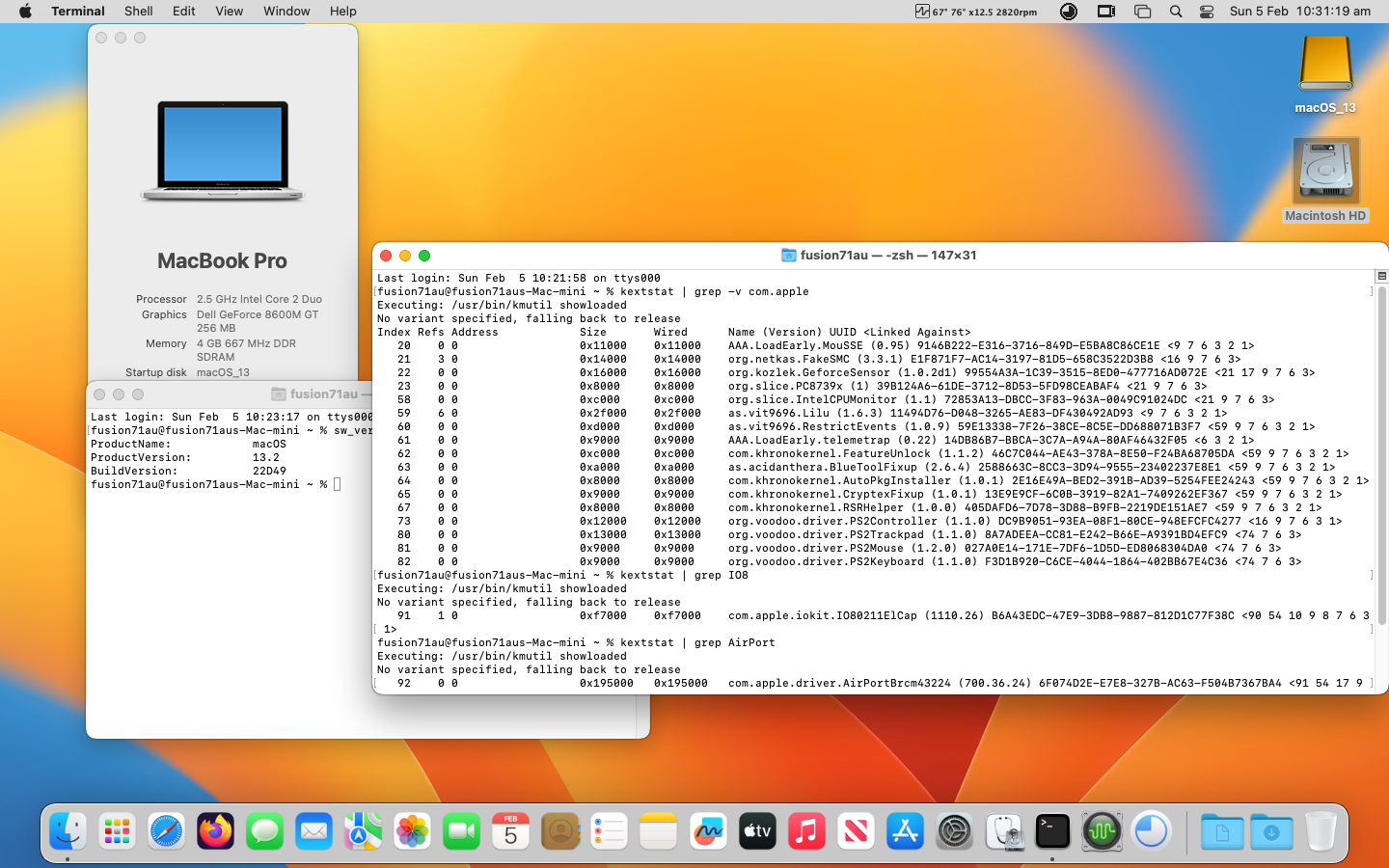

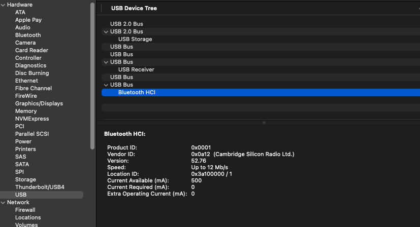

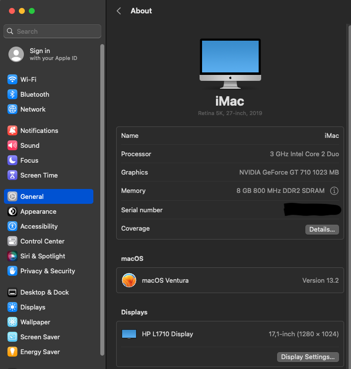

Time to go on Ventura from archive hardware. Everything works perfect and faster than Monterey. SMBIOS19,1 was chosen for best compatibility with CSR BT dongle. After OCLP patch for Nvidia Kepler and USB 1,1, BT (Apple BT keyboard), BT still works only through USB 2.0 Hub.
Display is VGA, with boot arg -agdpmod=vit9696 because OCLP had problem with second boot screen which goes to black if VGA is connected.

Addendum:
When you map USB ports with USBMap, USB1,1 injector.kext  from OCLP recognize all UHCI 1,1 ports properly with keyboard, mouse, BT dongle etc… Hub 2.0 or 3.0 is therefore only needed for first Ventura install and update.
If you have Apple BT keyboard, you can on Hackintosh install Ventura from scratch with ordinary BT dongle on USB Hub. On real Mac you cant, you must use only Usb wired keyboard or original Apple Broadcom wifi/BT adapter (or Fenvi) because BT dongles are not functioning.
People have problems installing Ventura from USB because they make mistake of removing USB boot stick after first restart. You must leave it in till the last install boot and first Ventura screen.

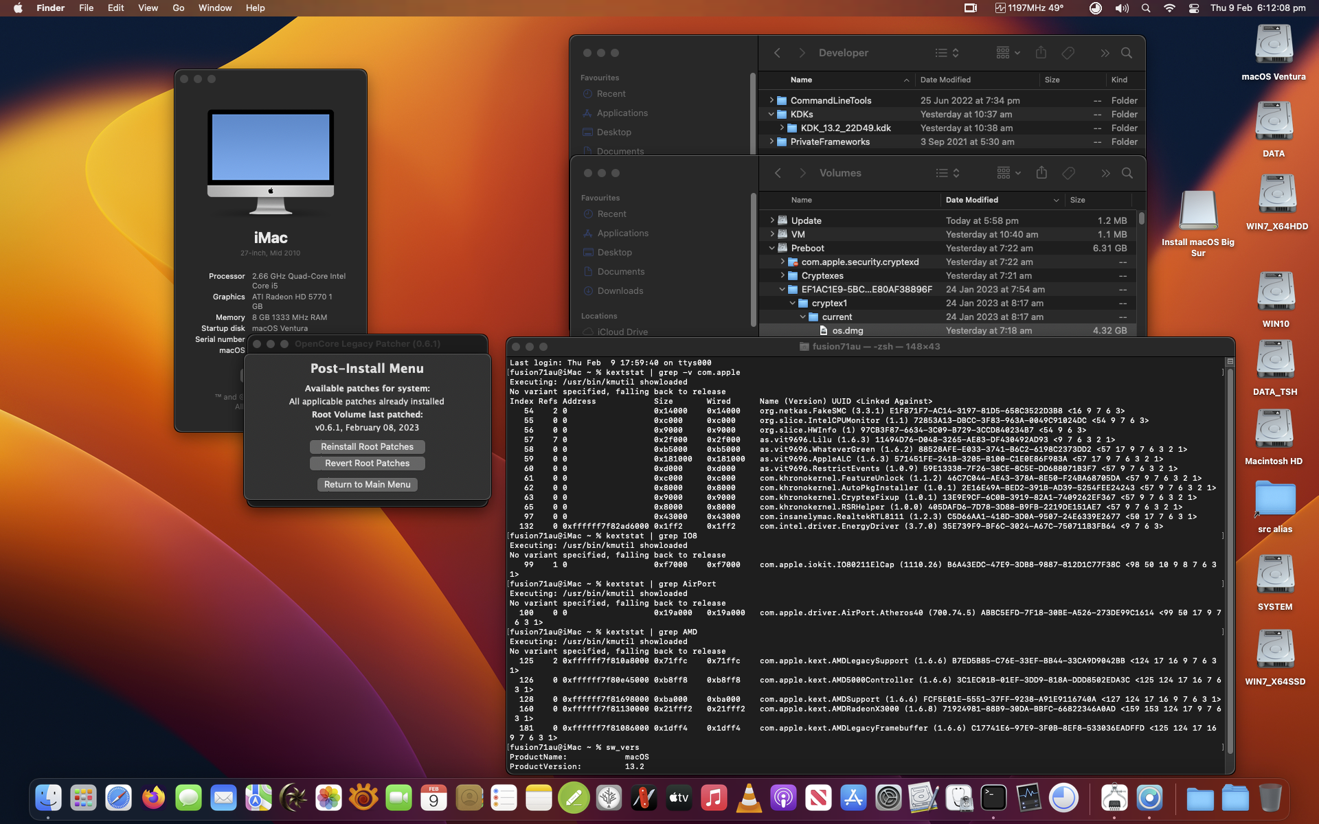

Hi Guys,
I’m a little late to the party but after finding out that Open Core Legacy Patcher 0.6.1 enables Ventura to run on legacy Macs like iMac11,3 and MacBookPro5,1, I thought I might try booting Ventura 13.2 on my legacy BIOS (non UEFI) hacks with OC 0.8.9 and kernel and kext patches adapted from OCLP 0.6.1…
Eg Dell XPS M1530 (before applying OCLP Wireless patch and graphics patches for Nvidia Tesla)
Spoiler
Eg Gigabyte P55A-UD3 after applying patch for Atheros Wireless and non metal AMD Terascale 2 graphics patches for ATI HD 5770
Spoiler
1601203492_Ventura13.2onP55A-UD3patchedwithOCLP0.6.1.thumb.png.580b873c9ee7e76f02ddcdcb230716e2.png
Attached is the EFI folder for the Gigabyte P55A-UD3:OC 0.8.9 for iMac11,3
I highly recommend reading @khronokernel's explanation for the various patches used in OCLP and also the specific changes needed to boot Ventura.  Thanks to him and all the OC/OCLP developers that keep our ancient hacks running :thumbsup_anim:.
Edited by fusion71au

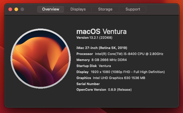

Question with OC 0.8.9 Dev. do you have any quirks like this , after pressing enter on boot ? ( I assume it will fix itself with the release )

7 hours ago, antuneddu said:
Work, work, work 🙃  I'll do it again next time (tomorrow maybe 😁 )
  Hide contents
277378751_Screenshot2023-02-13alle21_02_49.thumb.png.dc8fac096a27627ac5c67f65900c04cf.png
Hi @antuneddu -I also noticed this with new updates for OC 0.8.9.-wish they would fix this soon-makes The OC Picker look messy!
Build 1: iMac20,2, i5-9400F, Samsung 16GB DDR4 RAM, MSI Z390 Gaming Plus, Radeon RX 580 8GB, OC 0.8.9
Edited by ndungu6678

3 hours ago, eSaF said:
Итак, вы говорите, что если мы настроим наш EFI вручную, эта аномалия исчезнет!!?? Я проверю это как-нибудь сегодня и посмотрю. Если ваш пост о подробном тексте в меню загрузки.
I forgot to clarify - do you have a release version 089? not debugging?
13 minutes ago, eSaF said:
I use Nightly Versions, not debugging ones. What I am about to do now is build OC 0.8.9 and populate the EFI Folder without the use of a configurator (without the use of OCAT) as I normally do when updating the OC EFI Files and kexts. I will report any findings good or bad when completed.
I don't think OCAT has something to do with it... Anyway the OC 0.8.9 release is out... Try it directly... Before tonight I can't verify 😔
  • Like 3
20 hours ago, eSaF said:
Yes I was somewhat sceptical about that premise, anyway here is what I did as a test.
1. Built OC from scratch using Xcode.
2. Made sure all kexts are the latest released versions.
3. Populated the files and kexts within each respective EFI Folder for my particular machine.
4. Checked the completed Config.plist with the Ovalidate Utility from within the newly built OC folder which returned no errors as well as double checking all the Config.plist entries.
5. Placed the newly built OC EFI Folder onto the Partition of the drive after backing up my original one.
6. Boot off the new EFI, clean the NvRAM twice, rebooted and the anomaly is still there (see attached)
So as you stated it has nothing to do with OCAT, yes I did build the released OC 0.8.9 version. To be honest it is a bit unsightly but it's only there for approximately 2 seconds or so, one way out of it I suppose is to disable Verbose mode although I like to inspect any potential Boot up missteps.
Thank you @eSaF for clearing up doubt regarding the cause of this issue- as you say it has nothing to due with what is used to edit OC. Personally I always use OCAT, never OC Configurator cause as you pointed out in one of your earlier posts, OCAT has the ability to 'sync' the config.plist and EFI which I find ensures boot errors are eliminated correctly. I now ignore this verbose intrusion in the Picker and true it only happens for seconds.  Like you -I love seeing verbose output and will not disable it-

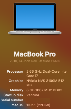

Smooooooth upgrade!  OC0.8.9 booting Ventura 13.2.1 on my HackBookPro6,2 (OCLP 0.6.1, Dell Latitude E6410).  Developers, you continue to amaze me!
EDIT: On this Legacy Hack, I am continuing to use FakeSMC3 instead of VirtualSMC.  Switching to FakeSMC3 as noted here has resolved all boot issues.  Big Sur, Monterey and Ventura boot flawlessly with the same EFI on this old hack.  I continue to use VirtualSMC on my KabyLake-R and CoffeeLake hacks, but for me, FakeSMC3 is best for this legacy Arrandale/NVidia hack.
