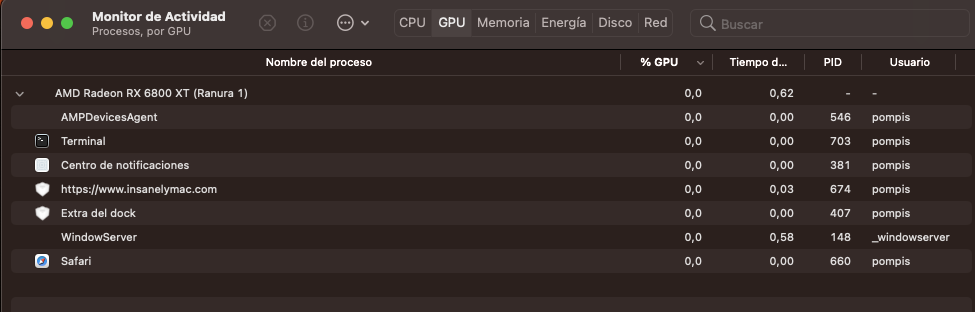

PoMpIs Posted August 2, 2022 Share Posted August 2, 2022 (edited) Would someone be so kind as to remind me what the command was for the GPU to appear in the activity monitor please It's that when I do a clean installation it doesn't come up anymore, and I don't remember... Among so many messages I can't find it 😅.. Thank you very much Edited August 2, 2022 by PoMpIs 1 Link to comment https://www.insanelymac.com/forum/topic/351969-pre-release-macos-ventura/page/88/#findComment-2790525 Share on other sites More sharing options...

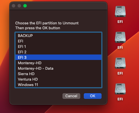

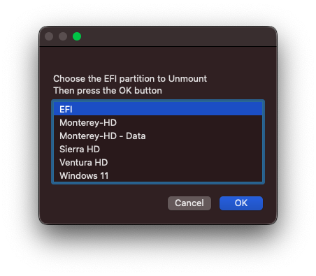

chris1111 Posted August 2, 2022 Share Posted August 2, 2022 (edited) With Ventura 13 you cannot eject the EFI partition without having to cancel another disk Here a Simple app to Eject EFI on Ventura 13 Note: you can not Unmount "EFI 1" or "EFI 2" Only EFI is available to unmount. Update: Eject EFI Ventura 13-V2 can unmount any EFI partition For quick access I put in my Applications then drag to my DOCK Spoiler Eject EFI Ventura 13-V2 can unmount any EFI partition Eject EFI Ventura 13.zip Update Eject EFI Ventura 13-V2 can unmount any EFI partition Eject EFI Ventura 13-V2.zip Edited August 4, 2022 by chris1111 Eject EFI Ventura 13-V2 can unmount any EFI partition 8 4 Link to comment https://www.insanelymac.com/forum/topic/351969-pre-release-macos-ventura/page/88/#findComment-2790529 Share on other sites More sharing options...
Guest ricoc90 Posted August 2, 2022 Share Posted August 2, 2022 23 minutes ago, PoMpIs said: Would someone be so kind as to remind me what the command was for the GPU to appear in the activity monitor please defaults write com.apple.ActivityMonitor ShowGPUTab -bool true Link to comment https://www.insanelymac.com/forum/topic/351969-pre-release-macos-ventura/page/88/#findComment-2790530 Share on other sites More sharing options...

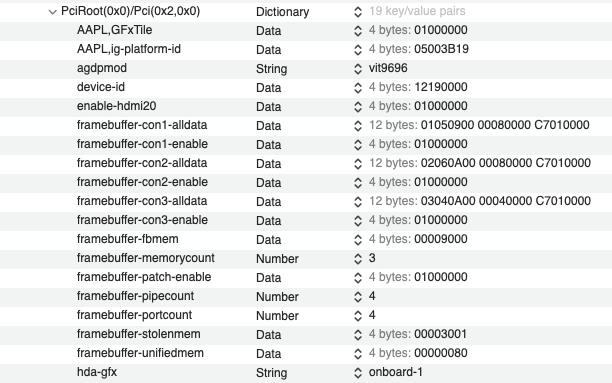

datafeedexpert Posted August 2, 2022 Share Posted August 2, 2022 On 7/27/2022 at 7:40 PM, Rocky12 said: @datafeedexpert i'm not the expert if u asking about connector patching config.plist-macOS Monterey.zip 5.98 kB · 17 downloads @Rocky12Here is your IGPU properties screen shot , Have to check both display connecter ? HDMI works good but DP no display using your IGPU Properties and boot args you used in this config.plist { igfxfcms=1 -igfxdvmt igfxonln=1 } My Optiplex 7050 MT Have 3 Connector (HDMI - DP - VGA) ( i5-6500T ) 1 Link to comment https://www.insanelymac.com/forum/topic/351969-pre-release-macos-ventura/page/88/#findComment-2790545 Share on other sites More sharing options...
Guest 5T33Z0 Posted August 2, 2022 Share Posted August 2, 2022 (edited) @PoMpIs defaults write com.apple.ActivityMonitor ShowGPUTab -bool true Oh, ricoc was faster. Edited August 2, 2022 by 5T33Z0 Link to comment https://www.insanelymac.com/forum/topic/351969-pre-release-macos-ventura/page/88/#findComment-2790546 Share on other sites More sharing options...
Rocky12 Posted August 2, 2022 Share Posted August 2, 2022 @datafeedexpert i don't have Monterey on this machine any more and really no idea about connector patching i have ventura installed without any connector patch only platform id 3 Link to comment https://www.insanelymac.com/forum/topic/351969-pre-release-macos-ventura/page/88/#findComment-2790547 Share on other sites More sharing options...

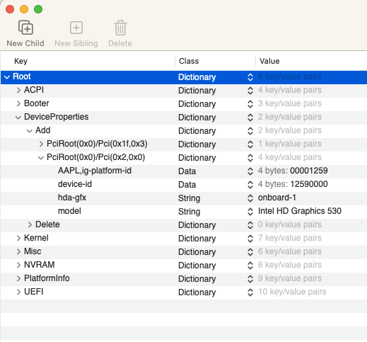

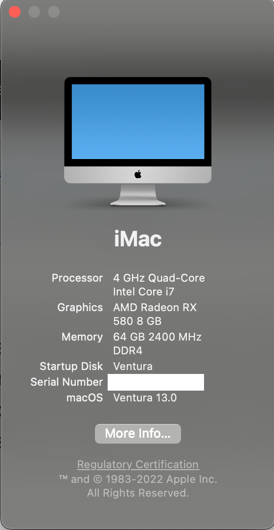

Henties Posted August 2, 2022 Share Posted August 2, 2022 (edited) I have still not been successful in setting up a GA-Z170X-UD3 hack, presently configured with iMac17,1 SMBOS, as per the attached EFI folder, to a SMBIOS of iMac18,1 with a working iGPU framebuffer. The objective is to upgrade macOS Monterey to Ventura 13 beta 4 and still end up with a working framebuffer. I can actually get rid of the "Skylake No Entry" message after I have changed the SMBIOS from iMac17,1 to iMac18,1 in the config.plist section PlatformInfo-->Generic-->SystemProductName iMac18,1 This change to my config.plist actually ensures that Ventura 13 beta 4 can actually be installed with a USB-stick installer, however without a working framebuffer. I have tested all 19 Kaby Lake frame buffers available through the latest version of Hackintool. The attachment "KBL Framebuffers tested" refers. The 19 tests actually involved plugging-in each framebuffer pair of the columns "AAPL,ig-platform-id" and "device-id" of the attached file, into the respective placeholders of the EFI config.plist file under: DeviceProperties-->Add-->PciRoot(0x0)/Pci(0x2,0x0) and then followed by system restart. None of the FB test combinations resulted in a functional framebuffer. It could well be that I am approaching this from a totally wrong angle and would appreciate for anybody to help me along in finally achieving the desired result. The attached EFI folder has been working for my Skylake system for many months/years without any problems whatsoever, including "Wake for network access", "Enable Power Nap" and "Sleep" The dGPU used is a AMD 580XT and under Skylake the iGPU is configured via a headless framebuffer. Greetings Henties EFI.zip KBL Framebuffers tested.rtf Edited August 2, 2022 by Henties 2 Link to comment https://www.insanelymac.com/forum/topic/351969-pre-release-macos-ventura/page/88/#findComment-2790548 Share on other sites More sharing options...
PoMpIs Posted August 2, 2022 Share Posted August 2, 2022 10 hours ago, ricoc90 said: defaults write com.apple.ActivityMonitor ShowGPUTab -bool true 2 hours ago, 5T33Z0 said: @PoMpIs defaults write com.apple.ActivityMonitor ShowGPUTab -bool true Oh, ricoc was faster. thanks a lot 1 Link to comment https://www.insanelymac.com/forum/topic/351969-pre-release-macos-ventura/page/88/#findComment-2790550 Share on other sites More sharing options...

Cyberdevs Posted August 2, 2022 Share Posted August 2, 2022 @Henties try this: EFI.zip and remind me again what is the model of your CPU? Link to comment https://www.insanelymac.com/forum/topic/351969-pre-release-macos-ventura/page/88/#findComment-2790552 Share on other sites More sharing options...
Henties Posted August 2, 2022 Share Posted August 2, 2022 @Cyberdevs Intel Core i7-6700K Thks for your EFI will have to try it a bit later though and come back to you with feedback. Greetings Henties Link to comment https://www.insanelymac.com/forum/topic/351969-pre-release-macos-ventura/page/88/#findComment-2790554 Share on other sites More sharing options...
Henties Posted August 2, 2022 Share Posted August 2, 2022 @Cyberdevs I now tested the modifications you applied to my EFI folder and report as follows: After slight "modifications" to your modifications, your modified EFI folder works quite well with iMac17,1 as the configured SMBIOS - no problems discovered so far - the "pikera...." boot arg now seems to be superfluous, great. Using that EFI, obviously with all the relevant settings applied, does still not allow me to select a framebuffer that is actually working with a SMBIOS setting of iMac18,3 and the KBL framebuffer that you inserted, as well as some of the others that I have retested - particularly the 2 headless fbs. that KBL offers. I have again attached the EFI folder, this time with most of your modifications included, but without the extensive "obliterations" of relevant, "ostensibly sensitive" identifiction data, only the serial number has been partly obliterated making it easier for us to exchange information required to hopefully arrive at a resolution of this problem I am experiencing. Thank you very much for your, to say the least, extensive input, which is much appreciated, in assisting me in this effort to hopefully finally sort this out eventually. Greetings Henties EFI.zip 2 Link to comment https://www.insanelymac.com/forum/topic/351969-pre-release-macos-ventura/page/88/#findComment-2790559 Share on other sites More sharing options...
Cyberdevs Posted August 2, 2022 Share Posted August 2, 2022 @Henties As far as I've tested the SMBIOSes only the following will work: iMac18,1 Macmini8,1 and MacPro7,1 I couldn't get the iMac18,3 to work with the iGPU. 2 Link to comment https://www.insanelymac.com/forum/topic/351969-pre-release-macos-ventura/page/88/#findComment-2790561 Share on other sites More sharing options...
Henties Posted August 2, 2022 Share Posted August 2, 2022 @Cyberdevs I follow what you are saying, in my particular environment I should perhaps try another one of the SMBIOSes you have listed, that's actually quite fair, will do so and report back. At this juncture I need to attend to some other chores I have been neglecting, will revert back as soon as time permits. In the interim it would be interesting if there are others that can, and are willing to make their contribution in helping me in resolving this peculiar problem. For quite a while I have been wondering whether this particular problem will just be history once Ventura 13 beta has been installed, with a framebuffer in Ventura 13 beta 4 being readily available for configuration in the native Ventura environment which the installer created. Just wandering. Greetings Henties Link to comment https://www.insanelymac.com/forum/topic/351969-pre-release-macos-ventura/page/88/#findComment-2790564 Share on other sites More sharing options...

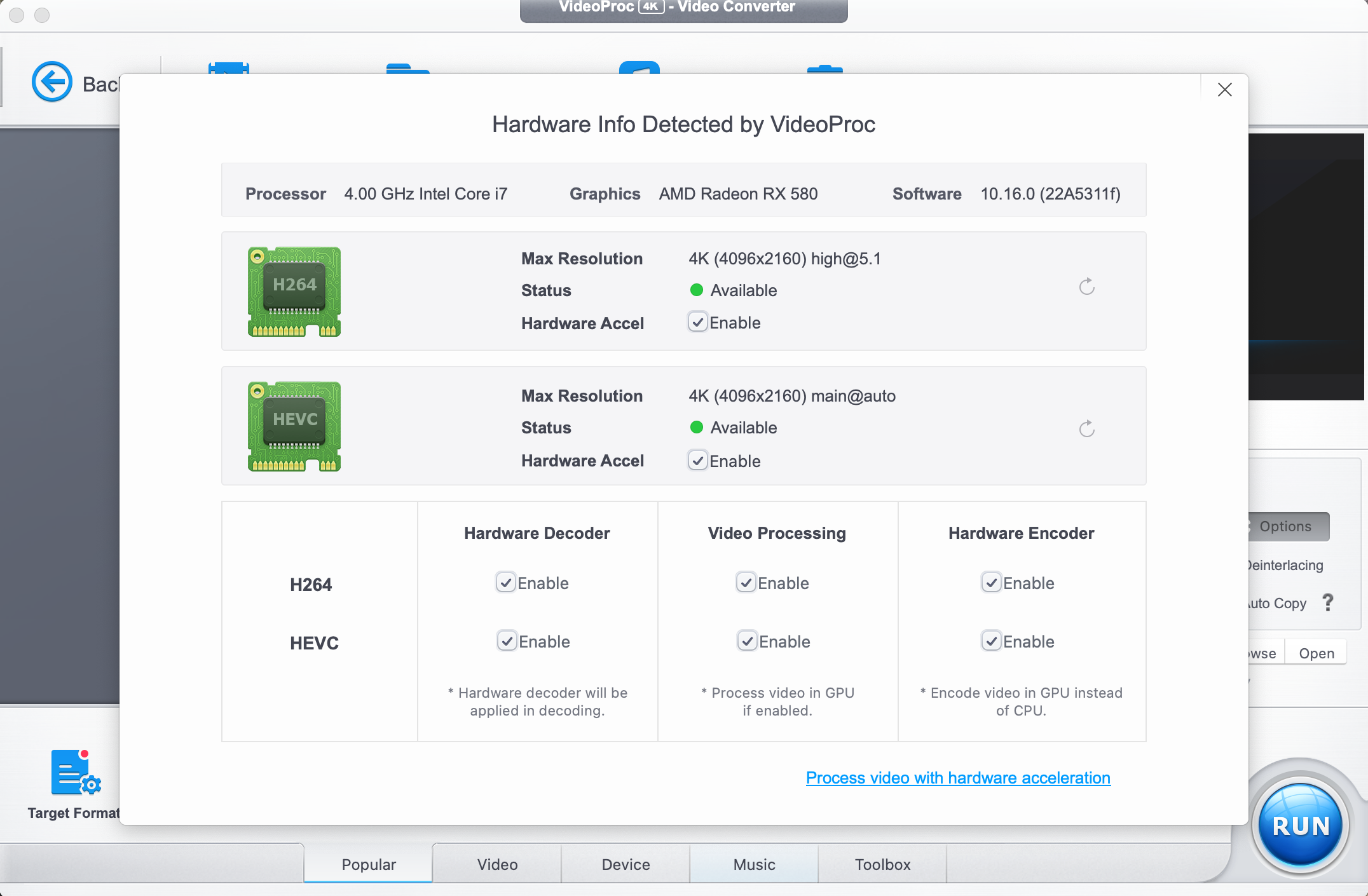

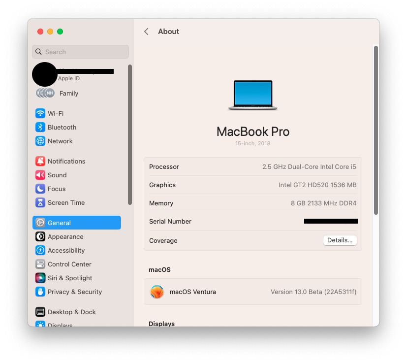

Henties Posted August 3, 2022 Share Posted August 3, 2022 @Cyberdevs Success. I took the plunge and installed Ventura beta 4 into an existing APFS HDD partition with ample free space thus creating a volume group of which Ventura 13 Beta (22A5311f) is just one of the members of that particular APFS volume group. Subsequently I used Migration Assistant to migrate all data, settings as well as apps from the Skylake NVMe, all apps are functional except 3 Rogue Amoeba programs and Little Snitch. For the latter the latest nightly build sorted out the problems with Ventura, Amoeba is presently working on Ventura compatible updates for its product range. Xcode also still needs to be updated with the beta for Ventura, but that can wait. What this all means is that my Skylake hack has received another lease of "modern" life, with the KBL 0x59120000 framebuffer also allowing video processing with hardware acceleration. Will now install Monterey 12.5 Release (21G72) over itself with a SMBIS of iMac18.1, hoping that this will also sort out the the KBL framebuffer spoofing problem in that particular environment. If successful one single EFI folder can be used to boot any of the 2 macOS versions in operation. Greetings Henties 3 1 Link to comment https://www.insanelymac.com/forum/topic/351969-pre-release-macos-ventura/page/88/#findComment-2790638 Share on other sites More sharing options...
