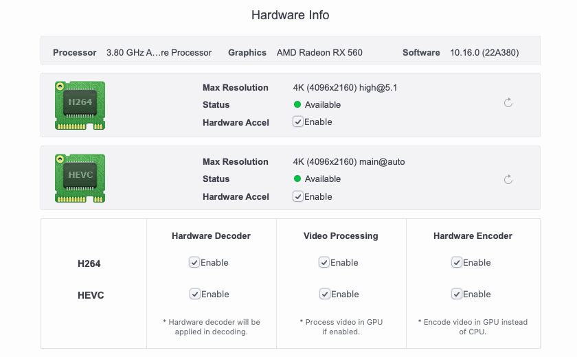

anerik70 Posted October 22, 2022 Share Posted October 22, 2022 4 hours ago, cyrhex said: would you mind to share how to enable rx 570 on nonavx 2.0 cpu? add this in your boot-args: -amd_no_dgpu_accel. Then apply oclp 5.0 5 Link to comment https://www.insanelymac.com/forum/topic/351969-pre-release-macos-ventura/page/133/#findComment-2795738 Share on other sites More sharing options...

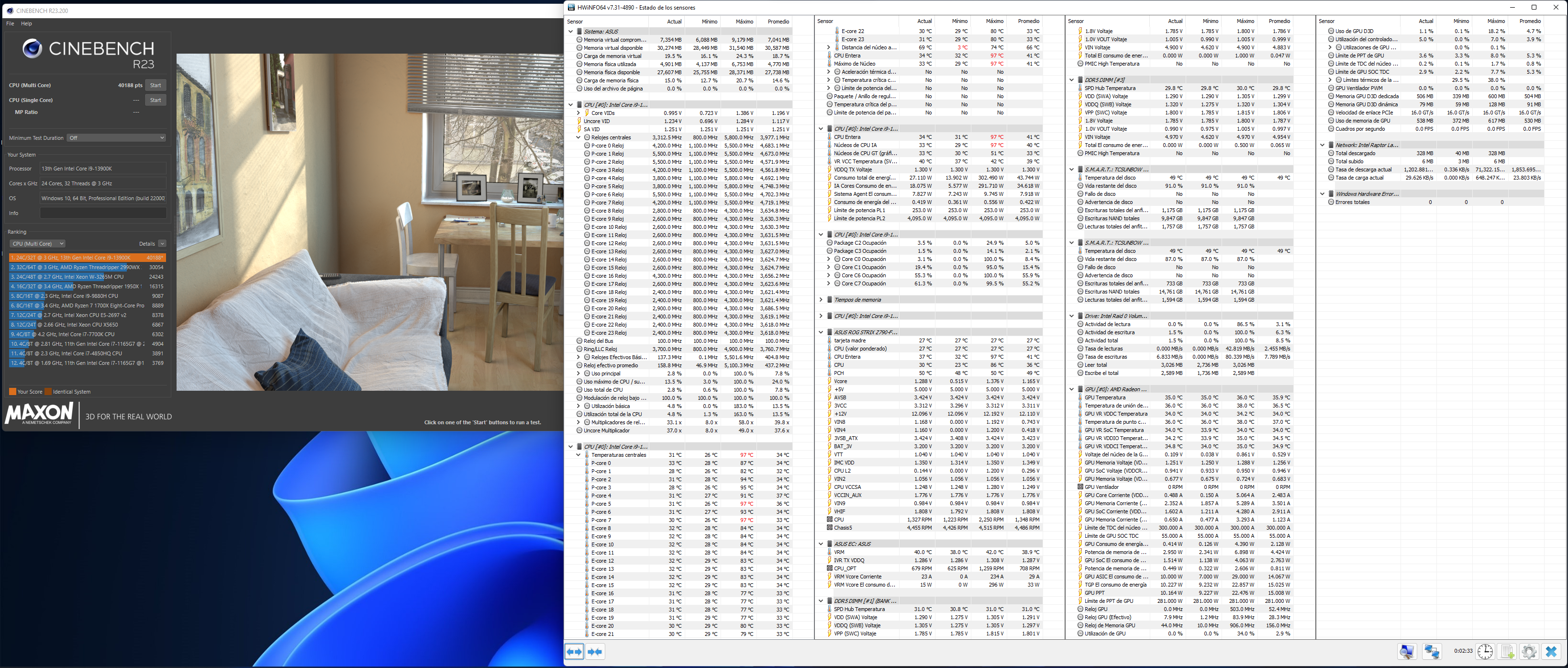

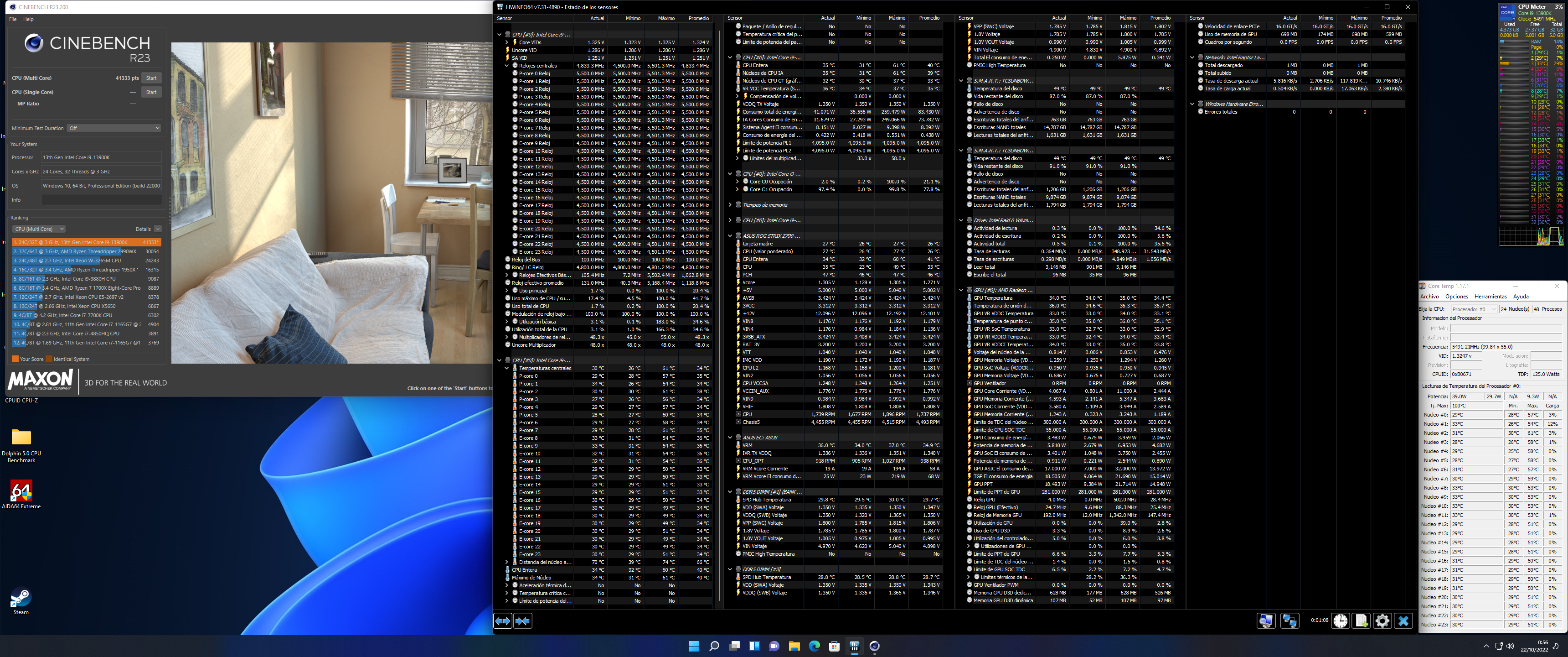

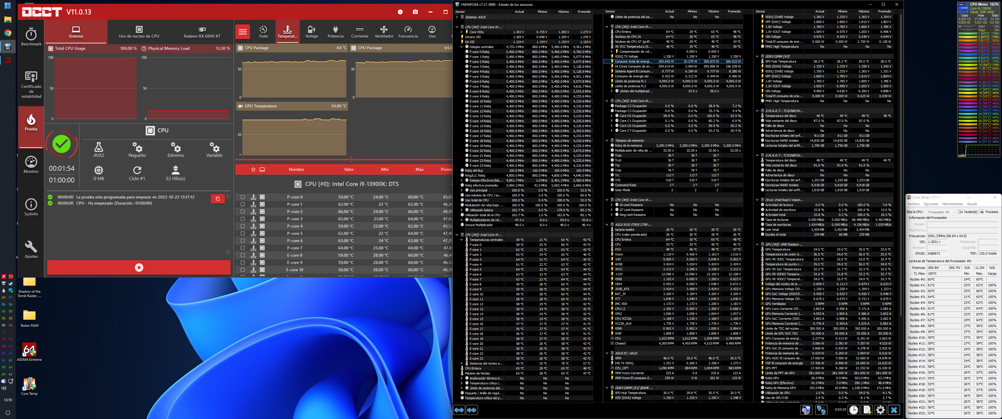

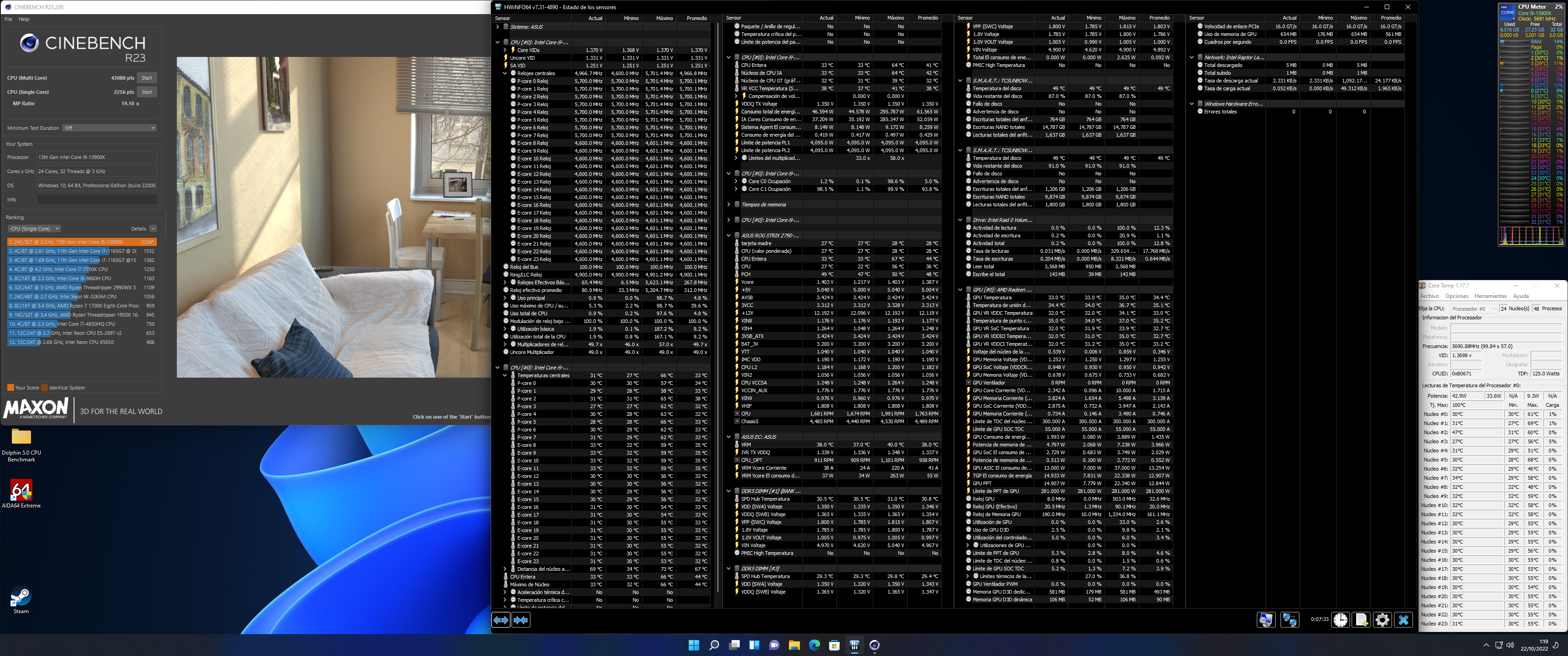

PoMpIs Posted October 22, 2022 Share Posted October 22, 2022 44 minutes ago, miliuco said: @PoMpIs Vaya máquina!!! OpnCore version of your EFI? Enjoy!!! It is version 0.8.5 I'm going to update to 0.8.6 to see what happens 😁 The computer is wonderful, it works very well... I have made it undervolt, and put the P-cores at 5.4Ghz and the E-cores at 4.4Ghz with a vCore at 1.120v load... and so on It is very fresh and yields very well.... I like it 👍 5 Link to comment https://www.insanelymac.com/forum/topic/351969-pre-release-macos-ventura/page/133/#findComment-2795740 Share on other sites More sharing options...
rhys216 Posted October 22, 2022 Share Posted October 22, 2022 35 minutes ago, PoMpIs said: It is version 0.8.5 I'm going to update to 0.8.6 to see what happens 😁 The computer is wonderful, it works very well... I have made it undervolt, and put the P-cores at 5.4Ghz and the E-cores at 4.4Ghz with a vCore at 1.120v load... and so on It is very fresh and yields very well.... I like it 👍 Thanks for posting your voltages, it'l give me a rough starting point. What are temps like right now, your using an air cooler right? 2 Link to comment https://www.insanelymac.com/forum/topic/351969-pre-release-macos-ventura/page/133/#findComment-2795741 Share on other sites More sharing options...

PoMpIs Posted October 22, 2022 Share Posted October 22, 2022 (edited) Just now, rhys216 said: Thanks for posting your voltages, it'l give me a rough starting point. What are temps like right now, your using an air cooler right? No... I'm using a custom RL.. 😅 I'll explain... ( Forgive the small offtopic to explain ) I like Hackintosh ever since apple switched to intel, my first hack was in 2006.... But my main hobby was always overclocking, I've been competing on Hwbot for quite some time. So, I have this processor with a custom RL, and yesterday I delid it and put liquid metal thermal paste (conductonaut) on it.. I leave you captures of the before and after in windows... now with the delid this computer is a true wonder Before delid: After delid: And here some tests at 5.7Ghz P-cores and 4.5Ghz E-Cores, uncore 4900Mhz at 1.403v by offset an LLC level 6 and I have also adjusted several more things in Digi+ ( IA DC, IA AC, VCCSA, VCCIO, IMC VDD ) And hitting it hard in OCCT AVX2 to check stability: Edited October 22, 2022 by PoMpIs 5 Link to comment https://www.insanelymac.com/forum/topic/351969-pre-release-macos-ventura/page/133/#findComment-2795744 Share on other sites More sharing options...

rhys216 Posted October 22, 2022 Share Posted October 22, 2022 46 minutes ago, PoMpIs said: No... I'm using a custom RL.. 😅 I'll explain... ( Forgive the small offtopic to explain ) I like Hackintosh ever since apple switched to intel, my first hack was in 2006.... But my main hobby was always overclocking, I've been competing on Hwbot for quite some time. So, I have this processor with a custom RL, and yesterday I delid it and put liquid metal thermal paste (conductonaut) on it.. I leave you captures of the before and after in windows... now with the delid this computer is a true wonder Before delid: After delid: And here some tests at 5.7Ghz P-cores and 4.5Ghz E-Cores, uncore 4900Mhz at 1.403v by offset an LLC level 6 and I have also adjusted several more things in Digi+ ( IA DC, IA AC, VCCSA, VCCIO, IMC VDD ) And hitting it hard in OCCT AVX2 to check stability: Pretty impressive reduction in temps! I did a similar thing with a 6700k. Switched out the tim but kept the same heat spreader. Are you using the original heat spreader or is the cpu a naked die? 2 Link to comment https://www.insanelymac.com/forum/topic/351969-pre-release-macos-ventura/page/133/#findComment-2795748 Share on other sites More sharing options...
PoMpIs Posted October 22, 2022 Share Posted October 22, 2022 21 minutes ago, rhys216 said: Pretty impressive reduction in temps! I did a similar thing with a 6700k. Switched out the tim but kept the same heat spreader. Are you using the original heat spreader or is the cpu a naked die? No, I use its IHS, but it's not sealed, I clean it, I put the conductonaut in the DIE, then inside the IHS, I put it in the socket and when I close it it's fixed... then I put the conductonaut between the IHS and the RL EK block and that's it... and that looks great 👌 2 Link to comment https://www.insanelymac.com/forum/topic/351969-pre-release-macos-ventura/page/133/#findComment-2795750 Share on other sites More sharing options...

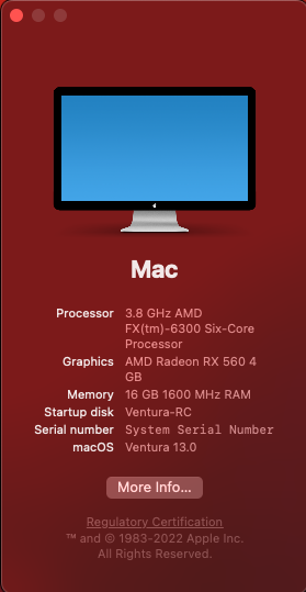

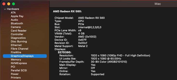

jsl2000 Posted October 23, 2022 Share Posted October 23, 2022 (edited) 7 hours ago, anerik70 said: add this in your boot-args: -amd_no_dgpu_accel. Then apply oclp 5.0 Thanks for your advice which solve black screen issue of RX-560 before OCLP in my FX-6300 hackintosh. Edited October 23, 2022 by jsl2000 5 Link to comment https://www.insanelymac.com/forum/topic/351969-pre-release-macos-ventura/page/133/#findComment-2795753 Share on other sites More sharing options...
anerik70 Posted October 23, 2022 Share Posted October 23, 2022 34 minutes ago, jsl2000 said: Thanks for your advice which solve black screen issue of RX-560 before OCLP in my FX-6300 hackintosh. ENJOY! There are two task to finish here: 1. To get OTA updates. 2. PM. 2 Link to comment https://www.insanelymac.com/forum/topic/351969-pre-release-macos-ventura/page/133/#findComment-2795754 Share on other sites More sharing options...

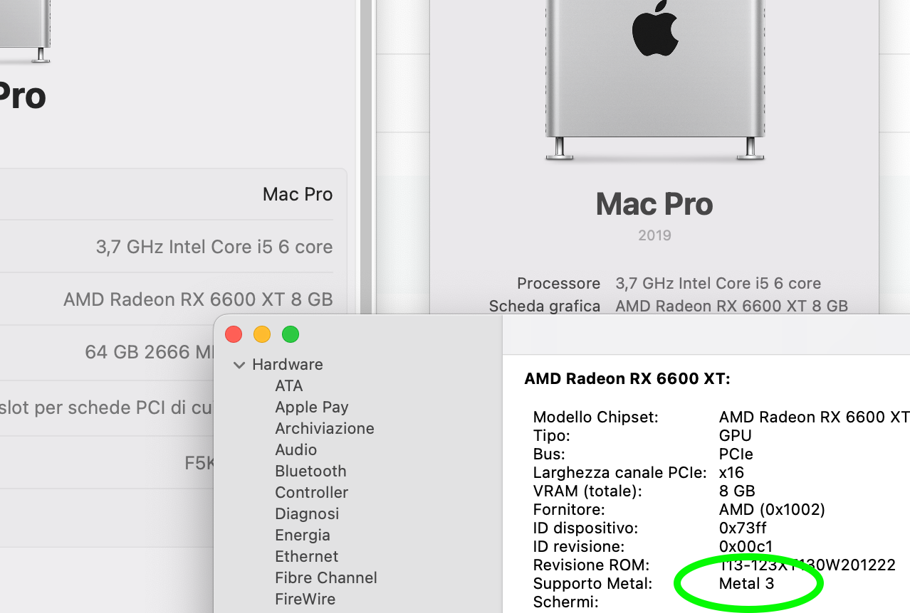

axonleo Posted October 23, 2022 Share Posted October 23, 2022 has anyone gpu that is metal 3 capable and enabled in the about graphic/ display ? Link to comment https://www.insanelymac.com/forum/topic/351969-pre-release-macos-ventura/page/133/#findComment-2795762 Share on other sites More sharing options...
D3v1L Posted October 23, 2022 Share Posted October 23, 2022 (edited) 6 hours ago, axonleo said: has anyone gpu that is metal 3 capable and enabled in the about graphic/ display ? All Vega - Navi - Navi 2 GPU (Polaris 20/30 - RX5x0 - stop on Metal 2) Edited October 23, 2022 by D3v1L 3 Link to comment https://www.insanelymac.com/forum/topic/351969-pre-release-macos-ventura/page/133/#findComment-2795763 Share on other sites More sharing options...
