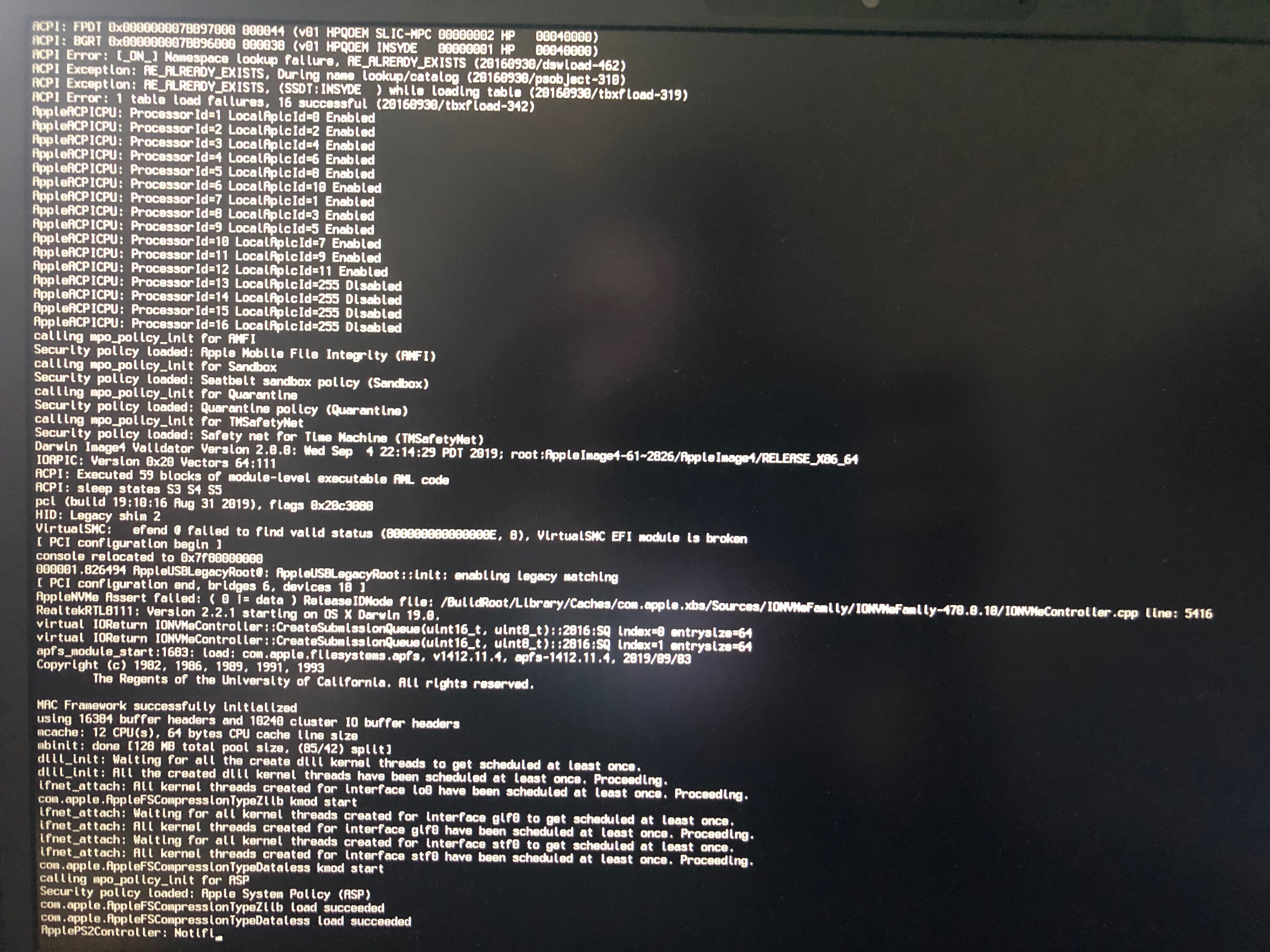

My USB where OpenCore is formatted as HFS+, whilst Catalina is using APFS.

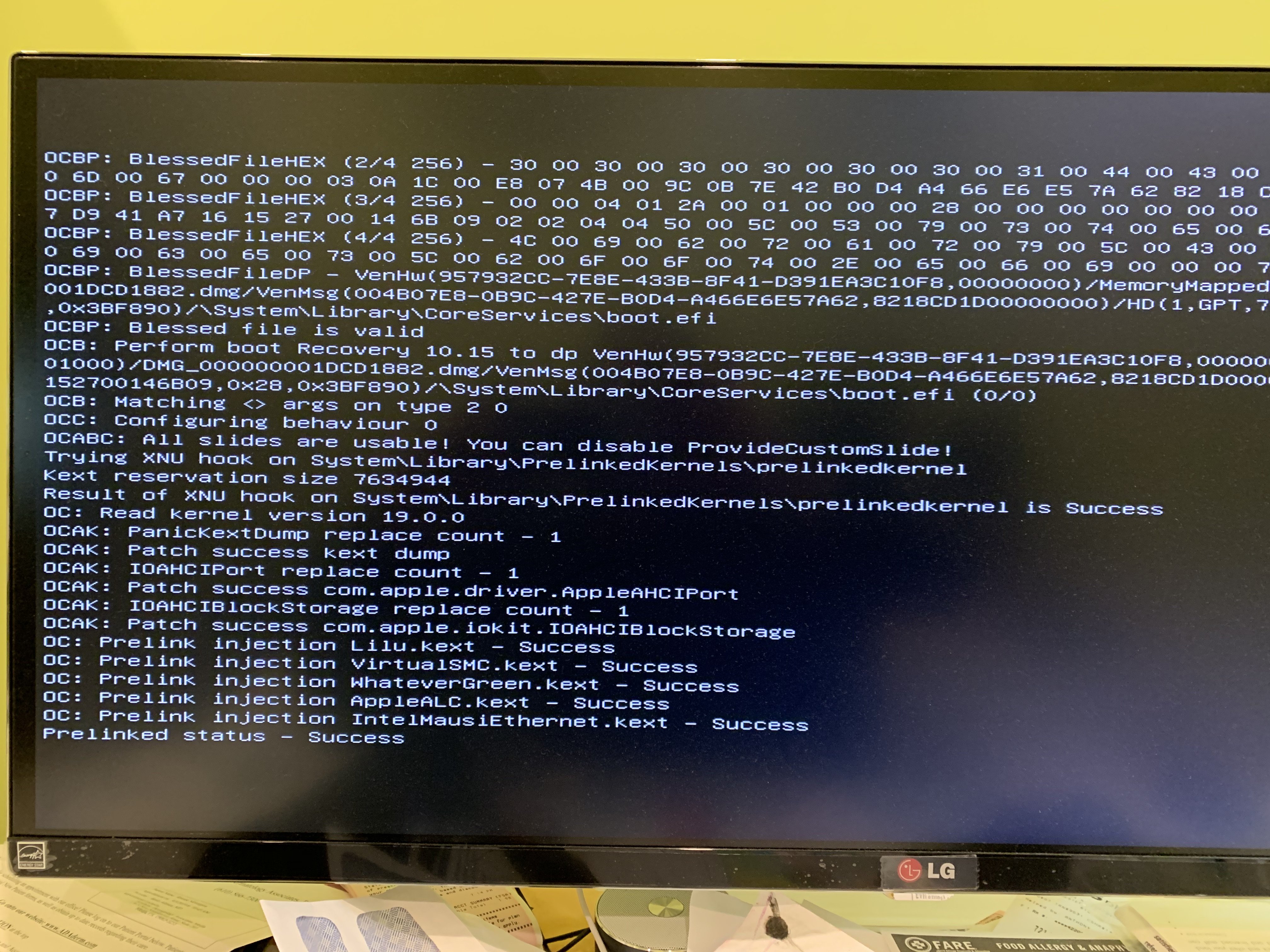

Your suggestion actually took me to a new error, which I have attached below.
Seems to be a potential issue with virtualsmc. Did you include it’s plugins in your config kext list?

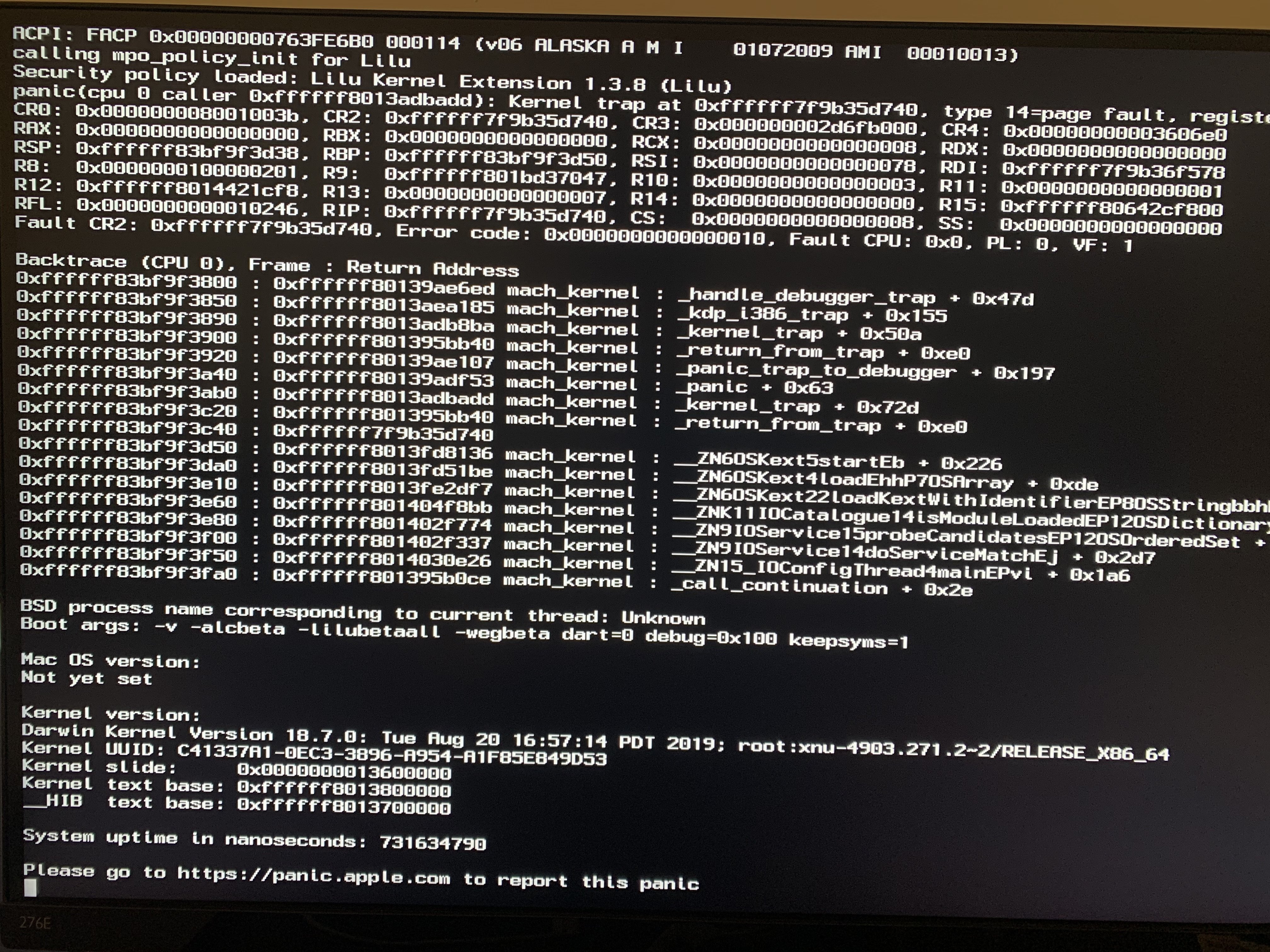

I had my ScanPolicy set to 0 and changed it to 983,299 as per Vanilla Guide under Security. It does boot now, even though I still get an error. I am not sure why it would not boot when I select 0, i.e. scan all.

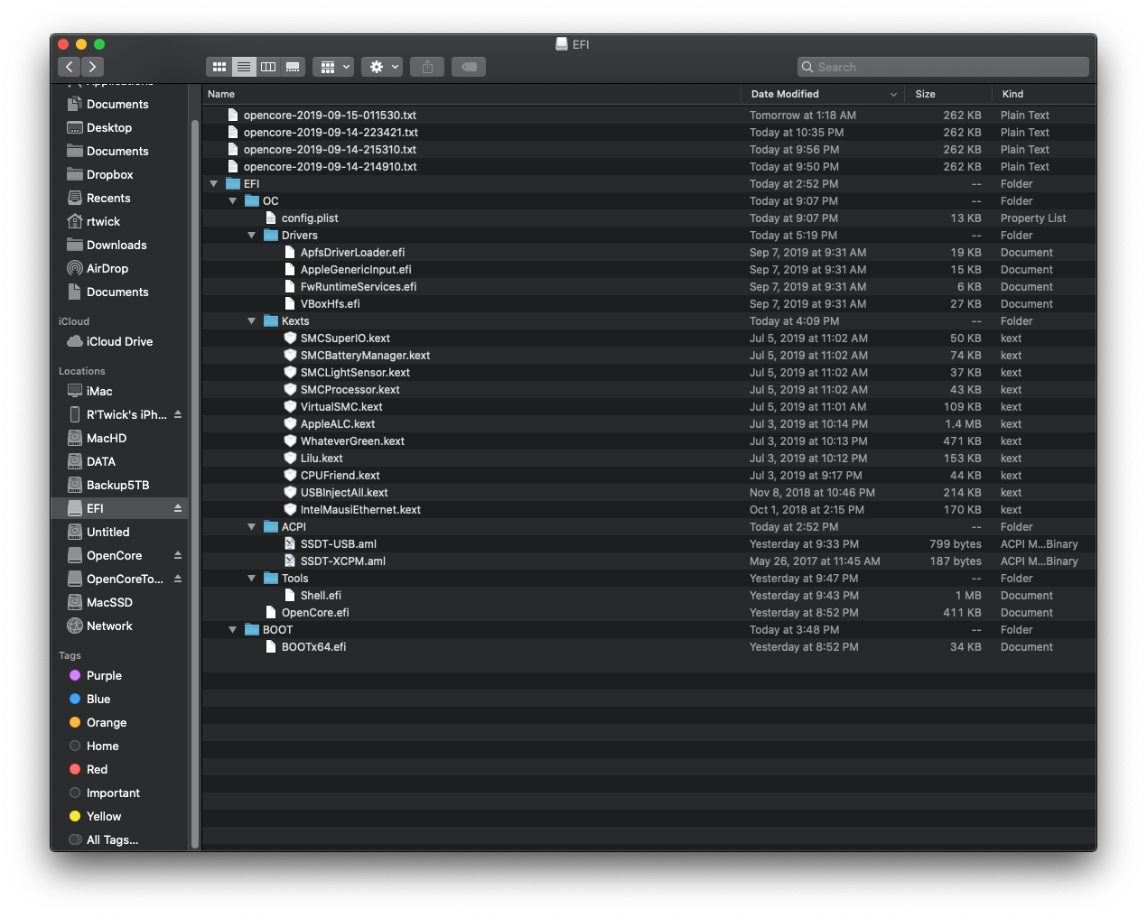

Yes, I have it in the OC/Drivers folder as well as under UEFI>Drivers>0>VirtualSMC.efi on my config.plist.
I still cannot understand why my VirtualSMC is broken, given that I updated it to the latest release.
2 hours ago, Matgen84 said:
Do you try to remove virtualsmc.efi (keep virtualsmc.kext of course)

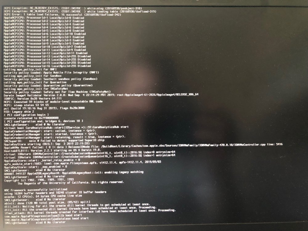

I have tried that and my screen has now change. I have also swapped the AppleGenericInput.efi for UsbKbDxe.efi to try and resolve the issue of ApplePS2Controller, but it still stands.
- ACPI: Same as before
- Drivers: ApfsDriverLoader, FwRuntimeServices, UsbKbDxe, VBoxHfs
- config.plist updated attached as well as screenshot
Thank you!
Thank you!
config.plist

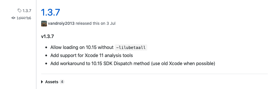

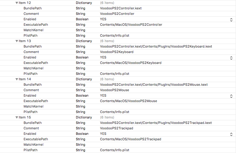

Get Acidanthera VoodooPS2. Edit your config like this:PS2.png.aa2a24e206d9a0ff5d4a91f6401f4cd2.png
Thank you!
config.plist
VirtualSMC.efi module is recommended for boot.efi compatibility when FileVault 2 is enabled. :) If you don't use FileVault2, remove it.
Do you try to select 'ThirdPartyTrim' Quirk to YES.
Thanks for this! To be honest, I was using VoodooPS2Controller from RehabMan. I was not aware of Acidanthera's kext in relation to VoodooPS2.
I have updated my new configuration which took me to a new screen, yet my VirtualSMC is still broker and will not boot. Strange how everything works under Clover but not under OpenCore, as the system is the same.
Please find everything attached to the post.

Fair enough. I believed it was a compatibility issue as FakeSMC requires FakeSMC.efi. Also, my VirtualSMC is still broken as you can see below.
I have enabled TRIM even though I am using an HDD for my Catalina partition.
Thanks again!
config.plist

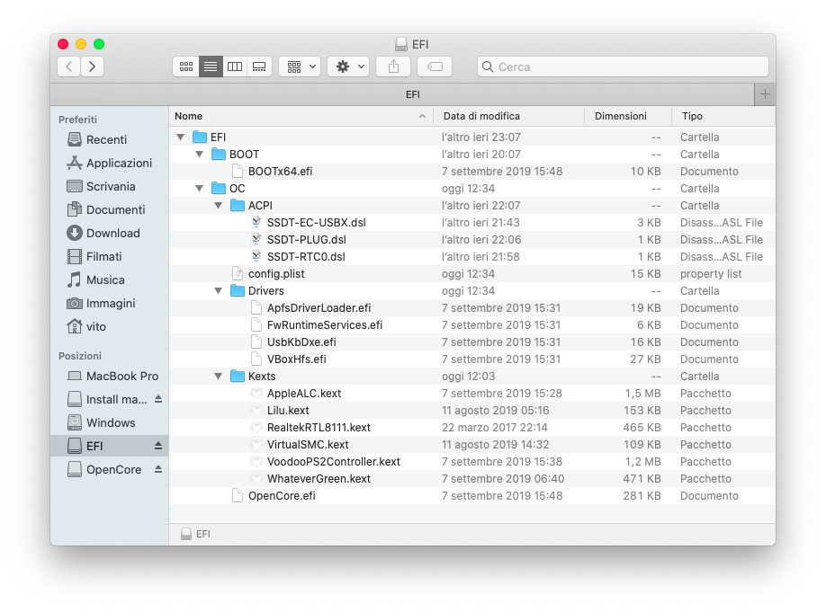

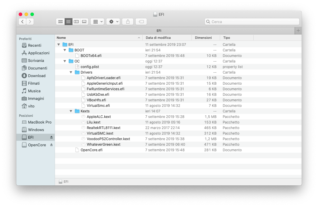

Download virtual smc package. Rigt click VirtualSMC  Show Package Contents, enter Contents directory. Create folder named PlugIns and put all virtual smc plugins in it. Edit config:smc.png.15ac132fec507197a6c718972a25c920.png
I have done what you suggested, but there is no real change. I can see as well that one of the ACPI table is failing on start up. I have also tried adding "-vsmcbeta" in my boot-args, because I am running Catalina Beta 8, but without success to boot.
I have updated my config.plist and I have attached it to this post.
I was wondering whether it is worth looking at my DSDT.aml with MaciASL?
Thank you!
config.plist

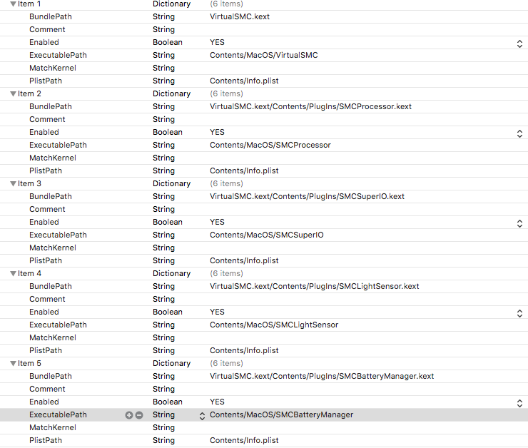

Try only with SMCProcessor.kext and SMCSuperIO.kext, also edit Config.

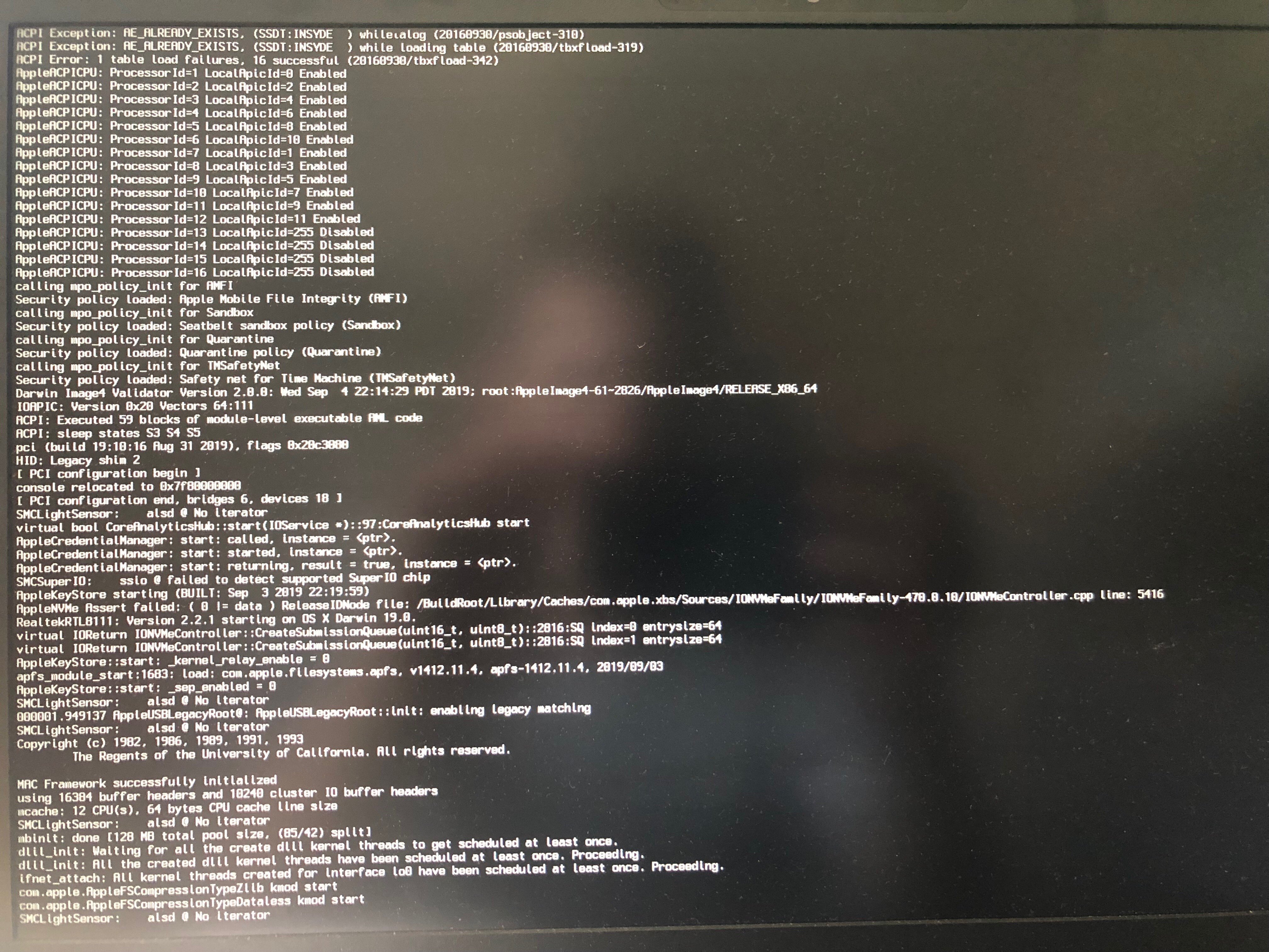

Thanks for your reply. I actually managed to get everything working back again, following my Clover configuration and adapting it to OpenCore. I also used another online resource.
My specs: i7 8750H, UHD 630, RAM 16GB.
Working: Ethernet, Audio, iGPU.
So far, I do not want to configure the whole system as I am using this for testing purpose only on this laptop.
Nonetheless, I would like to dig deeper into my ACPI and the correct functioning with OpenCore.
Effectively, the system is working without any ACPI patches, as I have completely removed the ACPI folder as it kept on giving me problems with the ACPI samples I found on the vanilla guide, and I have only left the EC0 to EC from my previous post. Most of the ACPI is also changed automatically by WhateverGreen anyway. I also had to add all the "beta" args for Lilu, WhateverGreen and AppleALC for it to work properly on Catalina.
I can also see the Recovery option on the OpenCore Boot Menu, but it does not work as it does not load. It is not an issue as I would probably never use it anyway, and it is for testing only, so I am going to pass on this.
I am assuming Reset NVRAM option worked as I get a reboot with a black screen and I am back again in OpenCore.
I have not tried the BOOTCAMP Windows options, but as far I can understand, ACPI should not be automatically patched in Windows from OpenCore. Even so, I would never use OpenCore to boot to Windows.

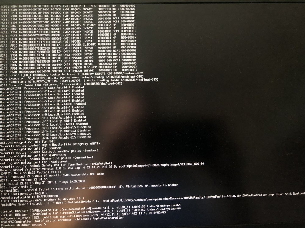

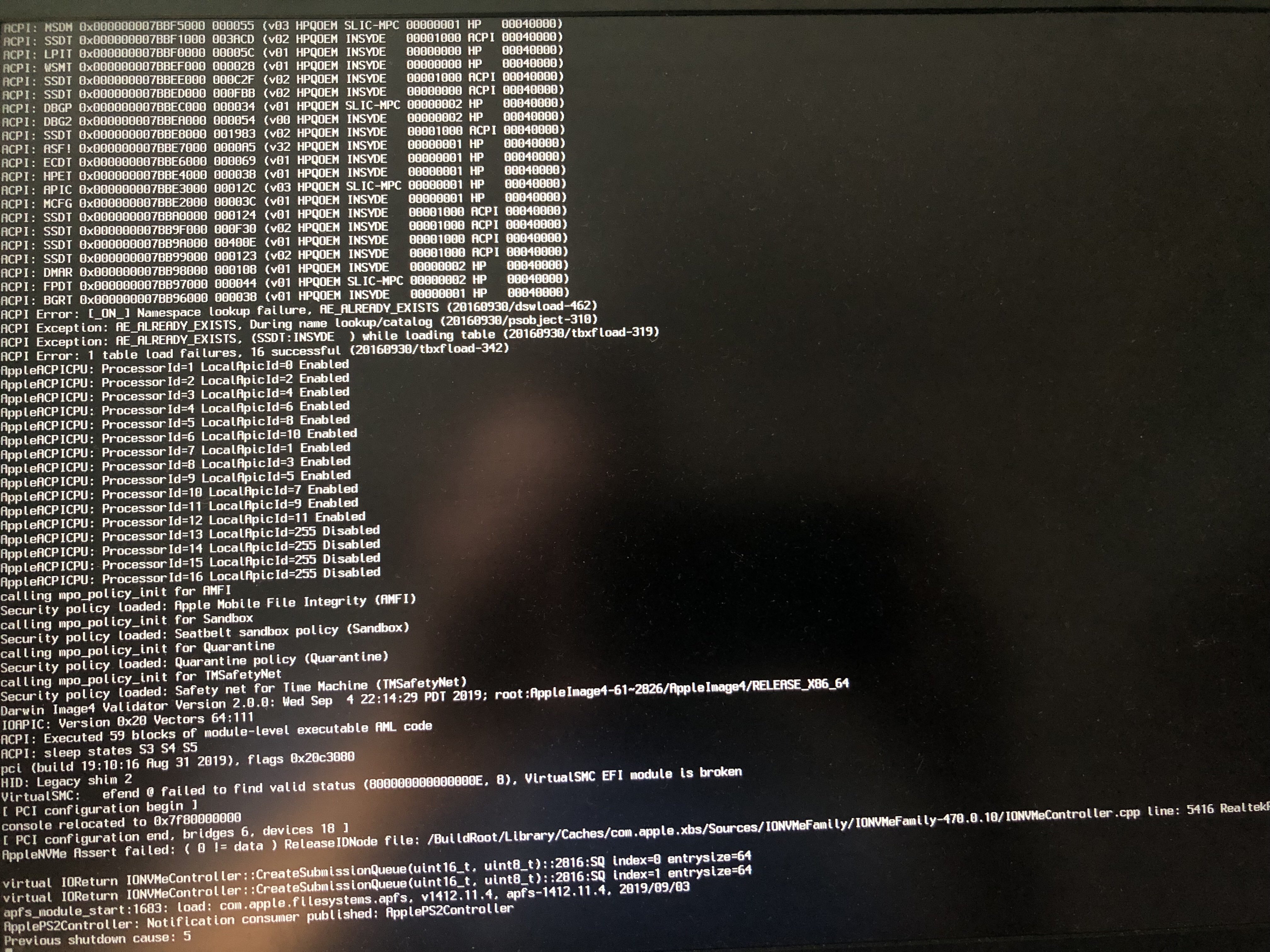

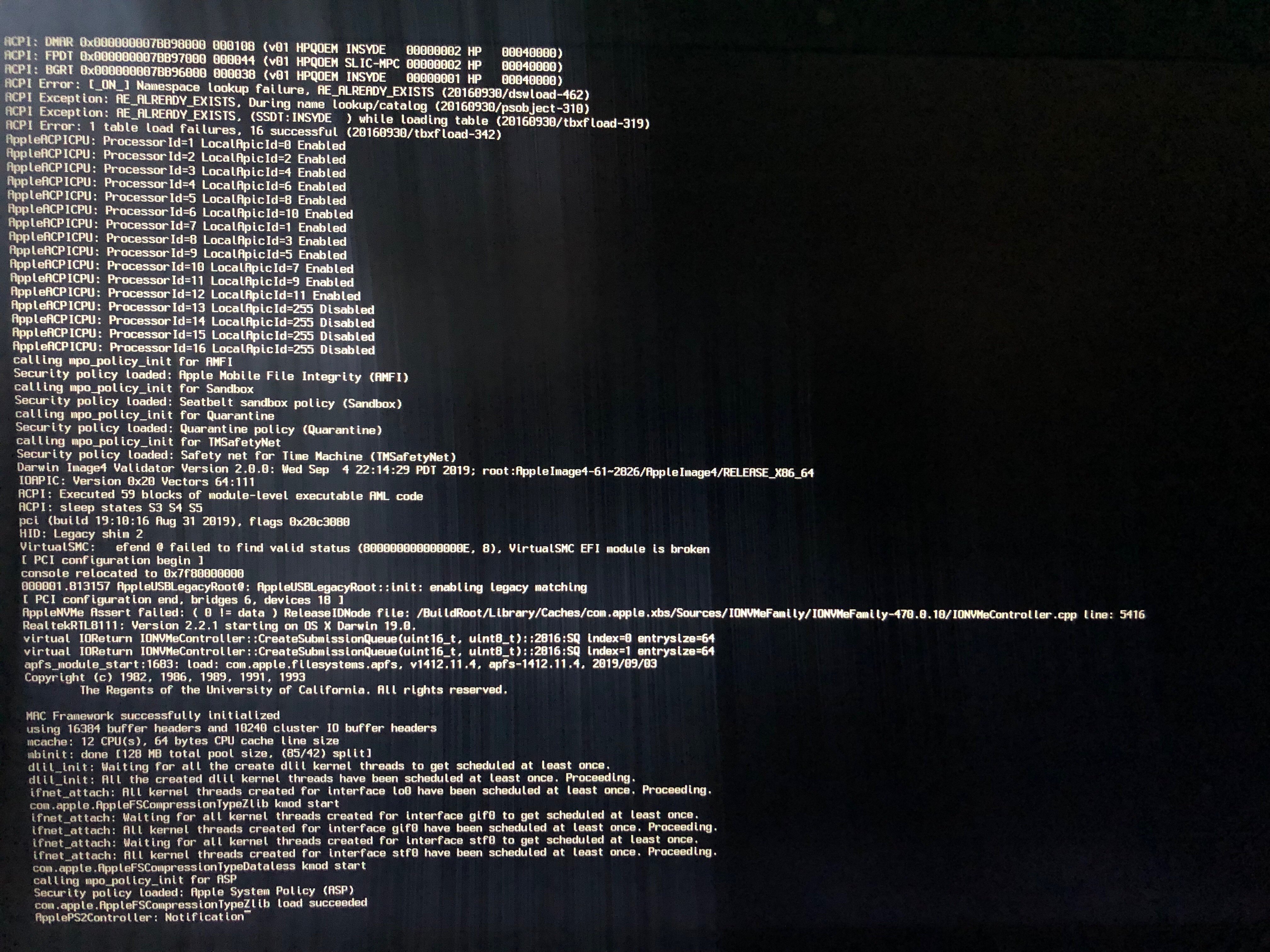

I would like to know what could be causing the following errors:
Quote
VirtualSMC: efend @ failed to find valid status (000000000000000E, 8), VirtualSMC EFI module is broken
Quote
ACPI Error: [_ON_] Namespace lookup failure, AE_ALREADY_EXISTS (20160930/dswload-462)
ACPI Exception: AE_ALREADY_EXISTS, During name lookup/catalog (20160930/psobject-318)
ACPI Exception: AE_ALREADY_EXISTS, (SSDT: INSVDE) while loading table (20160938/tbxfload-319)
ACPI Error: 1 table load failures. 16 successful (201609930/tbxfload-342)
I also get an error regarding power management but I have the configuration set with MacBookPro15,2 which has the CPU I utilise.
I would further like to know how to dump a log of OpenCore, as I tried with the F keys, but I am unsuccessful. Perhaps, I have to enable a setting in my config.plist I am unaware of?
Last but not least, I would like to know whether OpenCore settings, such as Quirks are off by default rather than me specifying them all the time. So I can have a cleaner config.plist.
Particularly with SignedPolicy, is it YES (true) but default or NO (false)?
Thank you in advance!

As I told you, you had disassembled ACPI with .dsl extension, they won’t work. Have to open it and save as ACPI Machine Language Binary.with .aml extension, the same in config.  I’m on desktop so I won’t be much of help, but I think without some add-ons-hotpatches SSDTs in your ACPI folder you won’t go too far. Check RehabMan’s repository or other sources. Replace VBoxHfs.efi driver with HfsPlus.efi could help with booting recovery problem. “Beta” arg is unnecessary, but I could be wrong.
I forgot to mention that I did use MacIASL to patch my SSDT and lookup my entire DSDT and then compiled them to .aml. Whilst they were loading perfectly, I kept on getting more ACPI failures that I would without any ACPI SSDT at all, hence my question regarding ACPI. I also had to change CPU0 to PR00 in one of the ACPI samples, for it to work and compile it again, so I got the hang of it in the end.
Regarding VBoxHfsPlus, this is the one attached to the AppleSupportPkg. Is it worth changing it to HfsPlus to render it "less vanilla"? What is the difference between the two?
The "-lilubetaall" etc args are necessary as Catalina is not stable yet, look it on the Wiki page.
Since  July, Lilu (v1.3.7+) is compatible with Catalina . It is the same of Lilu plugins: AppleALC, WhateverGreen and so on. The "-Lilubetaall" boot-args isn't necessary.
  • Thanks 1

From Configuration.pdf:hsf.png.5b03ae51a41287841c7bbeb8bfff9233.png
Just replace drivers edit Config and see if recovery works.

Hi,
trying out opencore. I have configured an usb following the Vanilla desktop Guide from https://khronokernel-2.gitbook.io/opencore-vanilla-desktop-guide/
I can go into OC menu and select my OS item but it just stops after "Prelinked status - Success". Keyboard also stops working.
My config: Gigabyte Z270X-UD5, I7700K, with an NVME , two ssd and a hdd running Catalina beta 8 (build 19A558d). It works perfectly fine with Clover.
To remove any messed up prelinked kexts, I installed catalina beta on a freshly formatted ssd and it boots fine via Clover. However, it also shows the same behavior under OC.
Attached is a screen shot of where it is stopping, OC log and my config.plist. I'm definitely missing something here but after spending the whole day reading the whole 71 pages still couldn't figure it out.
Any pointer?
Thanks
-R'twick
opencore-2019-09-15-011530.txt
config.plist
I wanted to try out opencore, but I get a kernel panic. Photo attached. Can any one offer advice?
9700K with ASRock Z390 ITX/AC and a Vega64 reference card at 4K@60 over DP.
log has the following:
00:000 00:000 OC: Setting NVRAM 7C436110-AB2A-4BBB-A880-FE41995C9F82:nvda_drv - Not Found
00:000 00:000 OC: Setting NVRAM 7C436110-AB2A-4BBB-A880-FE41995C9F82:prev-lang:kbd - Not Found
00:000 00:000 Dependency com.apple.iokit.IOHIDSystem fallback to com.apple.iokit.IOHIDSystem succeeded. Please fix your kext!
serials from attached config.plist have been redacted.
OC_config.plist
