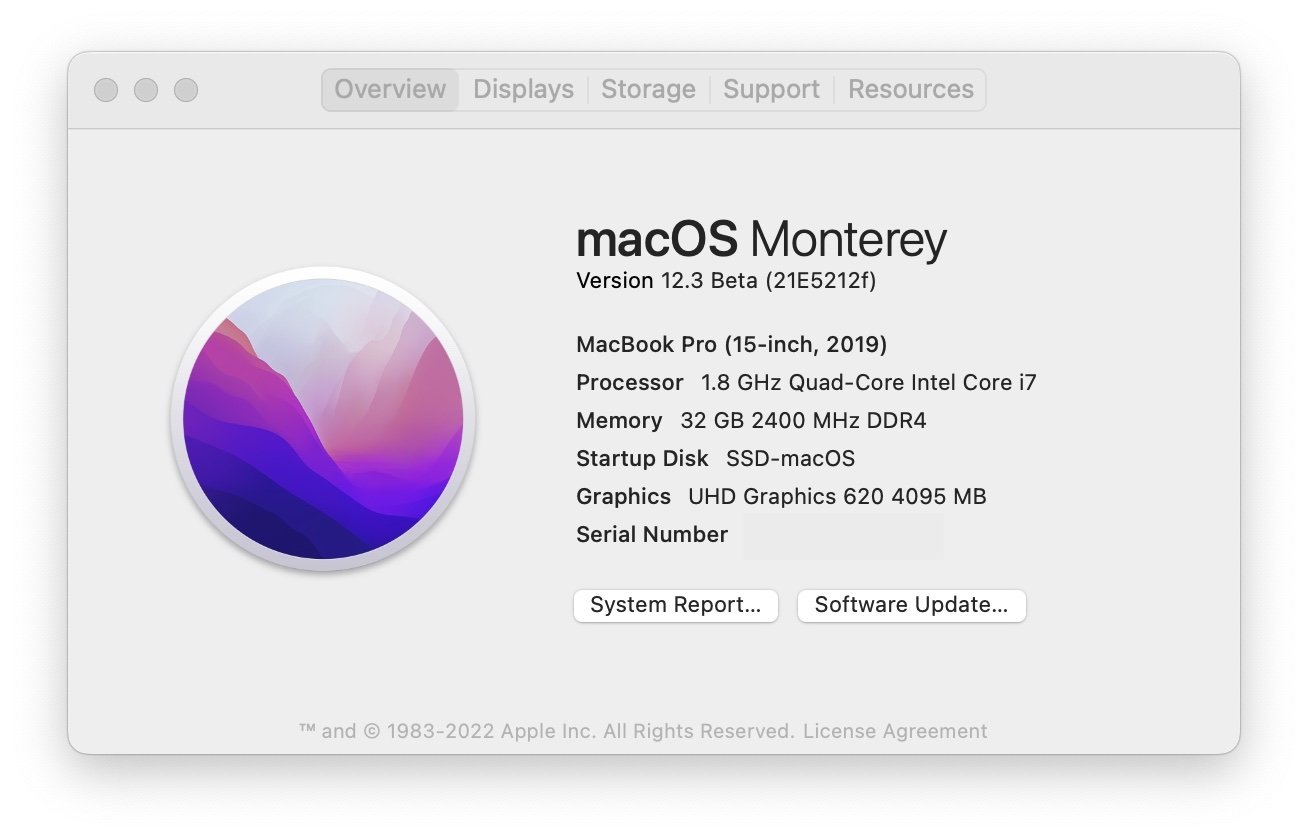

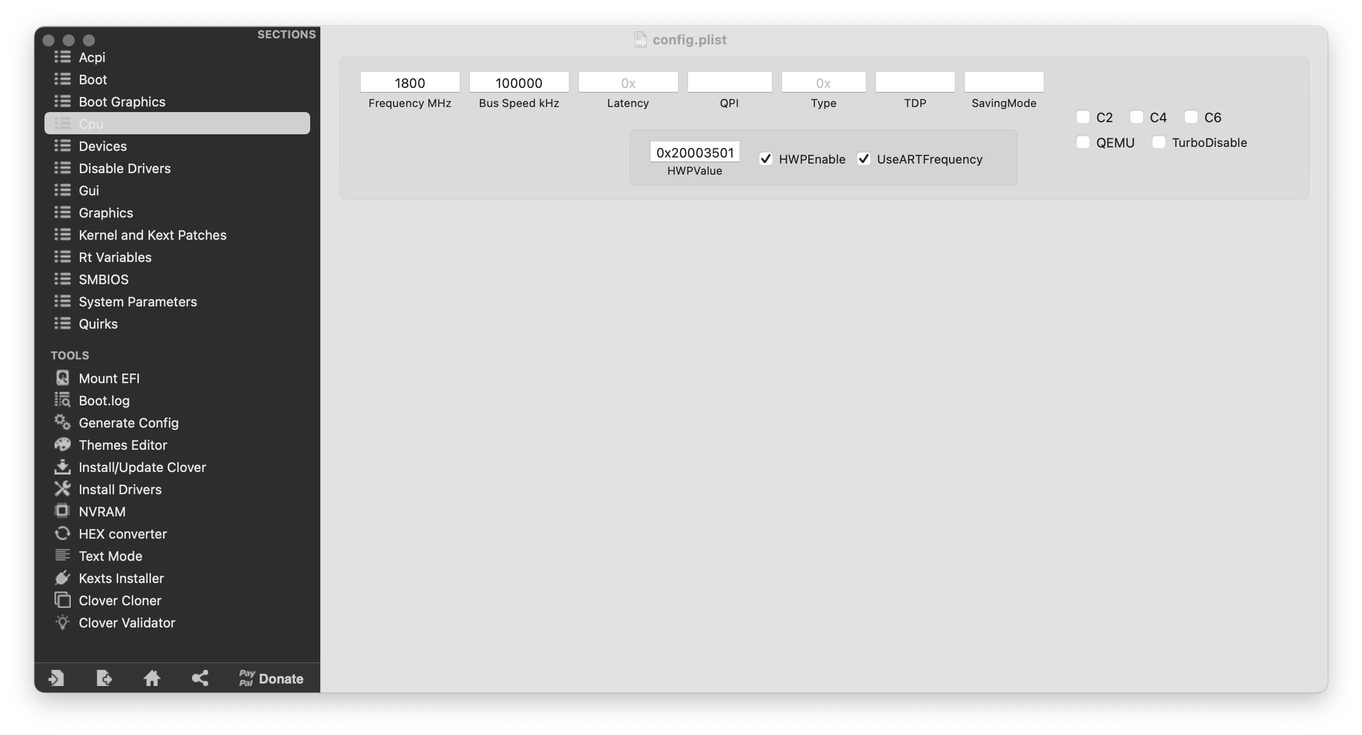

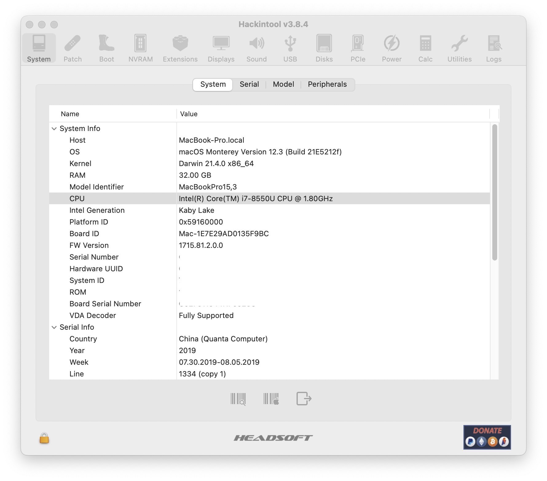

mnfesq Posted February 21, 2022 Share Posted February 21, 2022 I have a nagging problem that I just can't seem to solve. Hackintool properly identifies my CPU as an i7-8850U @ 1.80 GHz. Spoiler Clover properly identifies my CPU as a 1.8 GHz Quad-Core Intel Core i7 Spoiler But for some reason, OpenCore identifies my CPU as a 2 GHz Quad-Core Intel Core i7. Spoiler What gives and how can I fix this? I have read up on the CPU Type variable in config.plist and it does not address the frequency of the CPU, only its type. What controls the identification of the frequency? 1 Link to comment https://www.insanelymac.com/forum/topic/350754-opencore-general-discussion/page/302/#findComment-2777165 Share on other sites More sharing options...

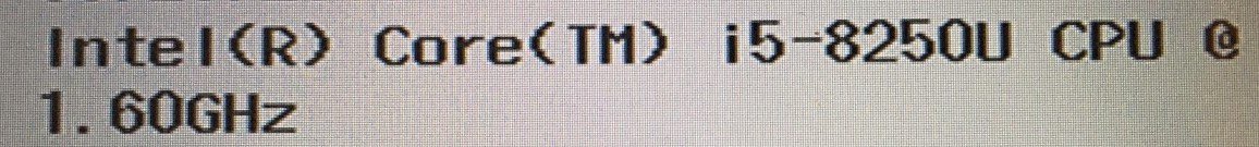

deeveedee Posted February 21, 2022 Share Posted February 21, 2022 (edited) @mnfesq Hackintool v3.8.4 identifies my CPU as i5-8250U @1.6GHz (correct base frequency). In About This Mac (Big Sur 11.6.4), the Processor is listed as 1.8 GHz Quad Core i5 (wrong base frequency). I'm using OC 0.7.8. I wouldn't have noticed the discrepancy until you mentioned yours. I don't have a fix - just saying you have company. EDIT: We both have KabyLake-R CPUs (and I'm assuming you spoofed your device-id as 0x5916). EDIT2: A quick scan of OC source seems to indicate that OC's CPU frequency detection is in Library/OcCpuLib/OcCpuLib.c. EDIT3: @mnfesq I noticed that the CPU string in my HP Envy BIOS screen is identical to the CPU string reported by Hackintool. Spoiler If I had to guess, I'd say that Hackintool is pulling the CPU string from a register, while OC is creating its own CPU description with a calculated frequency. EDIT4: @mnfesq I issued the following command in terminal and see why OC may be reporting 1.8GHz instead of 1.6GHz (on my rig): sysctl hw.cpufrequency Spoiler Maybe OC is correct and everything else is wrong? Edited February 23, 2022 by deeveedee 1 Link to comment https://www.insanelymac.com/forum/topic/350754-opencore-general-discussion/page/302/#findComment-2777171 Share on other sites More sharing options...

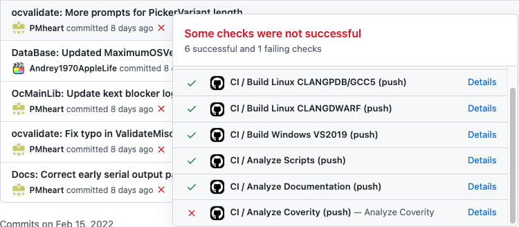

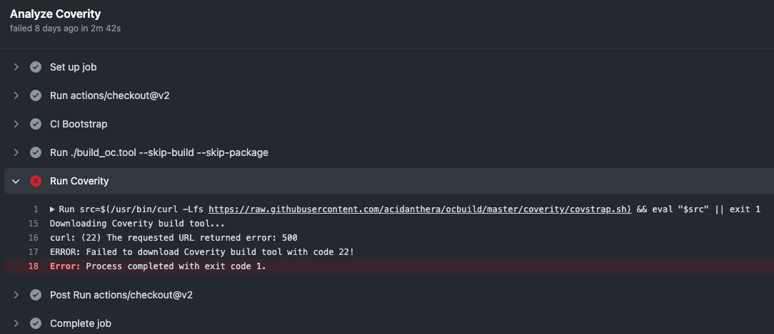

ghost8282 Posted February 23, 2022 Share Posted February 23, 2022 (edited) On 2/15/2022 at 1:49 PM, eSaF said: sometimes the Commit will have a red 'x' beside it with the comment 'This workflow run failed'. To my feeble understanding does this mean the package is unusable? Hi, most of the times it's usable, if you click on the little red icon, then on Details , you can see why the workflow fails. Sometimes there are 404 errors, meaning that external resources are temporary not available, or it can fail to build on some compiler(s), but that doesn't mean that the package is non usable. If it fails because of compilation issue then it's another thing. So summarizing, the red x only means that there was an error during the workflow, check why it failed (there could be billions of causes!) and you can see yourself if the package is ok or not. For example: Click on the red x: You see that the package builds on all compilers, but fails on CI / Analyze Coverity. Click on Details: The workflow failed because coverity url returned error 500 (generic internal server error). However the package is perfectly usable. Edited February 24, 2022 by ghost8282 1 1 Link to comment https://www.insanelymac.com/forum/topic/350754-opencore-general-discussion/page/302/#findComment-2777239 Share on other sites More sharing options...
mnfesq Posted February 24, 2022 Share Posted February 24, 2022 (edited) On 2/21/2022 at 2:03 PM, deeveedee said: @mnfesq Hackintool v3.8.4 identifies my CPU as i5-8250U @1.6GHz (correct base frequency). In About This Mac (Big Sur 11.6.4), the Processor is listed as 1.8 GHz Quad Core i5 (wrong base frequency). I'm using OC 0.7.8. I wouldn't have noticed the discrepancy until you mentioned yours. I don't have a fix - just saying you have company. EDIT: We both have KabyLake-R CPUs (and I'm assuming you spoofed your device-id as 0x5916). EDIT2: A quick scan of OC source seems to indicate that OC's CPU frequency detection is in Library/OcCpuLib/OcCpuLib.c. EDIT3: @mnfesq I noticed that the CPU string in my HP Envy BIOS screen is identical to the CPU string reported by Hackintool. Hide contents If I had to guess, I'd say that Hackintool is pulling the CPU string from a register, while OC is creating its own CPU description with a calculated frequency. EDIT4: @mnfesq I issued the following command in terminal and see why OC may be reporting 1.8GHz instead of 1.6GHz (on my rig): sysctl hw.cpufrequency Hide contents Maybe OC is correct and everything else is wrong? I get the same result using sysctl hw.cpufrequency Here's what my Clover bootlog looks like for CPU: Spoiler 0:105 0:000 Running on: 'HP ENVY Laptop 17-ae1xx' with board '83AD' 0:105 0:000 === [ GetCPUProperties ] ======================== 0:105 0:000 CPU Vendor = 756E6547 Model=806EA 0:105 0:000 The CPU supported SSE4.1 0:105 0:000 The CPU supported RDRAND 0:105 0:000 BrandString = Intel(R) Core(TM) i7-8550U CPU @ 1.80GHz 0:105 0:000 The CPU supported turbo 0:105 0:000 Energy PerfBias is visible: 0:105 0:000 MSR 0x35 40008 0:105 0:000 TSC/CCC Information Leaf: 0:105 0:000 numerator : 166 0:105 0:000 denominator : 2 0:105 0:000 Calibrated ARTFrequency: 23993292 0:105 0:000 Rounded ARTFrequency: 24000000 0:105 0:000 MSR 0xE2 before patch 1E008008 0:105 0:000 MSR 0xE2 is locked, PM patches will be turned on 0:105 0:000 MSR 0xCE 0004043D_F1011400 0:105 0:000 corrected FLEX_RATIO = 0 0:105 0:000 MSR 0x1B0 000000000:105 0:000 FSBFrequency = 85 MHz, DMI FSBFrequency = 100 MHz, Corrected FSBFrequency = 100 MHz 0:105 0:000 MaxDiv/MinDiv: 20.0/4 0:105 0:000 Turbo: 37/37/40/40 0:105 0:000 Features: 0x77FAFBBFBFEBFBFF 0:105 0:000 Threads: 8 0:105 0:000 Cores: 4 0:105 0:000 FSB: 100 MHz 0:105 0:000 CPU: 1700 MHz 0:105 0:000 TSC: 1700 MHz 0:105 0:000 PIS: 100 MHz 0:105 0:000 ExternalClock: 25 MHz As you can see, the FSB is adjusted from 85 MHz to 100 MHz. That happens as a result of a setting in Clover that allows me to configure the CPU: Spoiler But you are correct that OC attempts to calculate the FSB while Clover uses the reported value. I'm not sure why OC chooses the calculation method or if it results in better performance or more accurate sensor readings. Thanks for your investigation! Edited February 24, 2022 by mnfesq Link to comment https://www.insanelymac.com/forum/topic/350754-opencore-general-discussion/page/302/#findComment-2777303 Share on other sites More sharing options...
Guest 5T33Z0 Posted February 25, 2022 Share Posted February 25, 2022 I've noticed that in the last 2 weeks a lot of errors are occurring under the "Actions" Tab of the OpenCorePkg Repo. Also, the last bOC uild available on the Dortania Repo is also about 10 days old. I wonder what's going on. Link to comment https://www.insanelymac.com/forum/topic/350754-opencore-general-discussion/page/302/#findComment-2777334 Share on other sites More sharing options...
Matgen84 Posted February 25, 2022 Share Posted February 25, 2022 2 hours ago, 5T33Z0 said: Also, the last bOC uild available on the Dortania Repo is also about 10 days old. I wonder what's going on. Hi @5T33Z0 I just watched: all Opencorepkg commits are build as usual on the Dortania repo. Only the one from February 24 is not in the repo. There were no commits between Feb 16 and Feb 23, so no build. 😊 1 Link to comment https://www.insanelymac.com/forum/topic/350754-opencore-general-discussion/page/302/#findComment-2777338 Share on other sites More sharing options...
Guest 5T33Z0 Posted February 25, 2022 Share Posted February 25, 2022 18 minutes ago, Matgen84 said: Hi @5T33Z0 I just watched: all Opencorepkg commits are build as usual on the Dortania repo. Only the one from February 24 is not in the repo. There were no commits between Feb 16 and Feb 23, so no build. 😊 That's not true. The last OC commit on the Dortanio Repo is ae04256 which is about 10 days old Link to comment https://www.insanelymac.com/forum/topic/350754-opencore-general-discussion/page/302/#findComment-2777339 Share on other sites More sharing options...
chris1111 Posted February 25, 2022 Share Posted February 25, 2022 Correct is Acidanthera not Dortania Why you guys not creating your build from Xcode inside macOS Monterey, its work verry good 2 Link to comment https://www.insanelymac.com/forum/topic/350754-opencore-general-discussion/page/302/#findComment-2777343 Share on other sites More sharing options...
Guest 5T33Z0 Posted February 25, 2022 Share Posted February 25, 2022 @chris1111 Because not everybody is a programmer and has XTools installed and wants to waste processing power, time and energy to compile OpenCore,…I guess. Link to comment https://www.insanelymac.com/forum/topic/350754-opencore-general-discussion/page/302/#findComment-2777344 Share on other sites More sharing options...
