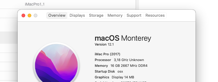

fronskild Posted January 19, 2022 Share Posted January 19, 2022 (edited) hello I follow your perfect guide and I success to install Monterey on my pc i9 12900 k z690 msi with intel internal gpu but I get display 14 mb any solution to get full graphic resolution everything working Edited January 19, 2022 by fronskild Link to comment https://www.insanelymac.com/forum/topic/349837-vanilla-hackintosh-alder-lake-z690-with-i9-12900k-and-amd-radeon-rx-6600-full-dsdt-patched-opencore-or-clover-bootloader/#findComment-2775342 Share on other sites More sharing options...
MaLd0n Posted January 19, 2022 Author Share Posted January 19, 2022 22 minutes ago, fronskild said: I follow your perfect guide and I success to install Monterey on my pc this igpu don't have support. u need use one amd card like rx560+ 1 Link to comment https://www.insanelymac.com/forum/topic/349837-vanilla-hackintosh-alder-lake-z690-with-i9-12900k-and-amd-radeon-rx-6600-full-dsdt-patched-opencore-or-clover-bootloader/#findComment-2775344 Share on other sites More sharing options...
