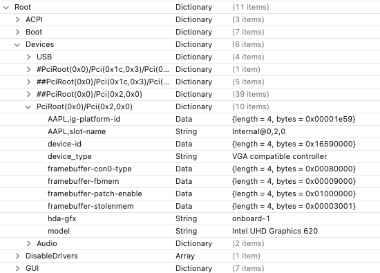

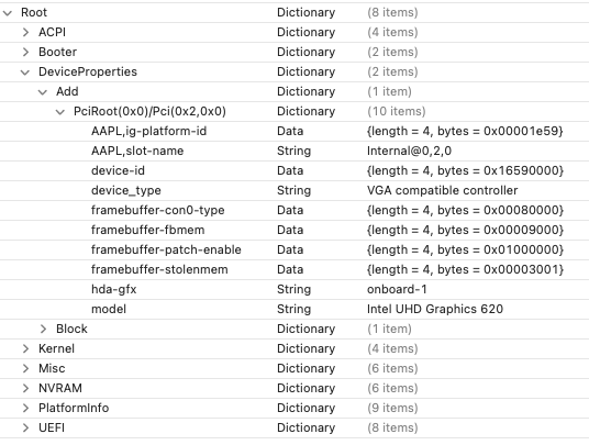

ltooz_audis Posted March 22, 2021 Share Posted March 22, 2021 I was trying to see if Clover 5130 works with Dell UHD 620 0x5917 i7-8650u laptop, it doesn't matter what ig-platform-id I used, NO QE?CI. Any tip on this? Cheers, Louis Link to comment Share on other sites More sharing options...
ltooz_audis Posted March 23, 2021 Share Posted March 23, 2021 which smbios should I use for this to work? OpenCore uses macbookpro15,2 and it works. Link to comment Share on other sites More sharing options...
ltooz_audis Posted March 23, 2021 Share Posted March 23, 2021 None work. Work fine with UHD 620 i7-7500u HP, not Dell i7-8650u Link to comment Share on other sites More sharing options...
ltooz_audis Posted March 23, 2021 Share Posted March 23, 2021 7mB Link to comment Share on other sites More sharing options...

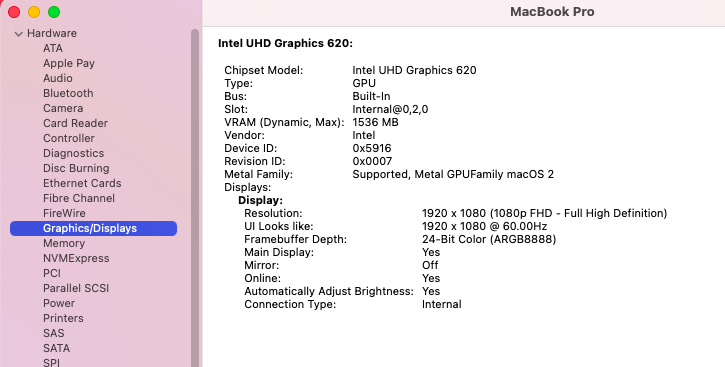

ltooz_audis Posted April 5, 2021 Share Posted April 5, 2021 I think something is still wrong with Clover, it doesn't seem to load the graphics UHD 620 frame buffer as OpenCore 6.4 or 6.6. Use the same iGPU properties for both boot loaders and OpenCore loaded but Clover doesn't. The same clover 5130 loaded fine with 591b on my Envy 13 i7-7500u using macbookpro14,2, but not on Dell i7-8650u 591e. Link to comment Share on other sites More sharing options...

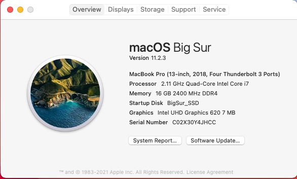

ltooz_audis Posted April 7, 2021 Share Posted April 7, 2021 Hello 5T33ZO, You're the man, it did it. Thanks so much. Learn something new every day and always operator error LOL. Cheers, Louis 1 Link to comment Share on other sites More sharing options...
ltooz_audis Posted April 7, 2021 Share Posted April 7, 2021 For those who has Dell Latitude 5490 Kabylake UHD 620 i7-8650u that wants to boot Big Sur 11.2.3 using Clover 5130, see the attachment for the sample config. Cheers, Louis config.plist.zip 1 1 Link to comment Share on other sites More sharing options...

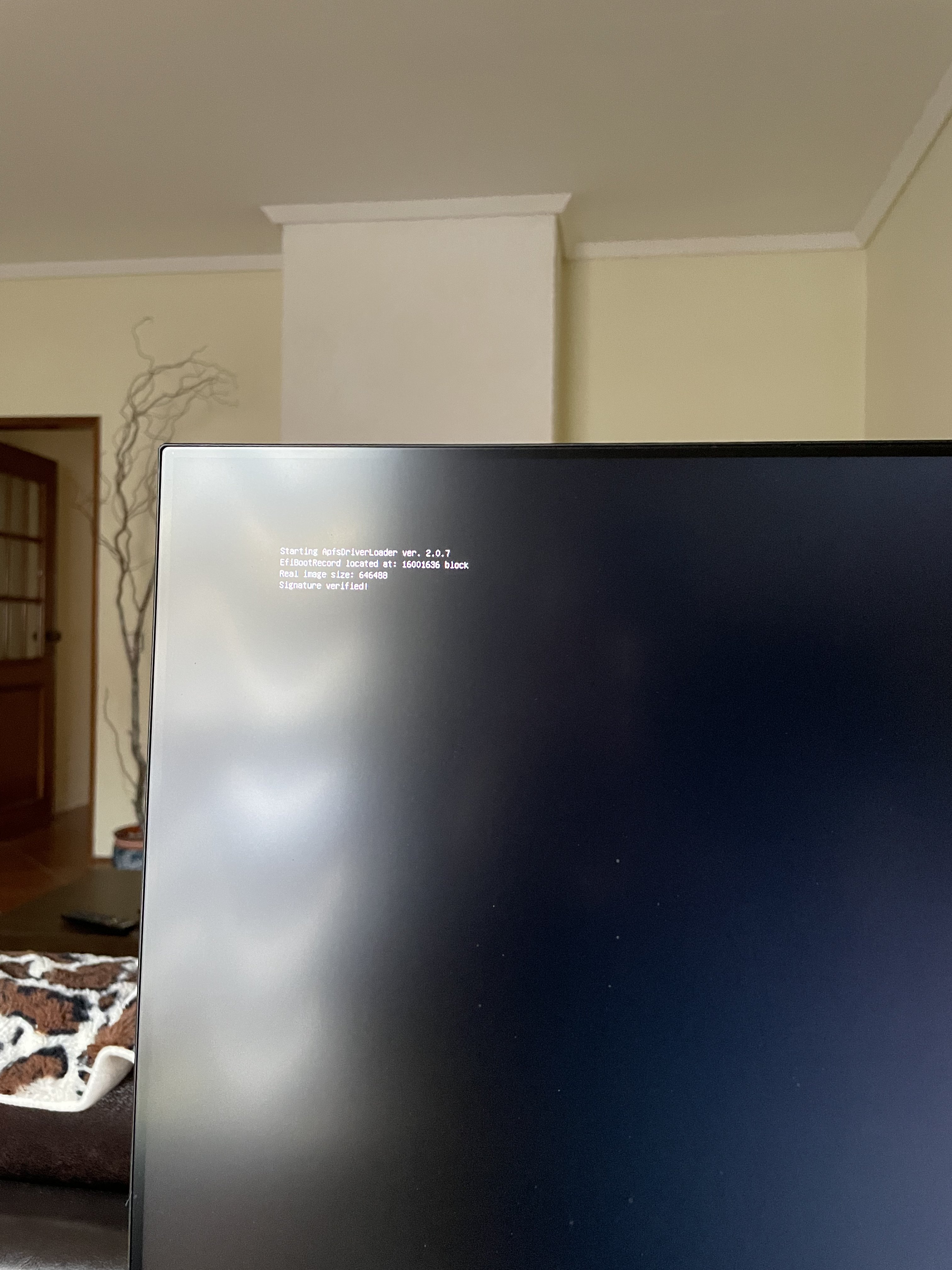

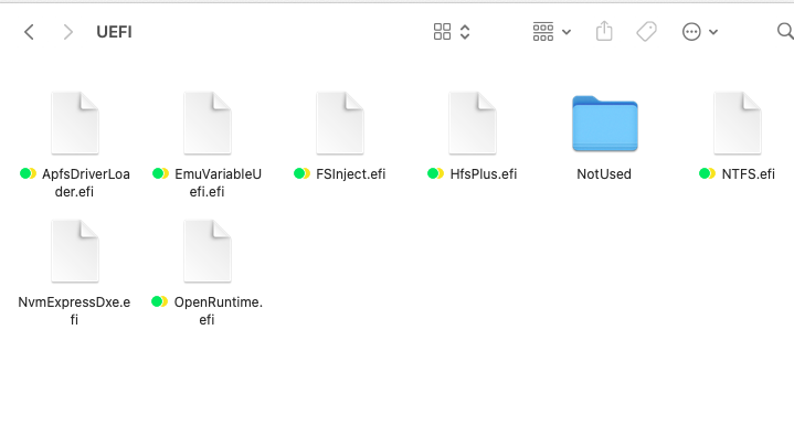

MorenoAv Posted April 9, 2021 Share Posted April 9, 2021 Hi guys, After problems with bluetooth I too tried to install macOS Big Sur with clover 5132, but I didn't succeed, it boots but after reboot the only entry that shows is the install one and my windows 10 in another SSD. After the 3 or 4 try I gave up and resumed the install with OpenCore and the second entry was there from clover and it installed successfully selecting that entry created by clover. For that reason I attach my EFI folder below and ask if any of you could take a look and tell me what is wrong with it. Thank you EFI.zip Link to comment Share on other sites More sharing options...
Matgen84 Posted April 9, 2021 Share Posted April 9, 2021 (edited) 41 minutes ago, MorenoAv said: Hi guys, After problems with bluetooth I too tried to install macOS Big Sur with clover 5132, but I didn't succeed, it boots but after reboot the only entry that shows is the install one and my windows 10 in another SSD. After the 3 or 4 try I gave up and resumed the install with OpenCore and the second entry was there from clover and it installed successfully selecting that entry created by clover. For that reason I attach my EFI folder below and ask if any of you could take a look and tell me what is wrong with it. Thank you @MorenoAv You don't have apfsdriverloader.efi in your EFI/CLOVER/Drivers folder. So Clover don't see apfs partition Your Openruntime.efi (20ko) is wrong (OC drivers?). You've to use Clover version (8ko) I think that you have to edit your config.plist and correct it: no SMBIOS. instead of SMBIOS Imac19,1 etc... Edited April 9, 2021 by Matgen84 2 Link to comment Share on other sites More sharing options...

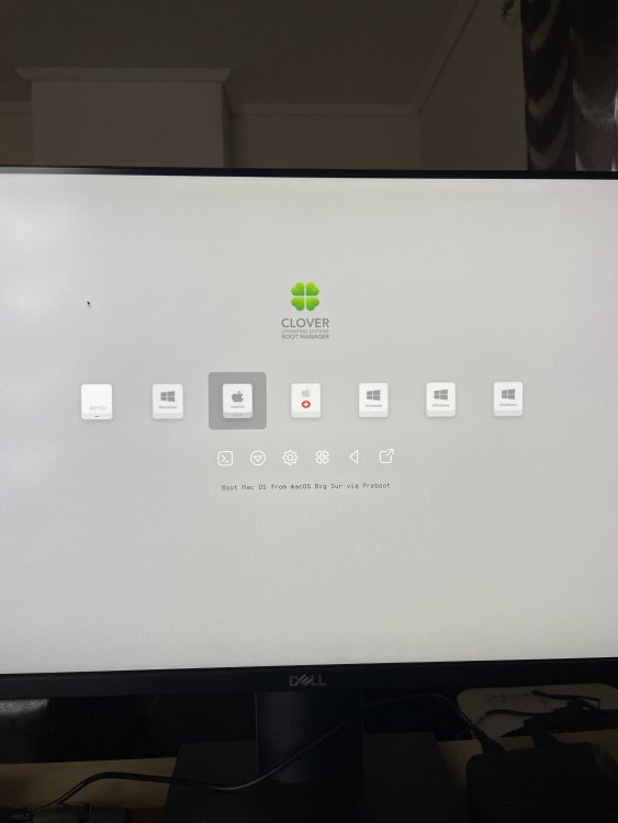

MorenoAv Posted April 9, 2021 Share Posted April 9, 2021 (edited) Thanks @Matgen84, That did the trick I was able to boot from clover as you can see in the photo below... PS: After posting the photos I have re read your post and I noticed that you had edited it, after adding the apfsdriverloader.efi I revised the config.plist and noticed that it was empty for whatever reason, and I redid it again, after that it worked right away. The only thing that I didn't try... yet, is install macOS Big Sur with that clover... Edited April 9, 2021 by MorenoAv 1 Link to comment Share on other sites More sharing options...
Anto65 Posted April 9, 2021 Share Posted April 9, 2021 5 minutes ago, MorenoAv said: Thanks @Matgen84, That did the trick I was able to boot from clover as you can see in the photo below... Hi did you switch to clover ? Link to comment Share on other sites More sharing options...
MorenoAv Posted April 9, 2021 Share Posted April 9, 2021 (edited) 15 minutes ago, antuneddu said: Hi did you switch to clover ? No not yet, I tried to make an usb install with clover, because with OpenCore and I don't know why I lost bluetooth first with the Fenvi T-919 so switched it for a Bcm943602CS and no bluetooth. That made me think to try with Clover and see if the bluetooth work again. In the end I wasn't able to install macOS Big Sur with Clover only was able to start to install and finished with OpenCore, due to its similarities with Clover, and voila I have again bluetooth working... So for now I continue with OpenCore... Edited April 9, 2021 by MorenoAv Link to comment Share on other sites More sharing options...
Matgen84 Posted April 9, 2021 Share Posted April 9, 2021 (edited) 20 minutes ago, MorenoAv said: Thanks @Matgen84, That did the trick I was able to boot from clover as you can see in the photo below... PS: After posting the photos I have re read your post and I noticed that you had edited it, after adding the apfsdriverloader.efi I revised the config.plist and noticed that it was empty for whatever reason, and I redid it again, after that it worked right away. The only thing that I didn't try... yet, is install macOS Big Sur with that clover... You're welcome @MorenoAv If you want to use a Clover Big Sur HD : you can use the @Slice 's csractiveconfig setting to update the OS via Preference/Softwareupdate: <key>CsrActiveConfig</key> <string>0x285</string> Edited April 9, 2021 by Matgen84 2 Link to comment Share on other sites More sharing options...
Anto65 Posted April 9, 2021 Share Posted April 9, 2021 9 minutes ago, MorenoAv said: No not yet, I tried to make an usb install with clover, because with OpenCore and I don't know why I lost bluetooth first with the Fenvi T-919 so switched it for a Bcm943602CS and no bluetooth. That made me think to try with Clover and see if the bluetooth work again. In the end I wasn't able to install macOS Big Sur with Clover only was able to start to install and finished with OpenCore, due to its similarities with Clover, and voila I have again bluetooth working... So for now I continue with OpenCore... Some time ago I used clover, recently I tried to convert Oc -> Clover just to try, without success, I abandoned the thing , thank goodness you solved it with bluetooth 2 Link to comment Share on other sites More sharing options...

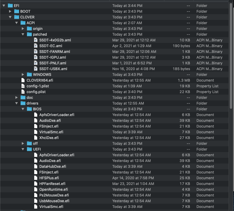

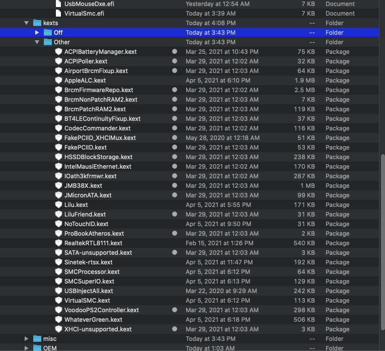

makk Posted April 12, 2021 Share Posted April 12, 2021 Greetings, I am running a bit nuts on how to get this to work. I thank you for your instructions. I followed it to the letter, but did not boot But it no worky so far. I am uploading my test pilot config.plist that is on a USB. What I have so far if you can bear with me a bit: 10.15.7 latest public release ( I think ) I think the rendition is .02? Catalina Clover 5122 running on normal EFI that is not touched. Upgraded from Mojave straight. runs and boots everything works so far. I do have a dead battery so no problems they cost a fortune nowadays. Originally Installed Rehabman's Project for HP Probook out of his Project which works nicely as long as we stay in Mojave had to make some adjustments to config.plist trial and error for Catalina and install Clover 5122 with some configurations changes. new versions of drivers as best as possible with latest from clover installer V2. New versions of kext, unfortunately VoodooPS2controller has a problem with the trackpad so went back to 1.9.2 Rehabman. 2.2.2 broken for trackpad. I do get hiccups with Catalina on certain things. But other than that everything works with Clover 5122. I actually have the SDCARD reader working but flaky. I have installed new version of Clover 5133. cannot boot in get panics. I was reading where your VoodooPS2 was a problem so I tried that no luck. When I switch off LapicKernel I get a different boot up and panic screen not the CPU one. I get the screen where it stops loading the kexts and drivers. and says last kext loaded: NoTouchID.kext. I'm wondering if this kext is any good what's the purpose? Seems a wasted effort. UPLOADED: USB configs and screen shots of boot and EFI layout Panic action screen shot Config.plist EFI on USB config.plist Link to comment Share on other sites More sharing options...
ltooz_audis Posted April 12, 2021 Share Posted April 12, 2021 (edited) 3 hours ago, makk said: Greetings, I am running a bit nuts on how to get this to work. I thank you for your instructions. I followed it to the letter, but did not boot But it no worky so far. I am uploading my test pilot config.plist that is on a USB. What I have so far if you can bear with me a bit: 10.15.7 latest public release ( I think ) I think the rendition is .02? Catalina Clover 5122 running on normal EFI that is not touched. Upgraded from Mojave straight. runs and boots everything works so far. I do have a dead battery so no problems they cost a fortune nowadays. Originally Installed Rehabman's Project for HP Probook out of his Project which works nicely as long as we stay in Mojave had to make some adjustments to config.plist trial and error for Catalina and install Clover 5122 with some configurations changes. new versions of drivers as best as possible with latest from clover installer V2. New versions of kext, unfortunately VoodooPS2controller has a problem with the trackpad so went back to 1.9.2 Rehabman. 2.2.2 broken for trackpad. I do get hiccups with Catalina on certain things. But other than that everything works with Clover 5122. I actually have the SDCARD reader working but flaky. I have installed new version of Clover 5133. cannot boot in get panics. I was reading where your VoodooPS2 was a problem so I tried that no luck. When I switch off LapicKernel I get a different boot up and panic screen not the CPU one. I get the screen where it stops loading the kexts and drivers. and says last kext loaded: NoTouchID.kext. I'm wondering if this kext is any good what's the purpose? Seems a wasted effort. UPLOADED: USB configs and screen shots of boot and EFI layout Panic action screen shot Config.plist EFI on USB config.plist 20.34 kB · 1 download Did you use an EFI folder from someone? Follow the guide in the beginning of this thread. Do you know what you have in the "Other" folder? Do you know what each kext in the "Other" folder is for? Where did you get this config file? What Devices/Properties for graphics? Rehabman guide is old, it won't work with Catalina or Big Sur. Cheers, Louis Edited April 12, 2021 by ltooz_audis Link to comment Share on other sites More sharing options...
makk Posted April 13, 2021 Share Posted April 13, 2021 3 hours ago, ltooz_audis said: Did you use an EFI folder from someone? Follow the guide in the beginning of this thread. Do you know what you have in the "Other" folder? Do you know what each kext in the "Other" folder is for? Where did you get this config file? What Devices/Properties for graphics? Rehabman guide is old, it won't work with Catalina or Big Sur. Cheers, Louis Thanks I am running Catalina with Clover 5122 no problems. I am trying to update to Clover 5133 latest with OC Quirks. With Clover 5133 Panic haven. See the photo with Panic. Right now I just booted into Catalina with OC 6.7 but slow as all get up. and no icons for drives to pick something wrong with this version. no audio. and no battery on Menu Bar. what else? USB is in 2.0 instead of 3.0 The config is mine. Slapa dill for ma Link to comment Share on other sites More sharing options...

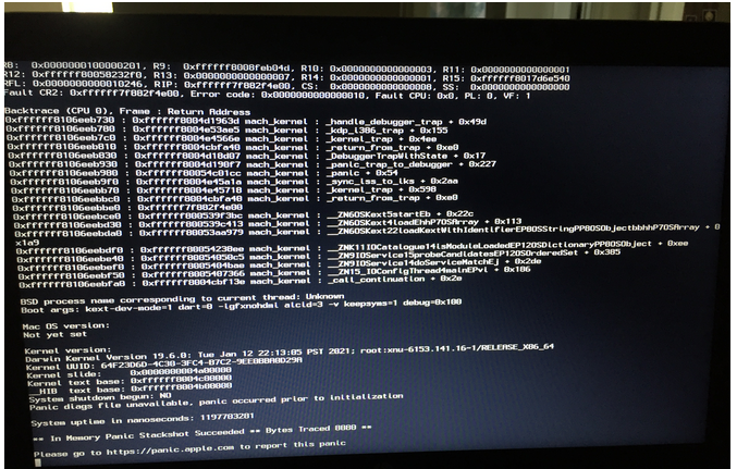

makk Posted April 14, 2021 Share Posted April 14, 2021 (edited) On 4/12/2021 at 11:07 PM, makk said: Thanks I am running Catalina with Clover 5122 no problems. I am trying to update to Clover 5133 latest with OC Quirks. With Clover 5133 Panic haven. See the photo with Panic. Right now I just booted into Catalina with OC 6.7 but slow as all get up. and no icons for drives to pick something wrong with this version. no audio. and no battery on Menu Bar. what else? USB is in 2.0 instead of 3.0 The config is mine. Slapa dill for ma Ok fixed running smooth NVRAM what at pain! F11 saves the day. Catalina 10.15.7 and Clover 5133. No problems. Boots up pretty fast. Just had to use the 5133 Package installer worked like a charm. Also in Drivers section on EFI need the QCQuirks driver added or won't boot It was relatively simple and easy with Clover package installer Just add the drivers. Take out the Aptiodrivers replace with Openruntime.efi and QCquirks.efi then it boots. Read the destructions without using Xcode. Use Clover Configure and don't add all the other stuff in the destructions at Opencore site. I personally find Opencore not so good. Too much restrictions pain in the arse. Like simple. Thanks for putting up this topic. Ready for BigSur. With Big Sur doing a straight upgrade no fresh install. Have to disable the injected kexts in Clover boot menu. All the fancy stuff has to be disabled. Most likely need Atheros Wifi Driver for Big Sur. Anyone have this for Big Sur? Edited April 18, 2021 by makk Link to comment Share on other sites More sharing options...
