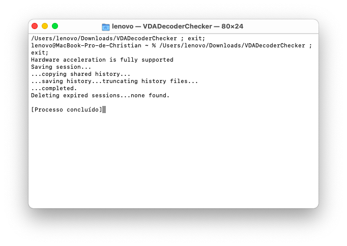

21 minutes ago, Pavo said:
@MorenoAv I read this today by accident: https://dortania.github.io/OpenCore-Desktop-Guide/post-install/drm.html
So with DRM, we have a couple things we need to mention:
* DRM requires a supported dGPU
* DRM is broken for iGPU-only systems
-- These have never worked with Haswell and newer
-- For Ivy Bridge, this could be fixed with Shiki (now WhateverGreen) til 10.12.2, but broke with 10.12.3
* Working hardware acceleration and decoding
and the statement "DRM in iGPU-only never worked with Haswell and newer" caught my attention. Is that a true statement?
Dortania contains some miss, read here better: https://github.com/acidanthera/WhateverGreen/blob/master/Manual/FAQ.Shiki.en.md

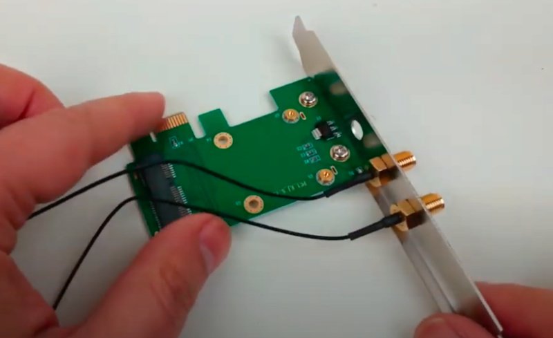

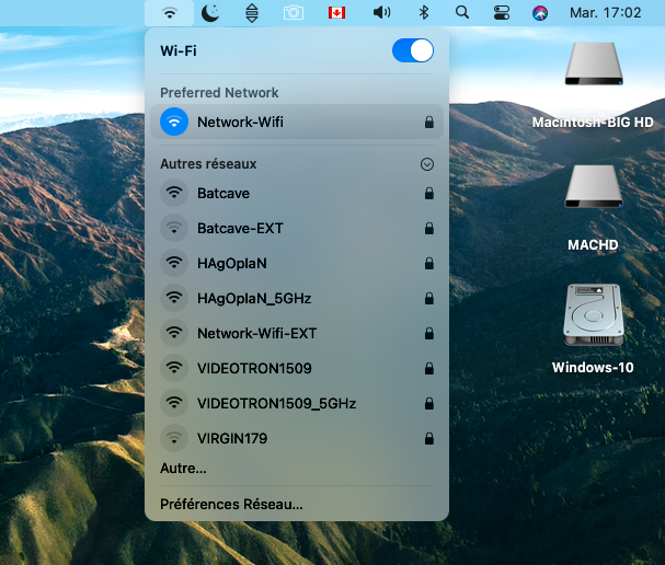

I unlock the Menu Bar Icons on my HP Prodesk 600. G1 with my WIFI card
BCM94360HMB and my PCIe Mini WIFI Adapter
Everything works like on my laptop , this card is native
Spoiler
Really happy of the result

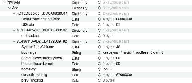

Im solved its with two USB installers: One from EFI downloaded from MaLD0n.
And another, im fix with Opencore with same kexts from Clover that works boot loader and put with my Old DSDT and fix the thinks about Nvram.
But first think is, delete all EFI folders and try install on external ssd/nvme. Not left anyone for behind. Make sure that your kexts is correctly for EFI Opencore.
use generics DSDT for try install with iMacPro 1,1 SMBIOS.
This config is for boot after installer complete 3 stages:
Spoiler
This config is for boot installer with no EFI folder on EFI partition target, ONLY on USB installer EFI:
Spoiler

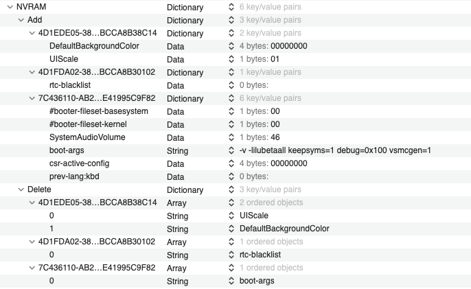

4 minutes ago, meaganmargaret said:
@Max.1974 and @Moviemakergr:
Thanks for the replies.  However, I ended up in the same place, SIGABRT, etc....
So, I enclosed my config.plist for my USB booter.  Maybe you all can see something I missed?  Thanks.
upload_config.plist
-lilubetaall & vsmcgen=1 are no longer needed as long as you have updated your kexts.
Have you tried minimizing your config? Remove some .aml, kexts, device properties?
I don't have x299 so these are just suggestions.

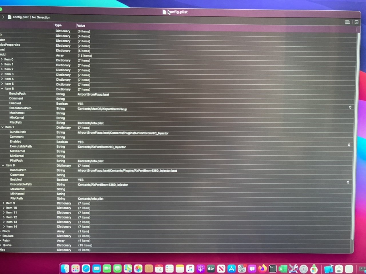

On 7/15/2020 at 3:14 AM, SavageAUS said:
@Everyone with unsupported wifi.
There should be need to replace the IO80211.kext anymore with the new AirportBrcmFixup.kext.
Update the kext from latest master, snapshot your OC folder with ProperTree, make sure the new plugins for AirPortBrcmFixup are present in config.plist, reboot, success.
No need to unseal apfs or delete snapshots, I updated kext and did a full fresh install and had working wifi at setup. DW1820A.
Thanks to the devs!
YMMV
Sent from my iPhone using Tapatalk
Hey @SavageAUS. I configured the OC config file to include under Kernel>Add section the two new plugins of AirportBrcmFixup and booted, but the WiFi is still not working. Attached is the screenshot of the config file and the AirportBrcmFixup kext I’m using which I downloaded from a post made here by @chris1111 (you have to rename it when downloading it). Could you take a look and advise if I made something wrong or I’m using the wrong kext?
AirportBrcmFixup.kext.kext.zip
Spoiler
@jlrycm Use the one attached and use ProperTree to make a snapshot of your OC folder.
Depending on the card you have you may also need to add this to your config.plist under DeviceProperties (change the compatible value if needed)

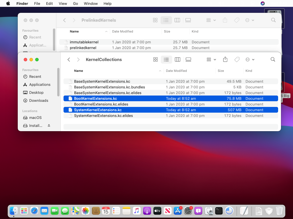

8 hours ago, ameenjuz said:
how to rebuilding kernel collections and prelinkedkernel after new kexts copied to /S/L/E or /L/E) under the Big Sur using terminal without recovery
and how to copy kext to /L/E or /S/L/E
1.  Ensure SIP, authenticated-root and APFS snapshots are disabled.  Mounting the / folder as read-write should not show any "error 66"...
fusion71au@fusion71aus-Mac ~ % csrutil status
System Integrity Protection status: disabled.
fusion71au@fusion71aus-Mac ~ % csrutil authenticated-root status
Authenticated Root status: disabled
fusion71au@fusion71aus-Mac ~ % nvram csr-active-config
csr-active-config	w%08%00%00
fusion71au@fusion71aus-Mac ~ % ls -l /Volumes
total 0
lrwxr-xr-x   1 root        wheel    1 15 Jul 08:21 Big_Sur -> /
drwxrwxr-x  23 fusion71au  staff  850 10 Jul 19:15 Install macOS Big Sur Beta
drwxr-xr-x  22 root        admin  704  1 Jun 15:08 macOS
drwxr-xr-x  21 root        wheel  672 23 Jun 15:27 macOS — Data
fusion71au@fusion71aus-Mac ~ % sudo mount -uw /
Password:
2.  Backup original kext(s) in /S/L/E, copy desired kext into /L/E or /S/L/E.  Afterwards, correct file permissions for the kexts...
fusion71au@fusion71aus-Mac ~ % sudo mv /System/Library/Extensions/IO80211Family.kext /System/Library/Extensions/IO80211Family.orig
fusion71au@fusion71aus-Mac ~ % sudo cp -R ~/Downloads/IO80211Family.kext /System/Library/Extensions
fusion71au@fusion71aus-Mac ~ % sudo chown -R 0:0 /System/Library/Extensions/IO80211Family.kext && sudo chmod -R 755 /System/Library/Extensions/IO80211Family.kext
3.  Touch /S/L/E and rebuild kext caches with kextcache (deprecated but still works for now) or kmutil (preferred)...
fusion71au@fusion71aus-Mac ~ % sudo touch /System/Library/Extensions && sudo kextcache -i /
Executing: /usr/bin/kmutil install --volume-root / --check-rebuild
rebuilding local auxiliary collection
kmutil done
or
fusion71au@fusion71aus-Mac ~ % sudo touch /System/Library/Extensions && sudo kmutil install --volume-root / --update-all --force
checking collections...
considering release out-of-date because of --force
rebuilding release collections: boot, system
	boot kernel collection
	system kext collection
kmutil done
4.  Run kcditto to copy the cache files to the correct locations...
fusion71au@fusion71aus-Mac ~ % sudo /usr/sbin/kcditto
Copying deferred prelinked kernels in /...
/AppleInternal/BuildRoot/Library/Caches/com.apple.xbs/Sources/kext_tools/kext_tools-685/kc_staging.m.279: Encountered error while inspecting path: Error Domain=NSCocoaErrorDomain Code=260 "The folder “PrelinkedKernels” doesn’t exist." UserInfo={NSFilePath=/Library/Apple/System/Library/PrelinkedKernels, NSUserStringVariant=(
    Folder
), NSUnderlyingError=0x7fc8e250f310 {Error Domain=NSOSStatusErrorDomain Code=-43 "fnfErr: File not found"}}
    Folder
), NSUnderlyingError=0x7fc8e2405170 {Error Domain=NSOSStatusErrorDomain Code=-43 "fnfErr: File not found"}}
Copying KCs in /...
System Volume UUID: 87B3F97E-C36B-47AC-848D-465CB4414386
Volume Group UUID: B6AB1C78-8039-45DD-B98A-4DF87261D0BA
Preboot disk: /dev/disk2s2
Preboot volume: /System/Volumes/Preboot
Copying: /System/Library/KernelCollections/BootKernelExtensions.kc.elides -> /System/Volumes/Preboot/B6AB1C78-8039-45DD-B98A-4DF87261D0BA/boot/System/Library/KernelCollections
Copying: /System/Library/KernelCollections/BootKernelExtensions.kc -> /System/Volumes/Preboot/B6AB1C78-8039-45DD-B98A-4DF87261D0BA/boot/System/Library/KernelCollections
Copying: /System/Library/PrelinkedKernels/immutablekernel -> /System/Volumes/Preboot/B6AB1C78-8039-45DD-B98A-4DF87261D0BA/System/Library/PrelinkedKernels
Copying: /System/Library/PrelinkedKernels/prelinkedkernel -> /System/Volumes/Preboot/B6AB1C78-8039-45DD-B98A-4DF87261D0BA/System/Library/PrelinkedKernels
Notice the error /AppleInternal/BuildRoot/Library/Caches/com.apple.xbs/Sources/kext_tools/kext_tools-685/kc_staging.m.279: Encountered error while inspecting path: Error Domain=NSCocoaErrorDomain Code=260 "The folder “PrelinkedKernels” doesn’t exist."
The end result of installing kexts and rebuilding caches while booted into Big Sur seems to be that KernelExtensions.kcs are updated but the prelinkedkernel remains unchanged, compared to doing this process from Recovery where both the prelinkedkernel and kcs are updated...
Spoiler
1325819429_PrelinkedkernelunchangedvsKernelCollections.thumb.png.a695eb22021a35aec0562d3b0cb430d3.png

AirportBrcmFixup.kext.zip
ProperTree.zip
I’m going to test with your kext and the addition to device properties. Attached is the OC config file.
config 2.plist
Edited by jlrycm
config 2.plist
This one has the deviceproperties and plugins for AirportBrcmFixup.
config 2.plist
This is assuming you have vanilla kexts in S/L/E
Edited by SavageAUS
Just now, jlrycm said:
@SavageAUS Should I use the config file you attached? What you changed?
I edited the DeviceProperties to add what i have in config.plist and i also added the plugins for the new AirportBrcmFixup.kext to the config.plist.
You can try it as long as you add in your serials etc or copy over what i added / changed into your config.plist
What WiFi chip do you have?
@SavageAUS It’s a Brcm94331cd mini pcie WiFi and BT combo card that I purchased back in 2014. About the serials, I had them already included but for some reason when I open About this MAC it shows the following wording: To be filled by OEM.
Update: I booted the system with the config file you edited but still no WiFi. I checked in Ioreg and nothing in there.
Edited by jlrycm
55 minutes ago, fusion71au said:
No, the main point of the post was that it is possible to boot Big Sur on an old machine with a non metal graphics card as long as the OS is already fully installed on the HD/SSD.  Without a metal capable graphics card, I was unable to install from scratch with a createinstallmedia Installer USB (installation stalls at stage 2, kernel panics with graphics error ---> reboots).
total 0
Password:
kmutil done
or
kmutil done
    Folder
    Folder
Copying KCs in /...
  Reveal hidden contents
thanks that great guide
Ok let me know how you go, Like i said, you may need to change this part
<key>compatible</key>
<string>pci14e4,43a0</string>
To match your card.
Edited by SavageAUS
